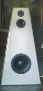

I am trying to post pictures here but its real slow..............At any rate, Thank you Tinitus for the cheers................Frankies' sound is awesome................Bass is tight and well defined, especially with the kick drum.................Bass guitar is very detailed and still maintains its' punch and notes are distinct, even when the music shifts into the upper midrange.................The CA15RLY performs voice amazingly better than I had hoped for and piano is very resounding................The TDFC greatly augments all the range from bass on up.................The entire frequency range of Frankie is performed in an Extremely transient manner, it brings goosebumps down my spine, it is so quick.................No sibilence at all.......When a high hat is hit, then stops, it stops "right now". The amount of detail throughout an entire passage with the different instruments playing together is something I have never heard in my earlier projects...................Frankie gets it, man..........it's amazing......................On violins, you can almost hear the individual bow strings caressing the catgut, kinda like hearing a vocalist breathing or the fingers rubbing on guitar strings..................These little nuances are what I have a deep appreciation for......................No nasal sound..........Very open sounding and imaging is good..................Imaging can get better, I think, when I more carefully place Frankie in the room more accurately................I did not take the time to do this yet, but will do so shortly......................Overall balance from the woofer to the tweeter, I think, is good.................All play without drowning each other out during both Highs and Lows of a passage...........However.....................I would like to bring the cymbal tapping sound of the tweeter up a little bit and make it sound a little more pronounced, help elevate it "above" a smidgeon..................I want to do this WITHOUT making the rest of the spectrum becoming too "tinny" sounding...........Tinitus..............Any Ideas?................I listened to Frankie for 3 hours of his inaugural gig late last nite, so I have got a lot more to experience with a few minor tweaks, I think...........Overall, without measuring equipment of any kind, I have to say that the FRD Tool method of designing and building speakers is excellent, and though a lot of leaps of faith are required, It definately is well worth investigating for anyone who desires to design a system........................Sreten, man, you put me on that path, and I wish to express to you my fondest gratitude.................Tinitus, your artistic heart, and sincere interest in Frankie is truly a gift I will cherish, as you have exemplified EXACTLY what I believe to be the essence of speaker building................Grant..............Your Curiosity and support in research and developement and desire to do the right things has ABSOLUTELY proven the value of tenacity.............and friendship.......... It's weird, because you started this thread, and my hope for you is that you realize your speaker design is definately viable and doable.......................I have a lot of people to thank, but mainly you guys have been my "ROCK" and I am grateful to you all.....................I am gonna try to post some pics here shortly after I post here, so let's keep in touch..................Omni
Fantastic ... and thank you fore your kind words ... and fore letting me be a (small) part of this adventure
But you want to have a more liquid treble, if I understand you correctly

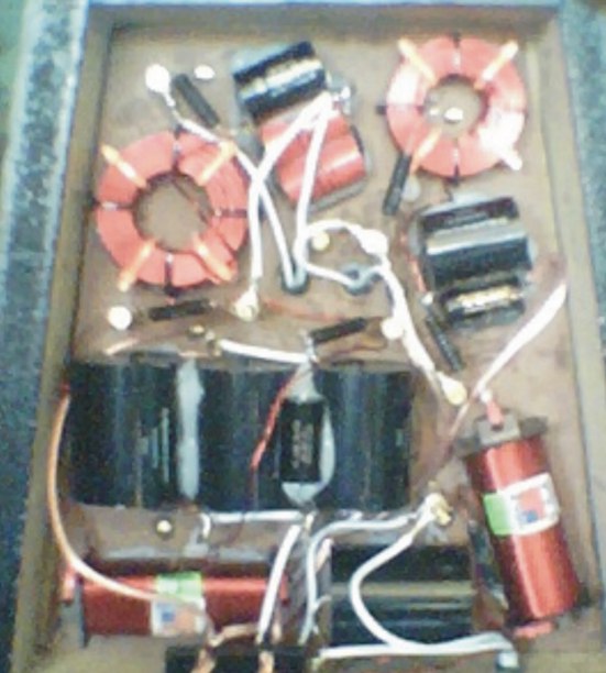

At this point I dont know your xo exactly .... do you have a small RC on tweeter ?????
Also tweeter attenuation can be a delicate thing ... may need fine adjustment
But remember ... its all still very fresh
Maybe its just perfect as it is, and what you miss just isnt there at all

Tinitus, You may be thinking right along the same lines as I am.........On the tweeter I have a series resistor of 1.2 ohms..........The shunt coil is .47mH with a 1.2 ohm resistor attached to it...............Sound still is SWEET, and somewhere I heard that speakers take several hours to break in.........I am not sure about this................I mean man, I really dig Frankies sound, and I will take some time to enjoy what is accomplished so for.........Maybe in a week or 2 I can lower series resistor to 1 ohm.........I,m gonna take my time on this........I don't want to spoil an already good thing.................Omni

Fantastic.. Congratulations! You seem to have a superb result and all your work has paid off. And of course you chose some excellent drivers! Transient 'snap' etc. I hear you about the treble, that a minor change might be needed, but maybe only after 30? hours break-in. I think turn it up for perhaps a week and take detailed notes of any changes in sound ...as one does, lol. Then possibly tweak xo? Just an idea. Your cabinets look fantastic, great work there too. Cheers , I'm so pleased for you!

Grant...........Thank you very much for your support, man, I think you are on the same wavelength here.............Play Frankie for a while......observe changes............then maybe tweak.....The only area I may need to tweak in resistors will be the tweet..............I bought extra resistors and at differing values, so I've got the goods....... HOWEVER...........If you have ever seen Tony Gees' Humble Homemade HiFi website, you may have read about his capacitor comparisons..............Check out his discussion of the VISHAY-ROEDERSTEIN mkp1837 capacitor............He raves about it........He talks of its' fantastic sound enhancing properties as a bypass, especially in the tweeter section, and what a huge difference it makes, sweetening the sound.................A while back, I did some exhaustive research to get ahold of these, and as luck would have it, I was able to get 4 of them..........I have not installed them on Frankie yet, because I wanted to hear Frankie with the original set up.................He does sound sweet, and I now have heard, I think, what a flat { or close to flat } speaker response sounds like.........Hopefully I described it aptly in my original post.............Although words are difficult to describe...........You need to get on a plane immediately to Rossford, U.S.A........................lol...............At any rate, what I am gonna do here, is listen to Frankie for a few weeks, observe any changes, then install the VISHAY caps.............Reports are they make a HUGE, SWEET audible difference................Then listen for a few more weeks, then if needed, replace my 1.2 ohm resistor with a 1 ohm....................Tinitus appears to understand the newness of the design and build, and echoed my sentiments..............That's cool.................Lets keep in touch............so much to talk about..................Omni

I would hold my breath about changing those caps ... and wait till you can afford "Duelund Coherent" caps and resistor fore the tweeter
And further on in the future some nice midrange series inductors
