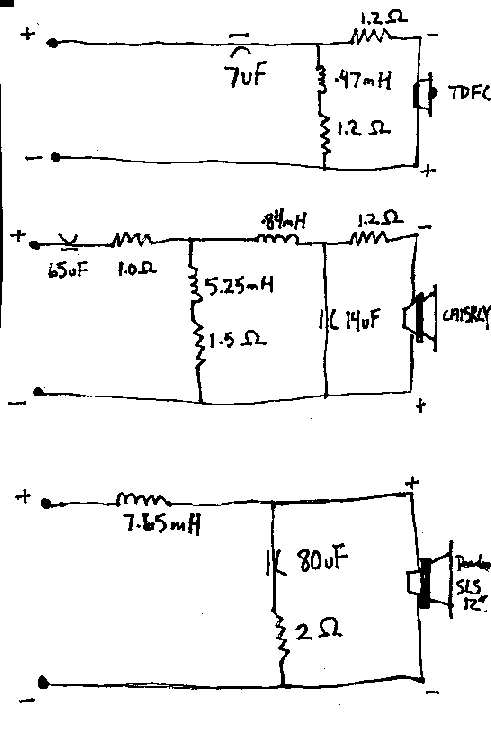

BTW ... my latest improvement is this "notch"(?) ... I use it on bass filter, but it might work elsewhere too ... at least on my speaker its very clear that it dont have the artefacts(?) of a normal "notch", very smooth and soft ... maybe you can try it in a simulation
-------------inductor------------
-------resistor------cap--------
Inductor is in series, and "shunted" with the res/cap
I dont seem to be able to upload from my paint programme anymore, so I hope this will do

It can be a "notch" filter if R is relatively low. It will correct a bump
in the passband of a woofer. To suppress artifacts above the c/o
point that interference with the midrange proper a parallel to
the driver series circuit is usually used, an eliptical filter.
🙂/sreten.
