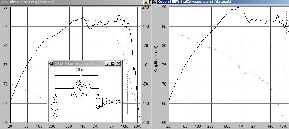

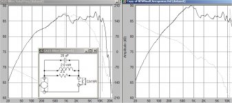

I had another try at a CA15 filter for you, ..attached.., it could be rubbish but it may be of some use as a *starting point* for tweaking but only in context with a woofer filter etc. Just sim all changes and look carefully at the electrical phase and Z as per Sreten's advice. Also note that Andy G. doesn't really sim anything nor does Tinitus! If you like I'll try a 'SLS' filter for you too.
Grant, it looks like the dip below 2khz got even worse than before :cannotbe: that is if I look at the right chart
Another thing is, I am not quite sure I would like to send all of my midrange signal through such components ... it might be better to stick with a series notch on midrange ... but some of it might be solved with changing the series resistors
But lets wait and see what Omni can achive with the woofer first
Sorry fore such negative response 😱

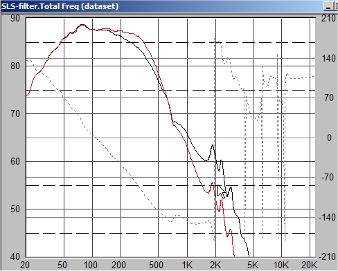

Hi Omni,
I had a go at a series notch filter on your woofers but it didn't improve it much, so I tried a parallel
one. After a little calculating and varying L/C ratios and R, I got about an 8dB spike reduction.
The black line is your SLS filter with 2R, the red curve is the parallel notch with no 2R.
This might sound better if it's used together with my previous CA15 filter, assuming the electrical phase still sims ok.

I put the graphs around the wrong way in my post #732. The one on the right is Omni's Ca15 in-box response with no filter. Why the peak/dip exists, I really don't know. The left graph is just my feeble
attempt to filter it a bit flatter and maybe incorporate this into the mids LP and HP filters, thereby hopefully reducing the CA15's Is it not advisable to put a parallel notch filter in the (series) signal path? I just could not get any improvement from my attempts at series notches.

Omni,
My red curve is higher from 150 to 500, so maybe (if you decide to use it) you could increase the 80uF cap to restore it? cheers, all
