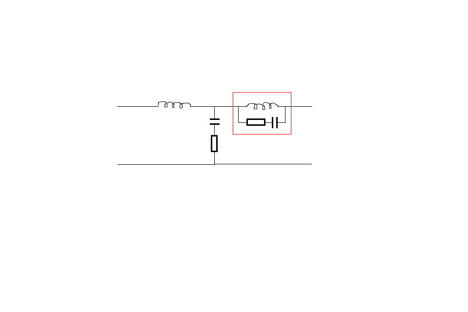

Hi Grant, would you do me a big favour and simulate this "notch" (framed in red) ... just use your own filter ... I would like to see how FR response reacts
Values about 0.6mH / 2.2uf / 8.2ohm

Well, notches are kind of new to me too, but I think that in a paralel notch fore FR "shaping", the inductor is big and the cap is small ... if you do it the other way round with big C and small inductor, its intended fore impedanse peaks
Grant....Tinitus...........It appears to me that probably the notch of choice will be a parallel filter situated in series to the driver........When I modelled series notch filters situated in parallel to the driver, impedance appeared to go a bit low, possibly in the danger zone..............omni

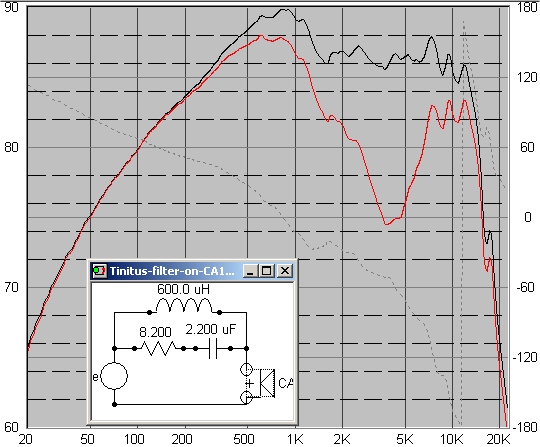

Here's your notch centred at 4380Hz...I used Omni's CA15 in box data with no other filter.
Omni, I'll resim your networks with new filters if you wish. It will be interesting to see how much the 2k peak diminishes... grant
Thanks fore the sim, and wow, it looks like a real effective notch 🙂
BTW ... seems you have simmed on midrange ... I forgot to mention that I use it on 4ohm woofers, so ofcourse component values would be different, but I guess I wouldnt use THAT on a wellbehaved midrange, as it seems to nearly shut down the driver, might be good on peak troubled drivers though

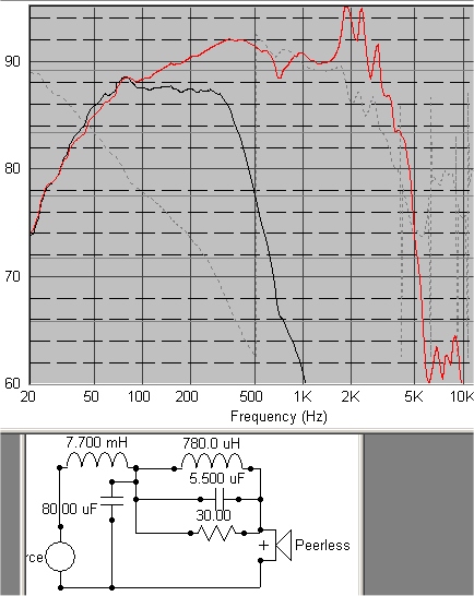

Hey Omni,
I took Tinitus' advice and tried it a bit wider... now it doesn't look too shabby, but its a real sledgehammer approach, same as your 7.7mH coils name! haha. I have no idea as yet what the impedance
implications would be. Thanks Tinitus, for your suggestion, grant
