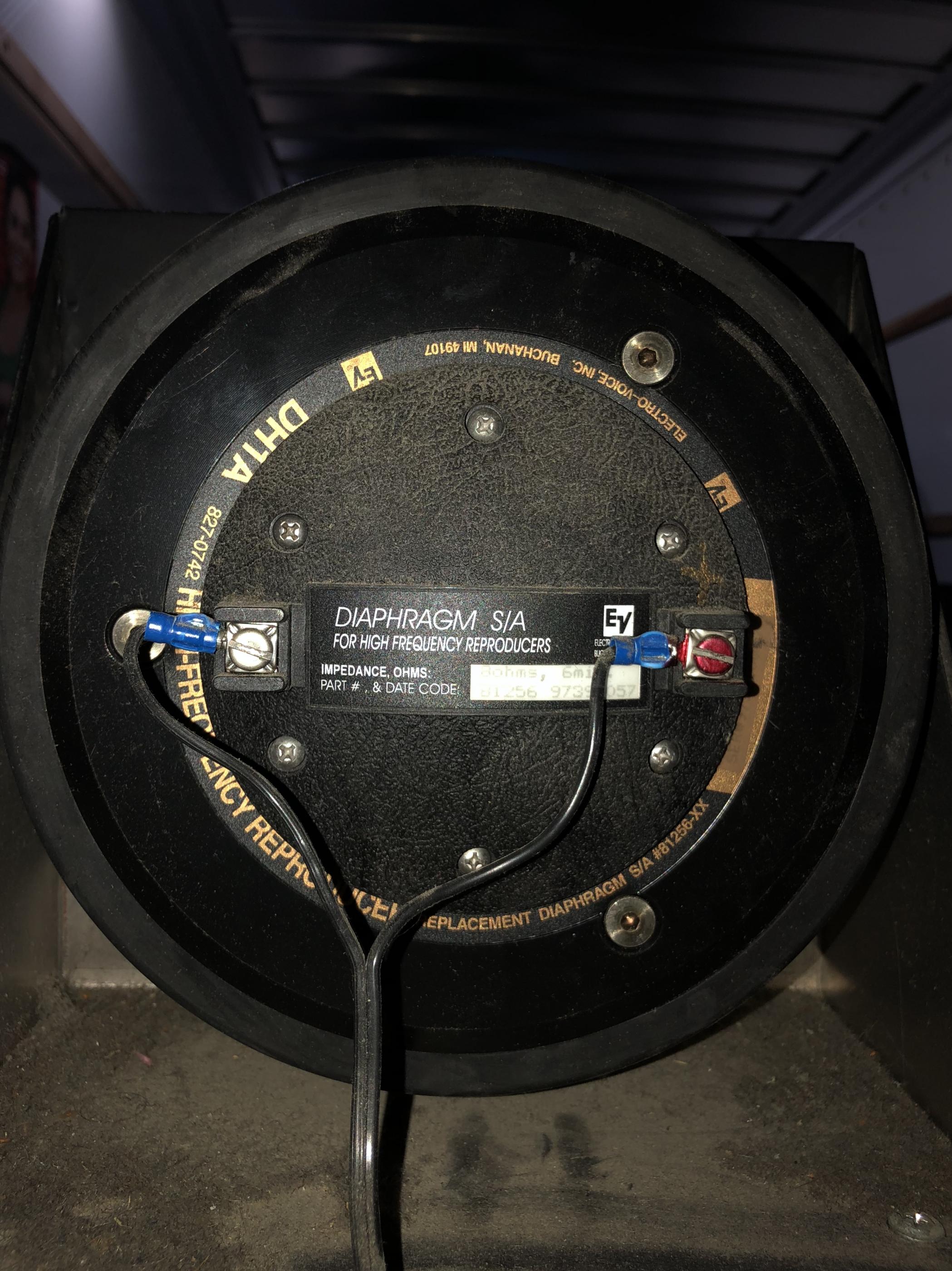

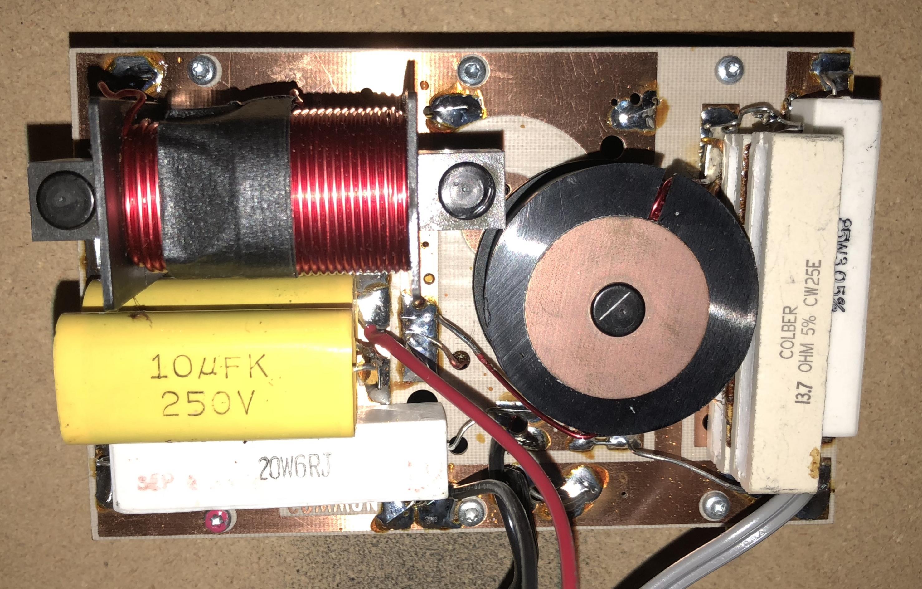

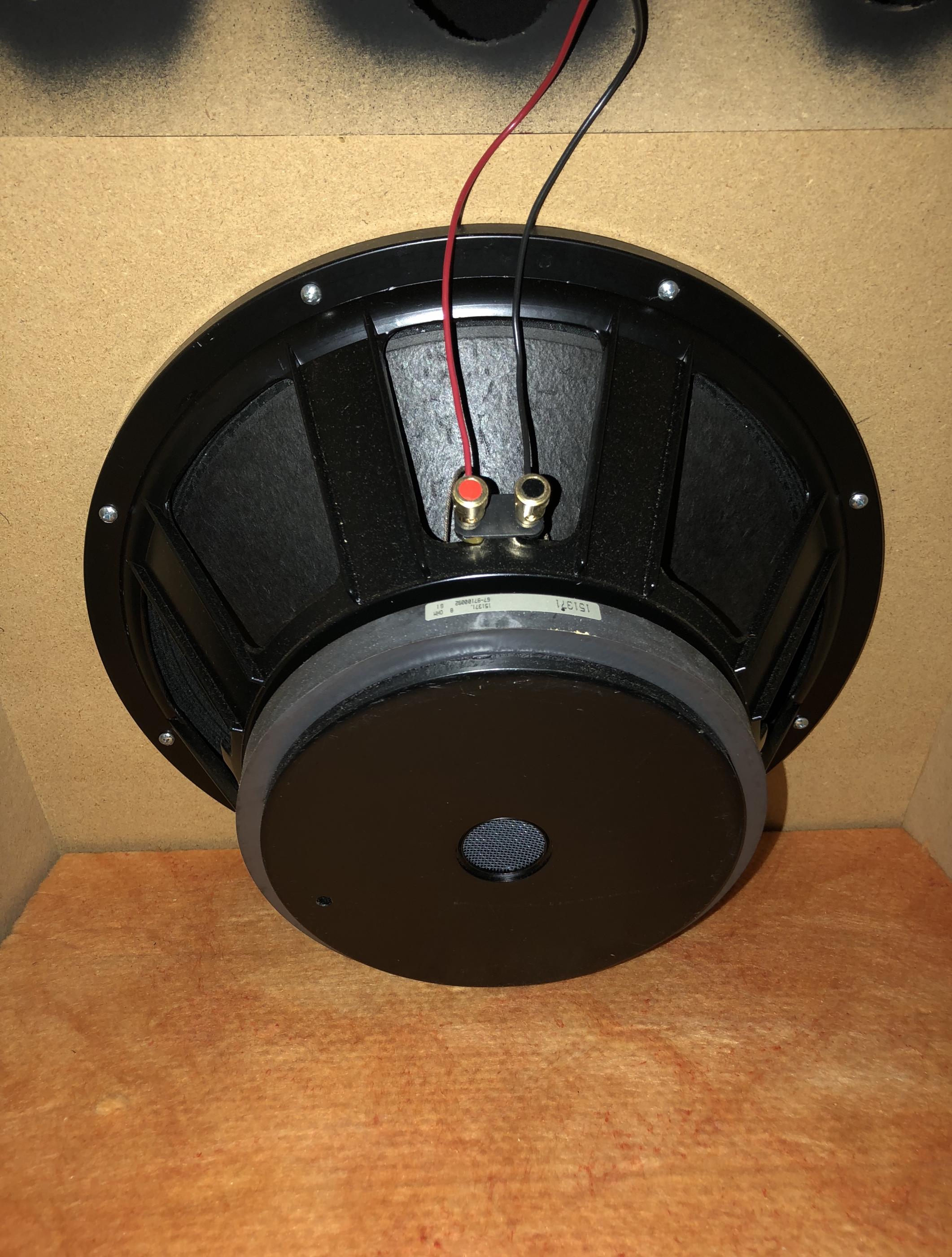

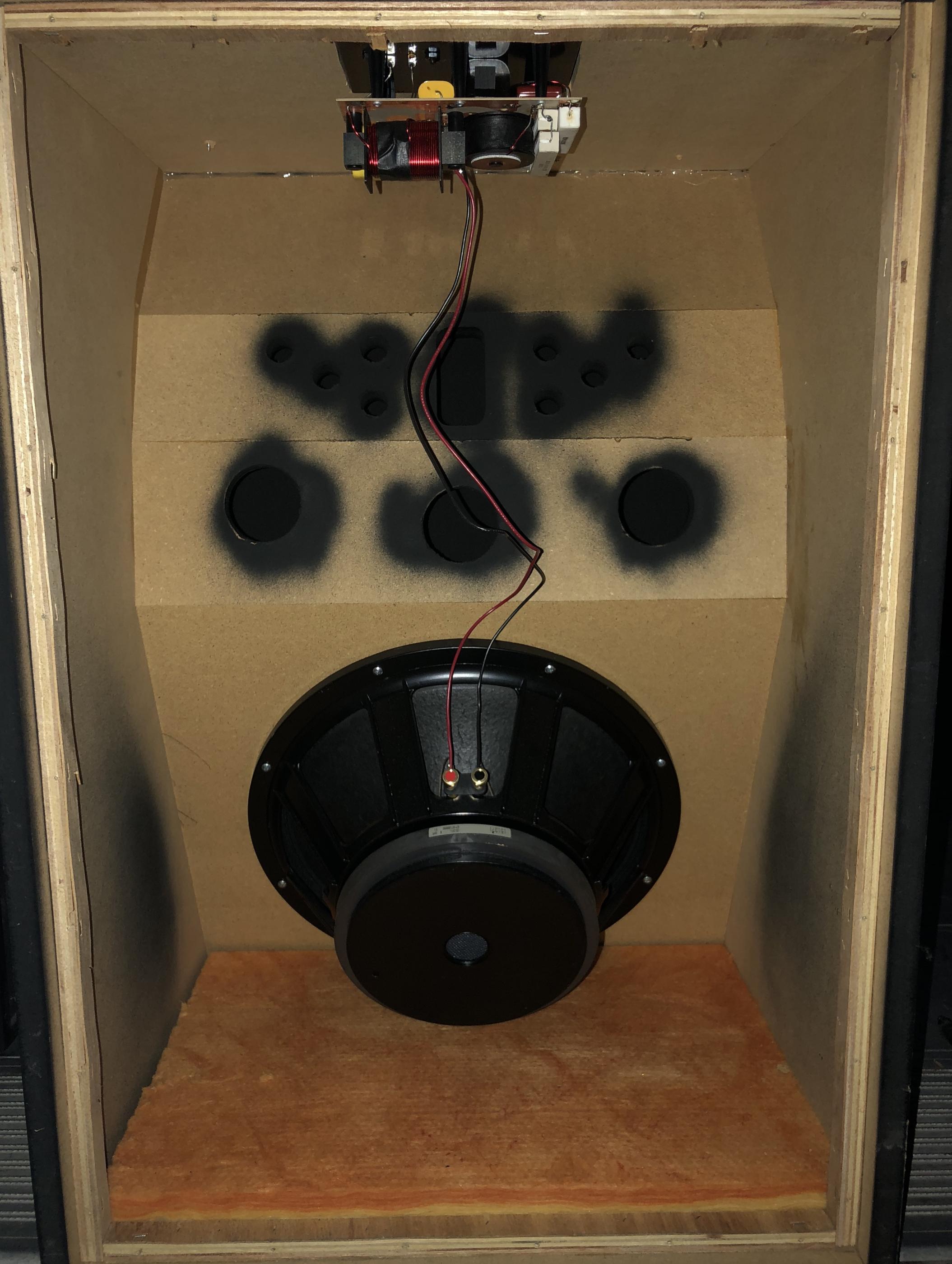

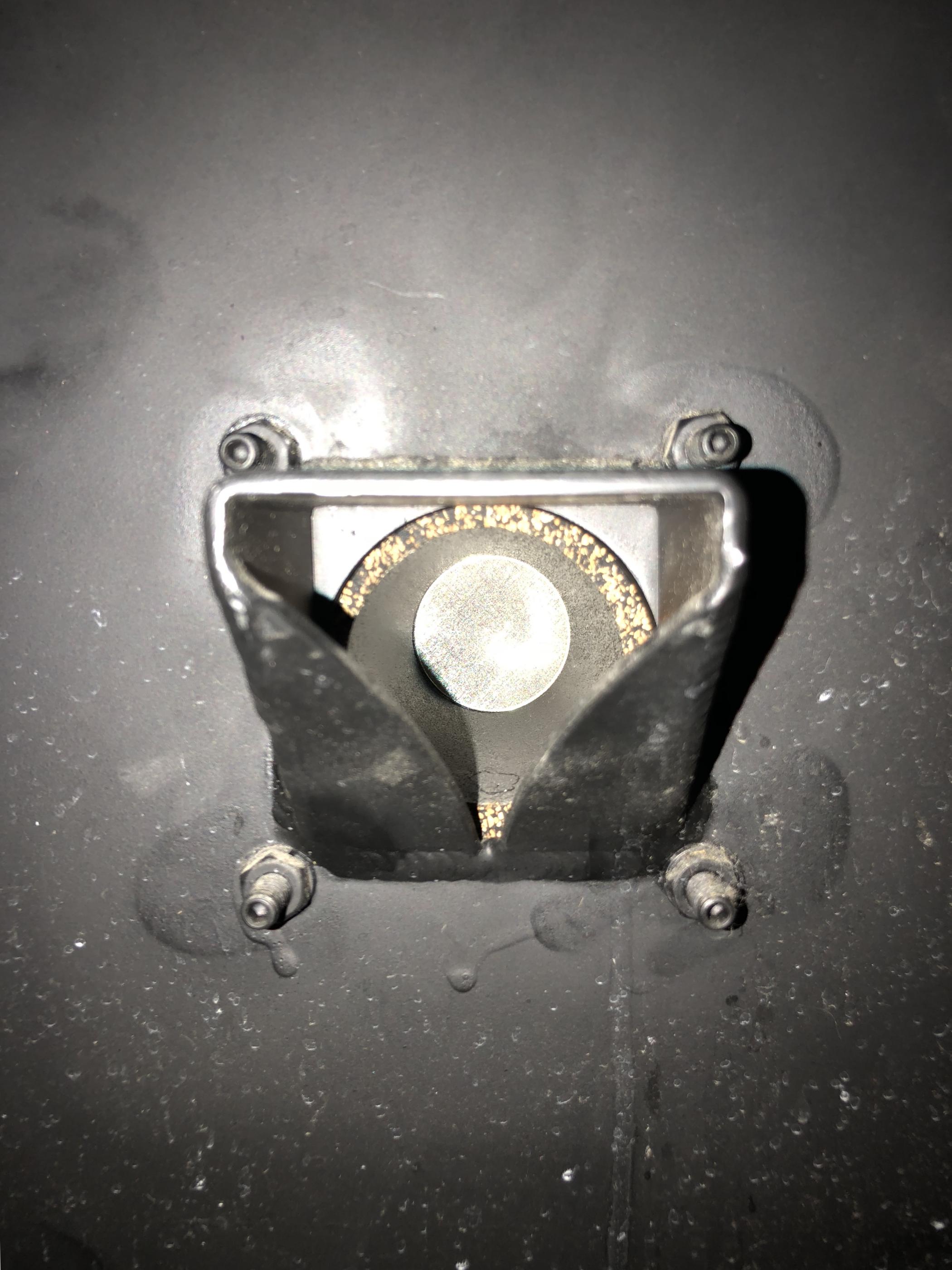

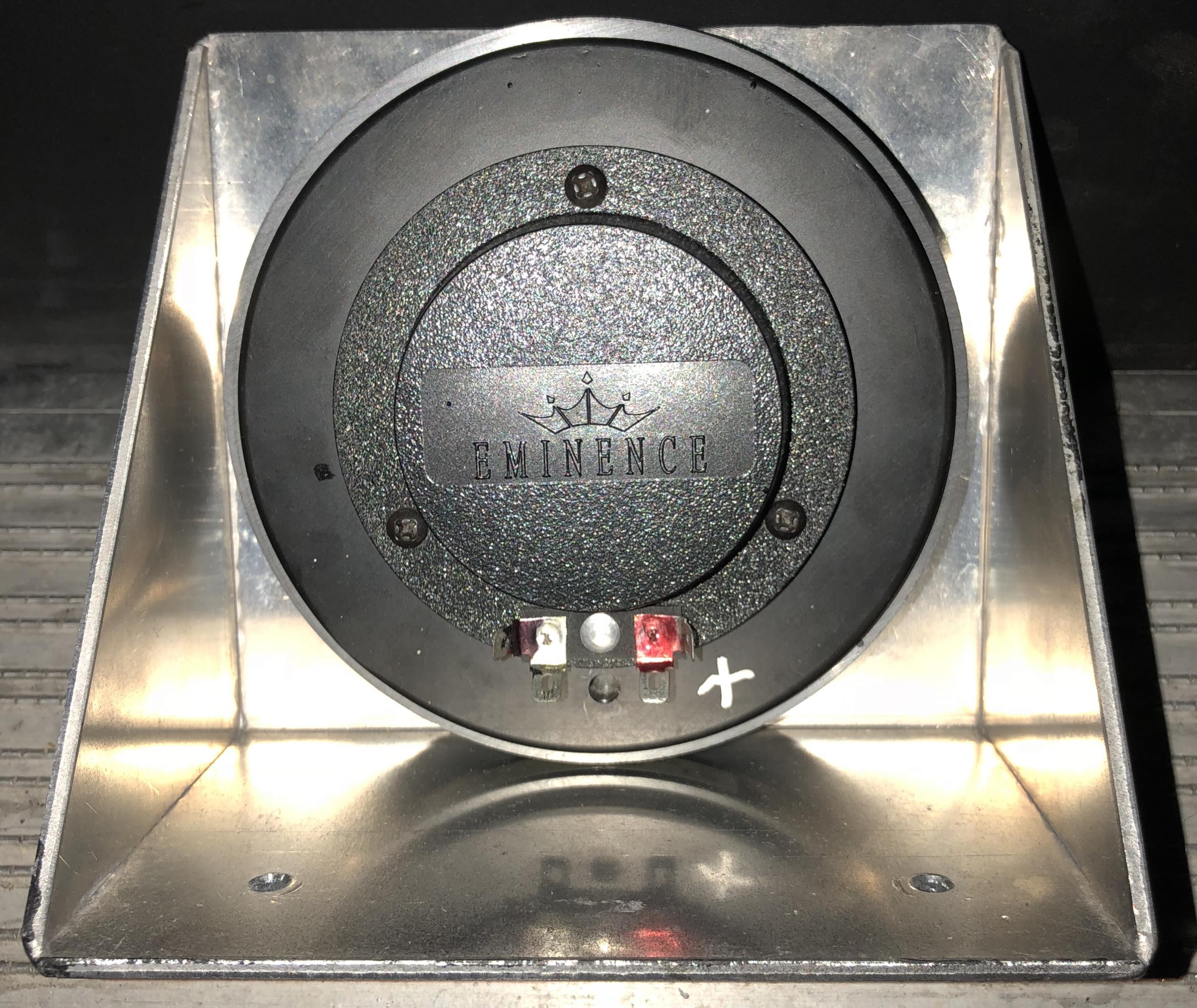

Picked them up yesterday. As well as several JBL 4675 and EV XEQ 504 Cinema LCR speakers. Don’t know when I’ll have a listen. Did open one up and took some photos before putting them in climate controlled storage. Sorry I didn’t have my micrometer calibers handy for measurements.
Here is what I found:
15” Eminence (OEM) Speaker
151371
1997
8 ohm
G1
Eminence Tweeter
02093
1997
8 ohm
G2
EV DH1A Compression driver
81256
1997
8 ohm
Tried several times to upload photos, but not working on this end. Will try again later.

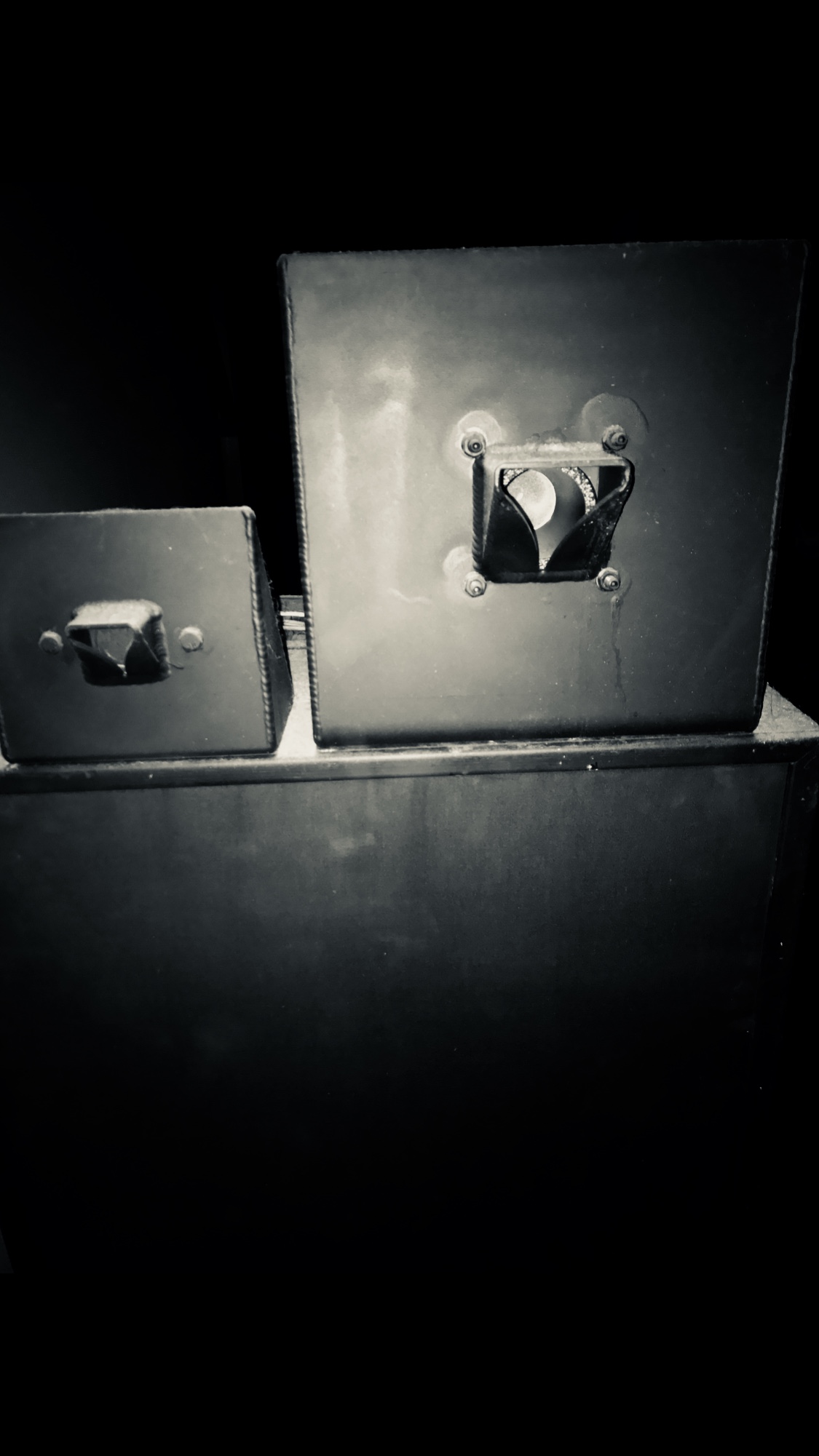

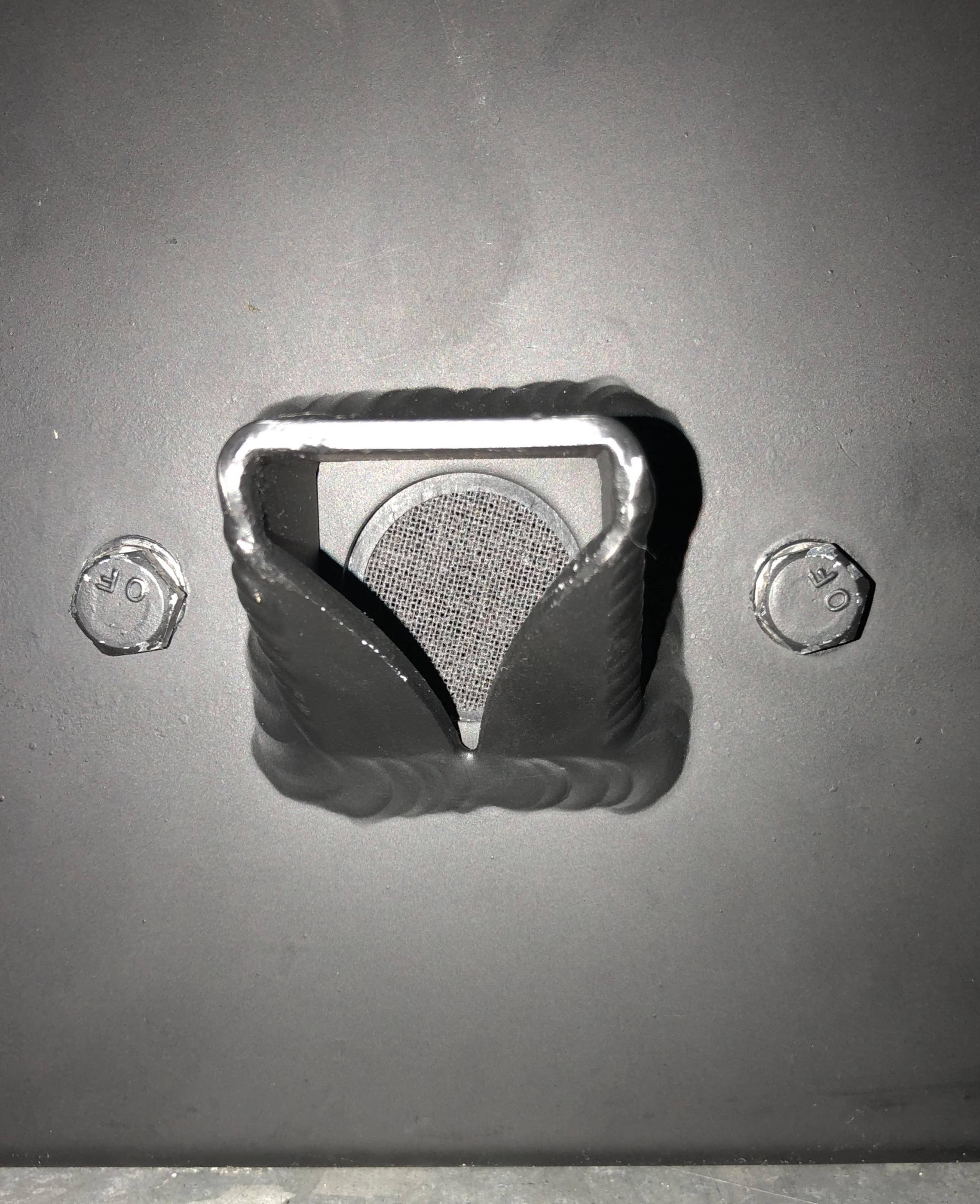

the larger klam lens w. DH1A is intriguing - AW must had thought it did something useful. (-not heard that driver - the factory diaphragm goes for $229)

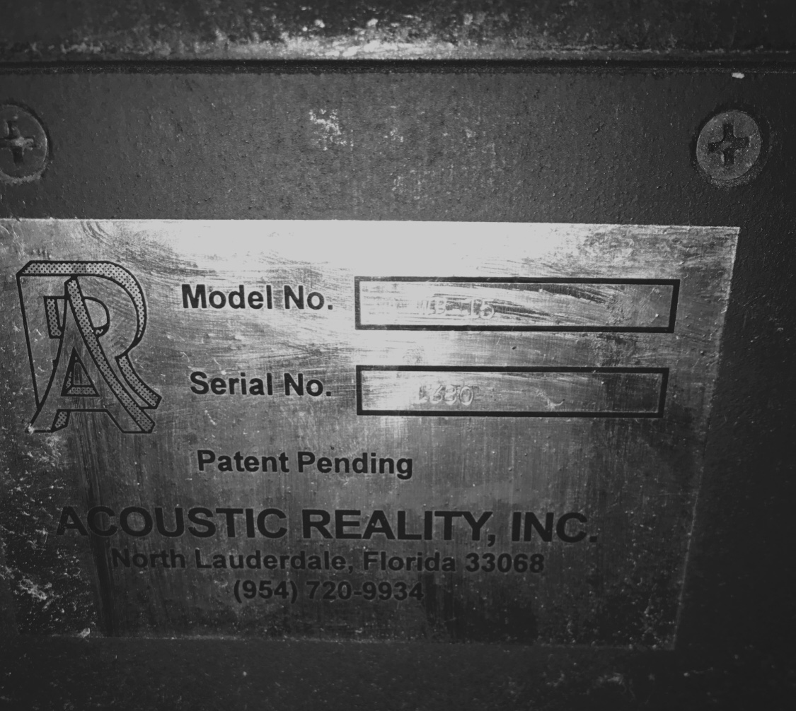

Acoustic Reality, Inc. Model WB 15

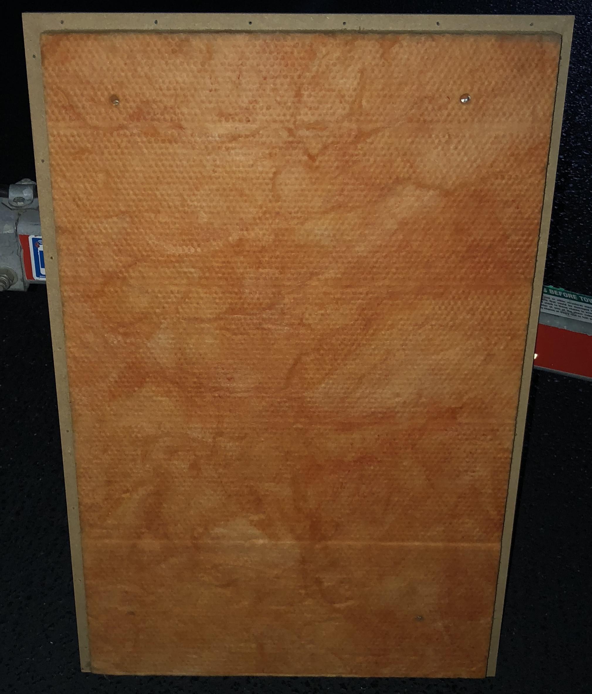

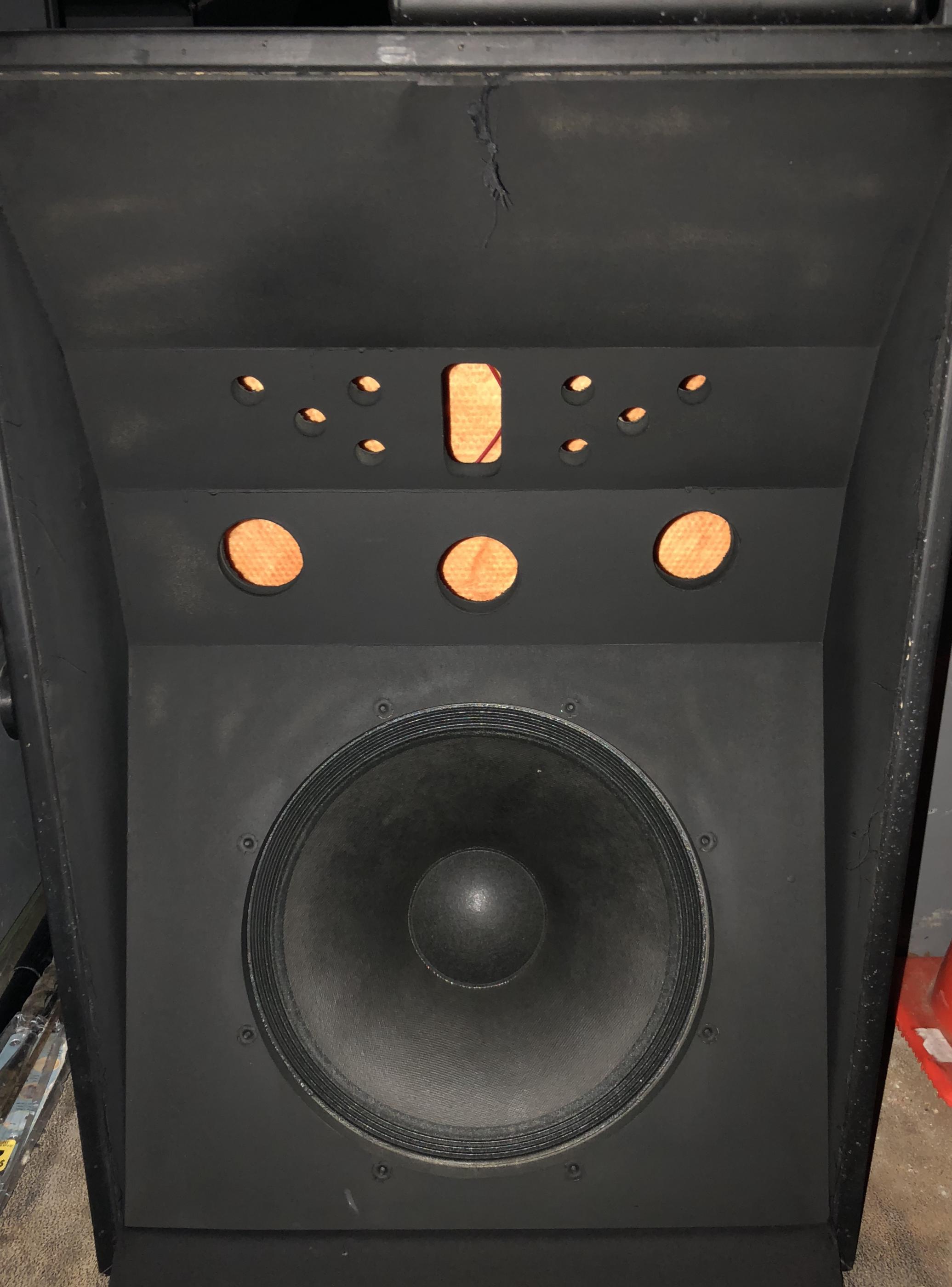

Photo upload worked this time. 🙂

very interesting - other than the lack of a K-front aperture, its built very close to John Karlson's X15 cabinet -but more like Fig.6 in proportions per Karlson's final "Acoustic Transducers" patent. Does it show any signs of once having an aperture up front?
It appears maybe the small mini-klam could fit in the central rectangular slot. -- On either side of that central hole are de-Q-ing vents as Karlson often used with X15. Likely that hole was also part of the vent as it appears there are terminals above the crossover which could feed either of those klam lens HF units.
You could add cleats to the front and rear parameter and add a K aperture plus do some bracing. Perhaps the Eminence woofer
Alan used sounded better sans K-aperture - ?
If you get time, it would be nice to have the outside dims plus enough inside dims to describe the baffle and 3 panel reflector
Where there any notes or verbal lore passed down with these speakers ?
