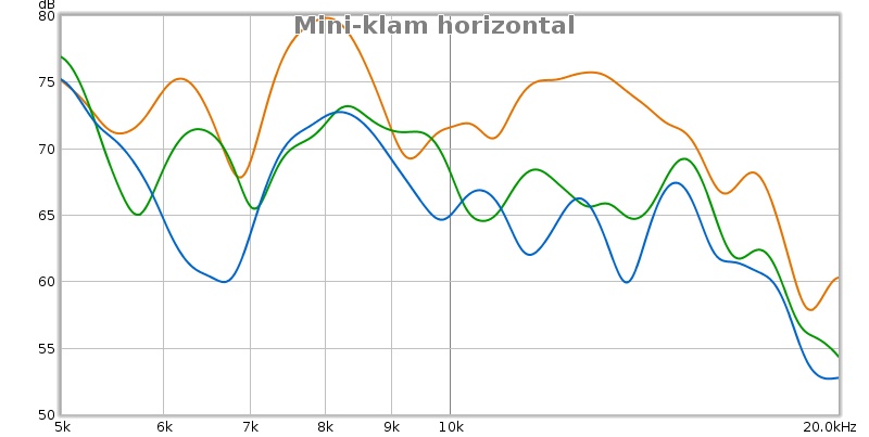

So the first impression is, that the mini-klam has wider dispersion and therefore lower sensitivity. I doubt I will have a chance to confirm that by measurements before end November. I tried the K-tube on both sides and as expected, they seem to work fine. I will maybe have a chance to listen louder tomorrow. In the horizontal plane, the sweet spot is quite large, but since the stack is high, the balance is changing in the vertical plane.

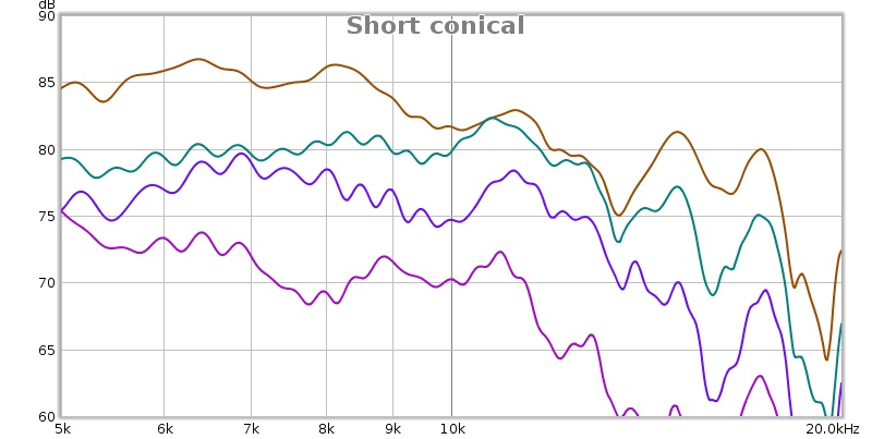

Some quick measurements. The flattest response (1/12 oct. smoothed) is perpendicular to the slot plane (kind of expected) and the dispersion is sort of OK, but nothing really amazing. For comparison, a cut off horn ca 5 cm deep, conical and around 60x40 degrees - and that one is not smoothed! Gating -1;3 on both. As I see it, the K-tubes are way better than the mini-klam (at least the one I made)

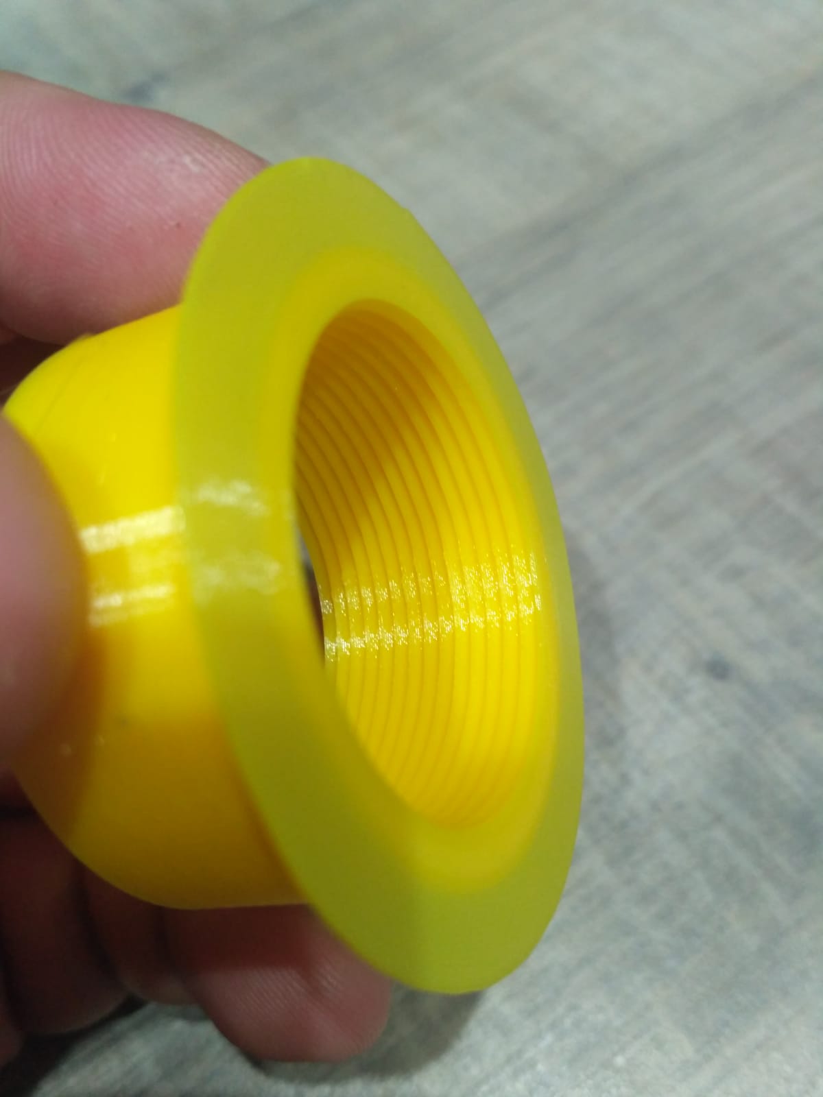

I'd still love to have a pair of those micro-klam K-lenses (how much for materials and hassle to print a pair?) - could not find a graph and the posterboard - tape construction probably was acoustically transparent in places
Freddi, the cost to print was less than 10 USD for a par if I remember correctly - and it is an easy print. The STL file used is attached to post 20 in this thread - I am pretty sure you can get it printed locally or by mail order in the US. And if you have any feedback, I can modify the model for you or make a new one. It is not too difficult.
thank you very much -- wonder how many hours would be involved to print a pair? - Ebay shows roughly $2 per hour fee from some sellers. I
m torn between this and the B&O lens set for 1" CD (- if there's any files available) Is there any particular plastic which is more suited than others for this kind of work ?
All the yellow prints were PLA, PETG is better but slightly more expensive. This is a very easy shape to print. I do not know the printing time, I buy the prints for roughly material cost x2. My estimate would be no more than 10 hours for the pair, since I got them printed over night.

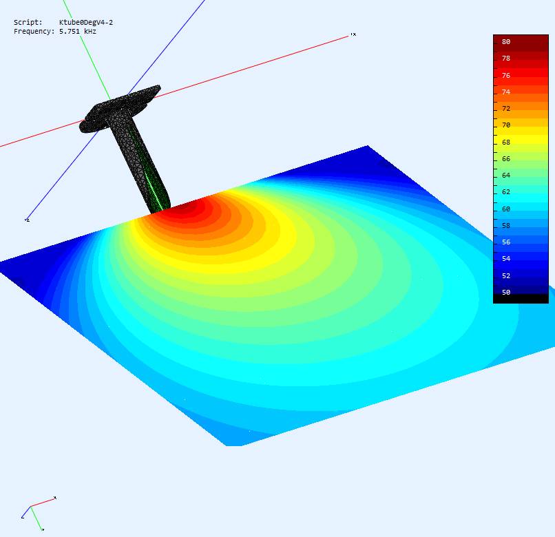

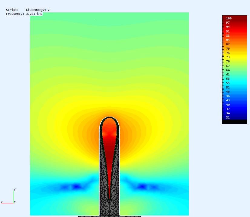

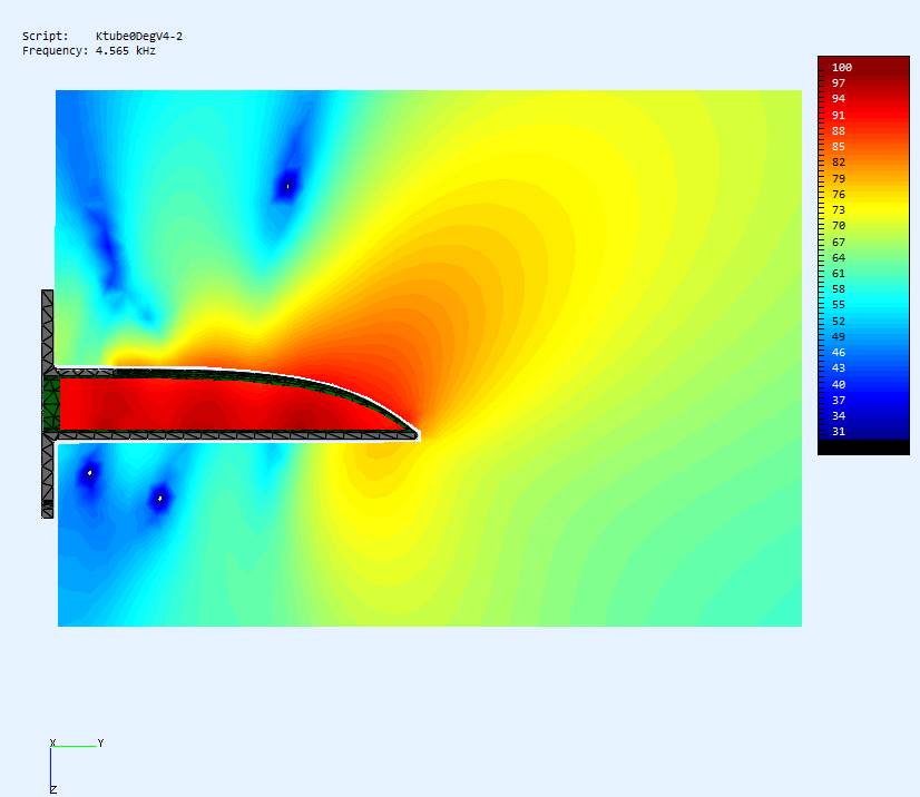

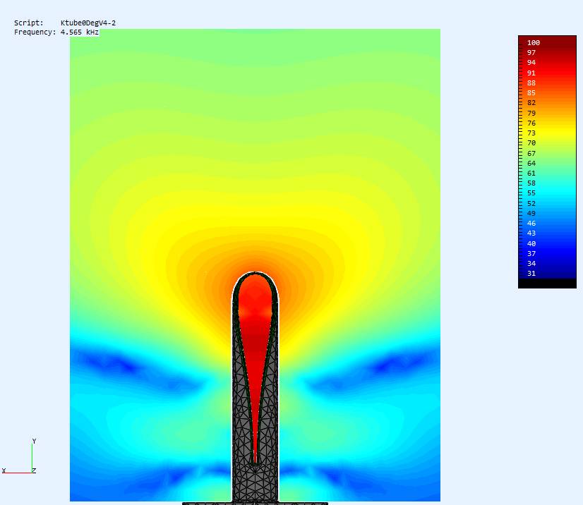

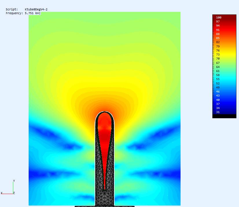

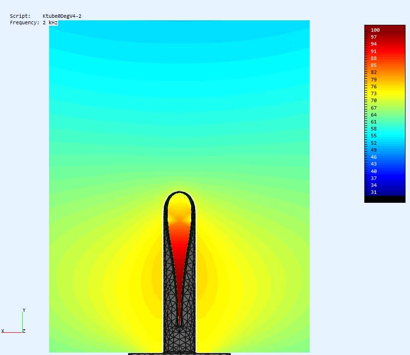

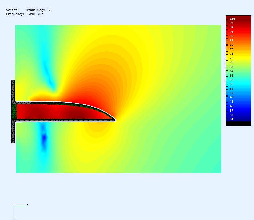

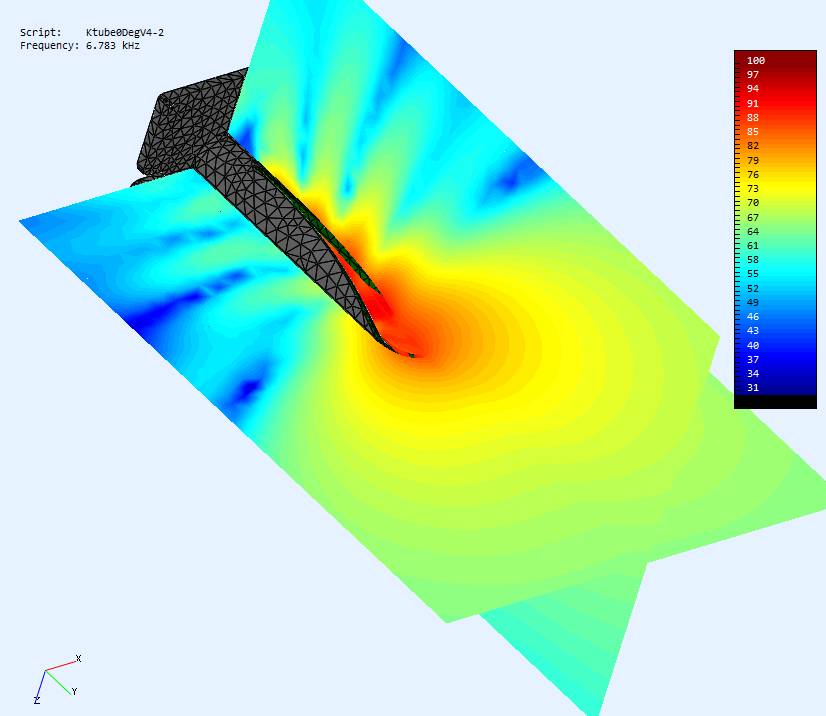

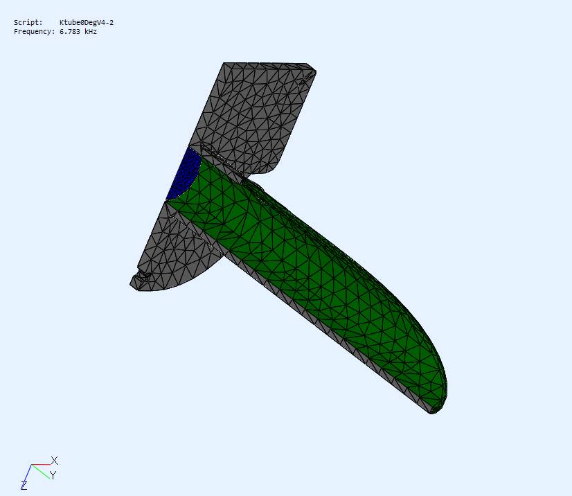

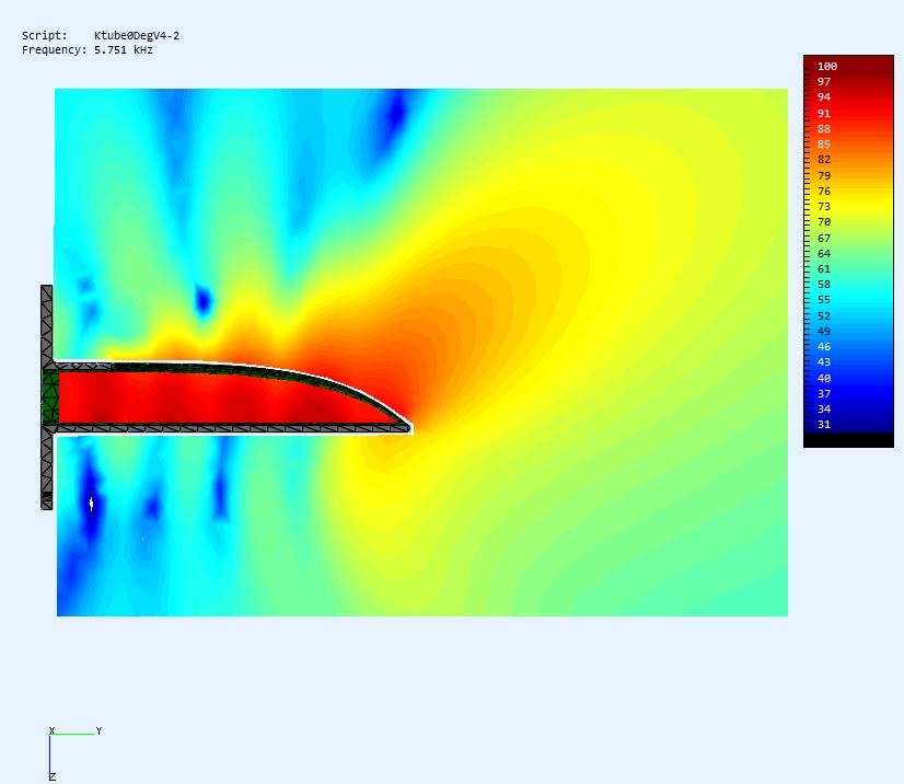

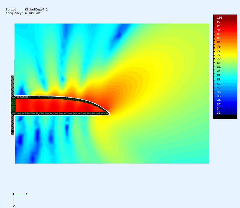

I was asked by @pelanj to create a ABEC BEM model of his V4 Ktube to see how it works. The tube was driven by an ideal membrane using constant/fixed acceleration (force).
Pics below show the model and its cross section. Normally all the measurements are made on axis, but after running the first sim, it may not be the best measurement position/angle. The tube projects at frequency dependent vertical angles which is why you see them pointing down at 45deg (-ish).
... and a collection of "on axis" observation fields.
The frequencies were chosen where the RadImp was near "1" so they exhibit similar efficiencies. The RadImp oscillates and coverges to "1" but not quickly. The vertical fields include a cross section of the tube to see whats happening inside.

.. More interesting is when you measure at 45deg (ish) like how I've seen them installed. Even though the vertical lobe shifts you can see in these 2 pics that the horizontal field looks like a well behaved source. The best observation angle (45deg ish) will change with frequency.
Don, thank you very much for this. Well done. Would it be possible to extract a polar map a la Geddes and the FR curve at say 10 deg steps out of the results? Like the script generated from MaBat's Ath4 program does?
Yes I can provide that. Polars would be centered on the listening axis. Probably -45deg vertical, like an installation.
