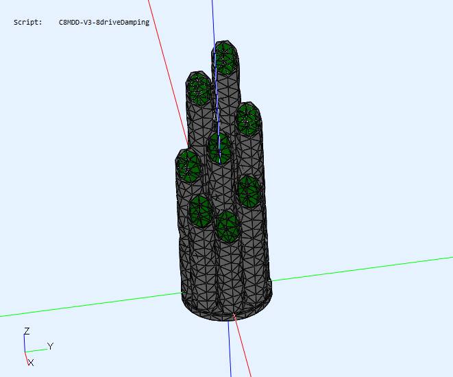

That is really awesome! Here are my measurements to compare. Zero is here the axis of the tube and below means the side with the slot, it was pointed with the slot down when I tested them (but it may be the opposite, I do not remember exactly...). So the simulation confirms, that the ripple is inherent to the tube.
Related to this topic, multiple tubes to reduce ripple ? There are some simulation results for smoothing out the ripple at:
MDD Multi Delays Diffraction (Multi TL, omnidirectional, single drive, ...)

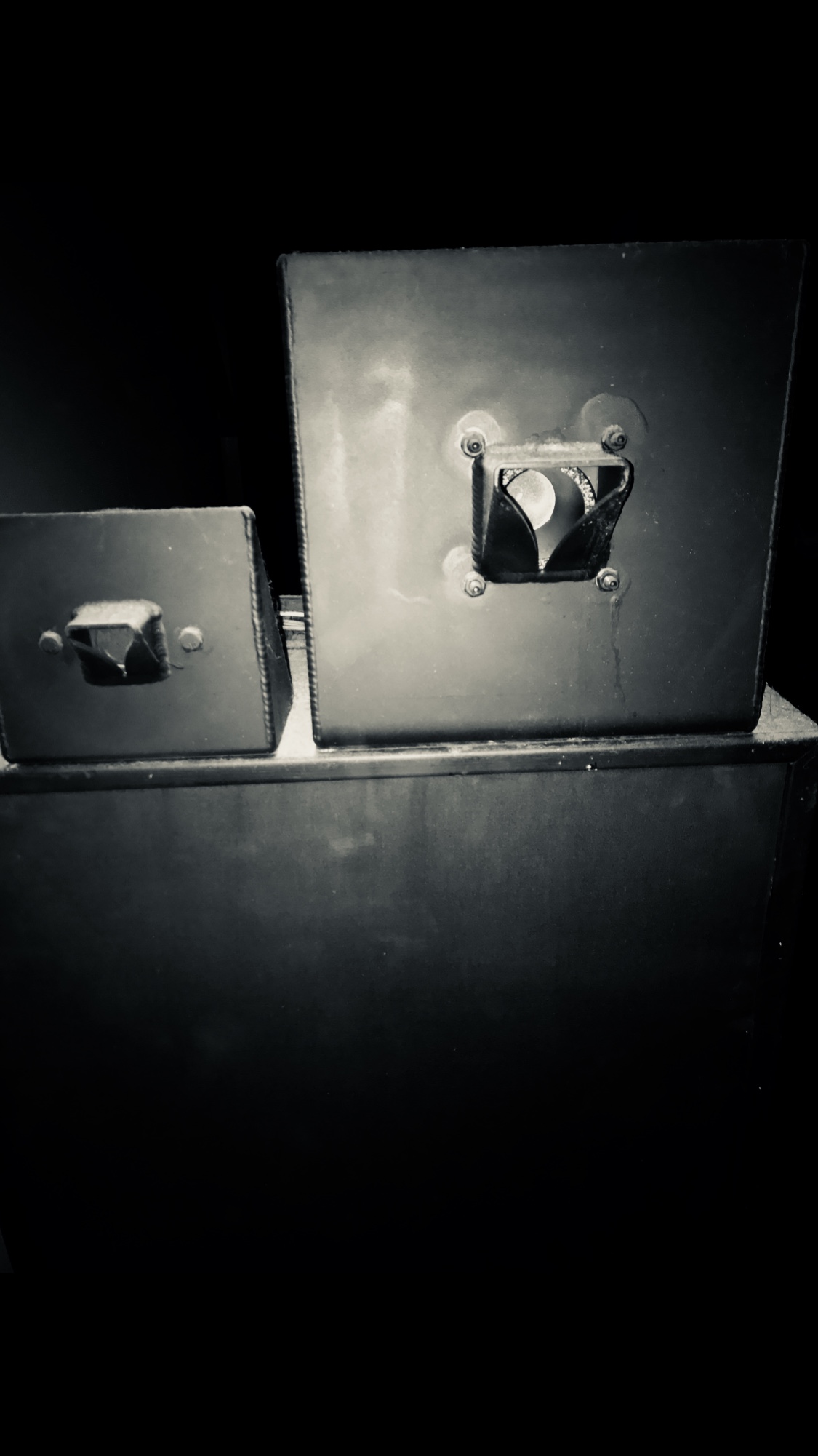

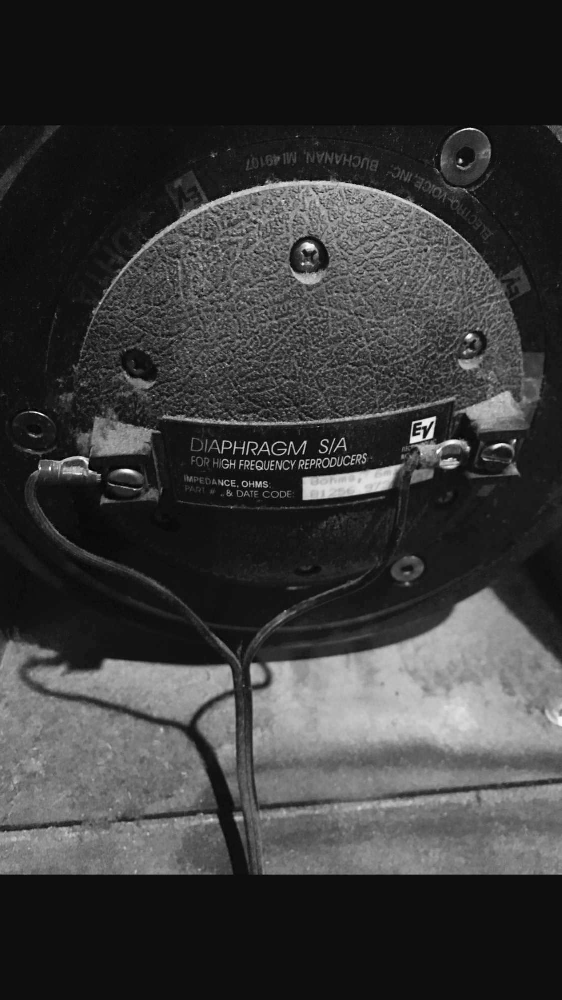

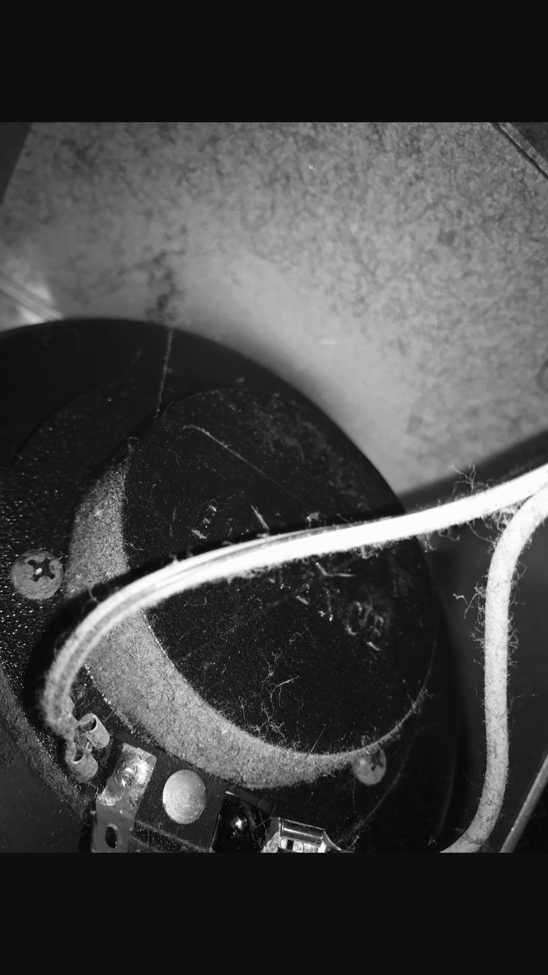

Hi Freddi, came across these and found you when researching them.
