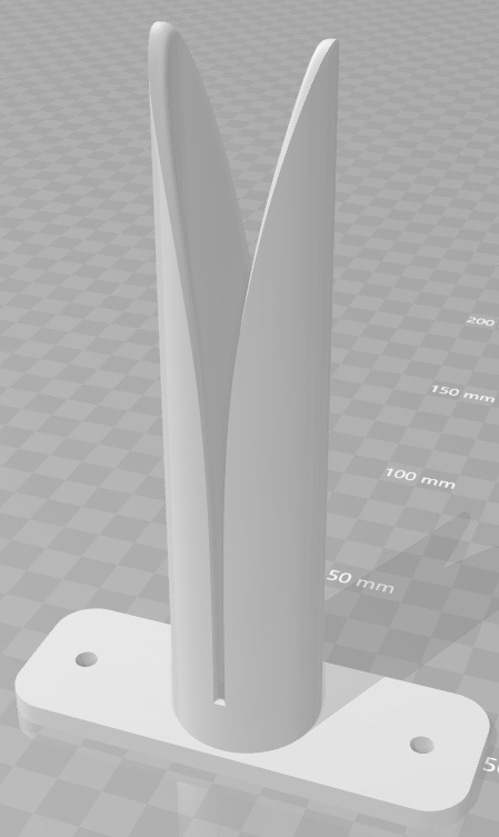

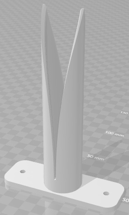

I tried to split the slot into two. I am not sure if this is correct, the expansion does not seem like that. I need to do the math properly and see the difference - my aim is exponentially expanding slot cut in half. This is an attempt to make the vertical pattern symmetrical and it is meant to be mounted behind a baffle with the CD mounting screws.

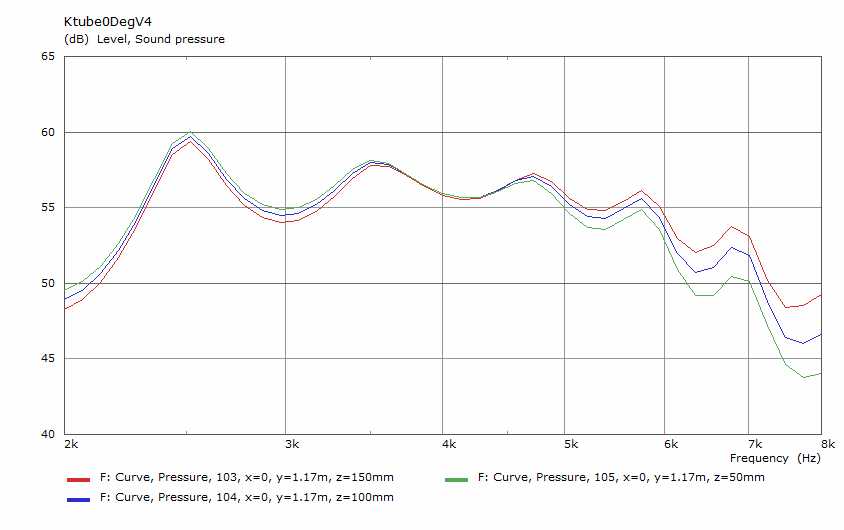

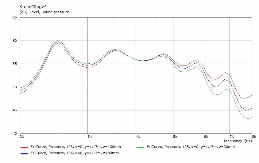

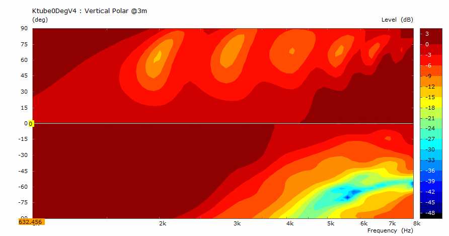

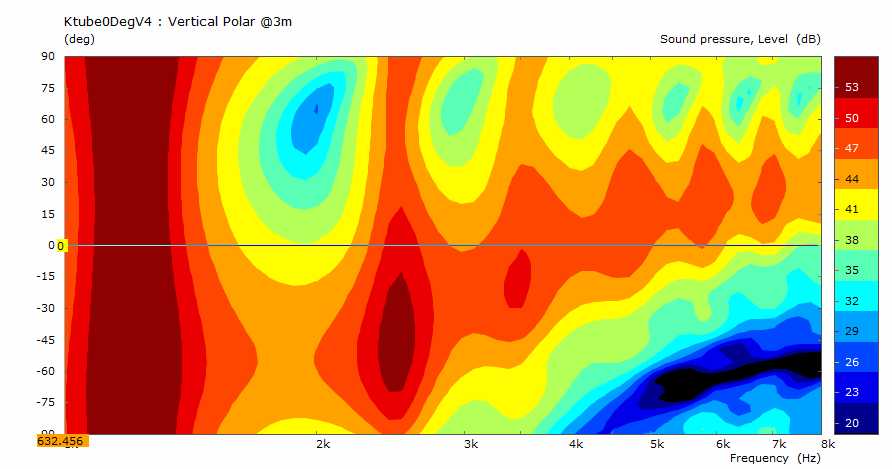

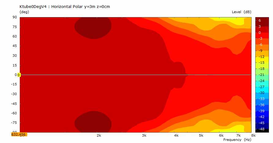

Don, thank you very much for this. Well done. Would it be possible to extract a polar map a la Geddes and the FR curve at say 10 deg steps out of the results? Like the script generated from MaBat's Ath4 program does?
I did both 30deg (first 3 pics) and 45deg tilts (next 3 pics).
SPL curves are at 1m and the polars are at 3m normalized. You can see the vertical polar rising with freq and asymmetric from the slot. The horizontals are very wide which is expected from obs fields.
The last pic is the vertical without normalization (raw) which shows this better IMO.

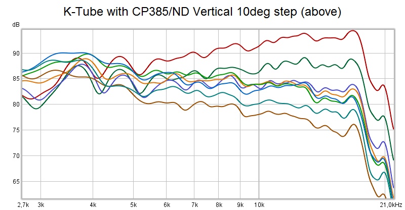

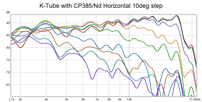

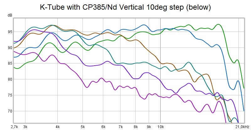

That is really awesome! Here are my measurements to compare. Zero is here the axis of the tube and below means the side with the slot, it was pointed with the slot down when I tested them (but it may be the opposite, I do not remember exactly...). So the simulation confirms, that the ripple is inherent to the tube.
Edit: Dual slot tube picture attached, now made properly. This one will be printed🙂
Edit2: In these measurements, the rotating point was not exactly at the end of the tube.

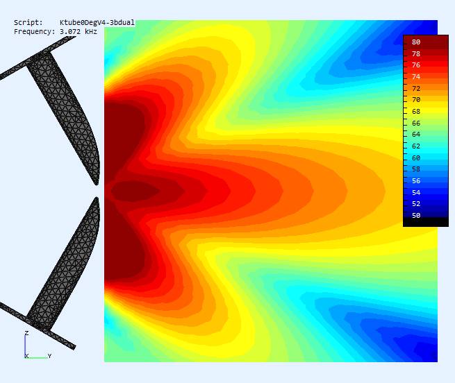

Great information, Freddi, thanks! Now this spread resonance triggered another though - an MDD tweeter tube.
an MMD K-tube arrangement would be an interesting experiment. btw, K-guy Carl Neuser mentioned that Ted Nugent used two Transylvania Power K-tubes in a guitar rig many years ago - roughly like so:

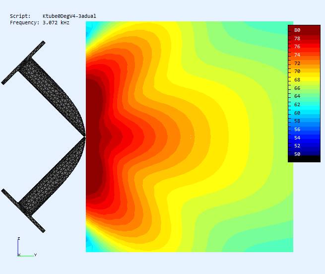

That's an interesting idea @freddi. Fixing the asymmetry.
The first pic has tubes angled 45deg nearly touching and the second has tubes angled 60deg with a space. Both are at 3Khz to see the effect.
Very interesting! For combining inside a MF horn, two shorter straight tubes would work better than just one bent. There are some pictures here: https://www.diyaudio.com/forums/mul...exit-driver-hf-unit-source-3.html#post6040929 and in post 49 of that thread. I might try some slight tapering in the first part that goes through the horn wall to make the tube slimmer, the length would be so that the tips almost touch and again, a half ellipse slot. Two HF drivers will be a better match for the insanely sensitive JBL2445. The disadvantage is I will need 4 in total. Maybe 4 DE7 or DE5 would work well with slimmer 0.75" or 0.5" ID tubes.

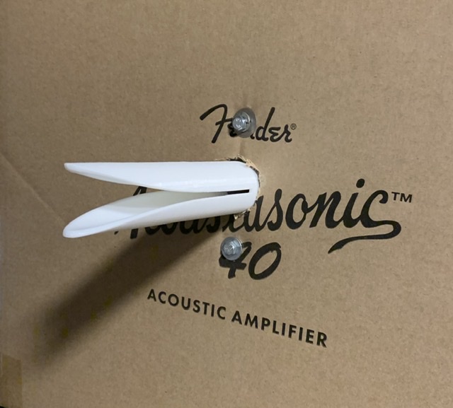

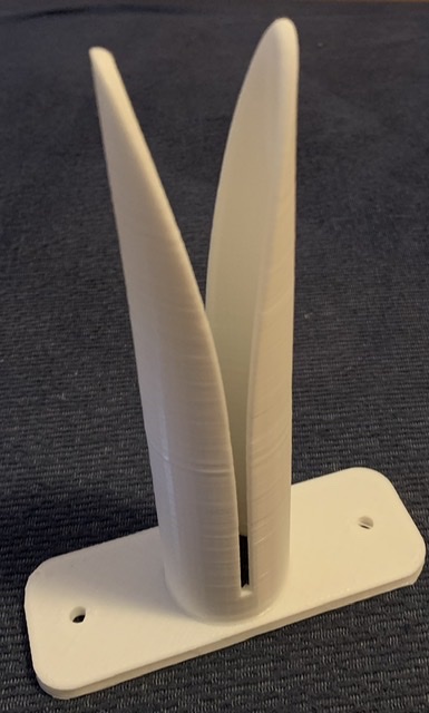

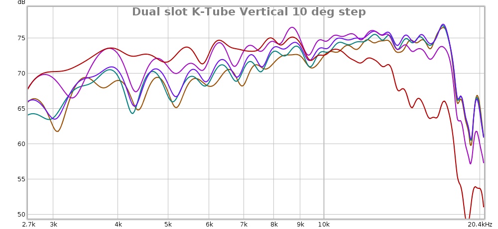

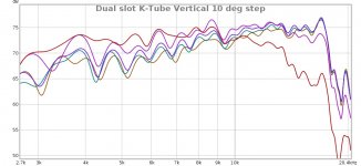

The dual slot tube is printed and ready for some measurements🙂 It is meant to be placed from the backside of the baffle held through the baffle with CD mounting screws.
Edit: I am looking for a way to share the designs effectively, most probably on Thingiverse, if they sort out the performance problems.

- looking forwards to what a dual slot tube does (Moray James likes that type a lot - I've only heard the regular, asymmetric type - which sounds really good with drum cymbals including hi-hat)

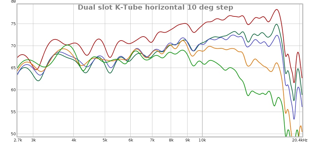

So here are some measurements with the dual slot tube on a paper baffle. The slot is oriented horizontally. The measurements show that it should most probably be oriented with the slot vertically while actually in use. As all my measurements, please take them with a grain of salt. I plan to set up another room for the measurements or do the measurements outside, so that will hopefully improve one day. But all in all, I think this might make an interesting waveguide for a tweeter, 3 kHz up.
Moray James has been running his double slotted K-tubes with slots on "top/bottom" for some years - great to see measurements - love to hear them - also love to hear two tubes arranged tip to tip for sound quality and for power handling with lower thermal and excursion issues.
