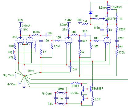

Your class D amp input impedance is 10K-22K. 3A5 plate output is not good enough to drive it properly. Same is true for 01A.

You can use a mu follower CCS cascade or Gyrator load to drive that impedance. Here's an example of a gyrator using the mu follower output.

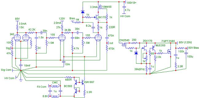

OK, stupid question time. The input to the CCS shown in that schematic has a bias applied - where is that coming from?

It's not entirely obvious, but there are two versions of the shunt supply for the amp. One adjusted for an output at 120 volts (second stage), the other 80 volts (input stage). They are shared for left and right. The bias is tapped from the PS 80 volt output.

You can use cascode CCS from K&K

You can use 10K:600 ohms line transformer in parafeed fashion. Easy and good sounding.

I put together a simple CCS using a 10m45s supplying 4mA to the plate - this gave quite a jump in sound quality..... which of course has me wondering what a cascode one would sound like!

Fran I recommend you to use the Moglia's hybrid mu-follower Hybrid Mu-follower (aka Gyrator) Rev08 PCB Update – Bartola(R) Valves
Felipe is right about Ale's Anode-Load - this is a very good implementation for horizontal load lines.
And with an anode current of 4mA, there is another reason to use it - it's difficult to build a cascoded depletion FET CCS that will work well at 4mA. It would need dissimilar FETs, with the lower part having an Idss much lower than the upper part.
