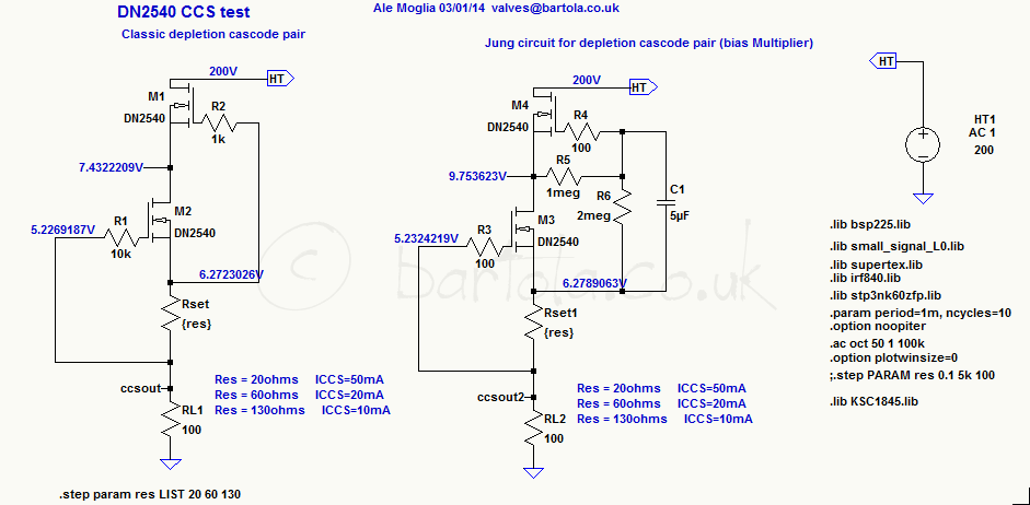

3a5 output stage advice
The IXTP08N100D2 is a good choice for the upper part; but a part with a lower IDSS would be needed below, to reach low currents.
For the lower part, the 10M45 might work (the data for it is not sufficient to tell); the DN2540 or DN2530 would be good, even in the TO-92 outline.
Why not implement plate choke? I have ordered from AlieX 1380H (up to 30mA) choke. It has 5.4K ohm. For 3A5, good operating point is 100V/10mA with about ~-2.5V bias.
So, with B+ of 150V on one side of plate choke and the other on plate, you will have about 100V on plate. I recommend fixed bias.

Attached schematic.
M2 & M3 can be SK170

I'll probably go for Ale's boards I'd imagine.
In the meantime, I didn't factor in the parallel halves, so yes, the CCS is now set for 4mA. But it is not a big job to bring that up to 8mA. Its at a friends house just at the moment, but should have it back in a week or so. When I get it back, I'll adjust and report back.
