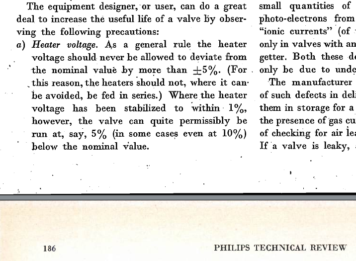

With oxide coated filaments or cathodes, the filament voltage has a big influence on the lifetime of the tube. For the best lifetime, don't exceed the nominal voltage - the sub-surface barium will be burned up at a wastefully high rate, and the supply of it will be exhausted much faster. But you can run slightly low (-5%) for temporary events, like low battery.
Thoriated tungsten filaments like the 10Y and 01A can use from 5 or 10% lower filament voltage, if the microphony is improved, but gm will often be lower, and so the sound is not guaranteed to be the same.
The Philips Technical Review had somewhat to say about lifetime and heating voltages, as applied to oxide cathodes - see attached. The +/- 5% is a concession to the reality of mains line-voltage tolerances (which are more like ±10% nowadays) - it is not as desirable (lifetime-wise) as the 1% stabilized voltage method they mention - which certainly gives longer life.

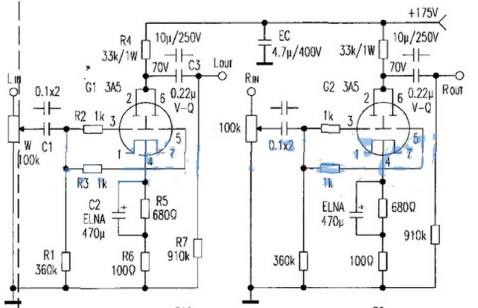

I would like to get rid of the batteries if I could - although they last a long time, they still will need recharging. So if you have a good value, worthwhile recommendation for a replacement that would be great. I find the original PCB (circuit attached here again) useful and would rather not start on a whole new build if possible. I am also open to any improvements you might suggest - although the stage is now silent, if there is something extra to be wrung from it using a regulated B+ I am happy to look at that too.
Fran I will use a simple cascode CCS with a couple of DN2540 in place of resistor anode load and change the OP as minhaj suggested for 105V 10mA so you have a better idea what's the potential of the tube, if you like it you will have time to improve the rest. I use with a lot of satisfaction Rod Coleman filaments regs. & Ale Moglia hybrid mu-follower.
1. Shifting OP to more linear region
2. Filament bias
3. Omitting input cap (if no dc from source)
4. Parafeed config
5. Choke/CCS/Gyrator loaded plates
6. Choke/pseudo choke input PS
7. Coleman filament PS
Pls check this link for better op and filament bias
Filament Bias: a practical example with 3A5 DHT – Bartola(R) Valves
Regards

Following the recommendations above, I contacted Rod Coleman who kindly supplied a pair of filament supplies. I got these built and installed and also implemented filament bias as per the Bartola site linked above. There is still some work that can be done - like removing the input cap. The stage is very quiet indeed, and I think seems a little more dynamic than it was before. I will build a CCS for the anode, but I'm waiting in parts for that, so it will be a little bit before I get to it.
So a success thanks to your advice so far - thank you for the help.
Fran
Yes, there is a improvement in removing that capacitor - seems like just a tad more immediacy. The promise I heard in this back when just the kit from Aliexpress is really starting to shine through now, I do think this is a keeper alright and I'm glad I went for the improvements you recommended @minhaj and others. I'll draw up a schematic as it stands and post it soon.
And, the other night I bought a pair of 01A to try at some point in the future.
