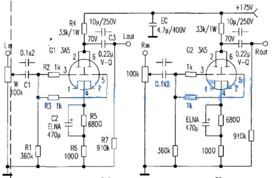

Hi all,

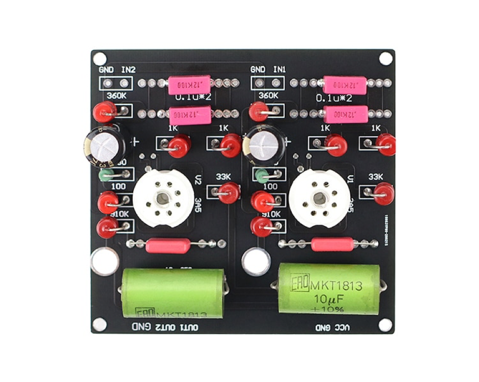

I'm looking for a little advice on the implementation of a cheap 3a5 board commonly available on Aliexpress. The pics below show the board which I guess many of you have seen, and I've included the schematic as well. I've hooked it up on the output of a DAC, and it performs "fine" but as you'd expect there is hum etc.
Not having any experience with DHT valves, in particular, I'd like some advice on heater wiring. So you can wire the heater in parallel or series, either 1.4/2.8V and 110/220mA current draw. There is cathode bias on this board, so I can't see how I can do what others advise in some other 3a5 threads, and connect the DC 1.4v across pins 1+7 and 4 and connect one end to ground. Obviously I'm missing something here, but having read around a bit I'm not any wiser!!
Is it as simple as leaving the heater supply floating? Any other advice to play with this thing?
Many thanks in advance for any help.

I have a very basic LM2596 module pressed into service with an inductor and cap on the output (as per the datasheet). Its not the quietest supply I'm sure, but gives the 1.4V and given that the current is low its not pushed too hard.
I suppose my question though is more about what way to wire the filaments - either go with series or parallel and floating or grounded. If grounded, then where to ground.
@astouffer - sorry I misread your question there.
No, I don't mean wiring both tubes in series - I mean within a single tube. So, you can bring one side of the 1.4V supply to pin 4 (ie above the cathode resistor) and the other side to pins 1+7.... or you can bring 2.8V to pins 1 and 7. In either case you are kinda floating the supply I suppose.
Then do the same thing on the other tube.
-fran, I have built 3a5 pre as transformer (parafeed) output with 2.5x gain. It gives me excellent SQ, better than any of the half a dozen pre I tried earlier. In my opinion you need extremely good PS for anode and filament supply. And yes you need separate winding for each filament.
According to the attached schematic the PCB is configured for series filament (for each tube) so you need 2.8 volt supply not 1.4 volt. Supply will be floating.
Regards
@minhaj - yes, and I know in this case I have a fairly basic CLCRC B+ supply, and the filament supply is also basic. I might try pressing a LT3045 into use for the filament, it should have pretty good noise rejection, and can handle the current I think.
So when I wire up the existing filament supply, and leave it floating I get quite a bit of buzz - all of the voltages etc work out as per the schematic which is reassuring. Another suggestion I saw was to take out the cathode bias and put some LEDs in there instead - aiming for a forward voltage matching the stock circuit.

thank you -fran. For current capability please check LT3045 data sheet. I use voltage reg +current reg for filament supply and only then it works.

So I did some more experiments. I had only 1 x LT3042 reg so I did one channel with that, and another with the LM2596 switcher. The switcher channel was much noisier. So the LT3042 type regs could work well.
@minhaj - your post gave me another idea. I took 4 D-cells I had here, hooked them up with a switch and used them. Its silent as the grave :)
So despite hating messing with batteries and charging them etc, I think the easiest solution here is just that - we'll see how long they last. They were made for batteries, and maybe everything else is just shoehorning a solution where it don't fit so easy.

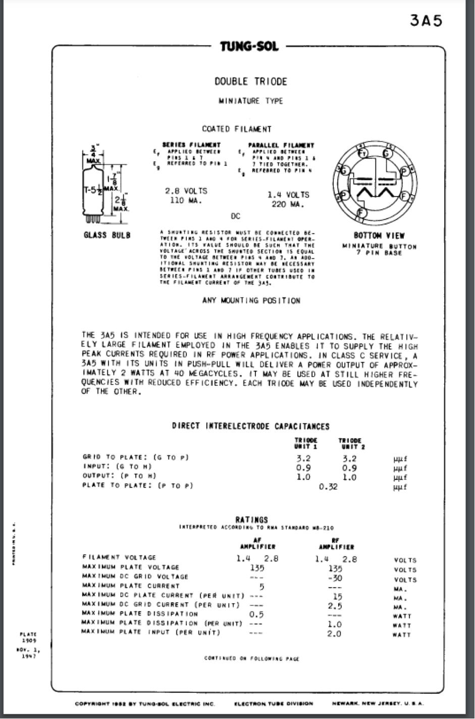

Thinking of the batteries still - what is the max heater voltage you think the 3a5 can take? I'm wondering about rechargeables, and even D-cells, tend to be around 1.5-1.6V, which means the tube sees a little over voltage.
''what is the max heater voltage you think the 3a5 can take?"
You always should check data sheet for spec. If data sheet not available then yes you may ask people for this.
D-cell is always 1.5 volt but if you measure it unloaded you will get 1.6volt+. Rechargeable AA battery is always 1.2 volt.
Regards
@minhaj - I understand your point, yes, the datasheet is widely available, but I was asking more for personal experience. For example something along the lines of "I use them all the time with LiFePO4 batteries which are charged to 3.5V with no apparent issues".... or the opposite as the case may be. The datasheet says 1.4 or 2.8V with no other tolerance mentioned.
As a further example, I have seen it written a few times that these valves function very well on starved filament supplies (mimicking a discharged battery) - again this is not mentioned anywhere on a datasheet.
Never mind starving the filament depends on total pd used. These things are for experience builders. I think you should stick with data sheet spec for now. Moreover 5% less current is okay if op is 75%-80% of total pd. With battery supply how you do that?
