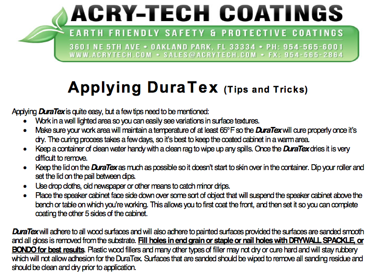

Dura-Tex and drywall mud
The thing that I really like about Dura-Tex is that they recommend using regular drywall mud to fill in screw heads and any little imperfection.
I would have not believed it, but the instructions say to NOT use Bondo, water putty, epoxy or other wood fillers.
The instructions say the Dura-Tex will not stick to these fillers.
Then sand, of course repeat, and then just paint over the whole thing with Dura-Tex.
I painted a sub with Dura-Tex, right over sanded drywall mud and it has lasted 9 months now without any cracks at all.
And I really flog that cabinet.
I just finished another set of cabinets and primed them with "Kilz" before coating with Dura_Tex.
That saves allot of the more expensive Dura-Tex.
I had the paint guys at Lowes put some Black coloring in the Kilz so it covered up with the black Dura-Tex easier.

Dave,The thing that I really like about Dura-Tex is that they recommend using regular drywall mud to fill in screw heads and any little imperfection.
The instructions just downloaded say use drywall spackle or Bondo for best results, avoid rubbery fillers.
Black Kilz, good tip!
Art

Dave,
Art
That's really weird to get complete opposite suggestions from the manufacturer. The other data sheet I read said avoid bondo.
