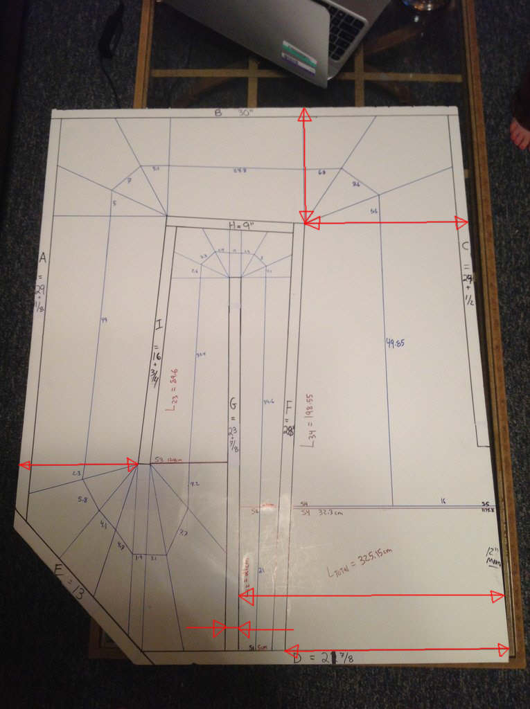

Here is the updated sketch / layout....
A. 29 1/8" x 13.5"
B. 30" x 13.5"
C. 24 1/2" x 13.5" (subject to change with the keystone / different mouth size)
D. 21 7/8" x 13.5"
E. 13" x 13.5"
F. 28" x 13.5"
G. 23 7/8" x 13.5"
H. 9" x 13.5"
I. 16 3/4" x 13.5"
J/k. (Side Panels) 30" x 38"
Those dimms are all accurate, that's what I went by.
Board G is connected to board D at a right angle.
I H and F are all connected at right angles as well.
Board E (for caster mounting) is at a 45 deg angle with boards A and D.
All miter cuts on those boards, E, A and D are 45deg.
The distance between boards G and F at the base is 5cm. (S1)
S2 is 6.2cm.
Driver height is centered at 21cm from s1
Basically I need to give you the positioning of boards G and F relative to the front or rear of the cabinet.

I could give it a stab at drawing PAL12 in AutoCAD, but I would need the additional dimensions indicated in the attached picture, and I don't know when I'll be able to get to it. Would 23/32"[18.25mm] be OK for the material? Maybe epa or Xoc1 can take get to it faster than I can.

I think that L34 should to be 32 and not 16 in your Hornresp simulation, distance from the back of the diver cone.
Okay so the wood measured from 18.2-18.42mm. I think it's safe to just assume 18mm ply. I wrote 18.4mm thickness in the drawing.
All the dims are written in black, just as the red lines are on the drawing in post 108.
The 33.8cm and the 40.7cm are measured along the top edge of panel D.
Just in case you can't read the numbers I wrote down, staring from above the angled caster board (E) the numbers are, going clockwise,
19cm
23.8cm
29cm
40.7cm
33.8cm
Wood thickness is 18.4mm. Lets assume 18mm.
