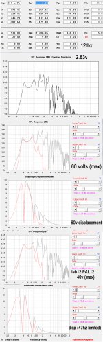

Could you, please, post your simulation for the PAL12 with the 12tbx100 driver?
Sine, do you still have the sim?
I mean... all I did was take the original pal 12 sim and input the 12tbx parameters in. Ive since deleted it.. but it will only take like 5 mins to do it over again. got to run over to a friends real quick, will do it afterwards.

Here ya go.
the TBX100 is a bit peakier in response and slightly less sensitive, but you'll notice the low end peak is noticeably lower. It will also take 60 volts before exceeding xmax, where as the lab 12 will only take about 40 or so (loose suspension lets the woofer exceed xmax in passband, and a slightly lower RE)

Thanks,
With 60v means only 500w max though? its a bit of a waste unless real world displacement is significantly less?
It honestly all depends on what the real world response looks like.
MRGSR noticed that the "saddle" resp on his lab12 loaded ones was smoother IRL. You pick up about 2 db of output and 5 dbs of output at 35 hz (as well as significant output increases between 35 and 45). Power compression should be lower, and if the tbx loaded box exhibits the same lack of saddle dip you could be picking up as much as 3 db per box (and 5 to 10 hz extension).
the 12bg100 also helps relieve some of the saddle response (modelled at least, with similar power handling (maybe slightly more), and very few differences other than that.

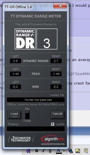

when lopassed at 100hz, this track has an average crest factor of 3 (after the bassline drops of course). Its in no way an example of "popular edm" but it is the style that I play.
Kaiju ft. Flowdan - Hunter [OSMUK029] - YouTube
this track (when lopassed at 100hz) has crest factor ranging between 4 and 2.5 THROUGHOUT (after bassline starts), centered at 34/35 hz (shall we call it the TH115 killer?)
attached is an image of the "dynamic range level" (actually just a crest level measurment) of the first 32 bars after the bassline starts in hunter, lowpassed at 100 (24db/oct). I would do the whole song but its basically just minute variations.
these are basically the first 2 of about... 2000 similar tracks in my library. Hunter is known for its particularly brutal bassline, but its not particularly special. Id expect almost every track in my library to measure under a 5 on the DR meter when lowpassed, and the bass is basically continuous for 54 seconds, followed by a few seconds break, then continuous again for 54 seconds, rinse repeat.
That is some seriously squashed shiuf!when lopassed at 100hz, this track has an average crest factor of 3 (after the bassline drops of course). Its in no way an example of "popular edm" but it is the style that I play.
