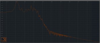

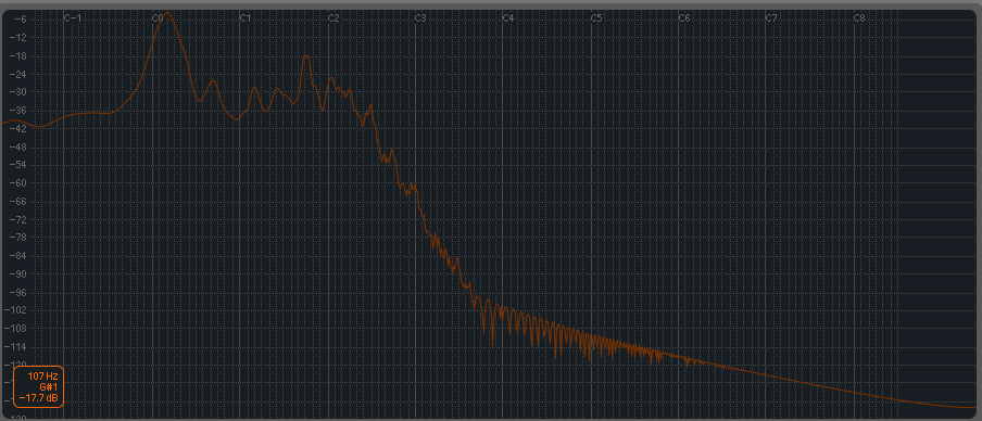

all sound is sine waves (layered of course), using a pure sine waveto reproduce 30 hz in a musical sense is a craving for 30 hz (not 60, or 90, or 120). esp once you figure in equal loudness curves. That being said, there are still harmonics in said tracks I posted, but rather than the 2nd harmonic of 35hz (70hz) being 0db down (as is the case with bass guitar), its more like 20 db down at the source.
heres a an average spec of the same 54 seconds (with the hipass raised a bit to 150). 35hz is 4 db down, 70hz peak is 22 db down, 105hz peak is 17 db down. Still harmonics, just not int he sense of a bass guitar 😛. That 50hz odd peak is the kick drum meat.

"a lot of the edm I would play is somewhere between -5 to -10db rms" meaning that the average power is is 5-10db below peaks and dynamic range from peak to rms would be 5-10db. not sure if that is the crest factor though.
None of my EDM is less than -5db rms and even -5db wouldn't be hardly any. most heavy stuff would be -7 to -10db but this is all before any lowpass.
