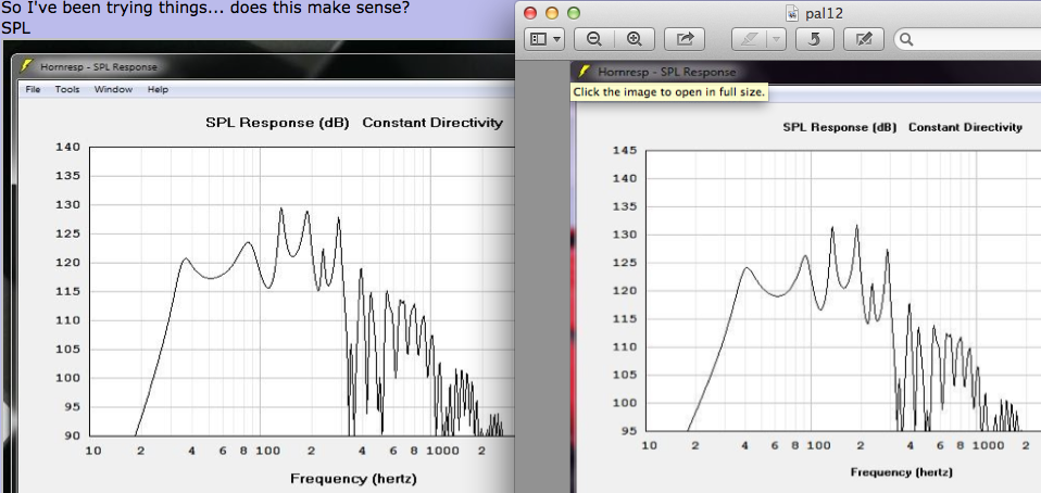

Can anyone tell me how well the Ciare 12.00SW will perform in this 'thing'? I know that the 12.00SW and Lab 12 seem to perform pretty similar in most designs...?
If the Ciare does not perform well, is there someone that would want to alter the design for me, at an suitable payment?

Hornresp input screen was posted in #6.Didn't i post hornresp input screen? .
it sims almost exactly the same as the lab,so yes it works well.Could someone please confirm this will work (or not)?

Assuming the response charts you posted are using the Ciare 12.0SW in the PA (l12), looks like it should work OK.Thanks for your replies!
So I've been trying things... does this make sense?
The 50-80 Hz "saddle dip" is less than the Lab 12, but the out of band upper peaks are worse.
Out of band parametric EQ cuts in the 160- 200 Hz range will probably be needed, but that goes with the territory.

This design is sent to my cnc cutter.
As you can see, I left out the recess for the wheels. This is a conscious choice because I do not intend to move it regularly. I am considering to use the (now-) free space for some sort of handle(-s), but I doubt it will be much of an improvement in comparison with grabbing it in the port and at an corner.
Any suggestions for this are more then welcome.

^ compromises need to be made sometimes. One of those that I made was to take up possible internal volume by adding a spot to put casters.
If this were an install version, I'd lengthen that back panel (panel I) to make the path length longer and see how it sims.
But that's just if you are looking for the cabinet to dig slightly deeper. If not leave it as is.
