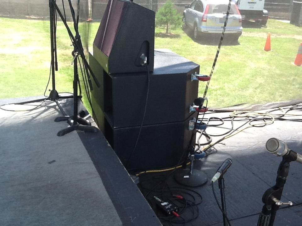

I just did a reception last night for 300 people, I used the 4 that I have, I was hitting 110 db at 40 hz at about 60' indoors very impressive and no back strain getting out thank you for your good design
So using inverse distance law, about +24db at about 1m. So 134db at 40hz at 1 meter. That just about lines up with the sims.
What amp was this with (still the Yamaha pc4800)?
Yes I own 6 of thoes amps that we have been looking to putting them to good use. The place had limited power as in 1 15 amp plug so I was pressing my luck using 2 of the yamaha's. The next gig we get proper AC and I will be hooking 2 of the PAL12 to a qsc 4.0 and we will use them as a drum sub. I will be reporting back as to how it works out. So far this design is great and has done everything I have been looking for in a small box.

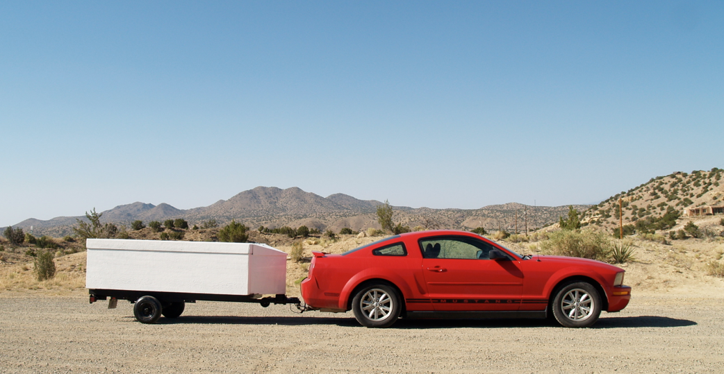

Been working on this as a transport solution for the subs. All said and done, hitch, trailer, 1 sheet of Baltic birch bolts etc I'd say I have about $500 into it.
And I can now build two more, woohoo! Have a ton of other stuff on my plate now, but I will build two more PAL12's in the near future.
Nice work on the trailer, under carriage looks almost the same as the old trailer kit I used for the small system.And I can now build two more, woohoo! Have a ton of other stuff on my plate now, but I will build two more PAL12's in the near future.
Looks like you can fit four PAL12 face down, save some loading/ unloading.
Trailers, gotta have 'em!
Thanks!
Yup I designed it to do four face down (38 wide. 30" tall and 60" front to back)
Or stack the two the way I have them now.
Trailer bed was enlarged with the wood to 60" front to back and 38" wide
