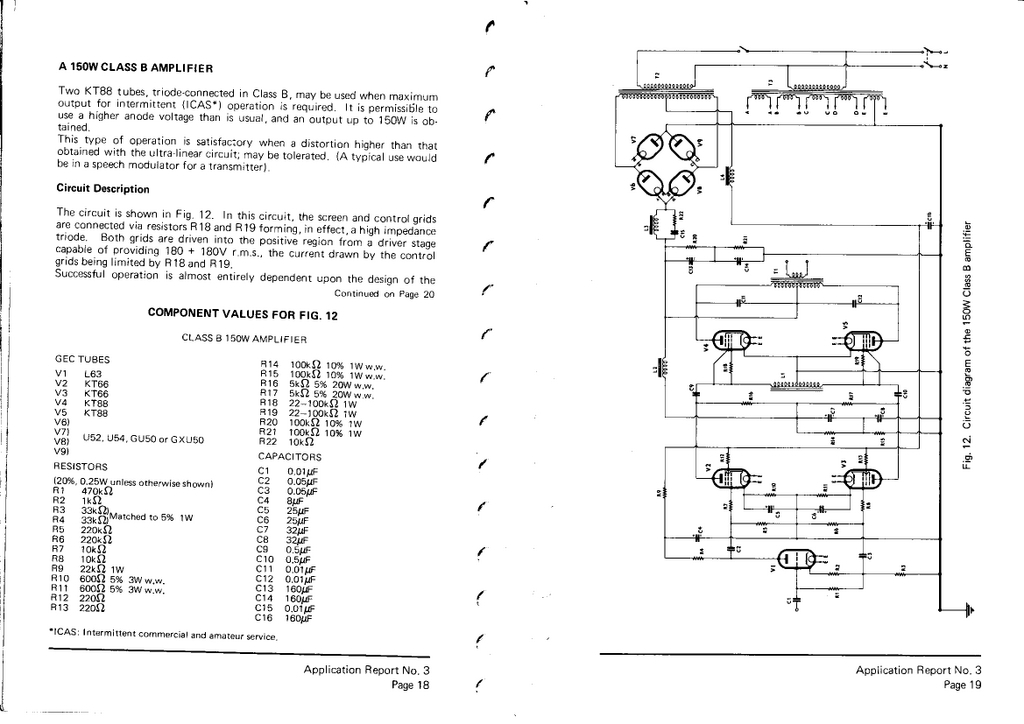

The common cathode choke/transformer in the AppNo3 schematic would be acting as a transformer for augmented PI action I guess. Multi - what was the reference for that page?
There was a self-split PI technique using a cathode transformer that had a brief spot-light moment in the early 1950's - known as the cathamplifier.

I got the circuit from the GEC Circuits for KT88.{ Application report No 3} The DA 41 circuit comes from the GEC Audio Frequency Amplifier design. {Audio Amateur Press}
I can scan the whole artical if you want.?

Thanks Phil. I have the GEC 1957 document "An approach to audio frequency amp design". If you could scan the App report No.3 then I would certainly appreciate viewing it.

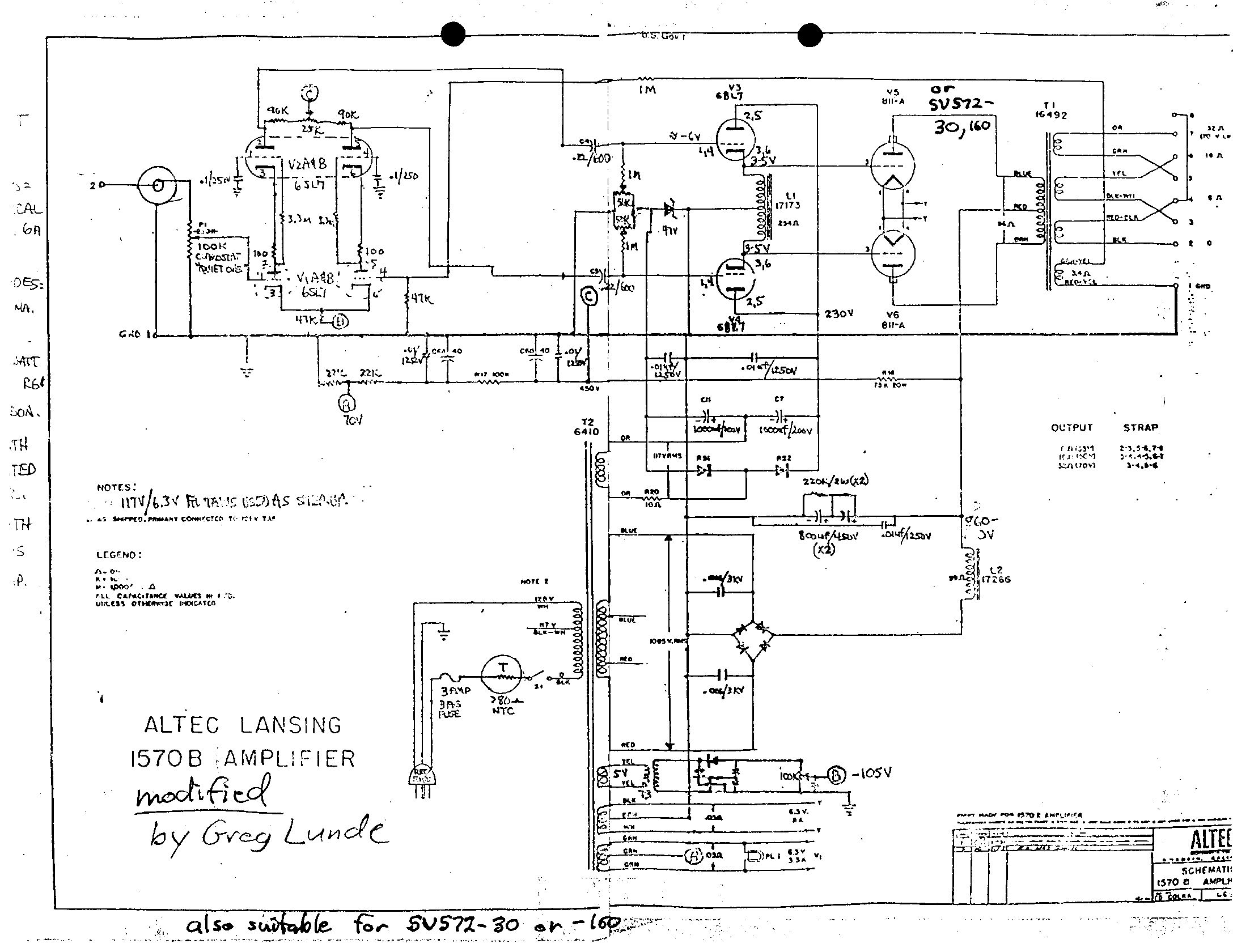

Another 1570B Modification
Multi
I came across this modified version of the 1570B by Greg Lunde which further simplifies the front end by reducing 3 stages (gain, splitter and driver) to a single differential stage. The differential stage is not the usual cascode with the grounding of the upper grids and the SRPP like bias arrangement. I would not use the 6SL7 in the cascode but a high transconductance tube such as the 6DJ8 or 6N6P. Anyway, for your interest and any comments welcome.
Multi
Ejam
Thanks; hard to imagine that 6SL7's would have sufficient drive. Certainly best to use the 6N6 or 6DJ8.
Cascode
Figured out that the cascode used grid-leak biasing of the upper triode to create self-bias as opposed to the usual fixed bias divider network usual employed. At quiescence, the upper triode is zero-biased, but when we input a signal, a charging current flows into the capacitor via the grid-leak, which lowers the voltage on the screen grid. The larger the signal, the greater the bias developed, which creates a compression effect on sustained passages. Great for guitars but not hi-end audio. Allen Wright's cascode differential would be the front end I'd think of using.
