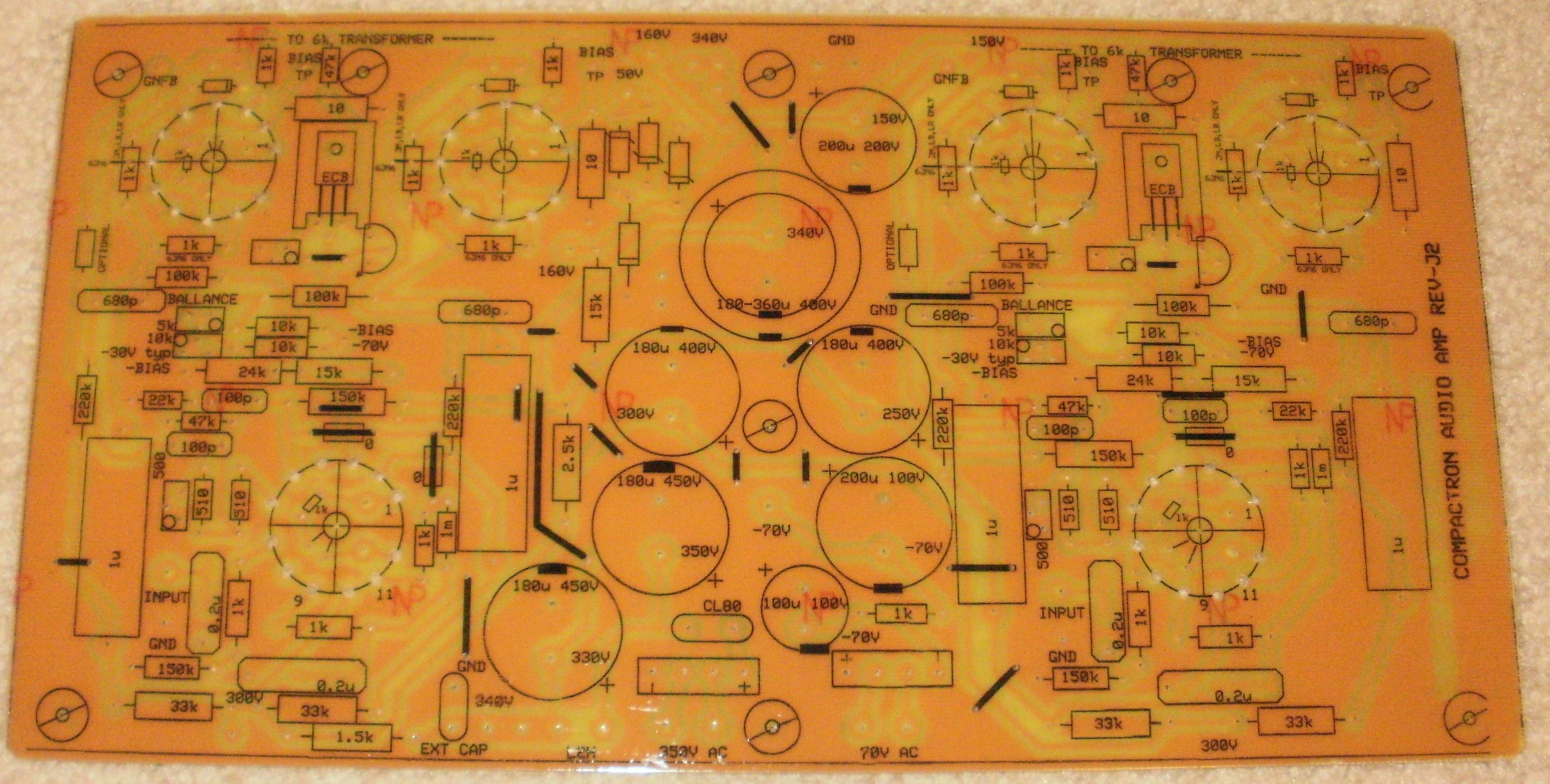

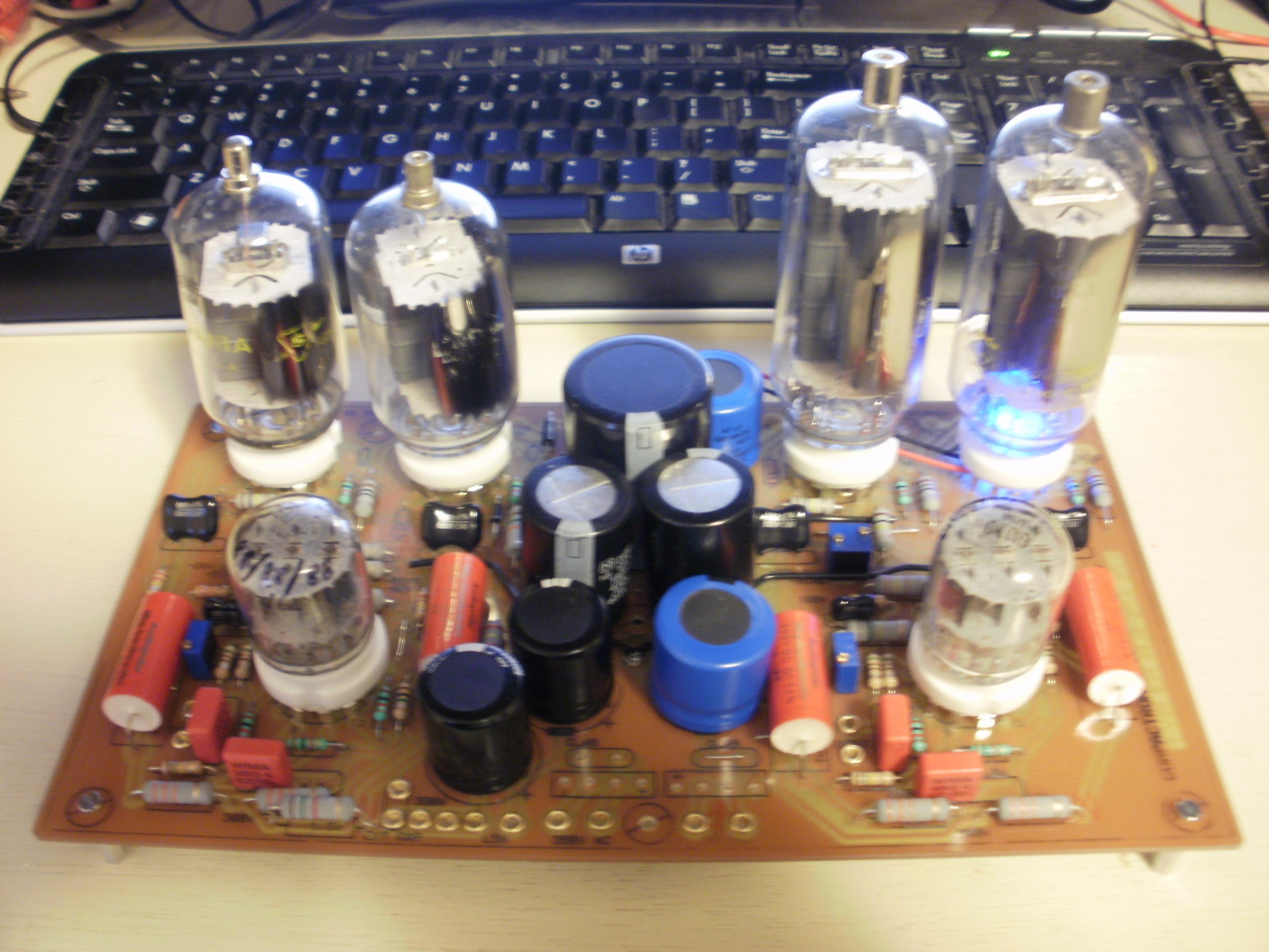

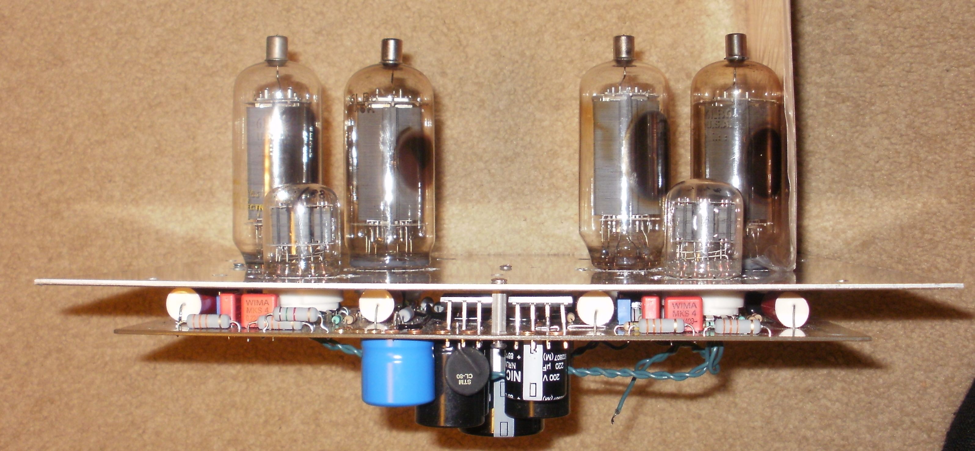

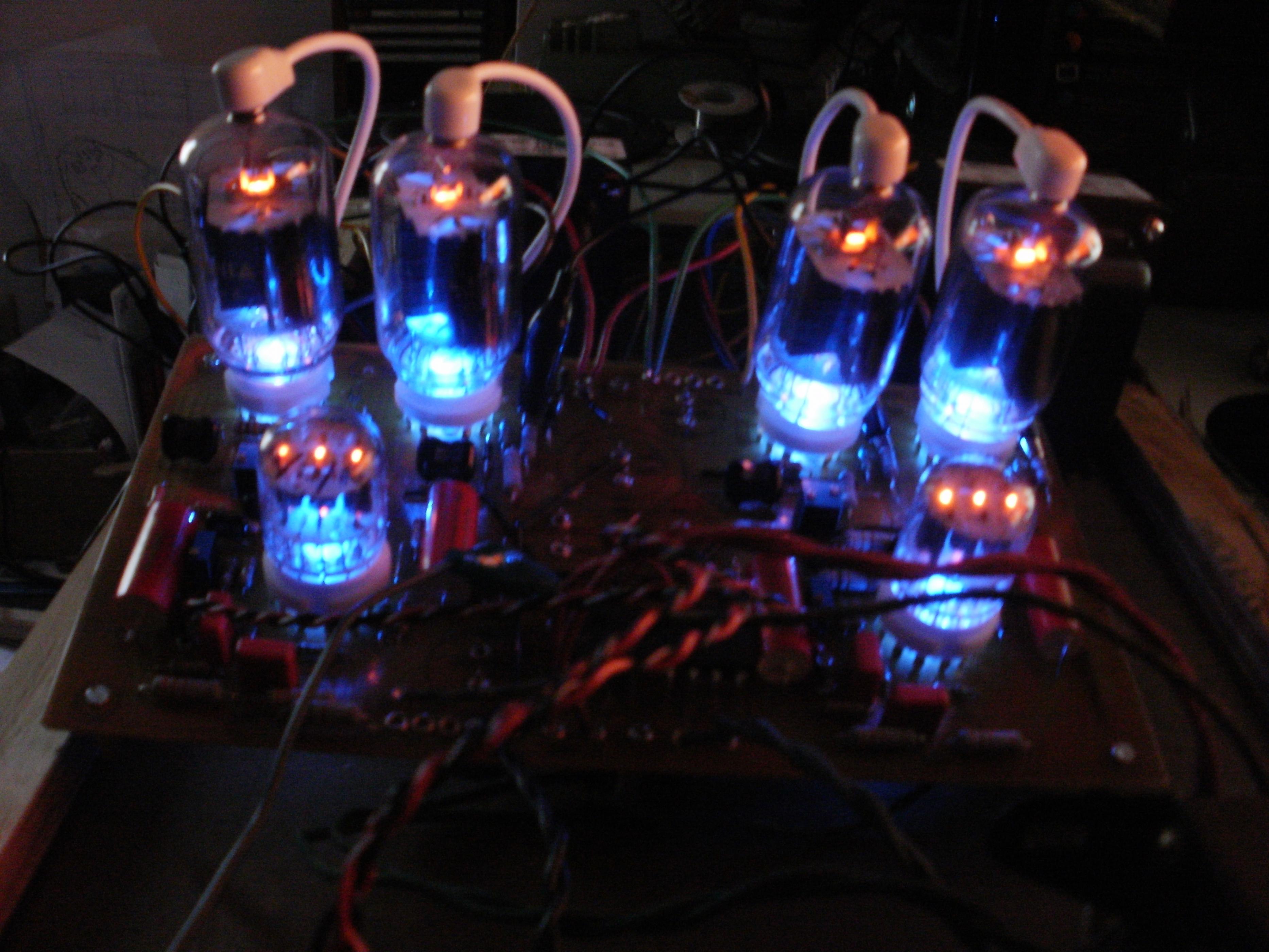

I've been toying with the PCB design again, if 400V B+ and 40 to 50mA, 16 to 20watts plate dissipation. I removed the diodes and first cap for the B+ so that would have to separate and coupled with the inductor to the PCB. I added a 6CG3 damper for slow start, I've done this for yrs now and like the concept. It has a bypassed 50V for the heater CT and 160V for the G2 gate and nixie tube if used.
My first tube combination will be 6JT6 outputs with 6JT8 drivers. The 6JT6's look like the 6JT8's on steroids.
