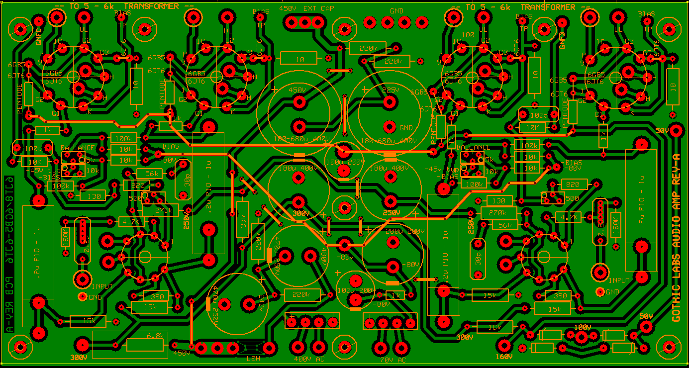

I modified a PCB design for 6JT6 and 6BG5 output tubes. Being 17watt tubes and similar in pin out, just a couple jumper options between the two. I had an idea but do not know how practical it is. With the odd voltage tubes, 16v, 18v, 21v heaters has any one tried a multi taped transformer?

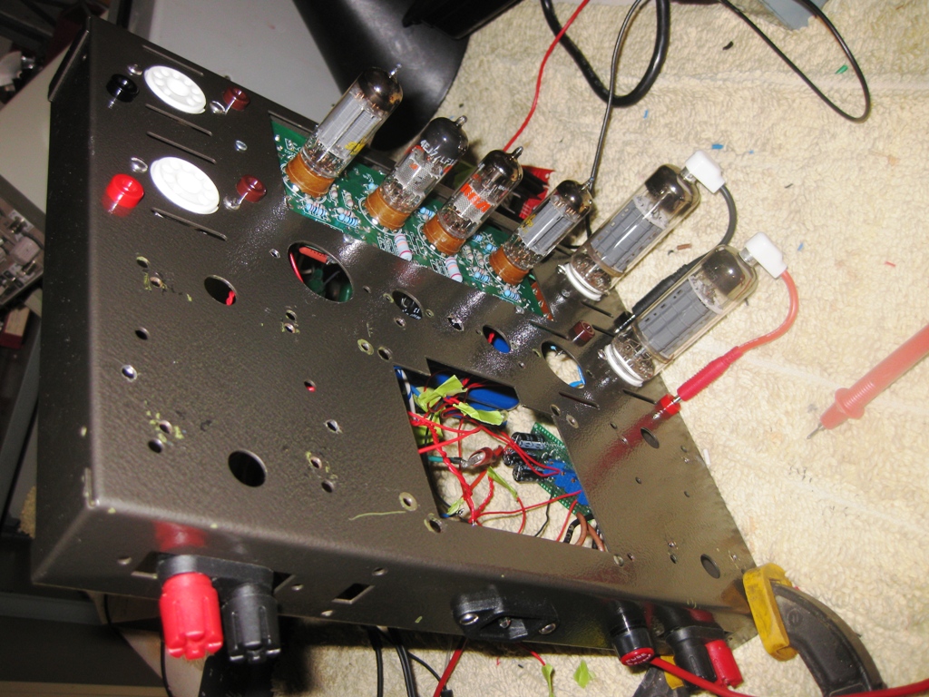

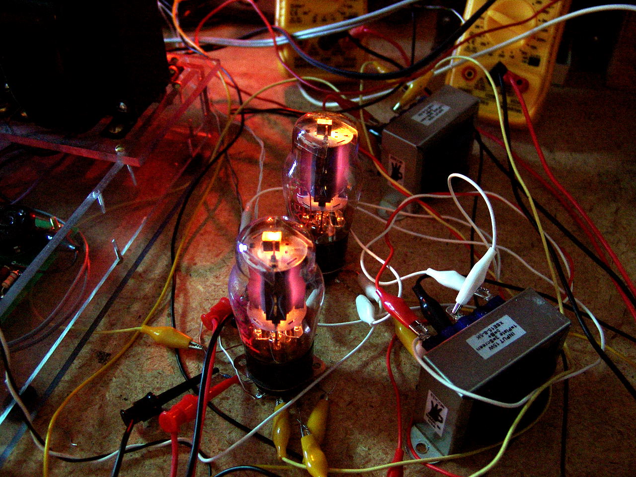

Running 13GB5's in UL Today with off-shelf Edcor Transformer
I am successfully today (so far) running 13GB5 pair push pull ultralinear into 2100 ohms p-p at 321 VDC plate, 324 VDC screen at 80mA quiescent current and -65 VDC bias.
B+ is from a 1:1 isolation transformer via voltage doubler. Driver tubes are $2 8GU7's, pre tubes are 50 cent 4EJ7's triode strapped.
I took an Edcor CXPP60-MS-4.2K and connected 8 ohms to the 16 ohm tap for the 2100 ohm load. I intially set the bias for 60ma/tube and it was stable. Bumped it up to 80ma/tube and still stable. That's 25 watts quiescent dissipation per tube. Bias still stable after playing at high volumes for awhile. No global feedback.
I have not run power tests as I get a huge hum when I connect the oscilloscope ground (probably a ground loop due to the mess on my bench). Amp is virtually hum free and plays music fine thru the one channel.
I need to measure screen current (tubes are NOT red plating or screening) and do some power checks in a day or so. I'll also turn up the bias and let you know when I see red on these 50 cent tubes.

Tom, that's great! Can't wait to hear more on actual measured performance. What is the UL tap ratio you are using?
Rene
Rene
I don't suppose they're lay-downs that'll fit in a dynaco chassis hole, i.e. 3.75 x 3" mounting holes??
Rene
Edcor states 40%. EDCOR - CXPP60-MS-4.2K
Of course, thanks, I'm not really all that good about doing more than 1 thing at a time, trying to do some work and this at the same time...🙂
I'll check on the Edcor line to learn what they have.
Rene
Rene
Is that an old Eico chassis?
Dynaco 70 chassis with paint on it. Driver board is a modified Dynamull board from Geek.

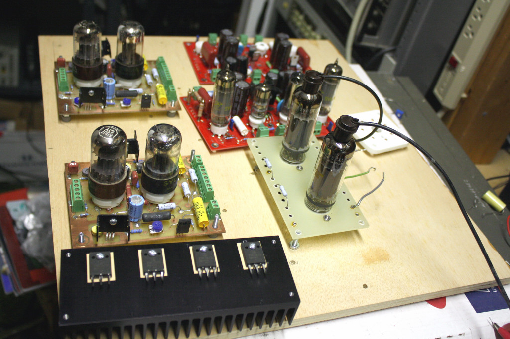

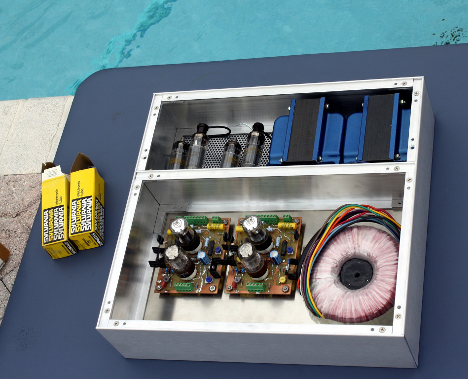

I thought I would post a quick update. I will be leaving on my yearly 2500 mile road trip next week and I won't be back until Memorial day, so there won't be any more progress until then.
I will be building a two channel power amp for HiFi and guitar amp use, likely both at the same time (jamming to a computer generated backing track while computer recording). Expected power output will be in the 100 WPC range. The chassis is already designed, built by Landfall Systems, and in my possesion. A mock up was done to verify fitment before drilling any holes. The chassis divider was drilled last week in woodshop class.

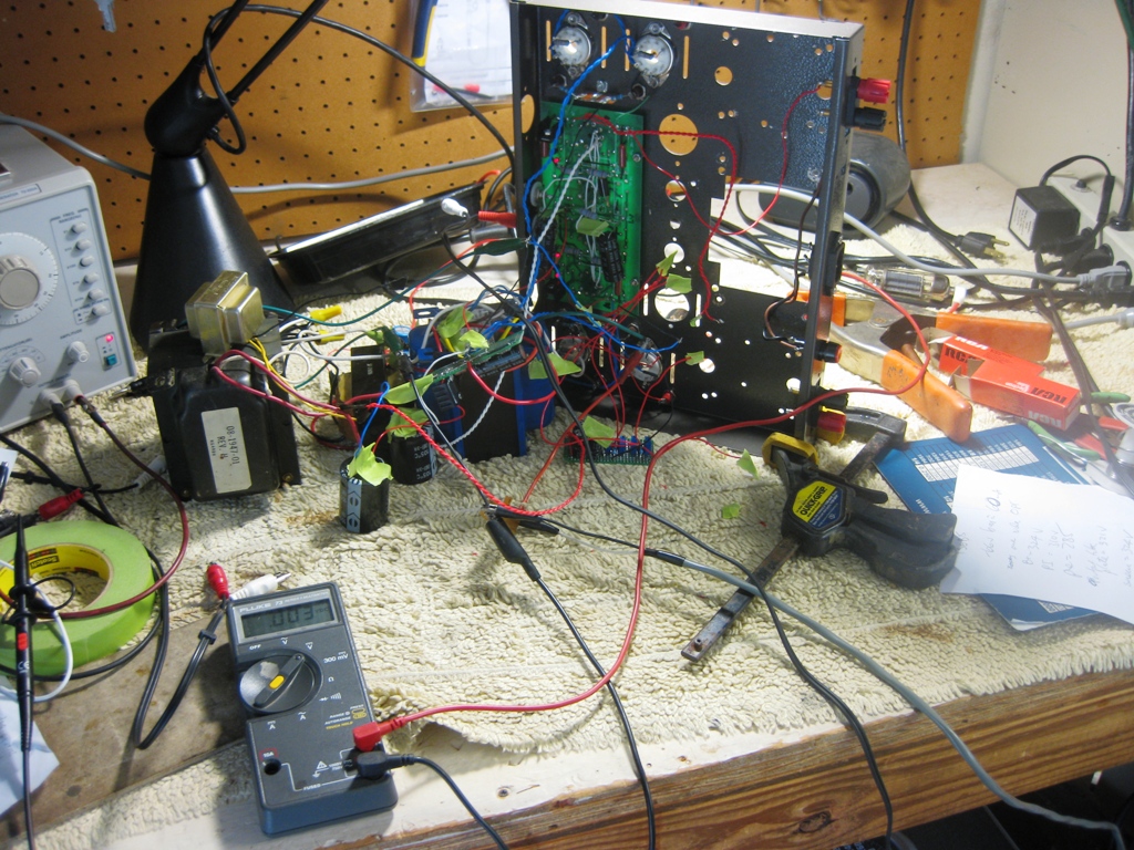

I rebuilt my old breadboard for testing. I have two of Petes driver boards and two of my own. I will make new ones if needed. I have output stage turret boards for 9 pin, octal, and 12 pin output tubes, a pair of big Edcor OPT's and plenty of smaller OPT's that I can experiment on. I found and mounted four BIG low capacitance mosfets that can blow screen grids in half without blinking. I will perfect this amp on the breadboard before building. The two main criteria are space (it has to fit the chassis) and efficiency (heat will be the limiting factor on power output). I have an SMPS for heater power (the small one in the picture).
The breadboard testing will determine which driver boards to use. Petes barely fit the chassis, mine are a bit smaller, and I can roll something new using smaller tubes. The choice of output tube must be made too. Some are already off the list due to diameter, height, or heater power. I will test screen drive, G1 drive, and both at the same time (hence 4 mosfets). The tube, driver, and type of drive choice is all about efficiency. I have seen screen drive work at very low idle currents. Idle current is important when you have 600 volts on the plates!
The fun will start next month, and I will start a new thread for it all. There will be some tubes that get tested just for fun too. Why, because there is a bigger amp to be built after this one.

The tests you did with the 13GB5 trioded went so well I had to connect it UL. Time will tell.
I tested the 13GB5 pretty thoroughly in G1 drive mode. I will repeat the tests with the same one of Petes driver boards when the mosfet buffer is built. Since a sweep tube can be saturated to a low plate voltage in G1 drive mode without going into positive grid territory, adding the mosfet buffer shouldn't make much difference with static sine wave testing. It will however provide a baseline for when I use the same driver/mosfet buffer to drive the screen grid. I have lots of 13GB5's so they are a good candidate for testing, and might be used in the finished amp if they prove durable enough at 100 WPC. I have several other possible candidates too.
I'm still mulling over the near Class B operation and why it works with G2 drive but not with G1 drive
I can't say just how this stuff works, but I have seen it work, and played around quite extensively with screen driven sweep tubes several years ago. Most of my experiments were from a loud guitar amp perspective and used purpose built guitar amp OPT's. I dissected one of the OPT's and they have zero interleaving. They have one half-primary, then the entire 0-4-8-16 secondary, then the other half-primary.
I have since noticed that these OPT's respond differently to different tubes, and low plate resistance seems to be the key to good results. I used these OPT's in a push pull 300B amp and nobody believes that I got the OPT's for $16 each (I bought 200 and it was 15 years ago). I now have a pair of Edcors and a pair of Plitrons to test with. I have been listening to a G1 driven sweep tube amp (Pete's big red board with the cheap OPT's at 125 WPC) for about 2 years in a HiFi application, so I have a reference point sound wize.

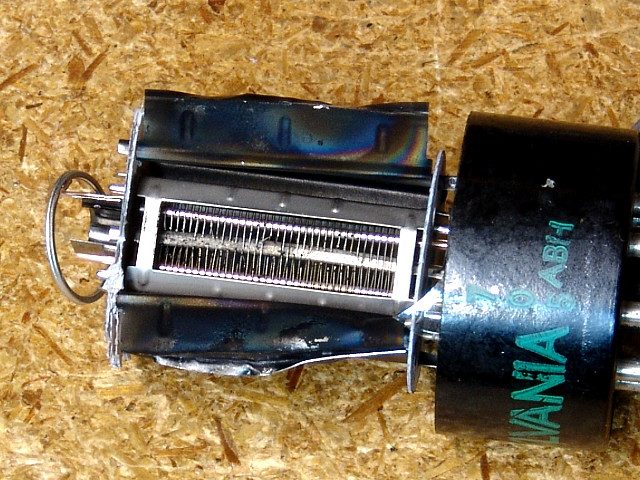

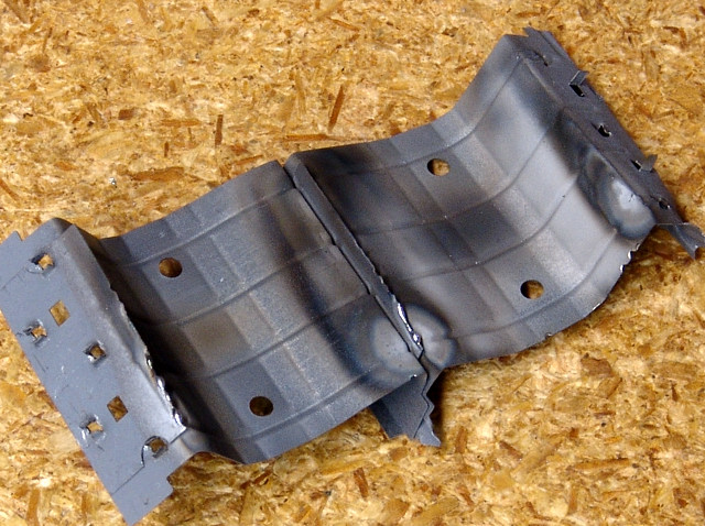

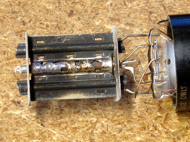

On a different note, last weekend I spent several hours outside sorting through my tube collection. I still have to thin the herd some more. In the process, I managed to drop a 6LX6 on the pool deck, and then step on the broken glass. After the temporary loss of vocabulary control, I got to pick the glass shards out of my foot with tweezers and wire cutters. It had to be a nice $30 sweep tube, not a half melted 6AS7. I saved the guts and have already removed the plate. I will post internal pictures when I get a chance. It has some unique internal fins on the plate to reduce secondary emission.
I have several hundred used 6AS7's. Some are pretty crusty looking. Once I get time to rig up an accurate way to test and match them, some of the bad ones will get "tested." I have been known to test some tubes a wee bit beyond their rated limits.

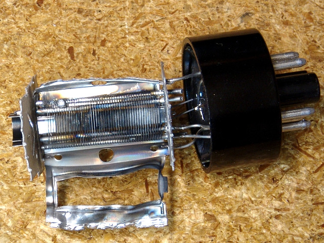

Note: The Chinese 6L6GC's and the Sylvania 21LR8 both still work good, the 6AX4 does not. It had a hole in the plate before I tested it, yet still tested good on two tube testers. The tube drop at reasonable currents, was in spec too, not any more. 6AX4 autopsy photo included.

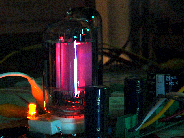

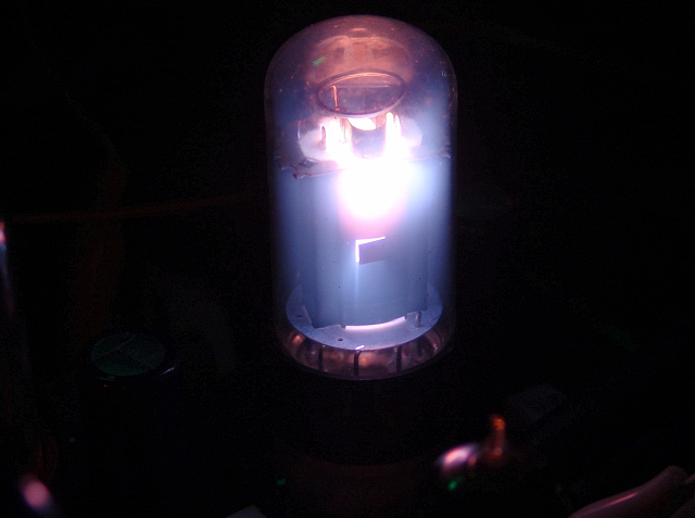

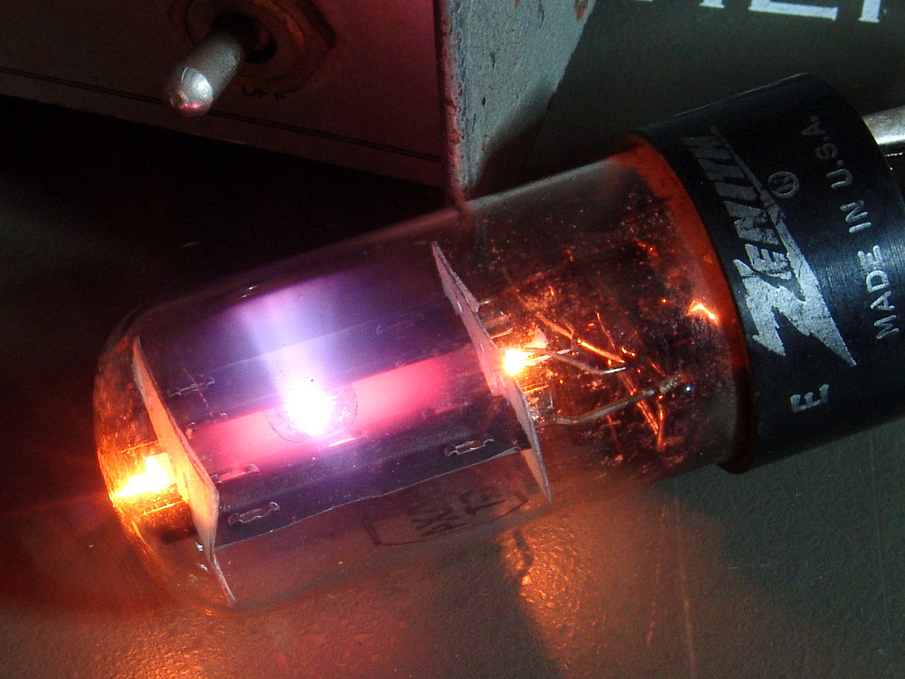

I had a bunch of gassy 6V6GT's. I stuck one in a SSE board and set the power supply on KILL. After about an hour of cranking out about 20 very distorted watts the cathode resistor blew, followed by the cathode bypass cap exploding. Tube autopsy was performed.
I have explained how you can overheat the screen grid in extreme screen drive applications leading to all sorts of blown parts. I was extracting about 125 watts from a pair of 6BQ6GT's when a tube arc blew up the tube, the mosfet, a bypass cap and a few resistors. Autopsy photos. Yes a wicked arc obviously ate the grid rod and a chunk of the plate!
