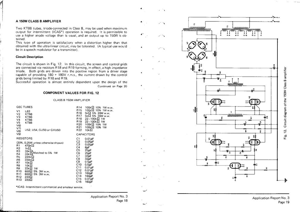

Screen driven pentodes; zero bias triodes
Zero Bias triodes; when a pentode is driven on the screen it becomes similar to an 811A Zero bias triode. KT88’s and 807’s screen driven were used by radio amateurs as modulators for transmitters

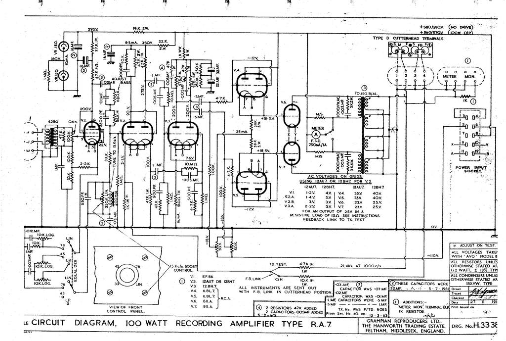

You can get up to 120 watts from 807’s, 150 using KT88’s or up to 200 watts using a DA 41-42 or 811A. The 811A can give very good audio quality running at 100 watts, with 600 volts and 70 ma current draw, you could also use 805’s
The 811A and Da41-42, 805’s where used in record cutters.
Svetlana and RCA 811a's last for many years at 600 volts.

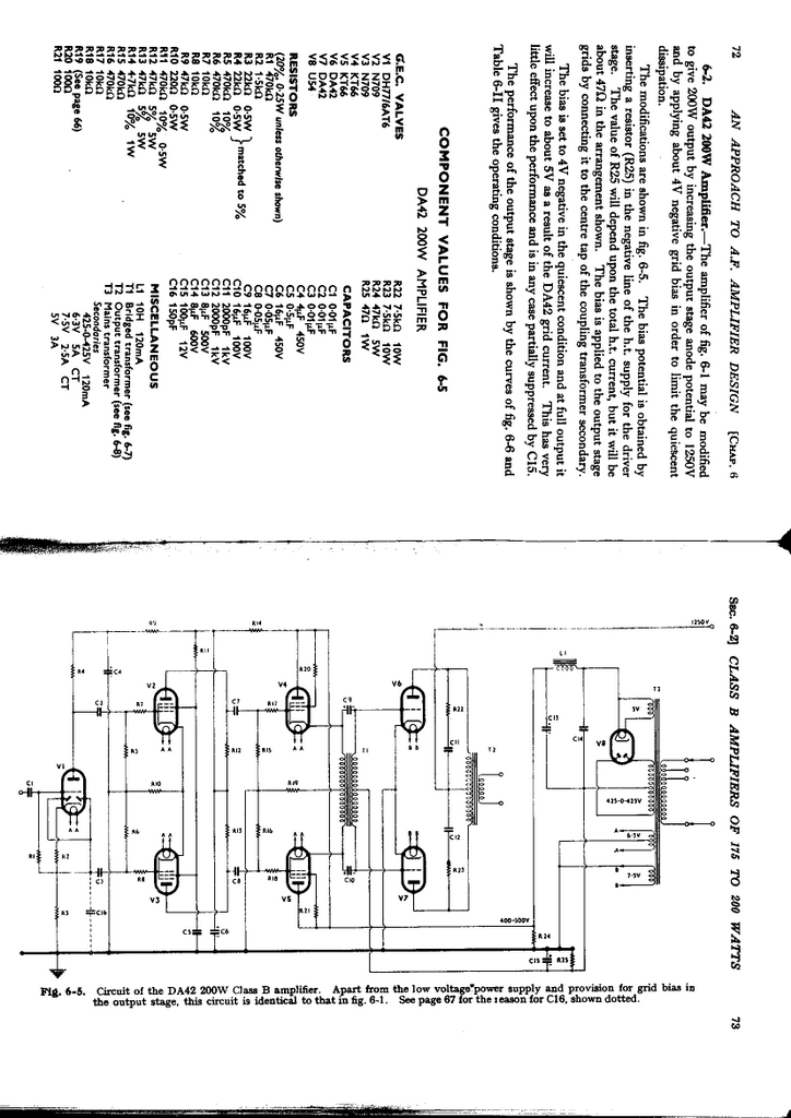

What kind of choke is that in L1 on the KT88 schematic? It looks a lot like the MC-240 schematic without the "Williamson" type front end.
The more I see these screen drive topologies, the more hesitant I am to proceed. They look a bit tricky.
