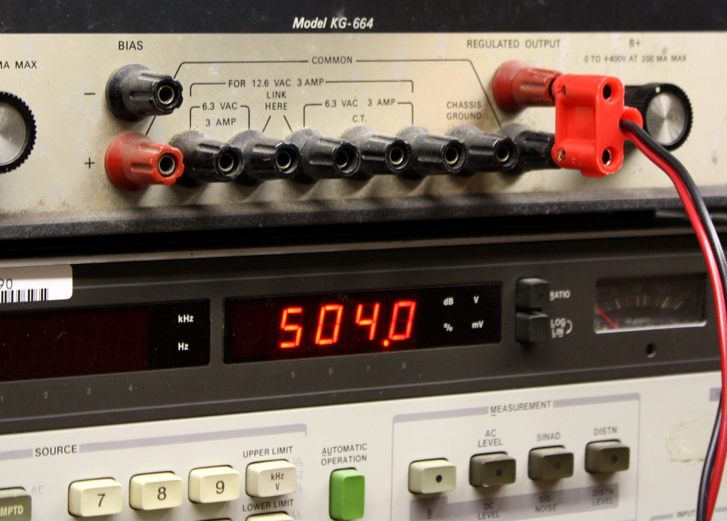

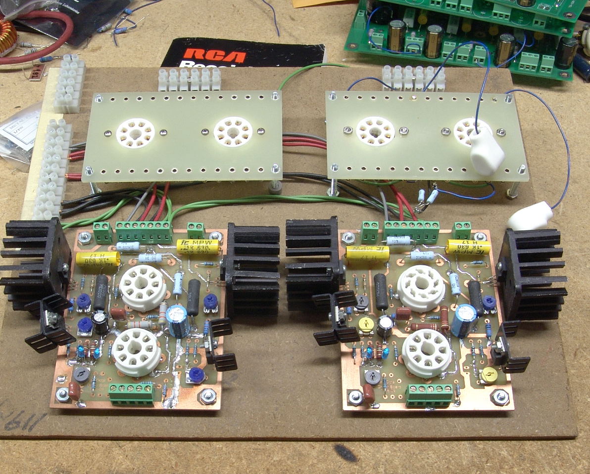

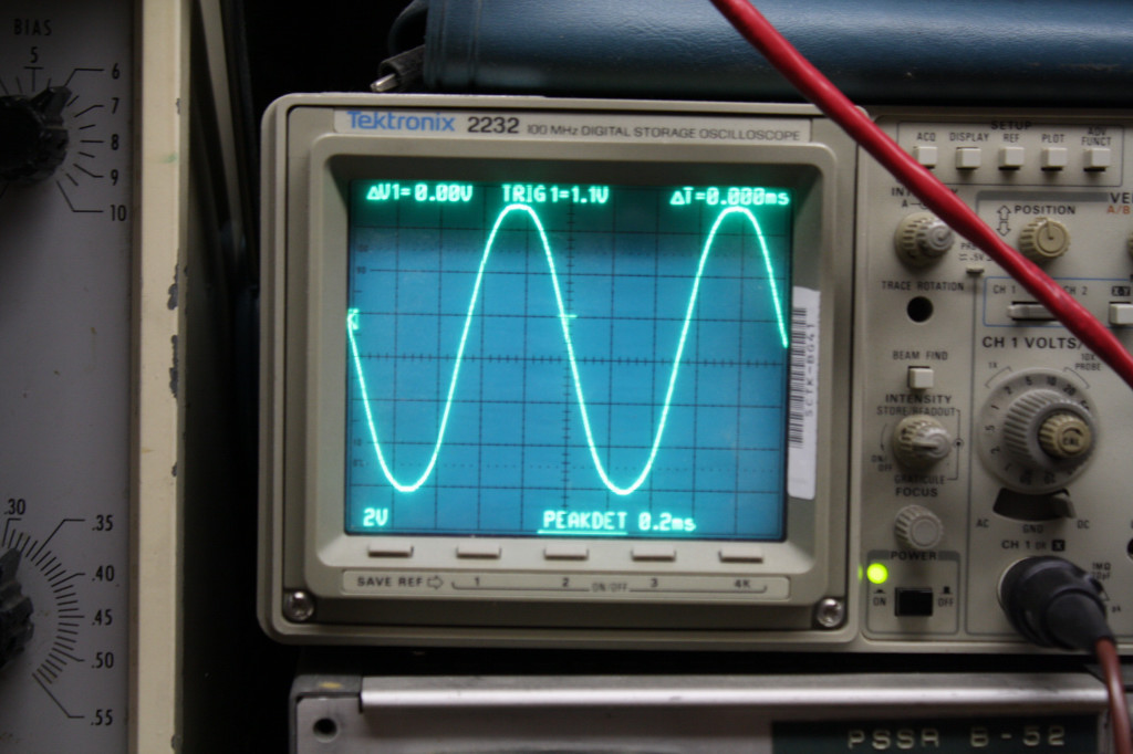

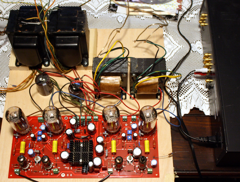

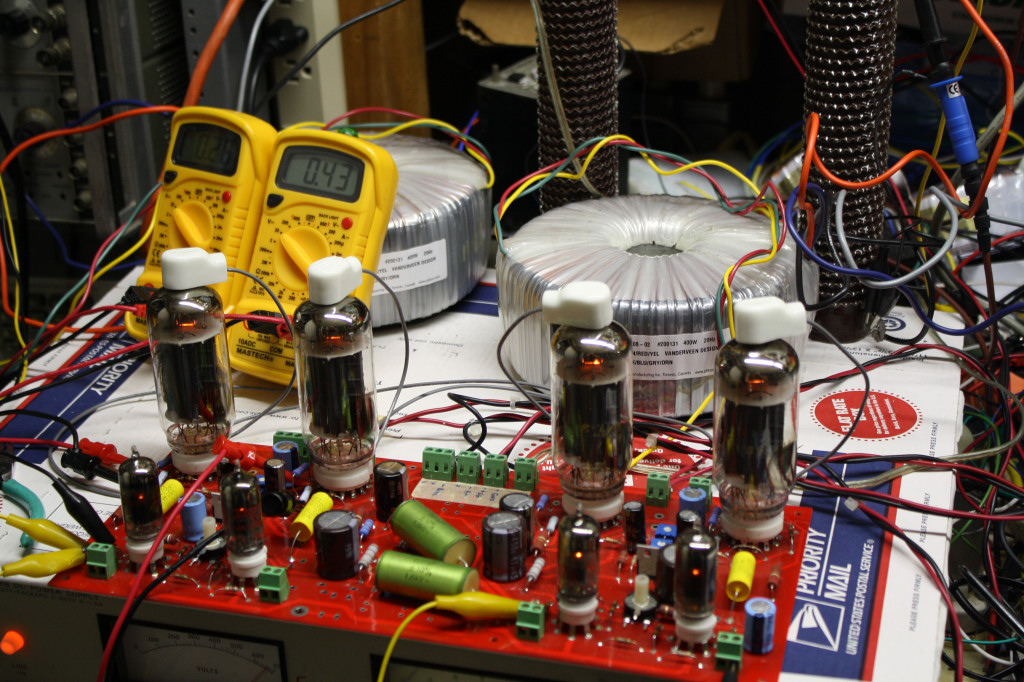

I am including some pictures that I happen to have on my work computer.
The breadboard is my 6SN7 LTP --> 6SN7 LTP --> mosfet follower board. It was designed to drive anything. I believe this is the 6LW6 triode incarnation. I think the picture was taken as I took it apart.
The Flamethrower 250 breadboard is a 125 WPC sweep tube amp built with Petes big red board. It still exists and I use it to rattle the neighborhood through my 15 inch OB coaxials. The output tubes are 6HJ5's which are still $4 each and don't need a plate cap.
504 watts from Petes big red board with 35LR6's. This is the board under power.
The watt meter reading.
The scope trace at 504 watts. Notice the slight onset of clipping. 5% distortion occurs at 525 watts.
