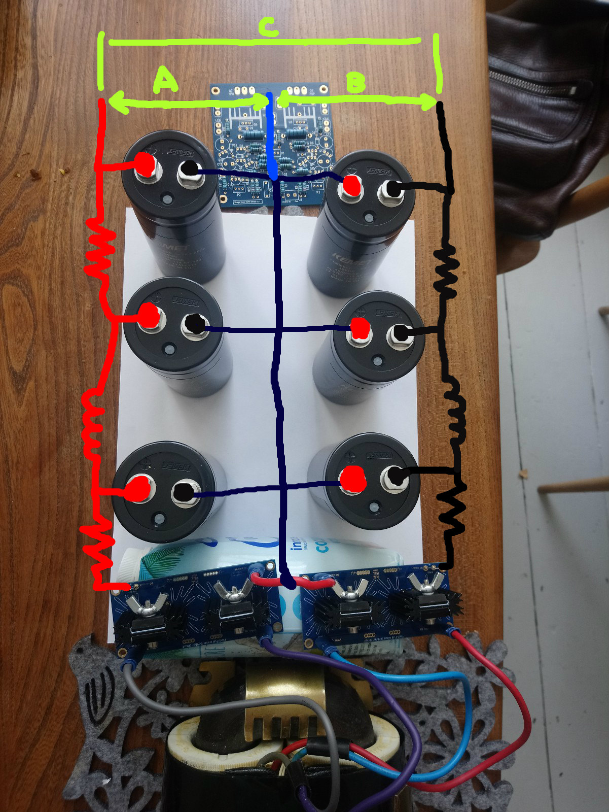

I ordered all the extra bits such as the 0.1R resistors, 2R2 resistors. To load and test the PSU I also ordered 100w 8ohm and 10ohm resistors which I will bolt to a heatsink. Should have it all wired up and ready to test this weekend.
Hi Vishalk,
Starting to look good. However have another look at the way I've drawn the ground connections in the schematic. Try to match that in your drawing. Plus, i don't see a connection to chassis ground on the end of the circuit.
You will have very large currents in the psu . This makes the layout extra important to prevent hum and unwanted interaction between those currents.
Joris
Joris
Start with your power connector into the case, with fuse, switch, chassis ground connection, optional noise filtering and transformer near them. Arrange your rectifiers and optional transformer damping filter nearby.
Will do Allen I will set it up as if it was in the chassis, only thing I can't do is ground it to the chassis. Can I use the earth of th transformer to earth or ground it?
An IEC power input connector should have a ground connection with a short lead that you can run a bolt through with a shakeproof washer. This is for compliance and safety only.
The power transformer core is typically connected to the casing if you're using an EI core transformer, which you then bolt to the chassis. If it isn't, the casing itself will at least be grounded. A toroid comes with mounting hardware to achieve the same result.
If you have a separate ground connection coming from the transformer, it might be an electrostatic shield. This is often grounded but in some cases is attached somewhere else.
It is, but both transformer ground and the ac ground should be connected to the chassis for safety in case the some part of the circuit brings the chassis toAC live potential. That arrangement you show is Not safe.
Hi Vishalk,
The yellow wire connects to an extra winding in the transformer which forms a shield between the primary and the secondary windings. It helps preventing noise and pollution from the mains ac power supply of your house entering the psu. it is not psu ground.
Connect it to the central star ground where ac ground, psu ground and chassis are joined.
Joris
Joris
The incoming wire is the power earth (or ground). Your amp earth can be the same, sometimes it is different. Earth is a relative term, unless you join different earths together. This confuses many at the start.
The chassis connection is needed for safety protection. The amp needs its own ground which I would choose to place relative to the amp. The signal input connectors are usually considered to be the most accurate representation of what the amp ground should be because it is at that point unchanged by the amp.
Then you can connect it back to the chassis if that is appropriate to your system, and I would normally recommend this (if you have to ask...).
Your transformer shield is probably worth grounding but it doesn't help anything else, it isn't enough on its own. (Some would say at least ground the transformer body if you must experiment).
