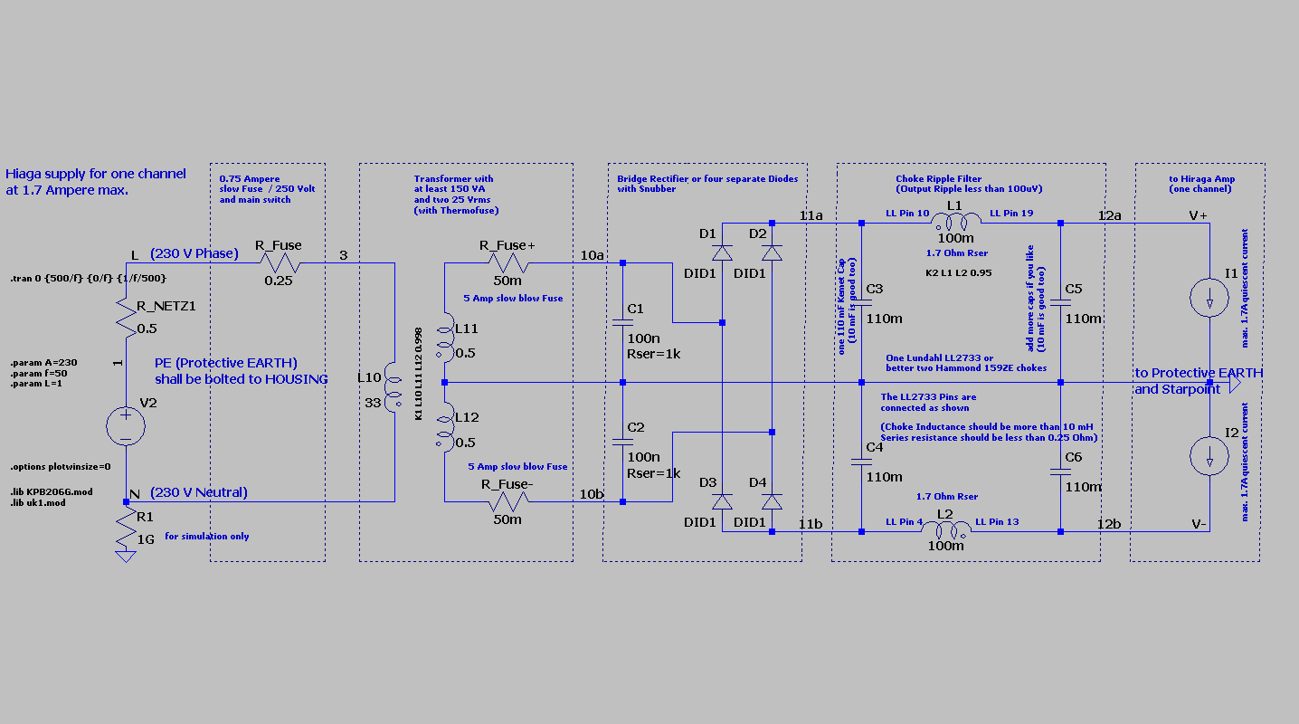

Shown is a power supply with the parts you have at hand for
one channel of the Hiraga Amp.
For one channel you need 4 of your 110 mF caps and one
Lundhal choke. Spare the other caps for another
amp!
Of course you could parallel more caps,
but with diminishing returns.
As shown the output ripple is below 100 microvolt, barely
measureable.
The Hiraga Amp has about 40 dB (factor 100) of power
supply rejection, therefore the 100 uV are reducted
to 1 uV at the output of the amp.
Copper bars or such things are not necessary. If you
look at the Hiraga Amp, you see a 0.47 Ohm resistance
at the collector of the power transistors.
Nothing to gain by a copper bar here.
The Lundhal choke has a huge DC resistance of 1.7 Ohm.
This gives you about 3 Volt of headroom loss and a
lot of heat dissipation in the Choke.
Not the best choice, but it will reduce the ripple efficiently!
The slow blow fuse directly after the transformer secondaries
has two tasks.
First it will protect against short circuits in the bridge
rectifier or at the amp output.
Second the DC resistance of the fuse will somewhat
limit the the peak currents into the first
110 mF capacitor.

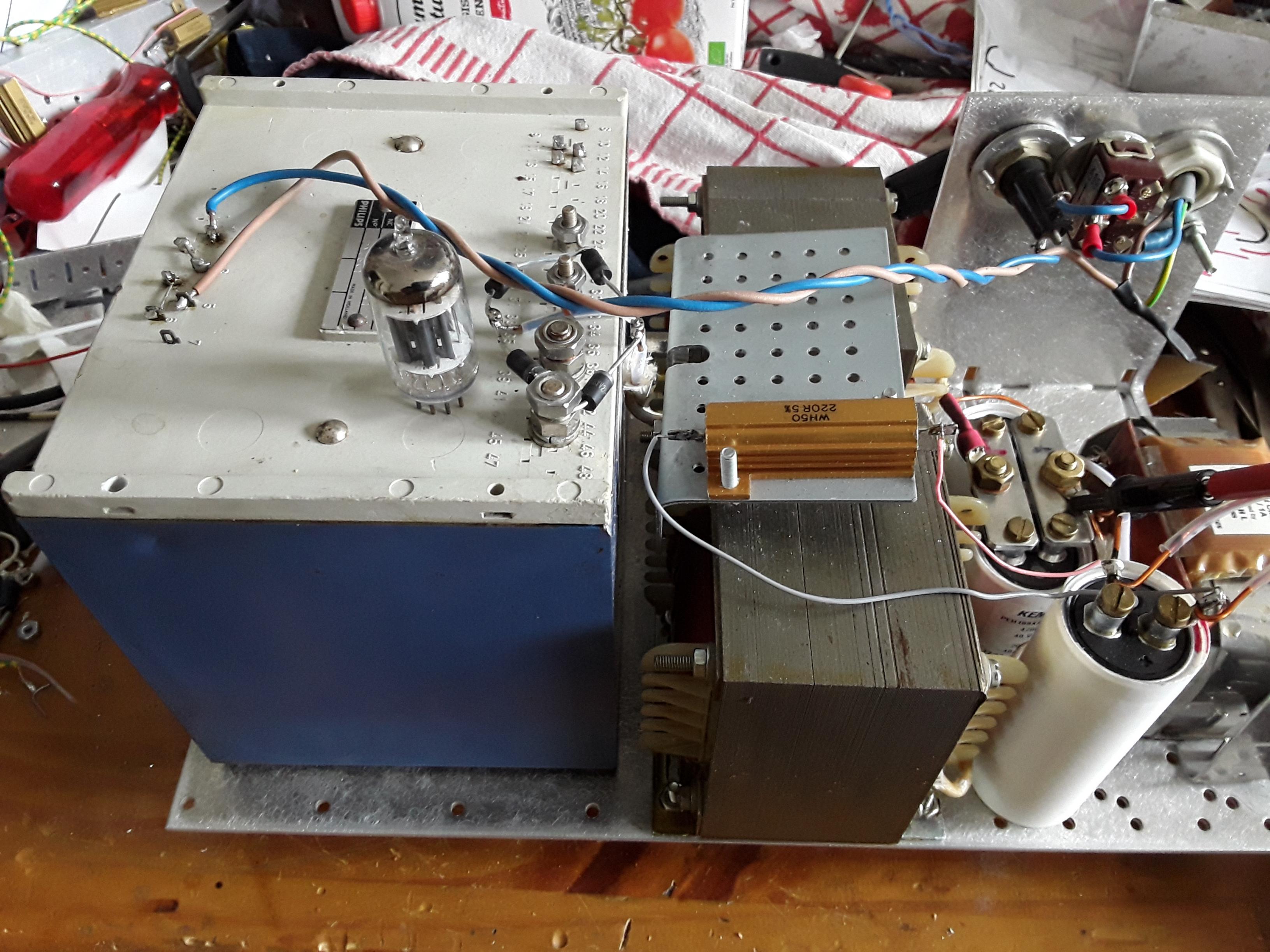

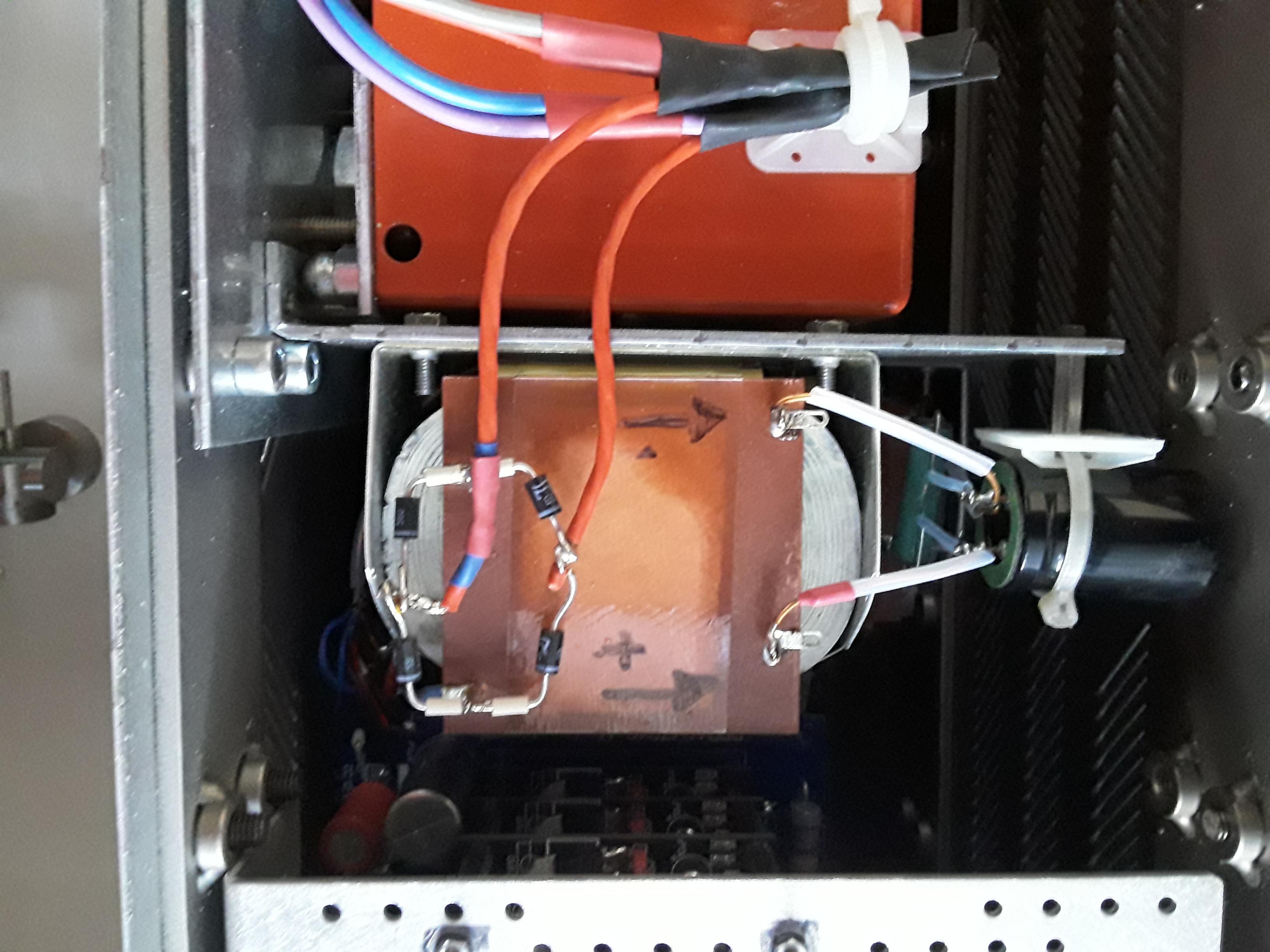

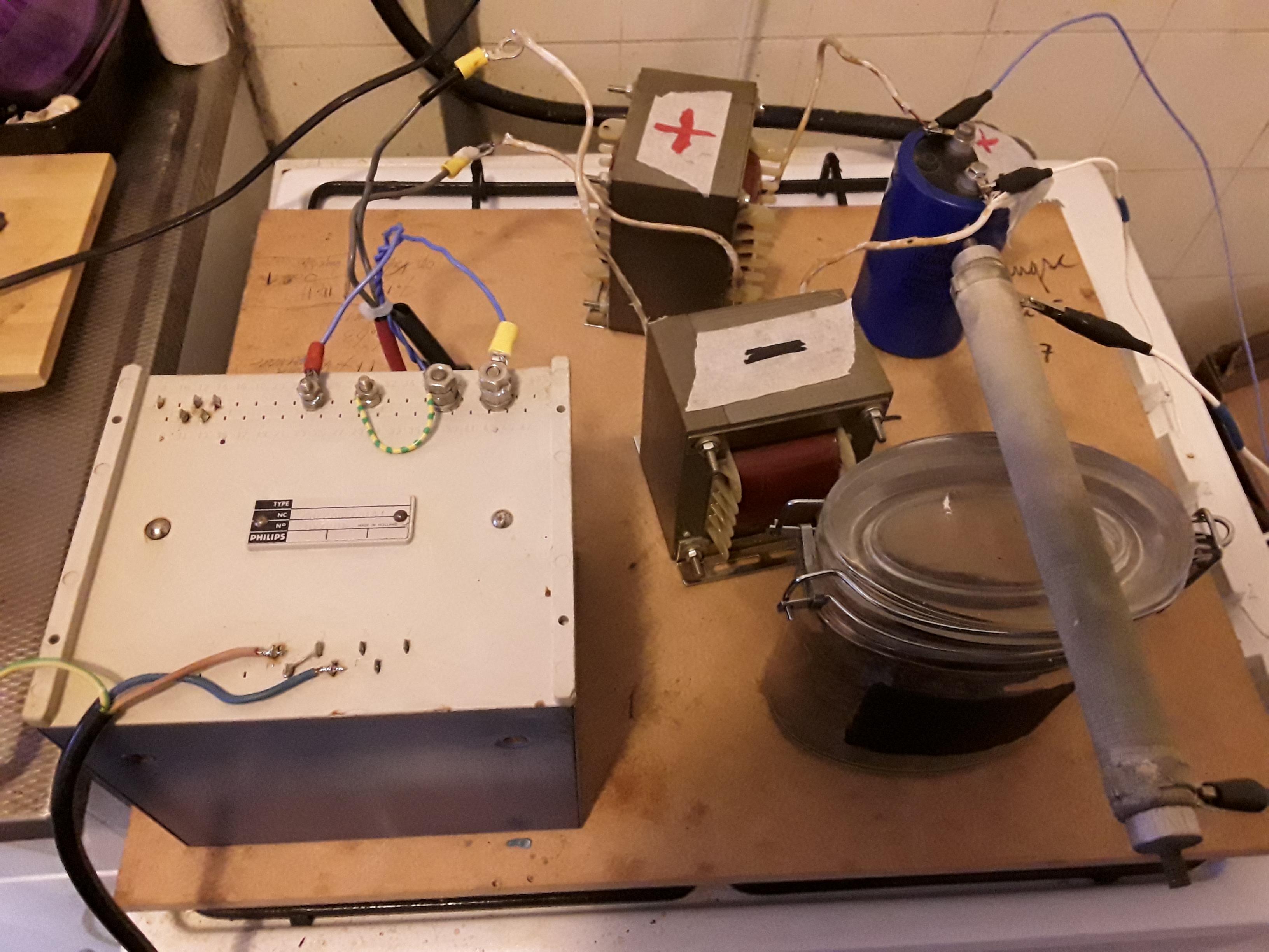

Hello,
In the photos you can see test set up from LCLC power supply with big chokes i bought here on this site as first choke and ll2733 as second choke in single rail supply for a class d amp in my home cinema set.
The last picture is my dddac LCL power supply.
You can do some test before all the final parts arrive.
As you can see if prefer hardwiring and short connections.
Cable groom the r core will be difficult to solder. I mean you can solder it gut you might damage the diodes by to much heat. In the dddac supply i had to use a thinner cable to connect the secondairies in parallel.
Short connections are important to the diodes and to the first choke!
As you can see i dont use big diodes i think they can take 3 or 5 A continuous current but the right choke will keep the current at the same moderate level, there are no charging pulses.
Will be back when you the actual dc voltage at the first. You see in the pics i dont use big caps as the first cap i think 10000 or 22000 the last cap is bigger.
Greetings, Eduard
