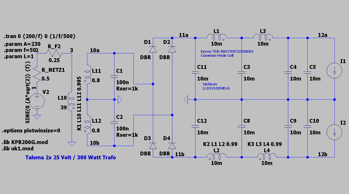

A good and relativly cheap alternative C-L-C supply is in the attached picture:
It uses a Talema toroidal transformer with 300 Watt and 2 x 25 Volt
output (Euro 55 at Farnell).
It does not make much sense to use separate transformers for
each side, if they are in the same housing.
Channel separation is not very important in stereo, about 20-30 dB
is more than sufficient and this is easily to achive.
The positive and negative supply is filtered by 4 x 10 mF
Nichicon LLS1V103MELA caps (Euro 2.9 @ Mouser).
For a tight budget, 3x 10 mF or 3 x 4.7 mF are OK too.
Two Epcos common mode chokes B82733F2232B001 are used
to filter the ripple (Euro 2.4 at Mouser) down to less than a millivolt!
The Epcos have about 0.15 Ohm series resistance and therefore
do not cost much headroom.
Be careful to insert them correctly so that the 100 Hz ripple
is seen as common mode.
The rectifier is a GBU806 or similar (1 Euro @Mouser).
A RC snubber (100nF + 1kOhm) over each secondary winding
damps oscillations due to parasitic inductance of the
transformator. A secondary 100 nF should be used
directly at each amplifier.
At the primary side a 1.5 Amp / 250 Volt glas fuse is used (
Bel 5TT 1.5-R or similar, 0.3 Euro @Mouser)
To be on the safe side, each channel should have a
separate 3 Ampere fast fuse, especially as the
Amp has no electronic current limiter!
Total part costs are about 90 Euros for the supply.
I think, that from a technical point of view this is a good
starting point for the Hiraga class-A amp.
Edit: The attached picture was wrong...

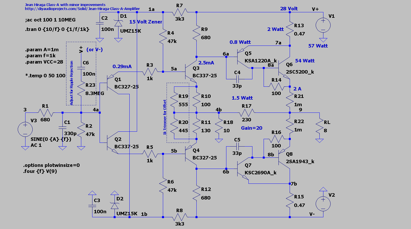

There is another nice trick to increase the power supply rejection
of the Hiraga Amp:
A high value resistor (R23 in the picture) in series with a 100nF
is used to inject some ripple at the input in a way
that the ripple at the output is cancelled.
This works very good in simulation and is worth a trial.
It depends on the matching of the transistors if the Resistor should
point to the V+ or the V- supply. In simulation a value of about 8.3 Megaohm
is right, but this needs experimentation.
In addition the various resistors are changed to get somewhat
better performance (lower input bias currents and higher predriver and driver
currents) and to set the output quiescent current to 2 Ampere.
By using 15 Volt Zener diodes, the amp works with a higher range of supply values
(18 volts up to 35 volts are OK).
The predriver current is send directly to the output to do some useful work
instead of getting wasted.
The gain is set to 20, about 1 Vrms is needed for full output.
EDIT: Forget to mention the Talema part number in the last post: RS0300P1-2-025
And note that the first Epcos common mode coil is used for L1 and L2,
and the second is used for L3 and L4

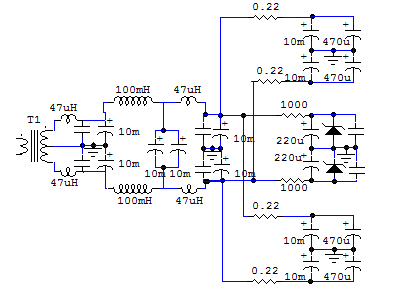

This is a supply I have used with my Hiraga. The channels are isolated – left outputs, input section, right outputs.
The chokes are followed by capacitors without a ground connection as this gives me 20,000uf instead of 5,000uF for the two cans, and the ground connection isn’t going to be doing much at this point. This deals with the majority of the differential mode ripple. The small chokes and small stacked capacitors following deal with common mode noise.
This is the capacitor input version which I used to increase the Voltage for the transformer I was using, and had the schematic for. The grounds go back to a single point.

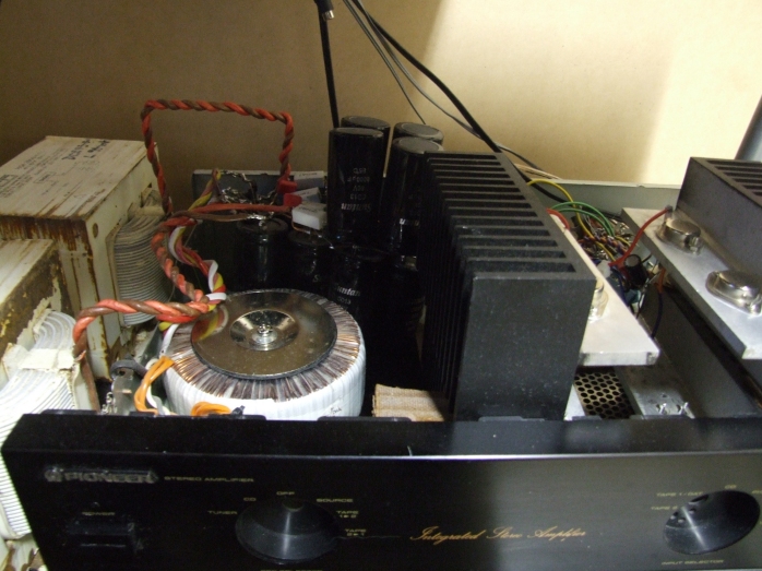

This is a picture of the chokes I use, with my old JLH amplifier. They are lighting ballasts, have an inductance of 95mH and a DCR of around 0.1 ohms if I remember correctly. This is more inductance than I need for the choke input version and they handle the DC well even though they are not gapped. They weigh around 14Kg each, and this is good because they have proved suitable through several different versions of supply and different amps. The low resistance is recommended for a higher current amp.
