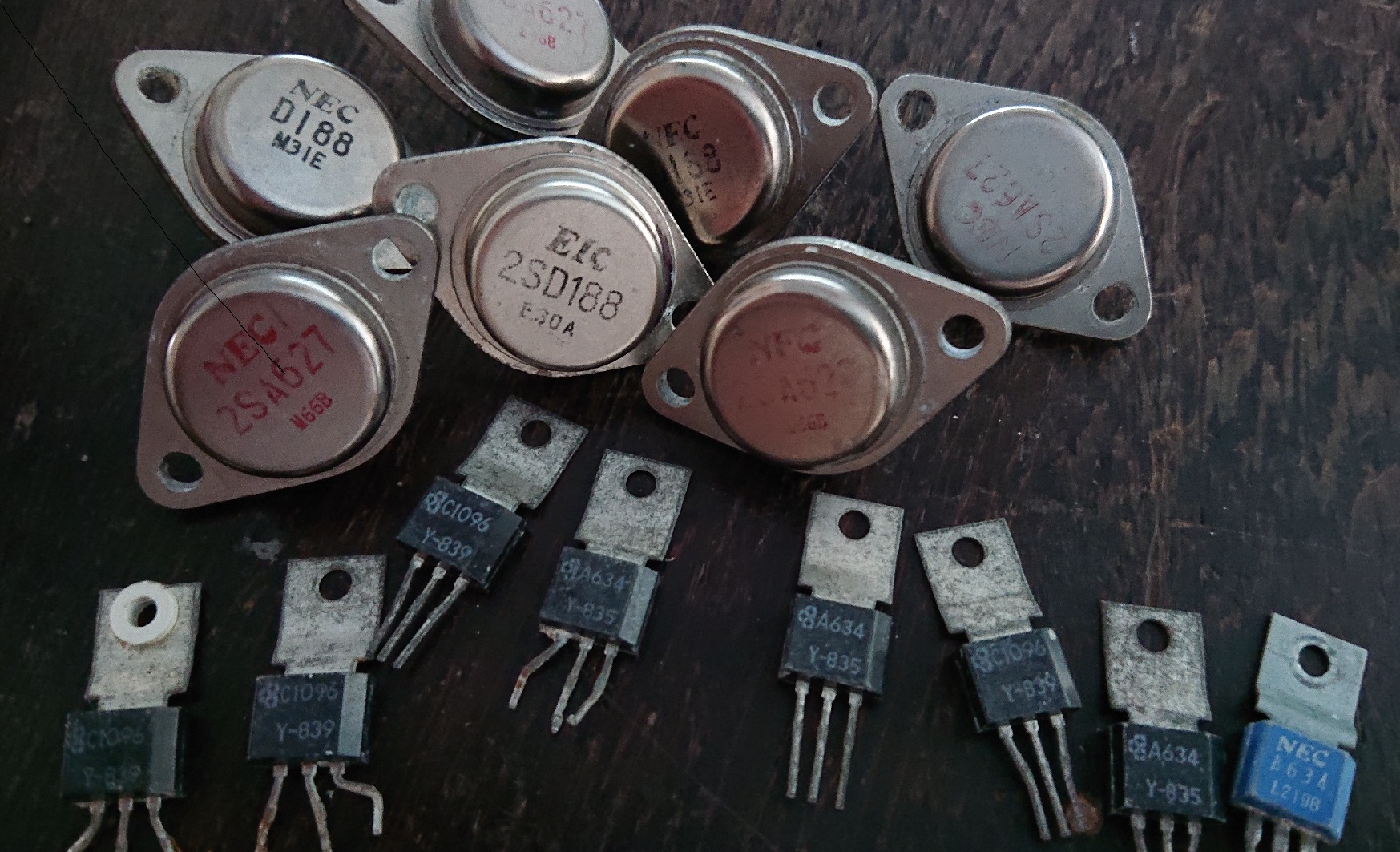

ohw, just dug these up. You triggered me Vishalk. 🙂
