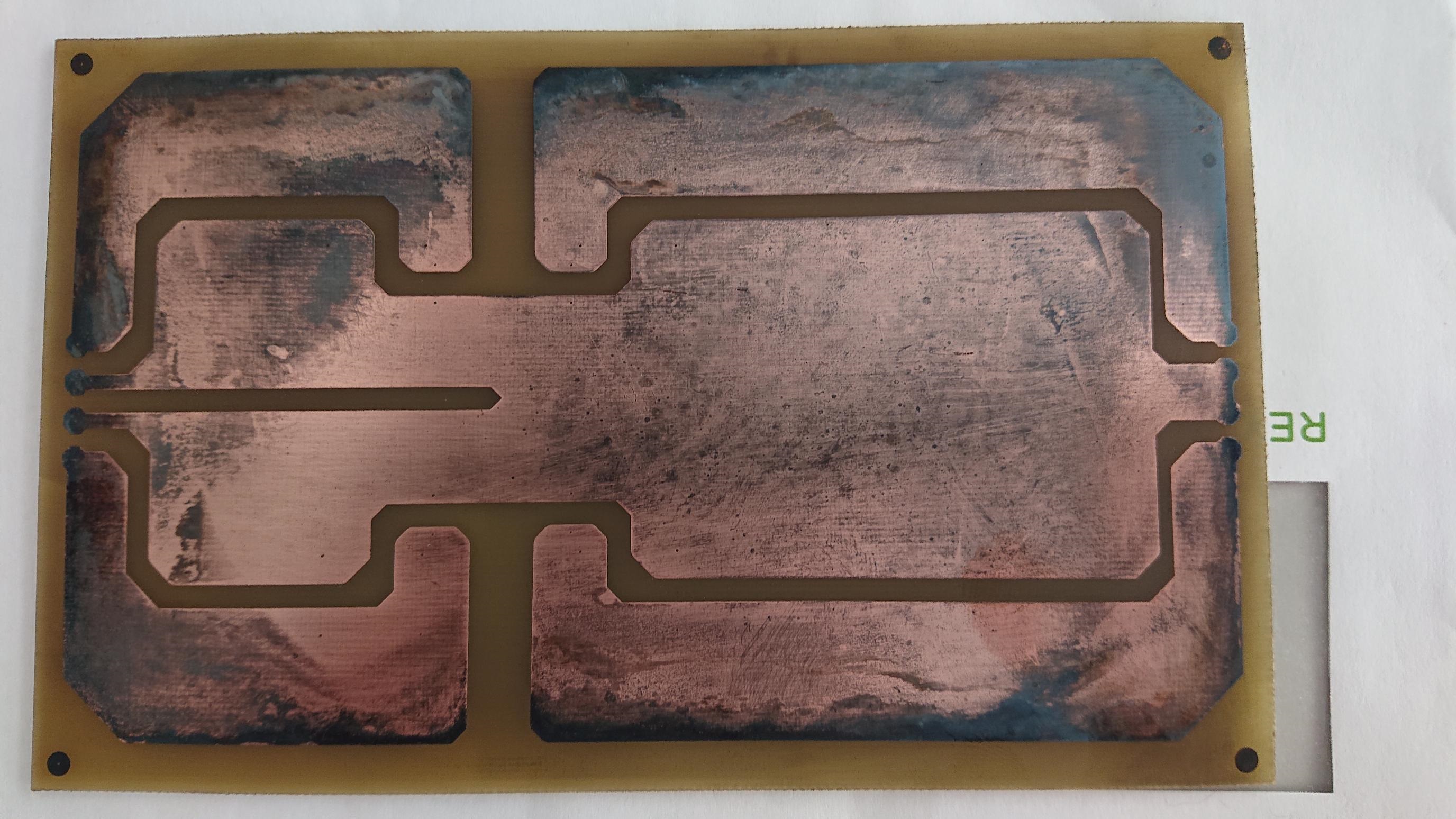

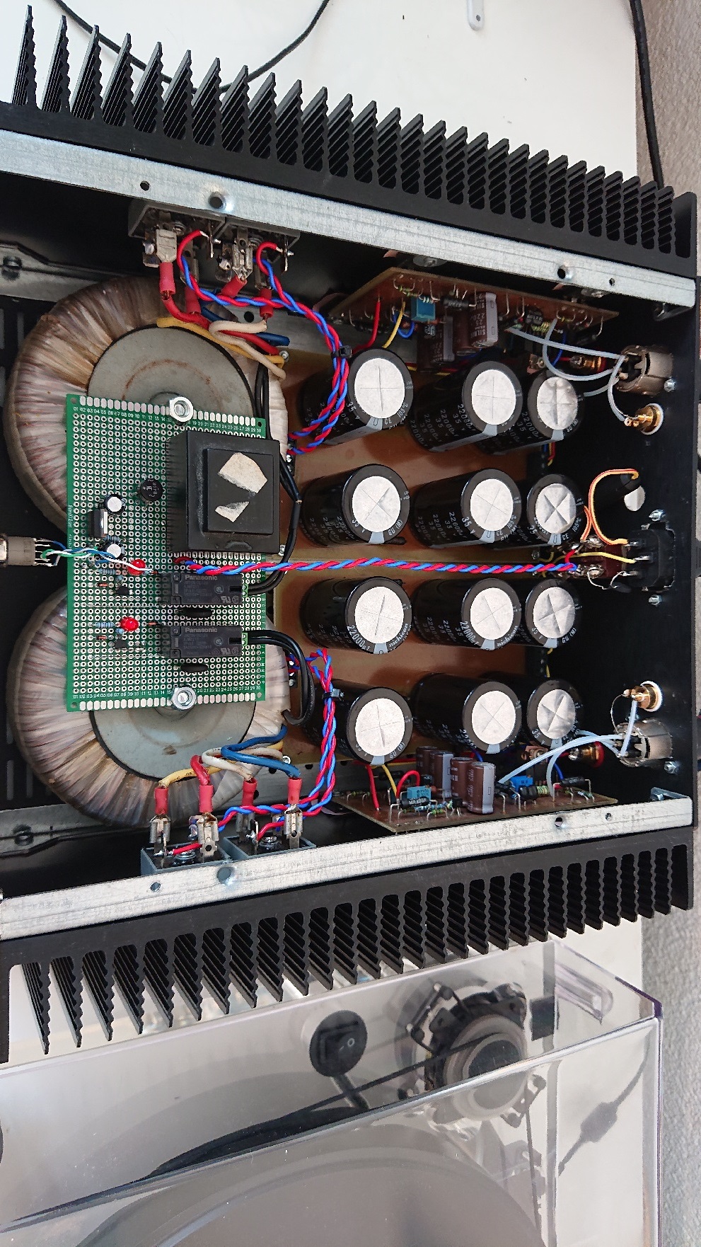

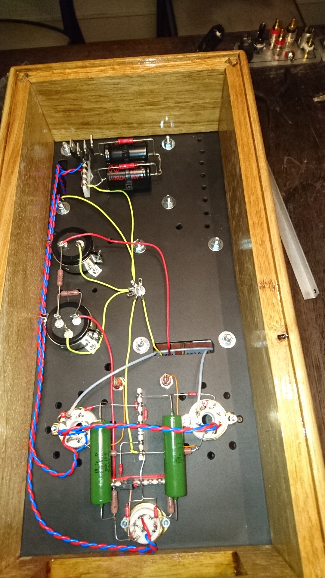

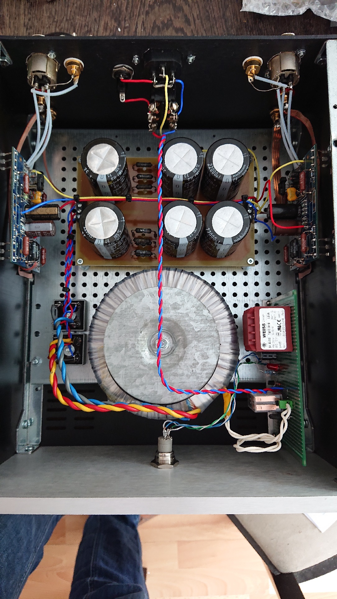

Ok, most things are sorted. For reference I'm going to attach a pic of an aleph-x I just build. It is dual mono but using crcc. It will give a visual example. I also attached a pic of the psu pcb's used (it is pretty old en dirty). This is pretty much the layout I would suggest.
look at a couple of things:
- pcb entry is on the left. You can see that there is only the psu lines coming from the rectifiers. They are separated not joined.
-The ground lines are kept separate until the end of the psu line. The last caps at the output. This would be the last caps of your supply on the right (top). (both in the schematic and the pics).
- Not visible but present. The output of the psu pcb on the right of the pcb gives options for grounding. there is one yellow wire going to the central star earth point. This is made with a bolt, nut and some wire lushes tying all grounds together at one single point (this is are just underneath the pcb's at the output in the pic). Connect the ground of the incoming ac inlet and psu trannie screens (yellow wire) there. I'd suggest using one of the bolts for fixing the ac psu inlet to the chassis.
- your pcb gives the hint of using an isolated cinch input. Use it and connect incoming signal directly to the pcb. Ground and positive signal wire. This is how i do it but the way AllenB described it is also valid. Uses an uninsulated chinch. Both ways are done commercially as well but most of the time you see the isolated version. I prefer that one personally and you can experiment with that
-Your pcb gives a connection for the loudspeaker return (ls return in the schematic). I would not use it but connect it to the psu ground out. like at the output of the pcb. You can change to the pcb ls return ground without risk. Try both. an extra pic is added showing a aleph-j. Hard to see but the speaker returns connect to the output of the psu.
- Hint twist ac carrying wires and those that carry large currents on dc.

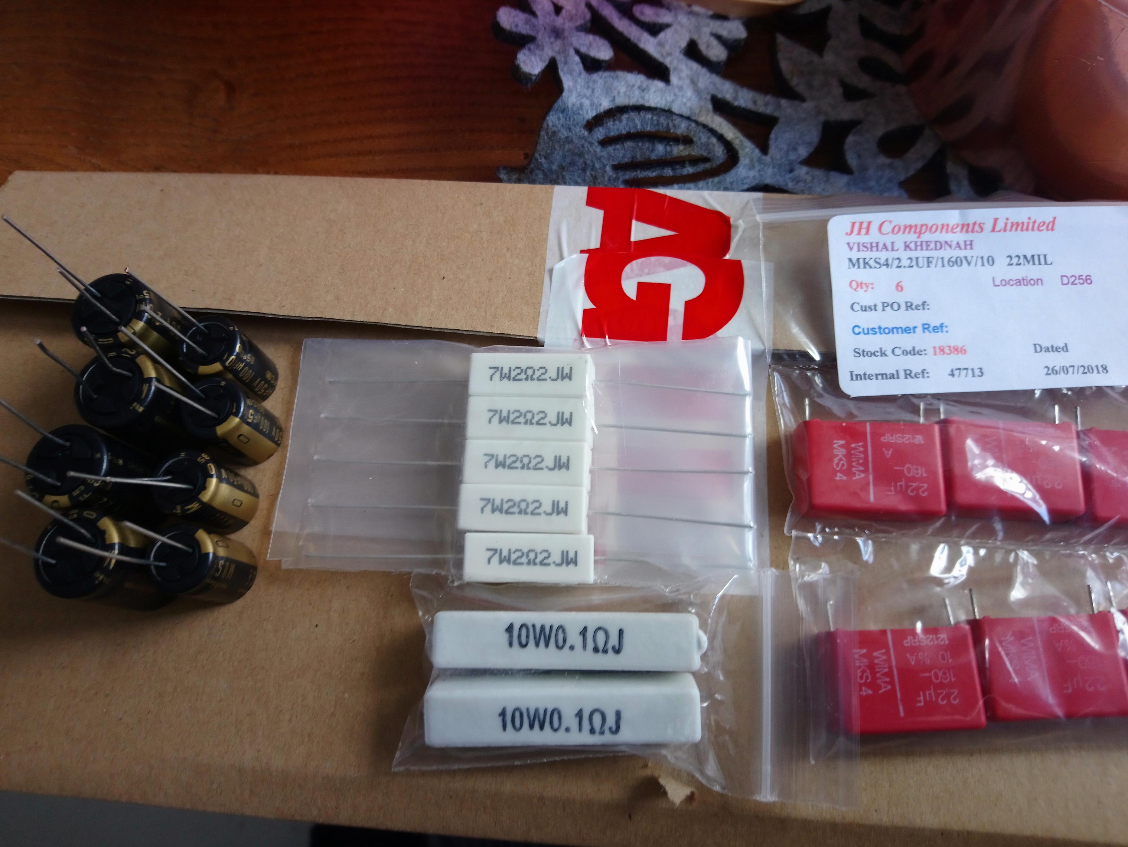

For the moment I bought 5x2.2R and 2x0.1R to test the PSU, then I'll buy more for the second PSU.
I realise the caps are massive, if it makes it better I can certainly buy some lower capacitance ones for the first caps.

Ok, now i understand. Was worried a bit about the numbers but this is fine. Tough i agree with Eduard on the value of that first cap we've already taken measures to control the charge pulses on that first cap with the ,1r resistors.
It's up to you but i would like to see you get it working before buying more components. We are probably going to run in to some issues along the way and i want to minimise the risk at unneeded cost.
Once everything is up and running we can go and look at optimising and tuning components. However it would be a nice learning excercise to try and find a lower capacitance but good enough first cap. For that you would need to get back to psu designer.
The trick there would be to look at the max current going in to the second cap. You would want the lowest value capacitance that has a slightly higher ripple current rating. That way it will be able to supply the needed current to the second cap. luckily you have those nice chokes. They will lower the needed current.
