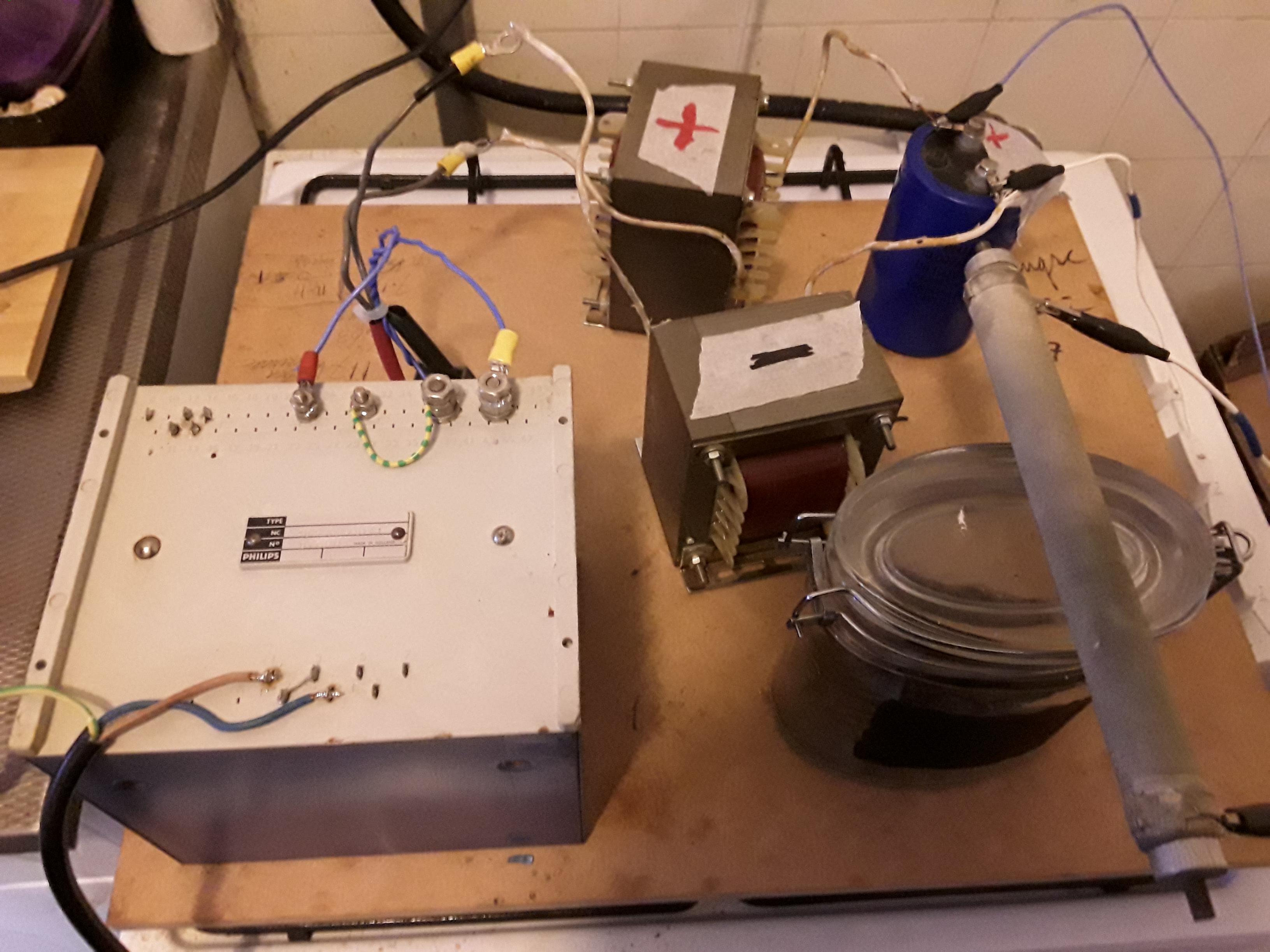

P.s in the attachment you can see how i tested a single rail choke input power supply with a big power resistor ( 15 ohm 200 watt) with a big Philips transformer Philips
You will need two of those because there is just one secundairy for each channel. ( in fact two put you need to put them in series to get the right output voltage. It is a nice transformer from decades ago probably made for some medical or other high tech application. There is a static screen and i assure Philips people know how to make good stuff.
I used two big chokes for the input chokes then a cap then the LL2733 in common mode then the last cap.
This is for a class D amp and i got close to 29 volts on the last cap. This amp needs that to have higher output. If not i could have used the LL2733 as input choke and be happy with 24 volts or so.
I used two or 3 A rated diodes but because of choke input they will not blow even with a 15ohm load! See you in september probably!

The power supply in the photo took me maximum two hours to build. You can see that but it was just build to check the output voltage. You can do the same.

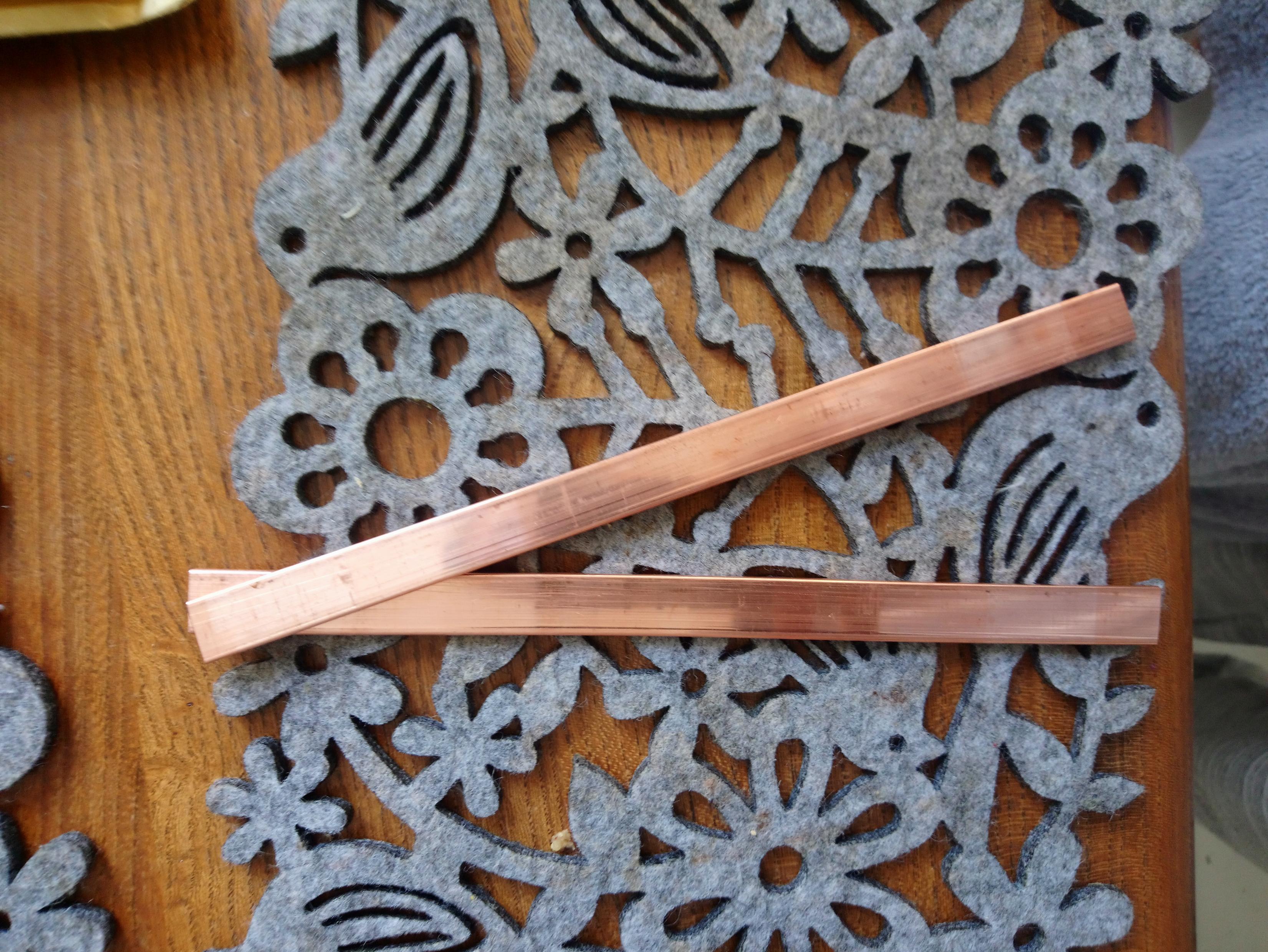

Bus Bars arrive
Copper Bus Bars finally came!
But now unfortunately i am being dragged to go on holiday tomorrow, i would rather have peace and finish building this but the wife isn't going let me.
