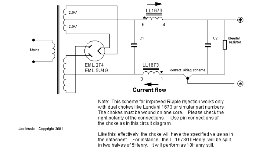

No, high current pulses put much greater stress on the transformer secondary than continuous conduction. The choke needs to have sufficient inductance to ensure continuous conduction. Check ANY textbook.
Well, the second "no"...
Actually, N101N's reasoning means that the power supply transformer will be relieved
Another possibility is that you don`t understand.
They need a minimal current draw.
When a poorly implemented choke supply rings, I'd say do a better job 🙄
A well implemented choke supply works well.
Of course.
Firstly, it is essential to differentiate between "choke input filter", LC, and "capacitor input filter ", CLC. The switching conduction mode is more efficient than the continuous conduction mode. Higher efficiency implies higher conduction losses and lower thermal losses. Reduced conductivity implies reduced electrical stress.

In practice, I found that is better to have a resin potted choke for less audible noise from choke itself. For electrical noise, other members like 50AE mentioned the AC/DC requiriments, for not saturating them; the noise becoming far worse when it saturatesWhat chokes are you all using when implementing a choke input filter? I have attempted a choke input several times and tried a variety of chokes, some modern and many vintage, but have not kept a choke in the first position in the final design. I have a purpose built listening room that is very, very quiet, and choke inputs have always created mechanical buzzing in the choke mostly, but less often in both choke and transformer. This buzzing noticeably increases the noise floor and, more importantly, annoys me. Any suggestions for chokes that will be silent in the input position would be much appreciated,
+1 for andyjevans small 1-2µF input capacitor for helping with noise
In sum, better to have a 100% dedicated choke made for LC input
Not just resin potted, but also (more important) vacuum impregnated.
Some core materials are extremely fickle when it comes to noise. Not every potting material works. Sometimes you need hard as glass epoxy. Polyurethane potting compound or ceresin won't always cut it. There are two sources of vibration - the core's magnetostriction and the coils. For the coils, where the issue comes more to power transformers, you need vacuum impregnation with thin lacquer, but potting helps too, because even a sturdy winding can excite the whole bobbin to vibrate.

You never know how this performs. And the voltage spikes can be quite heavy.
I haven’t used choke input because it hasn’t worked properly every time I tried it. In some respects the tube regulated power supply in the Loesch Legacy is what is most interesting about that amp. Tube regulated power supplies would seem to give both low DSR, and low ripple without chokes. However, complexity is substantial and energy consumption is high as well. Still worth a try though as I have not yet built or experienced this type of supply
With a regulated power supply you have another amplifier in the signal chain....
SE is class A by definition, so IMO a regulated power supply should not be necessary.
When used to overcome LC input filter supply problems you're on the wrong track.
When power supply transformer and choke are made for the application, LC input supplies work well (at least in my experience...).
