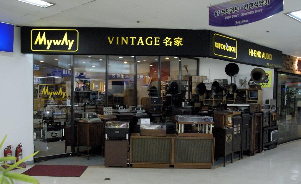

My ideal is always good, massive iron. No Zotl, NO OTL.
Just good, expensive and rare iron. The more, the better. Thats an audible pound, which pays off well.
And as I'm no genius audio designer, just trying to avoid mistakes is a big achievement.
A fully functional design, massively overdimensioned sounds most often great and avoids much calculation.
Sometime, pics show more than words.
