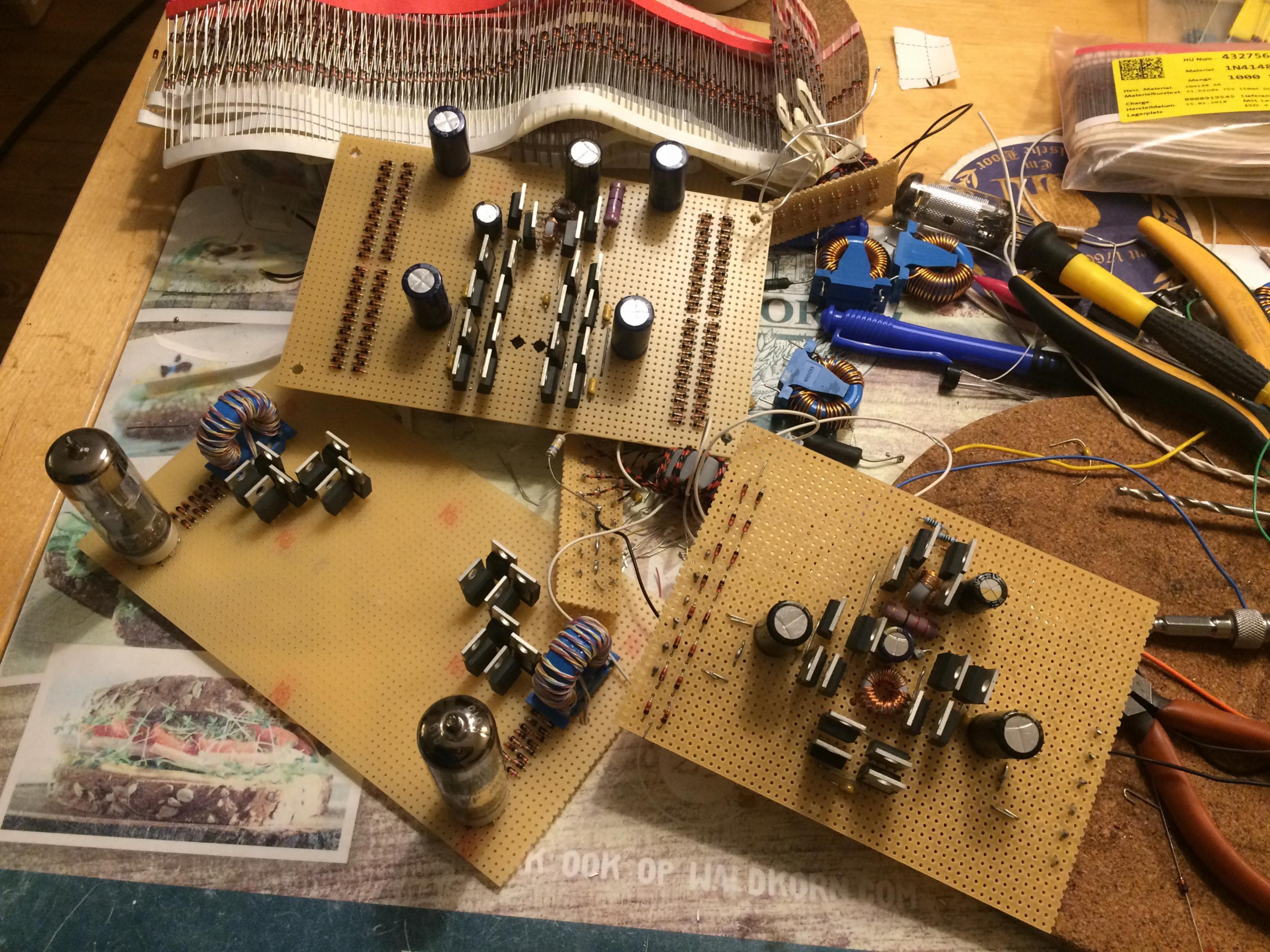

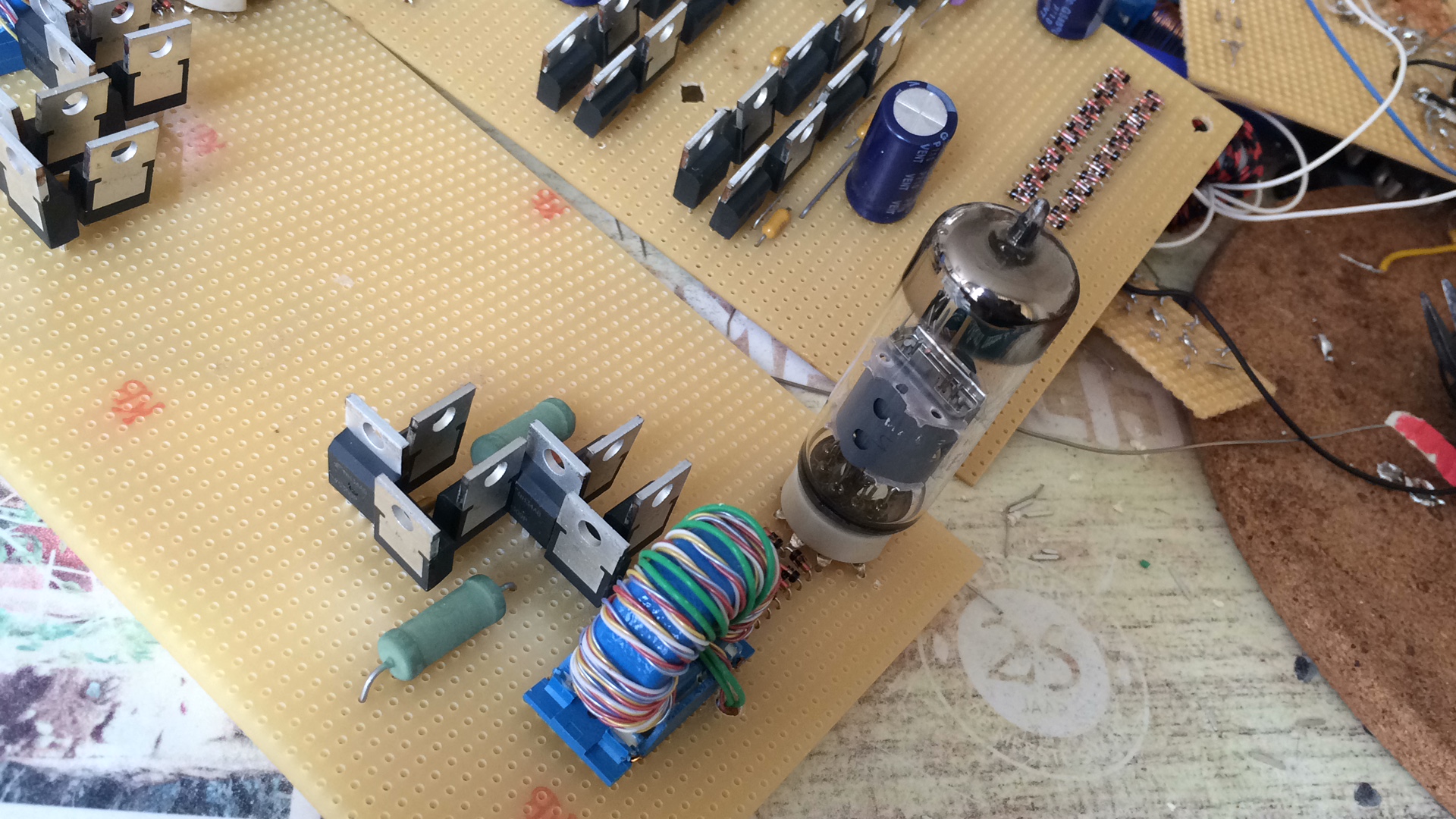

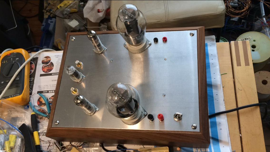

Some maybe know that i am a big fan of Zotl technology and i have build many amps using this technology including a SE 300b amp. This is the cleanest 300b amp i have heard so far plus it has the most accurate bass response of any SE amp out there (theoretically down to DC).
My new project includes this technology as well even in the driver stage. In this way i do not even need any HV power supply.
People claim to be purist but never heard a 300b in its purest form.
If you are interested then try to audition the Siegfried 300B or build one yourself as this is the DiY-audio forum isn't it?

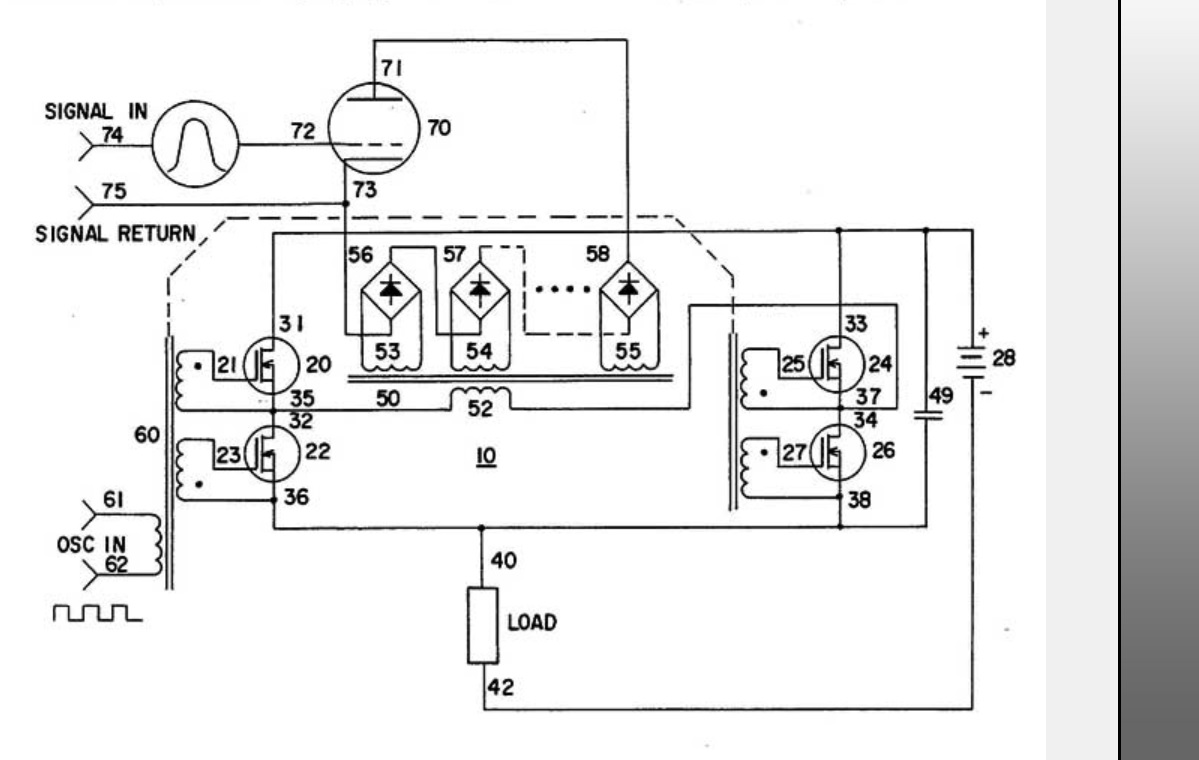

Some maybe know that i am a big fan of Zotl technology and i have build many amps using this technology including a SE 300b amp. This is the cleanest 300b amp i have heard so far plus it has the most accurate bass response of any SE amp out there (theoretically down to DC). My new project includes this technology as well even in the driver stage. In this way i do not even need any HV power supply. People claim to be purist but never heard a 300b in its purest form. If you are interested then try to audition the Siegfried 300B or build one yourself as this is the DiY-audio forum isn't it?
Tube amplifiers for high-end audio by The David Berning Company
I had to look up David Berning's Siegfried. Very different. Don't know what Zoti technology is, though.
Zero Hysteresis Output transformer less.
Please understand that this is not an OTL as such but it behaves like one.
The impedance converter is a HF circuit that converts low voltage to the needed high voltage for the tubes and at the same time will convert the LF audio from the tube (Class A or B whatever you desire) back to the low voltage side and to the load.
