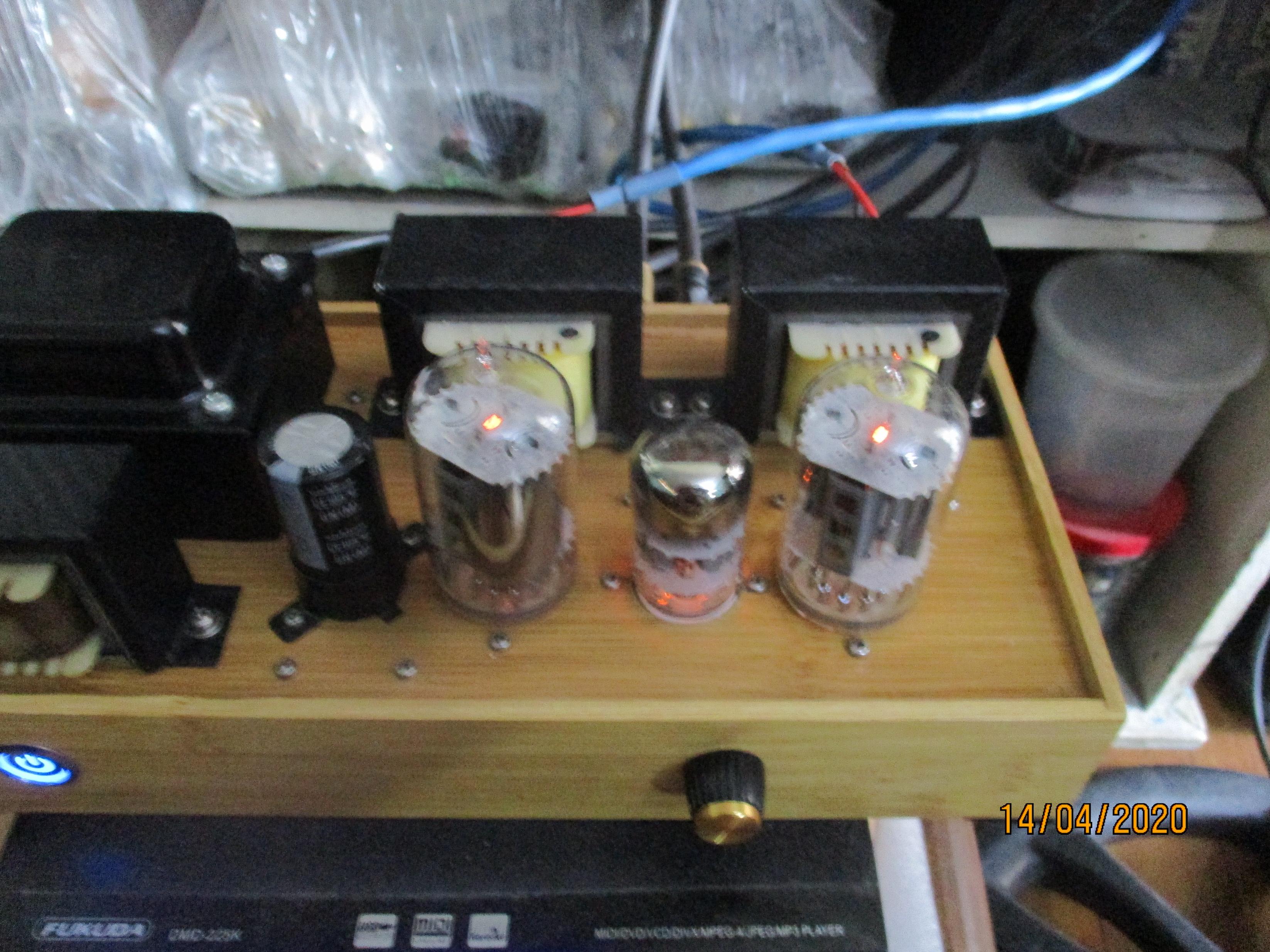

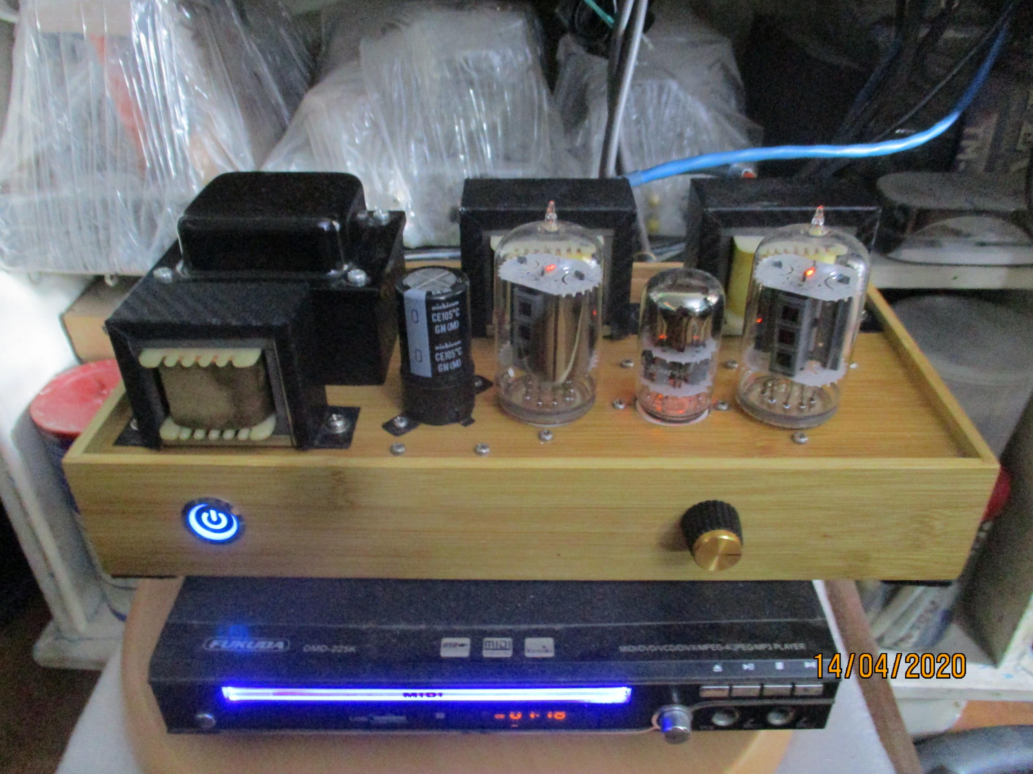

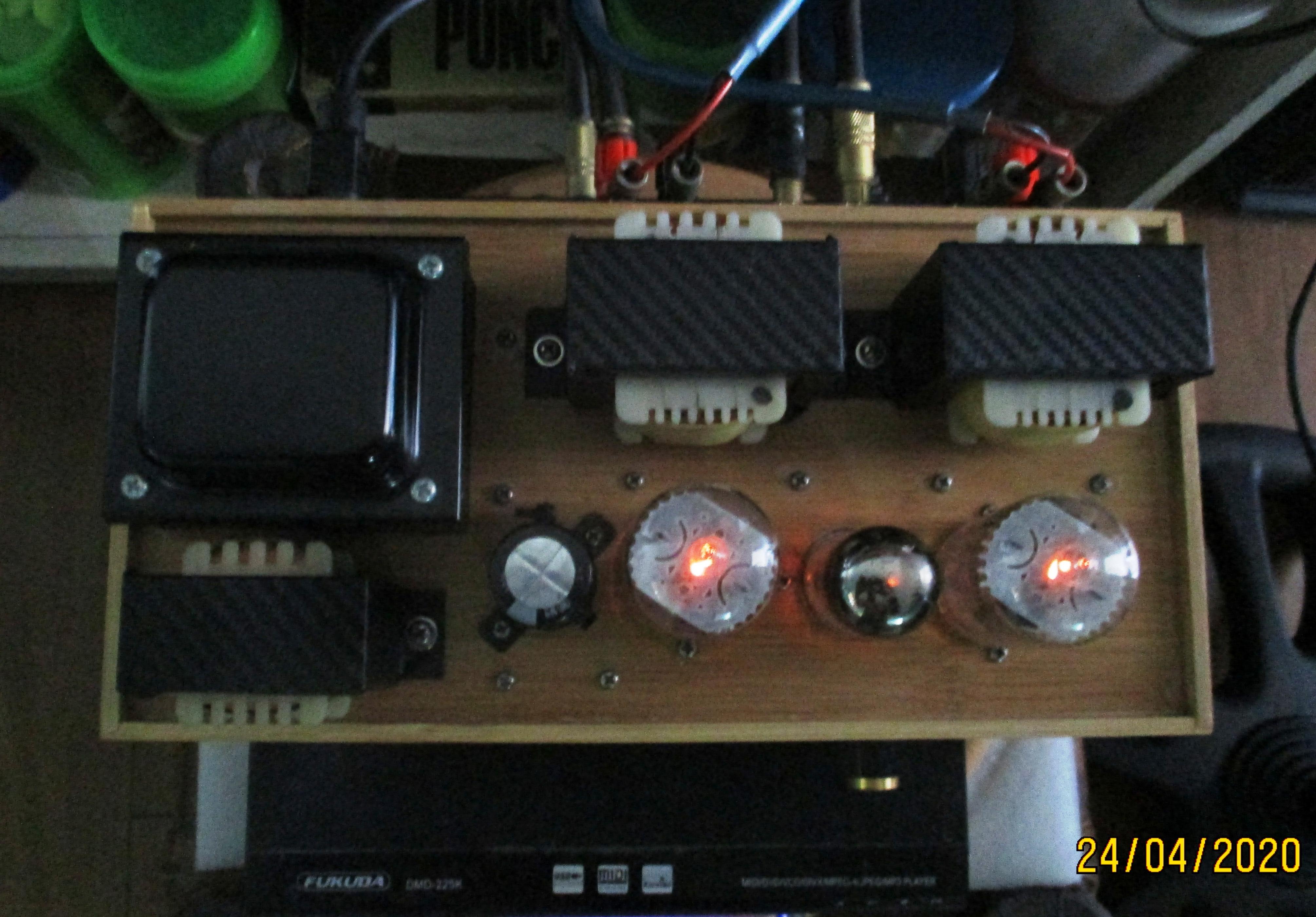

been there, done that, 12gt5 single ended pentode voltage amp is 6bn11 dual pentode, i made a facility for global feedback but since the amp was Shaded, there was no need....i love pentodes too....

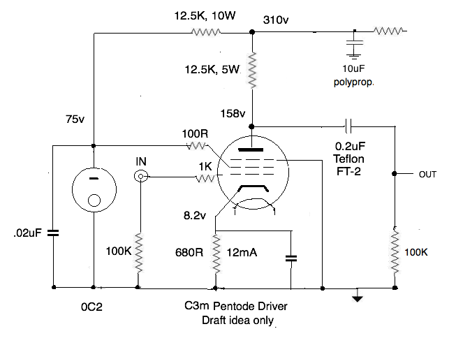

Since the OP was suggesting C3m, can you guys look at this pentode model and give some constructive feedback as to what to improve? I've never used a pentode driver before.

I'm OK for wire wound resistors - have plenty, thanks. Does the operating point make sense? Is 75v on the G2 right for around 150 on the anode? Is 12mA about right or what? It gives a 12.5K anode resistor which looks OK as long as there's a cathode bypass cap. I'd prefer to avoid that with a lower value cathode resistor and more current but I read that you should use a resistor on the anode and not a plate choke.

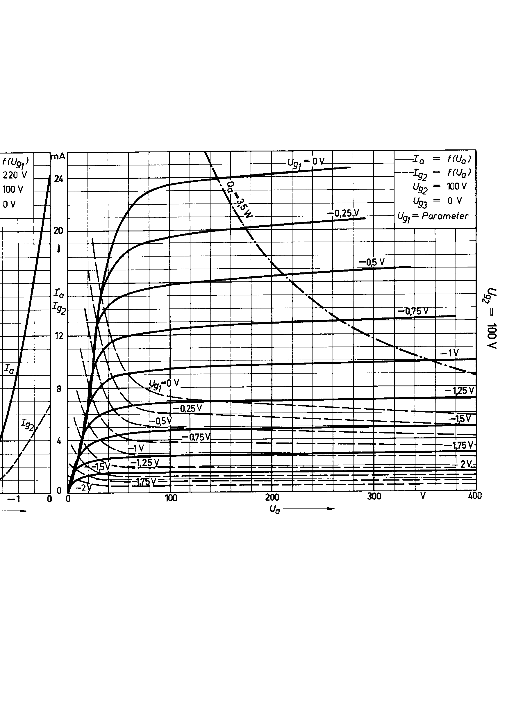

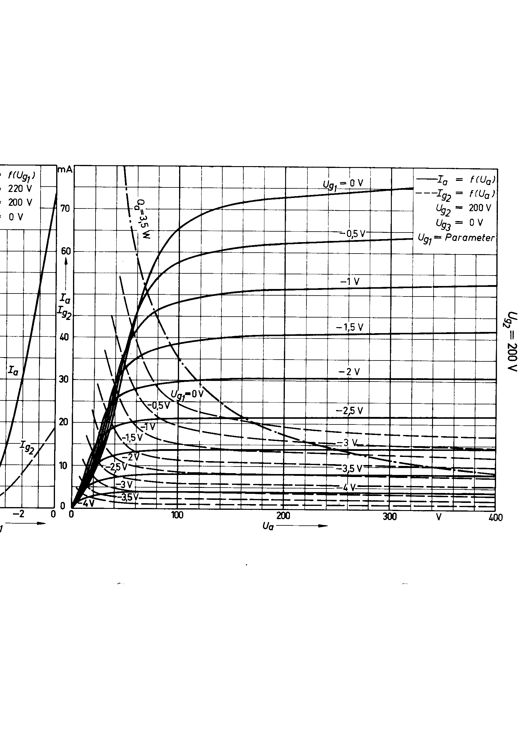

Heres two datasheet curve sets,
I think 200V G2 voltage has more evenly spaced curves right around 10mA or so. So is likely to be more linear. And have slightly lower distortion.
But if you want some higher 3H i suggest the 100V working point.
You can polder* it and meet somewhere in the middle. at around 150V G2 current, this is the best of both worlds IMHO so you dont have to cook the screen grid.
Polder* means wetlands in Dutch, we have some consensus driven decision making that mostly ends up being: lets make everyone happy and meet in the middle. I know politics is not allowed so thats the end of it as an adjective it is so common here.

Heres two datasheet curve sets, I think 200V G2 voltage has more evenly spaced curves right around 10mA or so. So is likely to be more linear. And have slightly lower distortion. But if you want some higher 3H i suggest the 100V working point.
looks good to me...plate is at half b+ for maximum swing, g2 is regulated at 75 vdc....gm at 12ma cathode current and 150 vdc plate is around 3.5....therefore voltage gain is (12.5k*3.5 ma per volt) around x44...if you do not need this much gain, you can decrease the 12.5k to say 10k or even 8k....

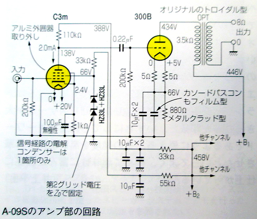

Thanks guys for the material on the C3m - very helpful.
nicoch58 - as luck would have it your schematic also runs the C3m at 12mA, so I can't have been far wrong. I just used a glow tube, and had a bit less B+ voltage.

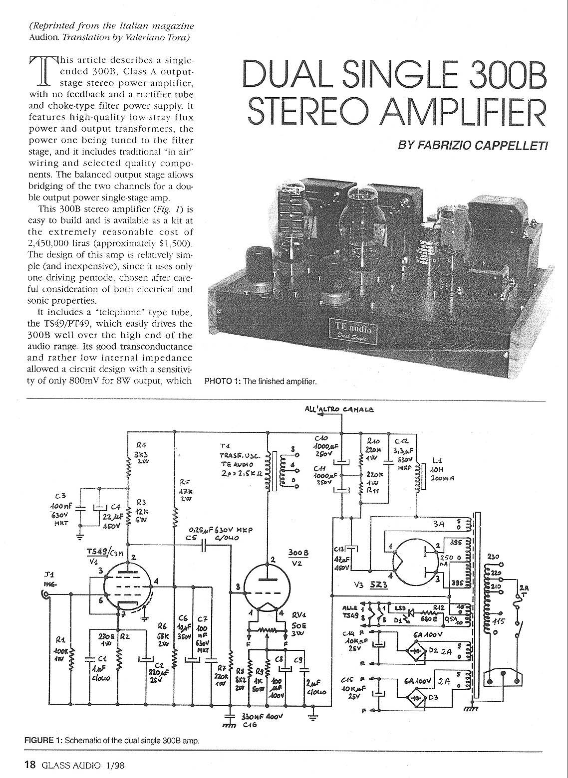

There are no voltages I can see on the Glass Audio schematic, unless I'm missing something. I have no idea why designers omit such essential data. Maybe it says something in the text. But thanks - useful info.

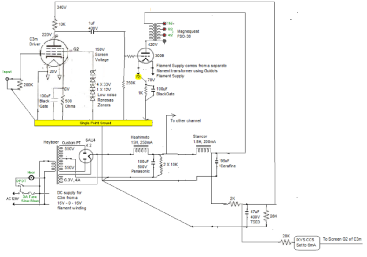

Bill Brown,
The 10uF across the parallel resistors in the SV83 screen voltage divider needs to be taken out (removed). Otherwise that capacitor passes the B+ ripple directly to the Screen, and on to the 22uF to ground. A 10uF/(10uF + 22uF) ripple divider.
The bottom resistor in the divider has the only cap that is needed (22uF) for the Screen resistive voltage divider.
The cross wiring of the rectifier plates is a good idea if the 2 rectifiers are not well balanced, one to the other.
The 0.68 Ohm resistors that drop the 6.3V to 5V for the rectifiers is a good idea.
It acts as a soft start for the rectifiers, because of the low cold resistance of the rectifier filaments.
