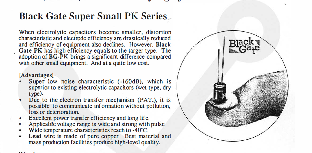

Attached a piece from the black gate capacitor series data sheet, its utter and complete bull. I actually could NOT find a datasheet with the most basic of parameters like ESR and ESL, cause if that exists, people can figure out how to make a 7 dollar industrial capacitor sound like a 75 dollar black gate with a 25 cent inductor.
But claiming that your capacitor leads are made out of "Quote pure copper" Is COMPLETE AND UTTER BULL. as ALL capacitor leads except for Aliexpress stuff is made out of PURE COPPER.
I disagree with mostly everything you said and especially this. There are reputable capacitors, such as Rubycon ZL that have steel leads.

There is a French expression that says: the exception confirms the rule, that the Rubycons have tin plated steel leads likely indicated an engineering decision to increase mechanical strength at the expense of slightly worse conductivity. Or to save on copper.

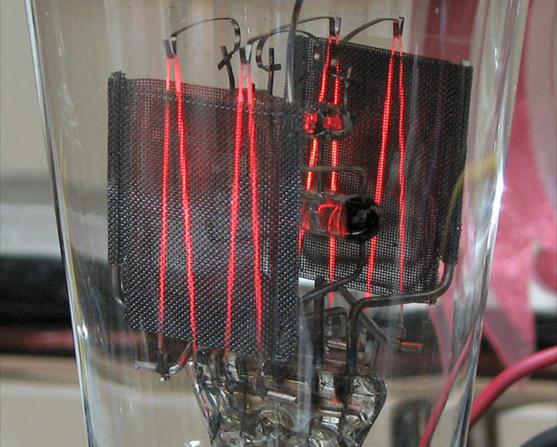

Well, indirectly heated tubes use a nickel cathode as you may be aware of. The composition of this nickel is the dominant factor behind vacuum tube lifetime. And without it you cannot make long life tubes. Behind that is the quality of the heater and the efforts put into outgassing everything before the evacuation straw is molten off and the tube is nearly finished.
Now during manufacture, these cathodes are coated with a spray gun to get an uniform layer of barium strontium and calcium carbonates on the cathode. This is emission liquid made by Heatwave labs in the states. Or by any chemist that can mix up the carbonate powders and make a solution that has the right viscosity. The binder seems to some organic compound that will turn into vapour at room temperature like paint thinner.
Once the tube is sealed and put upside down on the evacuaton carrousel, this carrousel uses vacuum pumps to draw out the air. And simultanoiously the heater is powered on at 150% of rated voltage. This carrousel then has induction heaters that glow all the tube parts red hot to get rid of all the gas into the pumps.
The industry dirty little secret is that they don't draw out all the air to an ultra-hard vacuum, but rely on the Barium getter to get rid of the remaining gas. Its been that way since tube time began, and some notable exceptions are the getter-less tubes made in the 20s for the postal service.
Getting simple things right like the mechanical tollerances of your grids, anode stampings and everything like that is not very hard at all. Its a question of maintaining and rebuilding your machines from time to time to replace worn-out bearings ect. Its a mechanical tolerance question. But getting the cathodes right is far more complicated.
Anyway, what i was getting at is that during some of the last steps of receiver tube manufacture the outgassing part, the cathode paste is reduced to oxides that can only exist in a vacuum. But simply having an oxide on the cathode doesn't give you emission. For that these oxides need to be reduced to a thin layer of metalic barium on the surface of a cathode.
Now it was discovered that trace metals in the nickel speed up this process, this means: less time and electricity wasted in the final step. But this is bad for lifetime. Therefore very high quality tubes back in the day used cathode nickel that was nearly 100% pure nickel, with a few trace elements to get the rigidity and flexibility required for the particular tube. (If its too hard to bend in your stamping machines its useless)
If you get nickel 200 billets from a supplier and send them off for for some other company to roll into strips you can use in your machines, you run the risk that your nickel has impurities that KILL the emission in a few 100 hours.
Judging from the Jacmusic site, Jac bought a batch of JJ tubes that had this problem, or were not activated to the correct schedule, and therefore he concluded that JJ had bad quality control.
In conclusion: using purified nickel for the cathodes is a sledgehammer approach to getting very long lifetime out of a particular tube, but it is expensive in production and takes up a lot of time on the machines.
