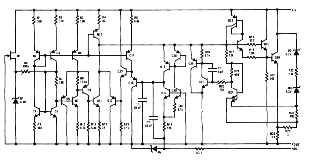

Its actually prettymuch the same for every three terminal regulator. NPN darlington ouptut pair, couple of current mirrors and a bandpass reference. Really nothing special.
LDO's particulairly fixed output ones sometimes use a PNP ouput device and sink the base current for the output transistor through the GND pin.
Linear regulators get a bad reputation for no reason, quality manufacturers make very low noise linear regulators. Yes there is a few uV-PP bandgap noise on the output but that is pink noise.
7805 can be 10uV PP self noise for example, which is nearly nothing. TL431 shunt reference can be 50uV to 5uVpp for the better grade Ti part.
The problem that people get, is they dont filter the supply feeding into the regulator very well. so a normal regulator may have 40db suppression or less at 1Khz harmonic.
You can make your own LM317 high voltage variant with a LM385-1.2 op amp FET and some extra components.
LM723 is insanely quiet if you use it right because of the temperature compensated zener reference. 10uV or so from the datasheet.
Attached LM317 internal circuitry.

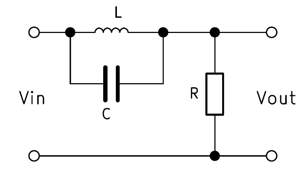

Each of those concisely formulated statements could be expanded into a chapter. They refer to previous, even more concisely formulated statements. An amplifier that blocks ripple components also blocks signal components. It is the task of the power supply filter to do that. Chokes can cover high frequency bands.
I beg to disagree with your previous assertion that LC filters will attenuate high frequency. Its a logical fallacy to compare linear regulators and passive LC power supply filters, as both will pass HF noise without any meaningful attenuation. Due to parasitic capacitive coupling.
This effect is amplified by the use of paper in oil motor run capacitors, whose self inductance means that they will increase the amount of high frequency impedance roll of dramatically, due to high equivalent series inductance.
If you use old paper in oil capacitors that are quite large, they have a rather high ESL and therefore no meaningful filtering characteristics beyond 10Khz or so.
Only the dreaded industrial parts are optimized for low ESL, ESL was of little concern back in the day.
See attached image, I have chosen to represent the impedance of the power supply capacitor as a resistance that increases with frequency.
