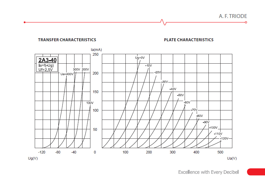

I have never been interested in the 2A3-40, simply because even its own manufacturer posts such poor triode curves.
See below: even at 400V, the ra is shifting, and the grid is losing control. This looks more like an indirectly-heated triode. This effect limits the usable operating voltage - and what's the purpose of a 40W rating if you can't use high voltage?
