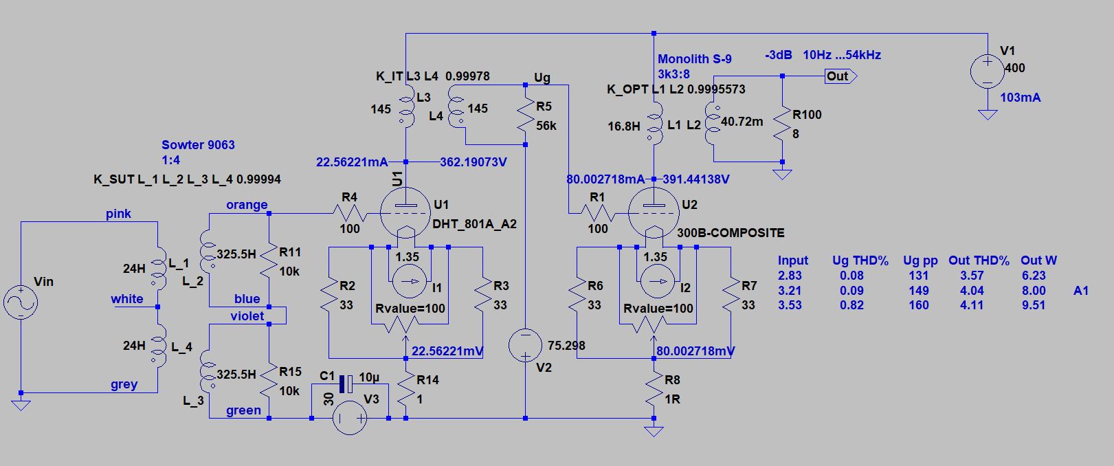

Sample:
1:4 SUT, IT loaded 801a, 300B, 3k3:8 SET.
NOS 10Y/801/801a are rare and costly, but Elrog now make new 801a too ... but it's costly too.

I hope LTSpice is not very accurate with the distortion figures for that circuit, otherwise it looks horrendous...especially for the price of those components.

2A3 gain is -about- half as 10Y/801 (about 8x), so 1:4 SUT + 2A3 hasn't enough gain to drive 300B grid swing (at 2V RMS input).
If power tube (300B) biased -for example- to 80V, the swing peek -to A1- is 80V, i.e. 56.6V RMS.
The required (VAS+driver stage) gain is 56.6/2 (grid voltage/input voltage) ... about 28.
If you use SUT with 4x gain (1:4, practically a little lower), the driver gain must be -at least- 28/4 = 7.... plus some headroom.

Thank you for the tutorial euro21.
In theory it seems like 2a3 driver isn't optimum but in listening it does not appear so. Lots of drive & very good prat factor
I've used both 6C4C (6B4G) and 46 as drivers and they were both excellent - as you say lots of drive & very good prat factor. That's a good description. But as Bela says, they don't have enough gain with a 1:4 step-up. Maybe with sensitive speakers they could work but on paper just like he says you want a driver with a gain (mu) of 7 or more. So I use a 10Y.
I don't use a preamp because I want just 2 tube stages, not 3. The 1:4 step-up might be considered a substitute for a preamp, but it's situated in the amp so it needs a typical 2V input. It drives my Wharfedale Program 30D-6 bookshelf speakers fine in my smallish room, which is 3.5 x 4.5 metres. I don't listen loud. Which is why I can use a 2a3 and don't need to go to a 300b.
The only way I would consider a third tube stage is if it were on the output of the DAC as essential amplification. I just have a ready-made DAC with an op-amp output. That could be looked at in the future but it isn't a pressing need.
