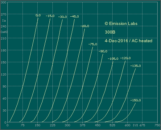

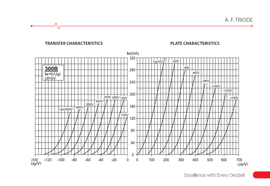

Compare it to the Same manufacturer's 300B:
JJ 300B
The EML300B shows little sign of ra-shifting, even at 600V+:
EML300B
I couldn't find curves for the ELROG 300B, but I suspect they might be good.

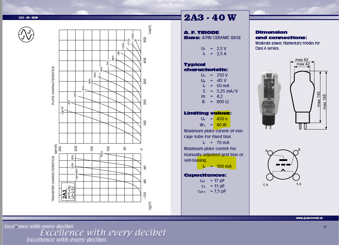

Maybe - but the usual operating point for 2A3s is at 250V. It may well work fine there.
But, the 2A3-40 claims 40W operation, and leads folk to think it can be interchanged with 300Bs.
The curves suggest this will not work well, since 300Bs are optimised for 350V operating points.
My understanding from JJ many years ago was that the 2A3-40 shares the grid and plate structure with their 300B and that there is no actual difference between it and the 300B except for the filaments. I have seen/heard amplifiers using these tubes producing around 8W on 400V plate supply.

Most data sheets showing curves for tubes are not good enough for comparison in most cases. This is because they are simply not that accurate, they represent an average expectation for behaviour. I read somewhere that the old data sheets from way back when were often drawn with the aid of french curves to create a smooth looking chart and had nothing to do with actual measured data.
With modern day measurement techniques, it should be possible and ethically responsible to present accurate curves.
Yes ancient datasheets were composites drawn by hand and fitted with french curves. Today that is obsolete technology.
