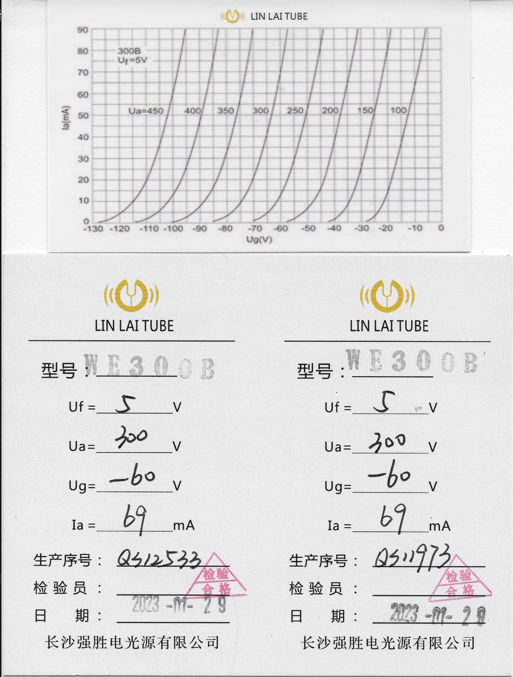

The only thing I have found from LinLai on their WE 300B is what ships with them.
“On Linlai's vacuum tube construction, she points out, "The E-series with molybdenum material produces a much stronger electron emission than other types of plate material such as graphite or hybrid plate,”
<snip>
Apparently molybdenum is used in filaments and supports very high operating temperatures without failing, and this might have an impact on filamentary emission and life?
I think you're being quite charitable but it's possible that is what she meant. But the same sentence says "other types of plate material" so I think the context is the plate not the filament. I'd bet the Chinese tube builders buy their filament material from the same source.
Given the technical market place in China I would be surprised if there were not a half dozen or more suppliers, it's not quite like here yet.
My other thought on the plate thing had something to do with secondary emission, but it could just be the usual marketing mumbo-jumbo, and that's not too unlikely. 😀
I have found such interview and my interpretation is a bit different, starting from the fact that salesmen and marketing people often get confused or are not accurate in technical descriptions. I think what she meant to say is that the E-series with molybdenum filament and permalloy plate has stronger emission than other types with different plate material and more traditional filaments.

From physical inspection and comparison to the photos on the Western Electric web site, I believe the WE 300B from LinLai is a fairly accurate copy. I don't have an actual WE 300B for comparison. However there are many photos for comparison on the new WE web site.
General appearance is the same down to the three side wings on the upper mica.
The overhung 4 support structure appears to be the same.
This is different on the EH Gold and Psvane tubes which have coil spring suspension of the upper filament points and 2 wings on the Psvane, no wings but a star pattern around the upper mica for the EH.
All have four upper support points and eight segments for the filament.
