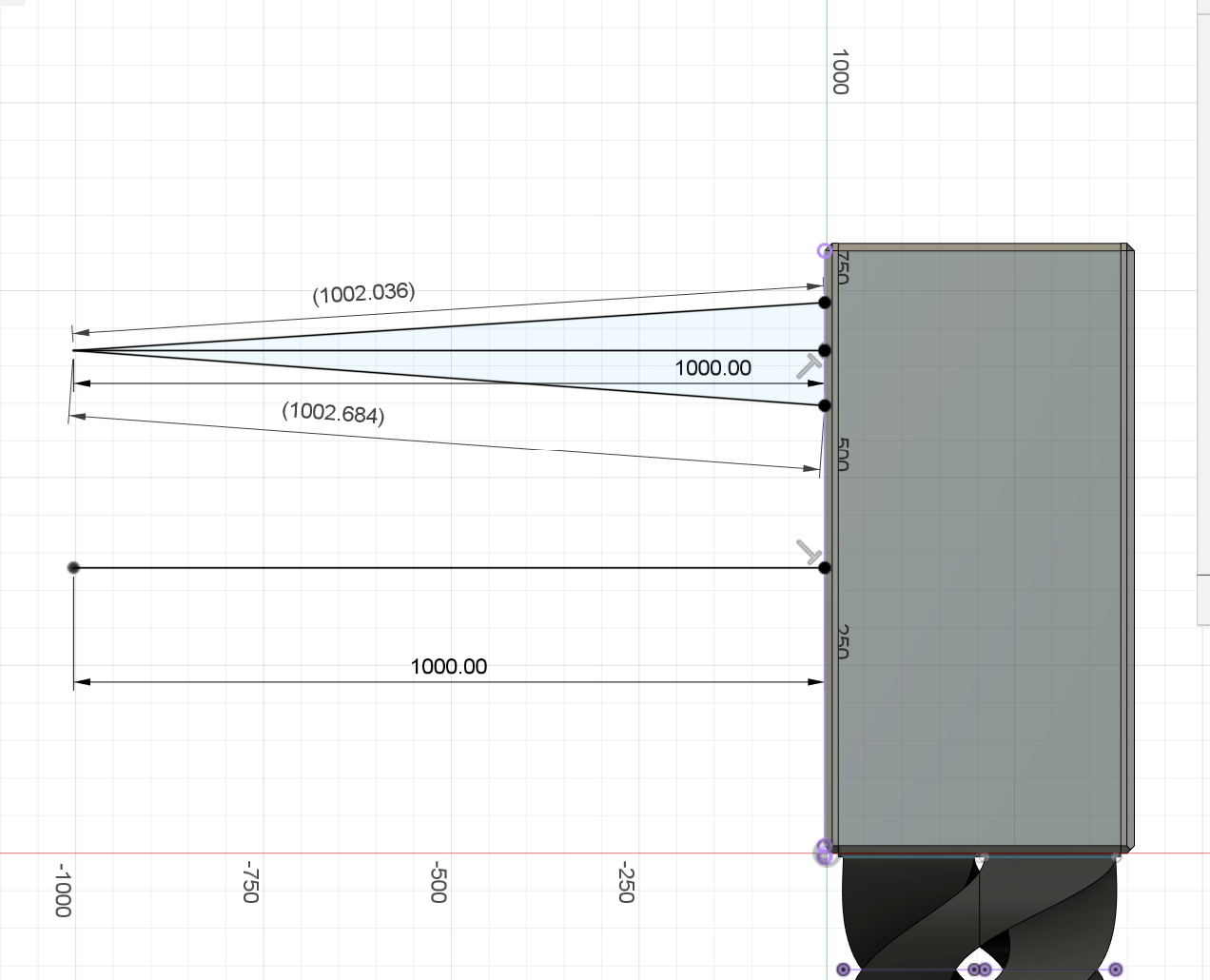

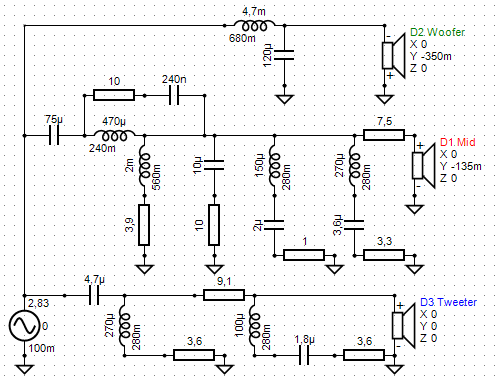

Looking at your first post my impression is you took your driver measurements each at on axis. If this is the case then this is the issue.
You must define your crossover design point Y. This is normally on axis with your tweeter.
Take a measurement of each driver at a fixed point Y 1 metre from the baffle.
Then use these measurements.

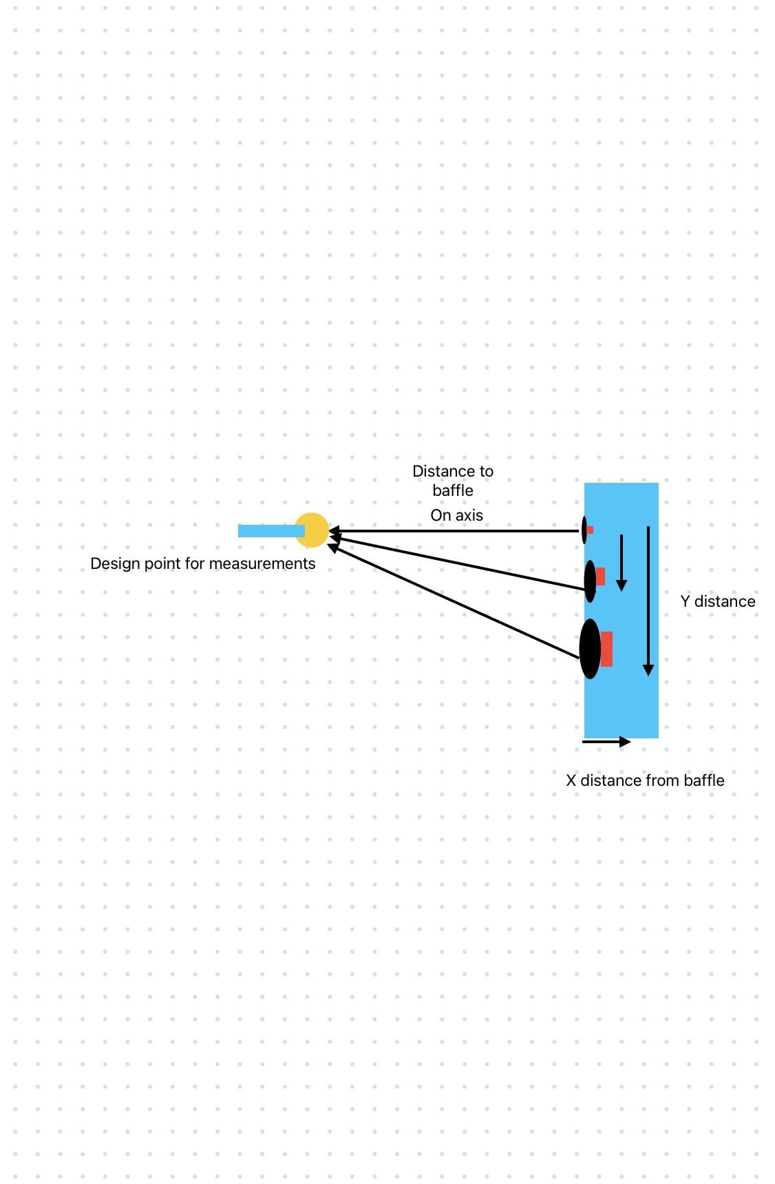

This is how you do it? Just set base measument to 0 and offset the ones that were measured differently? Good to know. I am still learning
It's not that simple.
Yes, the offsets could be used to manage certain idiosyncrasies in measurement, and for listening position differences and so forth. On the other hand if you don't include Y axis differences then you can't expect vc to simulate lobing for you and so you'll have to manage power manually.

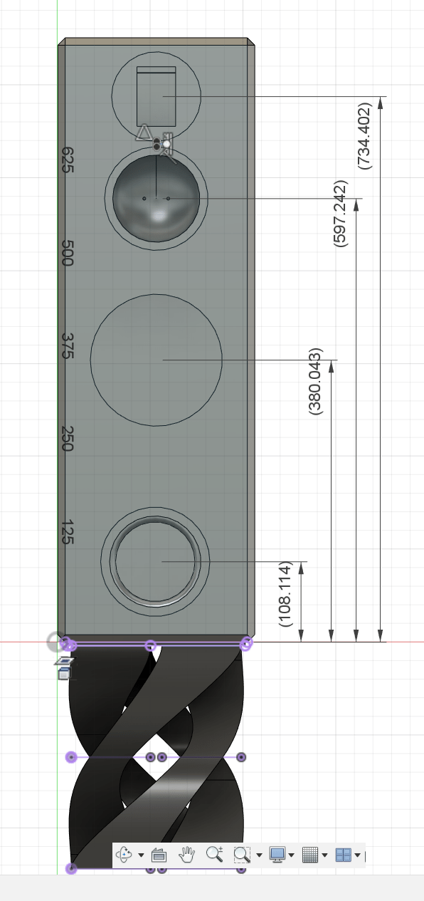

Sometimes a pic is easier to understand

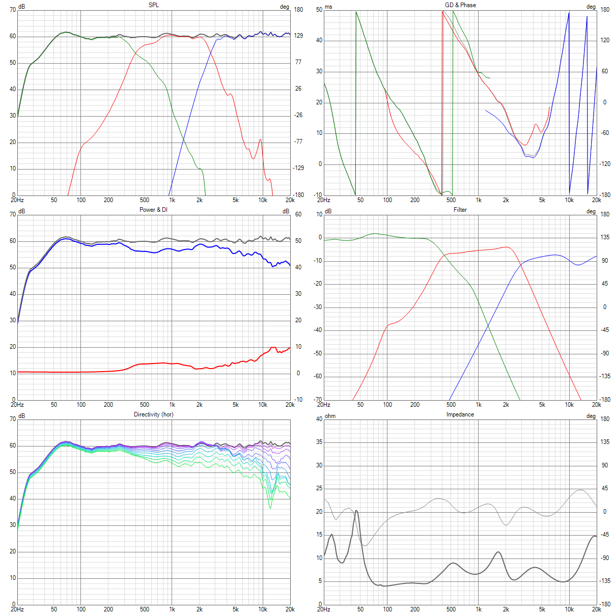

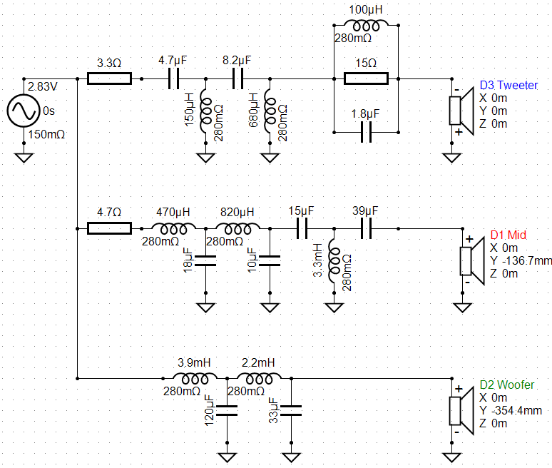

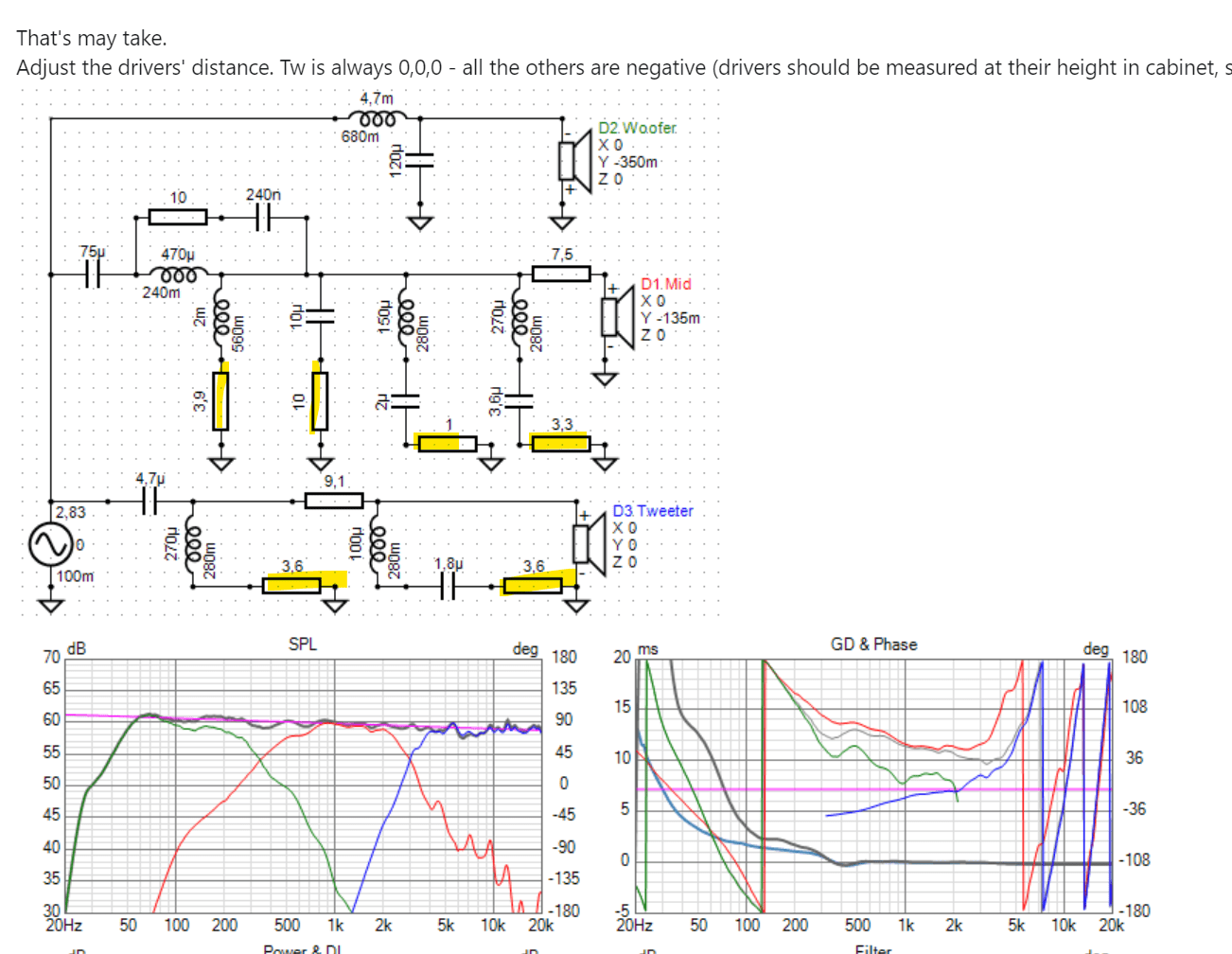

Got it, the cap in the woofer filter should be 100u, you have 10u
Yup, that was it! Alright, cool. We are all on the same page now!!!
I like how you used one section of the high pass for both the mid and tweeter. Thats an awesome way to save some componetry.
If his still looks different, post the tab that shows your SPL measurements and impedance loaded for the drivers.
They look the same now

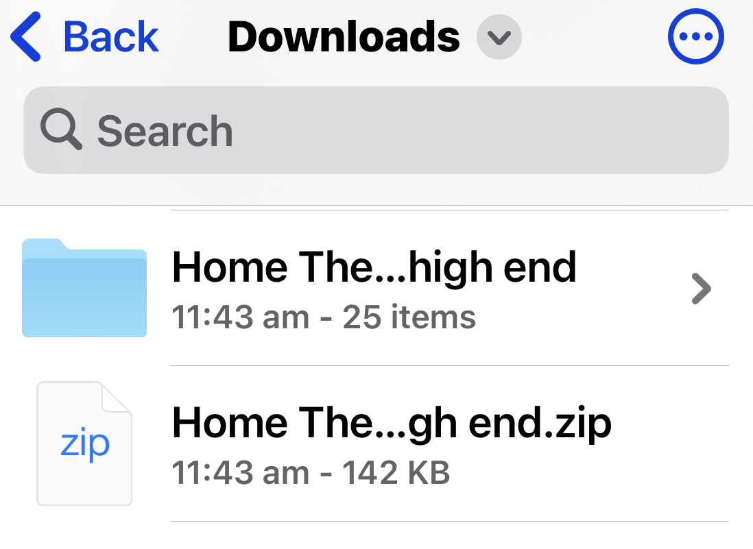

I am using an iPhone. I can’t easily open a zip. Try screen shots.

That's may take.
Adjust the drivers' distance. Tw is always 0,0,0 - all the others are negative (drivers should be measured at their height in cabinet, see vcad instructions).
Question:
What are the purpose of these resistors just before the negative connection of you filters? I've seen others use these. Are they just for fine tuning the filter?

Is 2.6mm really going to matter?
If this amounts to 137mm spacing on the baffle (?), this exceeds 1/4wl above 630Hz where it may make a difference.
I agree they're not always intuitive, especially where file operations are concerned. If you open Files/Downloads/ you should be able to click on the zip file to unpack it to a new folder.

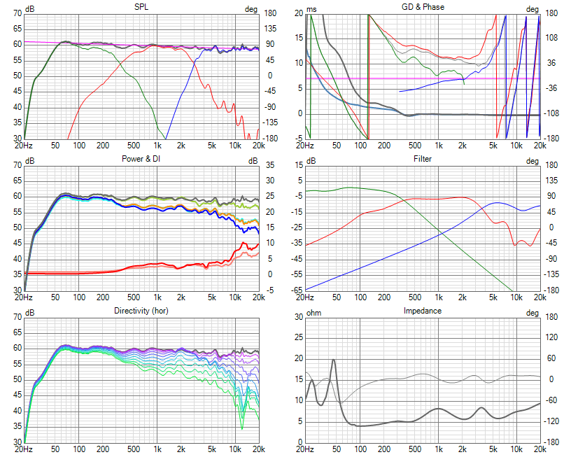

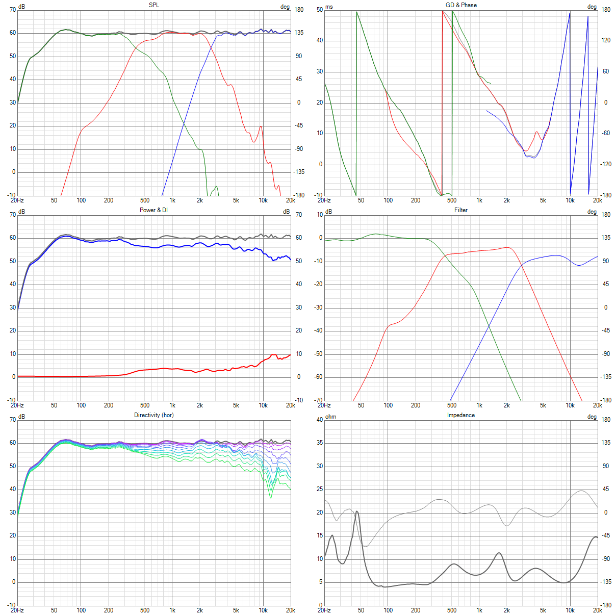

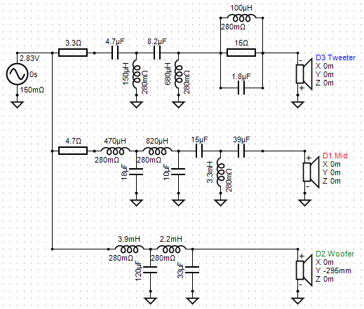

I'd like to offer up the following modified crossover design. I have added two extra components on the woofer, in an attempt to better attenuate the woofer's breakup resonances. These were relatively high in SPL. Note that the Y-distances were determined from the drawing of the drivers on the baffle, which was presented in the earlier thread. In this circuit, both the woofer and the midrange are connected with positive polarity.
Maybe you should build the crossover like this and listen to it. Then you can start again and try a less complicated design with about half that many parts. You improve an imaginary unicorn and in that process the whole thing goes down the drain.
Do you know there are world class speaker that only use a few parts in the crossover? Did no one tell you that any part in a passive crossover has a negative impact on the final sound? And a last one: You can make the response as even as you like, once you place a speaker in a room and play music, nothing of that linearity is left.
