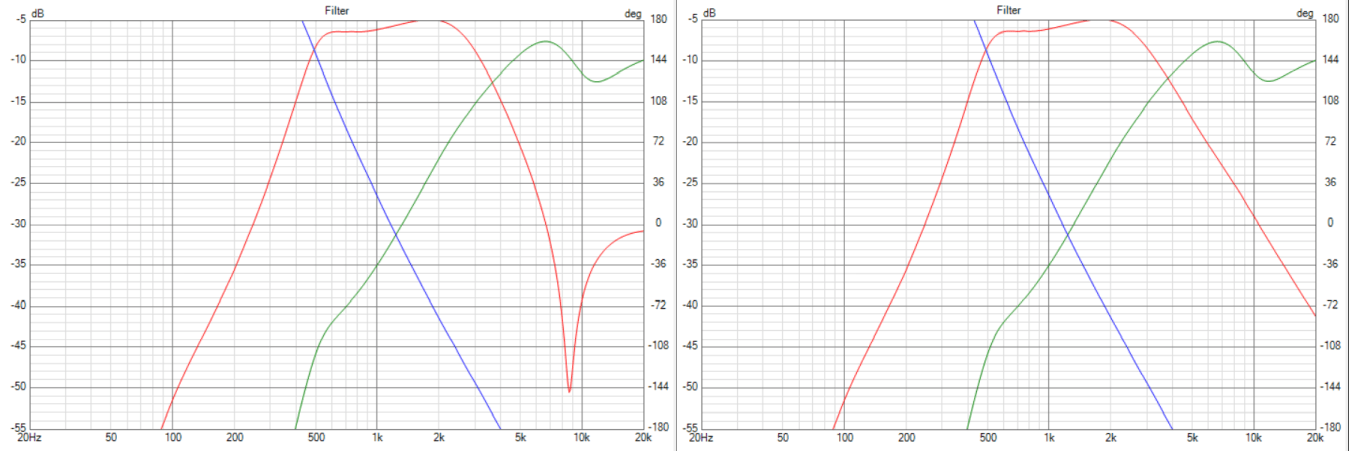

What is this going on with the mid crossover? That rise in XO at the highest end?
That's from the notch created by the 6.8u cap and 0.05mH coil to kill the peak in the midrange FR, you can see it better here (left) and also what it would look like if you removed the coil and connected the cap directly to ground (right):

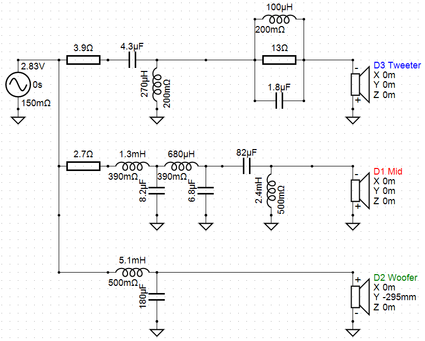

One tweak you should do with whatever xo you move forward with... Make sure all of the R, C, L values are standard values you can buy. For example if there's is a 0.68 mH inductor in VituixCAD switch between 0.65 mH and 0.70 mH since these are the readily available values. Also, look up the actual inductors you can buy and enter the actual DCR rather than what VituixCAD has estimated. Sometimes it doesn't matter, but sometimes it makes enough of a difference that you may change a component value to compensate.
Yeah I usually have to tweak the whole thing again when I start actually finding what values of parts I can actually buy

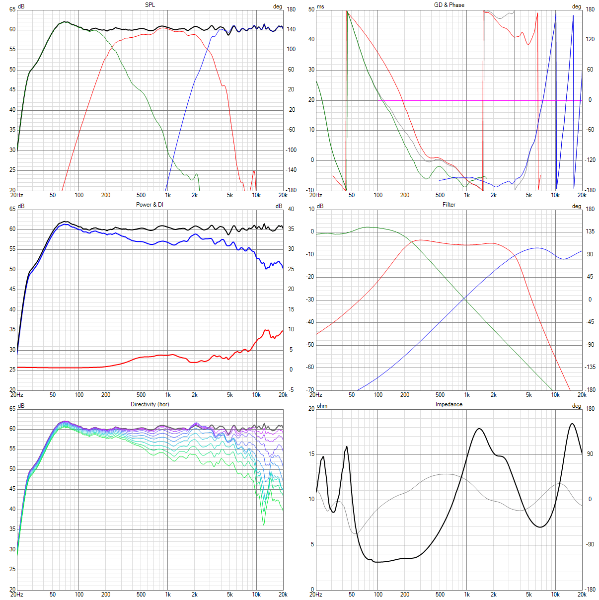

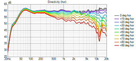

It doesn't work that way. You have to input value for the mid "Y", i.e. distance from tweeter to mid axis, lets say Ymid=-130mm. Your 2.6 mm is value for mid "Z". Both Y and Z influence vertical directivity (lobing).

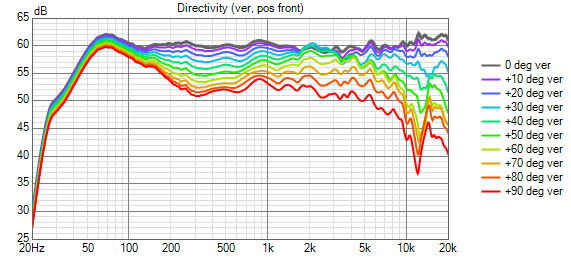

Cancelation is only in the vertical directivity (which is normal):
Here is the horizontal directivity of the same crossover:
Flip the polarity of the woofer. 🙂
Lol, missed that.... that will surely do it

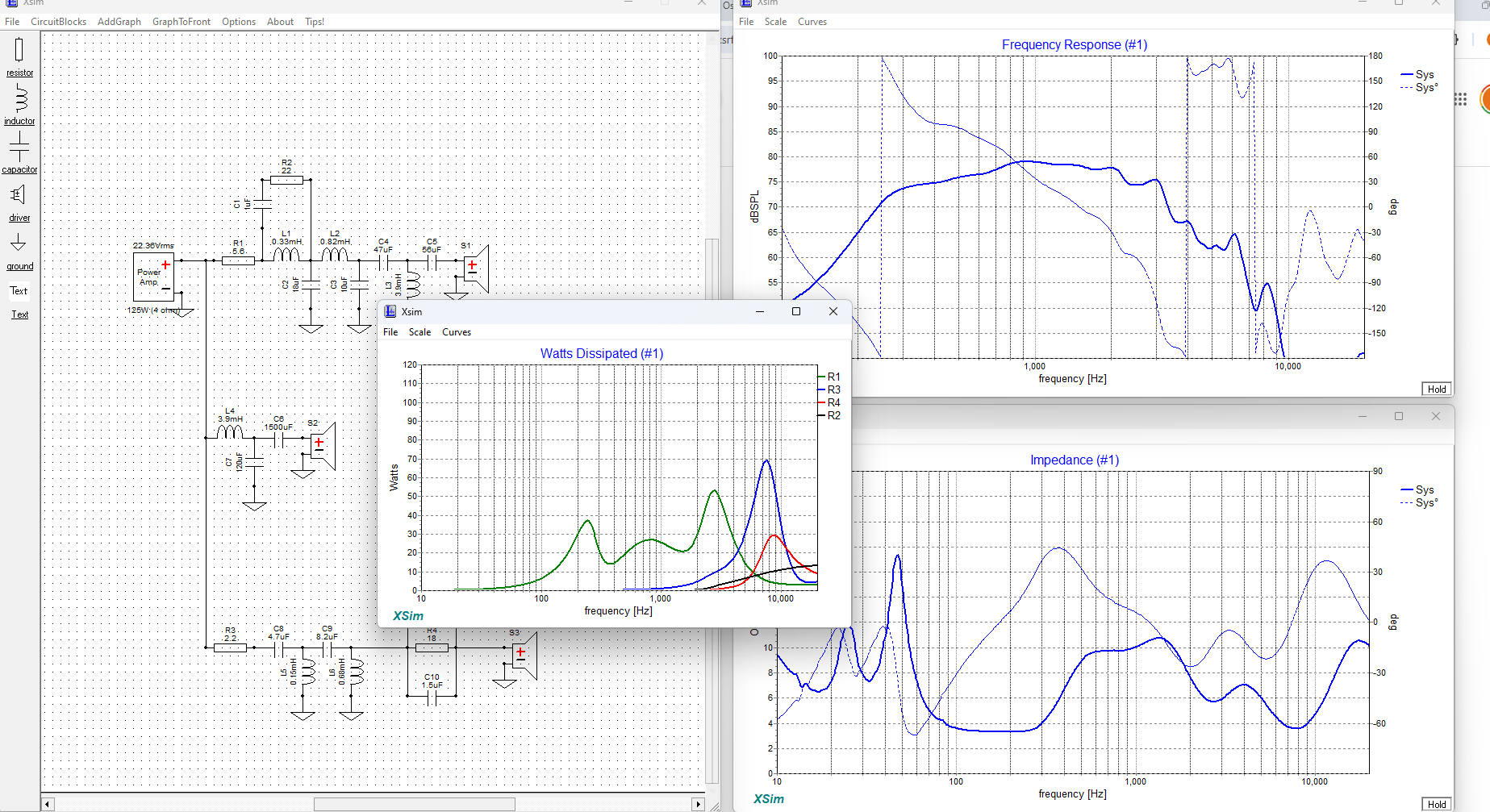

at calculating wattage dissipation
Simulators are going to assume the maximum by default, ie the whole amplifier output at that frequency. This makes sense as a tool, but it's also not showing the most likely practical reality.

Here's another reduced-component crossover, with only one inductor in the woofer LPF section. In this design, the woofer is connected with positive polarity, while the polarity of the midrange and tweeter are both inverted. Note that any sharp cone breakup resonances are at least 35dB below the level of the summed response. A flat tweeter response has also been achieved.

For VituixCAD power dissipation...set the max output to the watts or voltage you determined in your box modelling such that the woofer hits xmax or xmax +10%. Then change the settings to "pink noise above 2000Hz with 13dB crest factor" for a reasonable approximation to normal audio power. (If anyone disagrees, feel free to correct me, this is advice I saved from someone else's post.)

Your inductance is very peaky. I have read that flattening the inductance makes the system sound more natural and in phase.
I guess then the argument is "are more XO components worse for sound than peaky impendence?"
Note that my impedance curve has been plotted over a reduced amplitude range for the vertical axis. That might have made it look a bit peakier than in the previous plots. The swings in the phase response of the impedance results are not very wide, so that side of things shouldn't be a problem.
Flattening the impedance curve above 100Hz would of course make it behave more like a pure resistance, without any reactive component. Solid state amplifiers aren't affected very much by a varying impedance, unless it strays into being a highly capacitative loading. Of course, if a tube amplifier with a low damping factor were to be used, then the variation in the loudspeaker's impedance curve would affect the amplifier's frequency response.

Look at Parts Express inductor selection. You have a choice of air core - small gauge wire (high DCR), air core - large gauge wire (medium DCR) and Iron laminate core (lowest DCR). If you are just trying to match one of the xo's designed so far, VituixCAD usually assumes a reasonable DCR, so one of these should get you pretty close. In your tweeter circuit (and maybe other places) small gauge air core probably are fine. In other places you have to decide. Large gauge air core are considered the best quality, but they have more DCR than iron laminate and can get pricey. Some people (I think there was a post earlier) don't like the higher DCR of air core because you loose some SPL but sometimes that actually helps your frequency response. Best advice...just play around with the values and get a good idea of the tradeoffs that you have.
