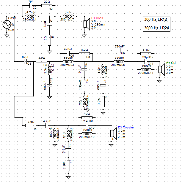

OK, one more contribution....xo points 300 Hz and 3K

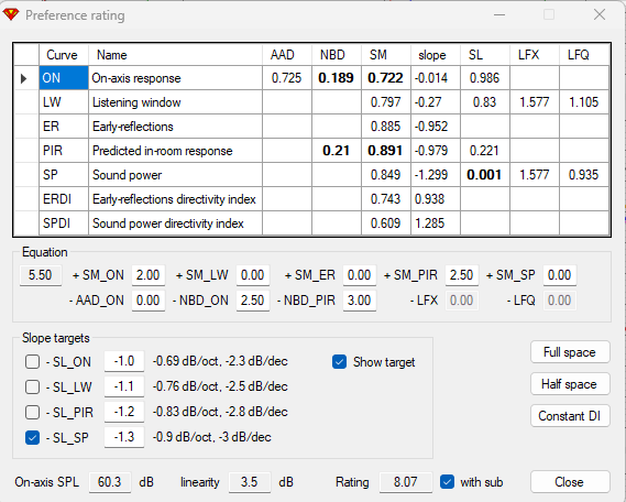

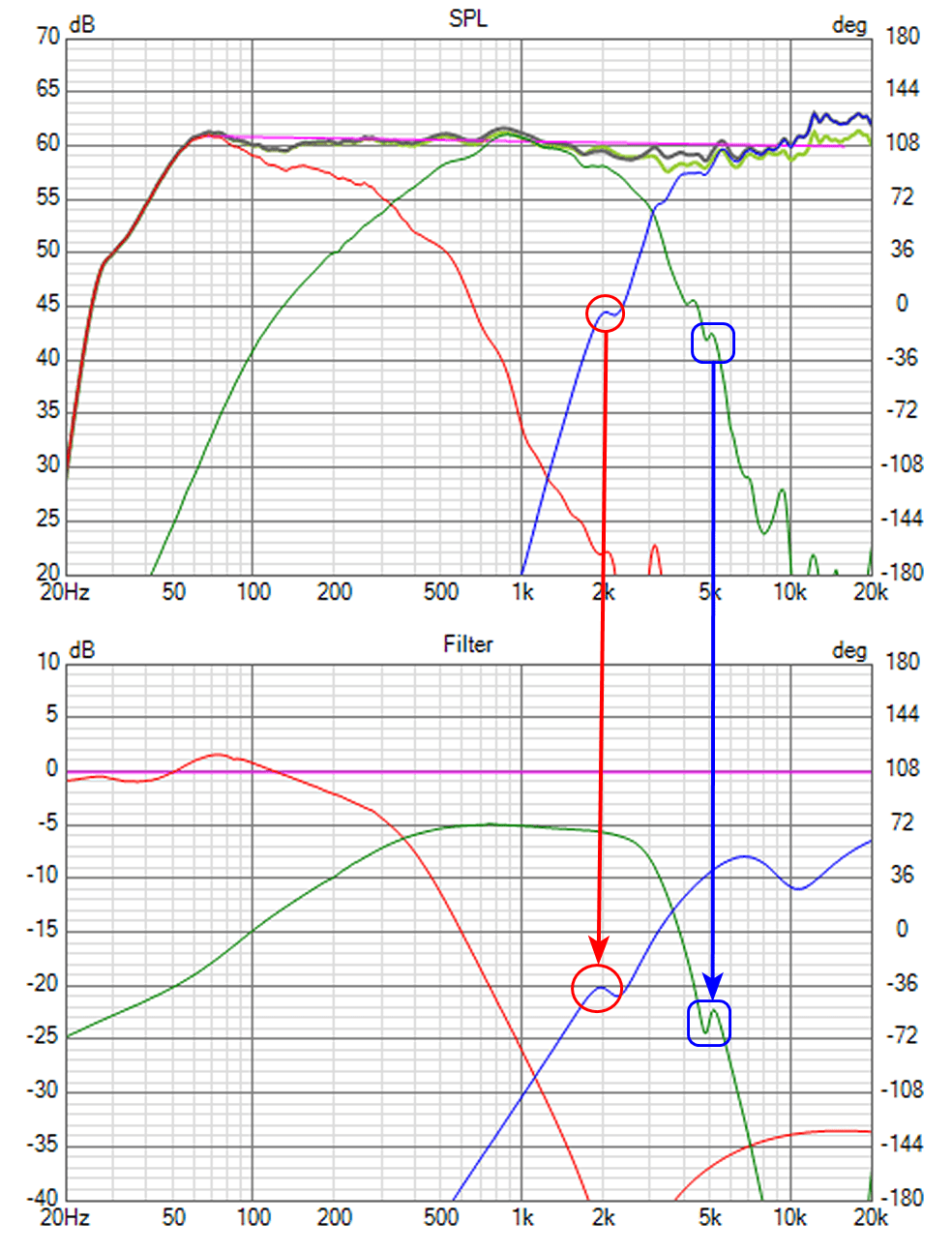

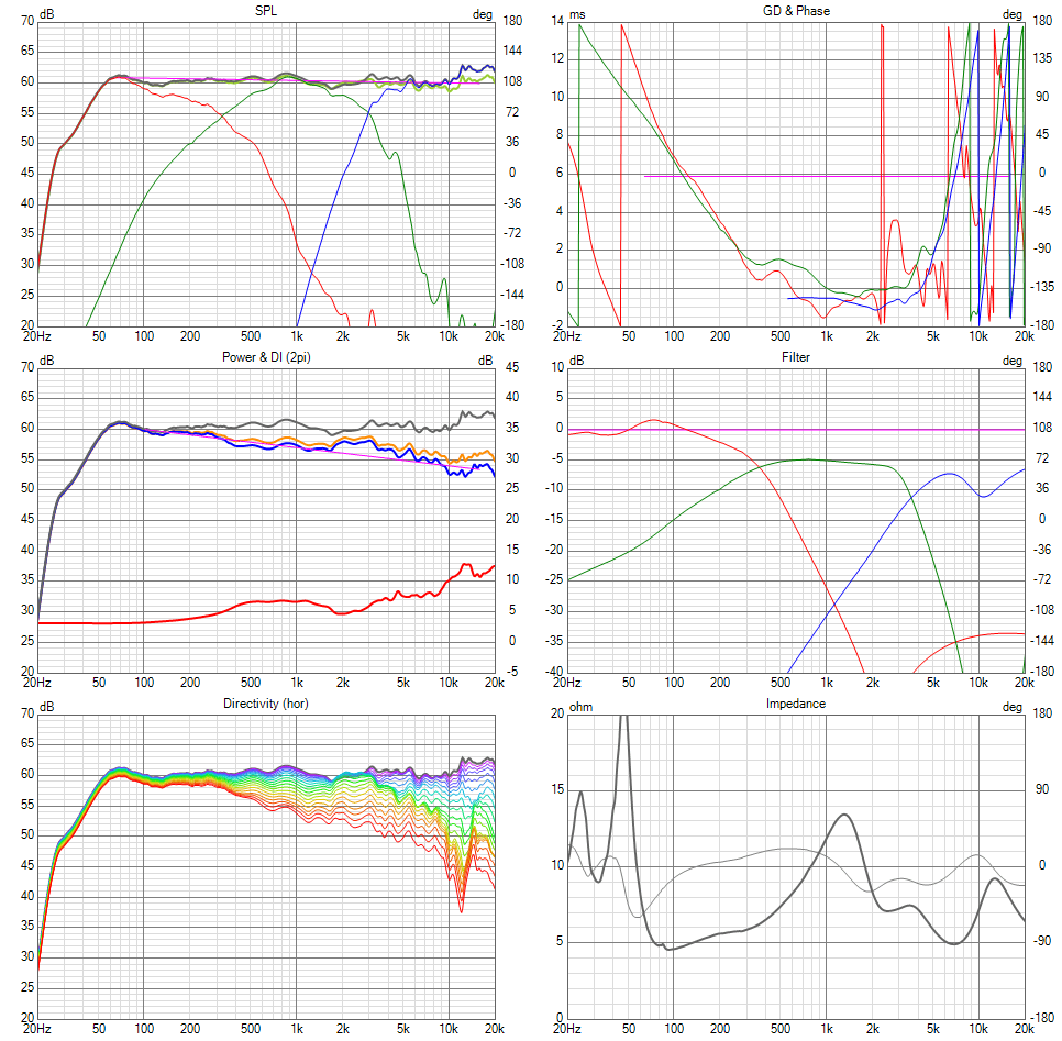

I noticed that the midrange filter network includes a small electrical resonance at about 5.2kHz. The tweeter filter network also has a similar electrical resonance, at about 2.0kHz. Would it be possible to adjust the filter networks in question to remove those two resonances?

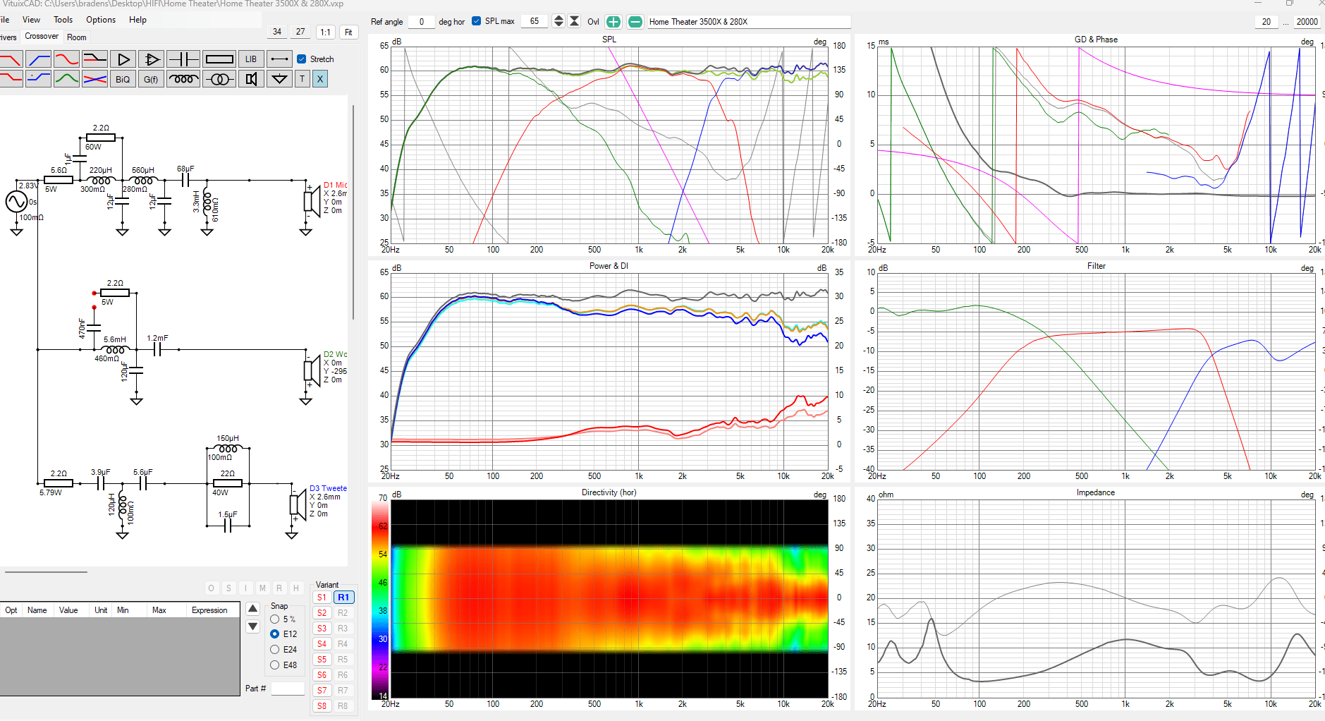

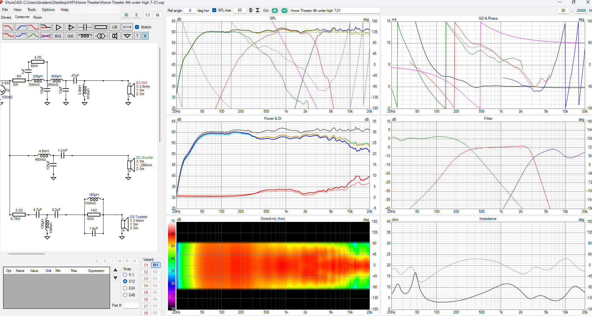

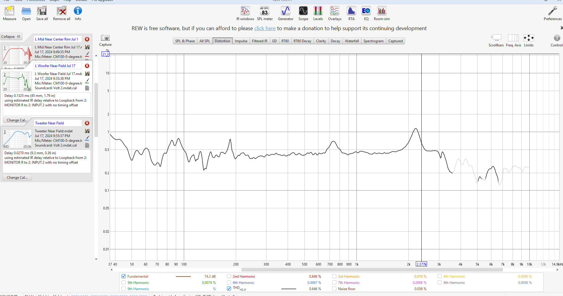

I feel like I'm going in circles now. It also seems like everyone is lining up very similar in how they are getting the responses and the XO where we all think it should be. I have two options. On the left is a 2800 & 320 hz XO. On the right we have a 3500 & 280 XO.

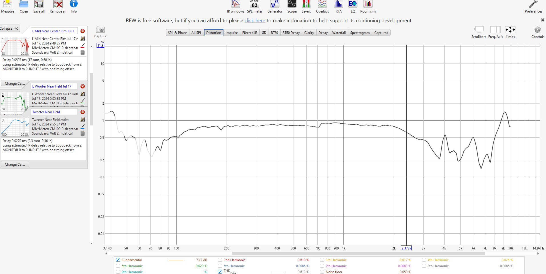

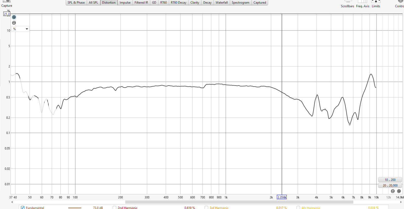

Looking at the distortion figures also attached which would you consider better?

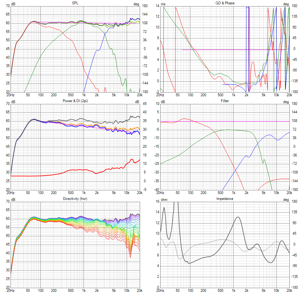

Attached without those two notches: on axis is more linear , but the PR blooms at the sensitive 2K to 5K region....
Yes - look at my crossover in post #48 - midrange cone resonances at about 5 kHz and 10 kHz are -35 dB below the signal. Tweeter resonance at 2 kHz can be killed also, but only with more complex filter.
It blooms there because the previous design (see Post #101) had a mild case of "BBC dip"-itis in the 2–5kHz region. I think it's more important to get the on-axis response flatter and remove undesirable resonances sitting not all that far below the summed response, which can be easily excited by music program material. That choice is made on the basis that the direct sound from the loudspeaker will, in most listening situations, most strongly influence the listener's perception of the sound reproduction quality.
The plots below, taken from Post #101, indicate the presence of resonances in the midrange (blue square) and tweeter (red circle) responses that have been created by their respective filter networks. The peaks in the relevant Filter responses curve indicate that undesirable resonances are being introduced. The one in the tweeter's high-pass rolloff, located at 2.0kHz, is only 15dB below the summed response. I would hazard a guess that that is undesirable. The one on the filter for the midrange is located at about 5kHz, and it is a relatively high-Q resonance that is only 17dB below the level of the summed response. I would be concerned that these resonances might be audible.
