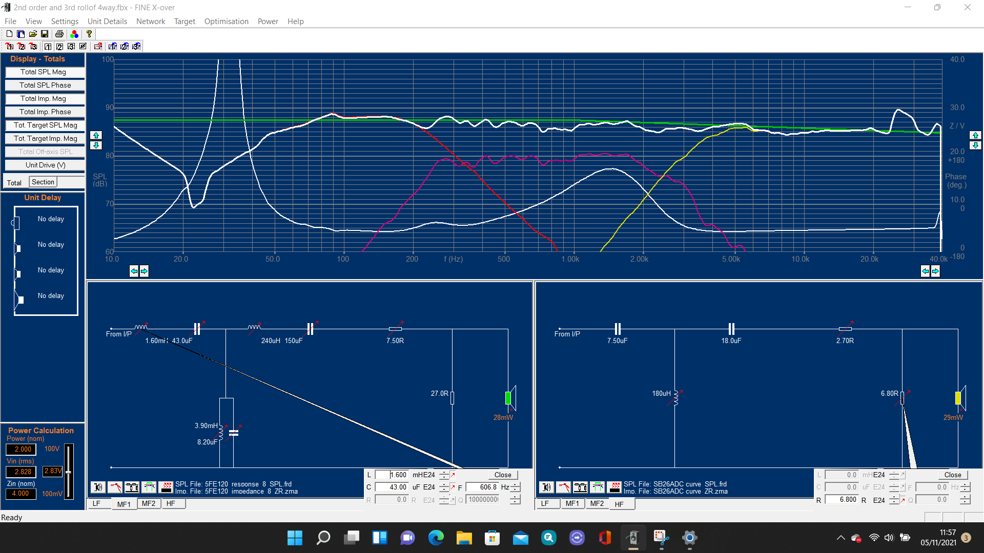

motokok i have read https://www.diyaudio.com/forums/mul...ing-crossovers-measurement-2.html#post2587247
But don´t know what to do.

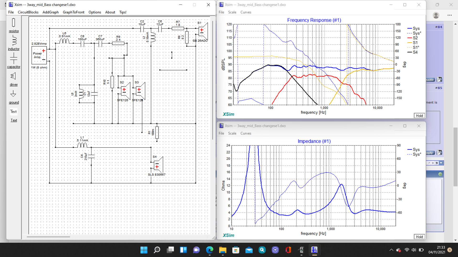

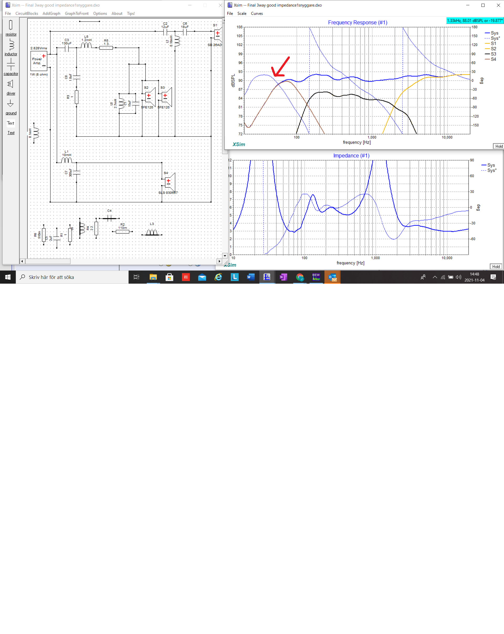

I havent got any resistors in the xover for tweeter, the woofer only have a big 10mH coil and a 305uF cap (i change it from 205uF with a electrolyt 100uF)
Seams to me there is some problem in the xover from 350 hz and down, as some of the xover-parts seems to "quarrel a little", and the "knee" down around 350 hz is problematic i think ( also seen in phase-curve from xover-point 150hz)
And the arrow i draw in the pic Xsim211104, why the curve don´t go up ?, it goes up a bit but then it turns down again ??....The other 2 curves goes up pretty in a waveform.
AdamThorne:

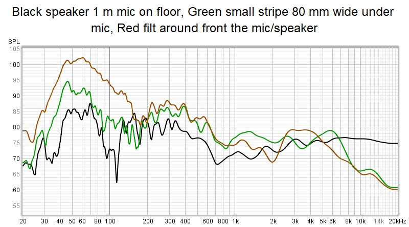

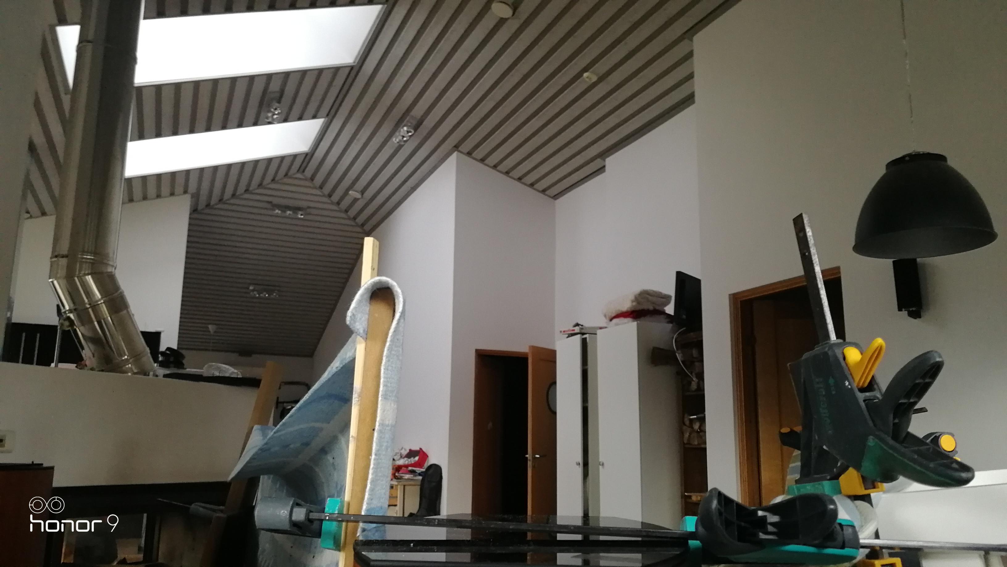

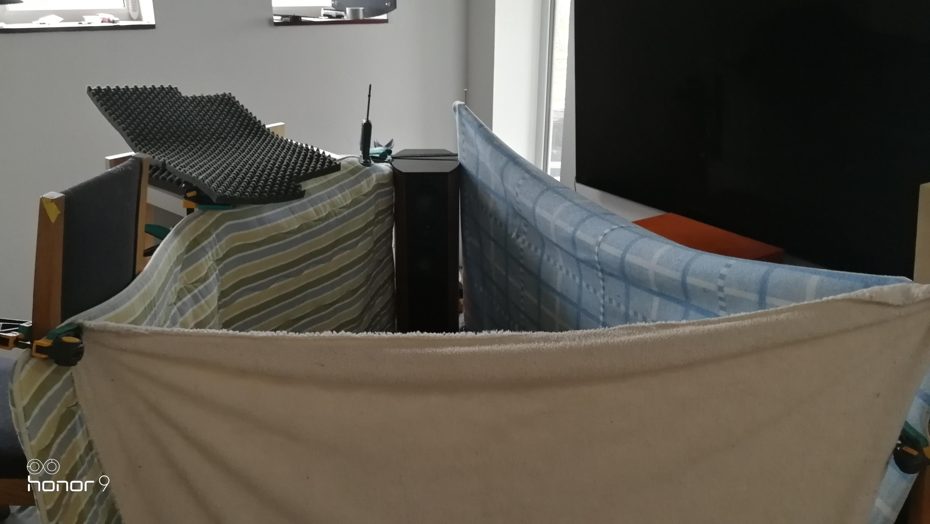

These measaurements are from mic on the floor, with no and more damping around the mic.
And i have spend a lot of time in XSim to try get the 350hz knee away, but i don´t make any progress.
So i post you guy´s the hole FRD, ZMA, Xsim files in here with the latest info.
Regards John

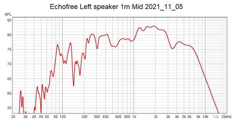

John, could you take new driver measurements in cabinet with no crossover?
I think you're seeing the reality of the baffle and box vs the datasheet response from an infinite baffle and anechoic chamber. For example, this is the response of the woofer at the moment vs your target curve. Either the measurement is way off or the response shows the current XO is not working anywhere near intentions.
Hi Jawen,
The new measurements you posted are with the microphone at the position of your ears when seated at the sofa, and the amp volume control set to the same position for all tests ?
If you kept the microphone in that exact position when you measured each individual driver you should have frequency with the relative phase data that should allow Xsim to work well.
The 350Hz knee you mention maybe a result of the two mids or diffraction problem or less than optimum phase information. Interesting that you do not see a 350Hz bump with the Xover in the other speaker.
A quick test to see if you can change the 350Hz knee is to try it with the woofer reversed. It should highlight it is phase related if it changes with the woofer reversed.
Its a very subtle one, but you are using the same FRD and ZMA info for both 5" faitals. I am quite happy that the impedance should be the same but there probably will be a small change in the frequency response between the two positions. For the time being I think it is a minor issue and would need more time for further measurement to clarify.
Ground plane measurements seem to give excellent results, but I think they ideally need a hard fixed surface, and lots of free space to stop reflections form fences, walls and such muddying the results. Definitely worth reading up on if you have plenty of free space do do them in. I have never attempted one so cannot give any advice. Envious of those who have the space.
NB on the sim I have posted the Bass is opposite phase to the other drivers. There is also a bit more simplification.

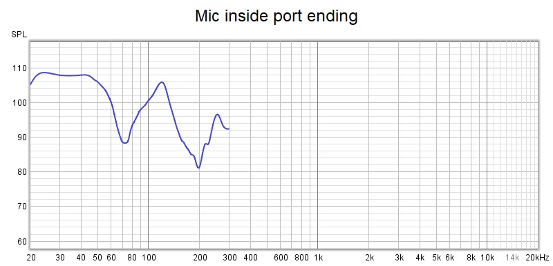

Hi raymondj
Do you mean put the mic inside the port?
Or the same 1 meter just without xover....i do both !
Regards John
Regards John
I would try to keep it simple for the time being and set the microphone up at 1 metre distance at a height that would normally match where your ears would be relative to the speaker. Usually this should be somewhere near to the centreline of the tweeter on a large floor standing speaker.
Capturing a good approximation of the bass is going to take a bit more time. We should be able to get the mid and tweeter working well quickly, if the data is good.
I know form previous experience with the tweeter that is a workable selection of values.
Yes, please take the measurements without the crossovers that will give us real data to work with keep the microphone in one postion and the volume the same, not too loud as you do not want to damage the tweeter, Some people use a couple of uF in series to protect it.

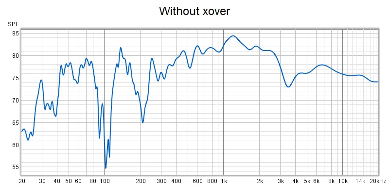

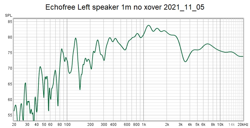

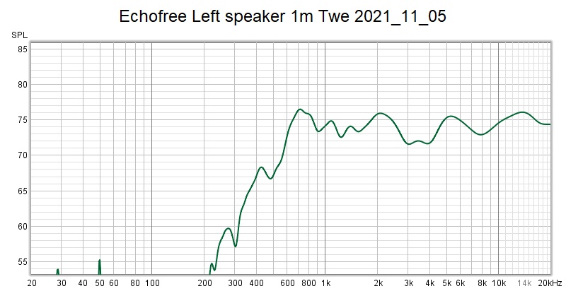

The post 74 is from listeningposition in sofa, all others ( posting 75, 77, 79, 80 and 83) from 1 m in the middle of the MTM !

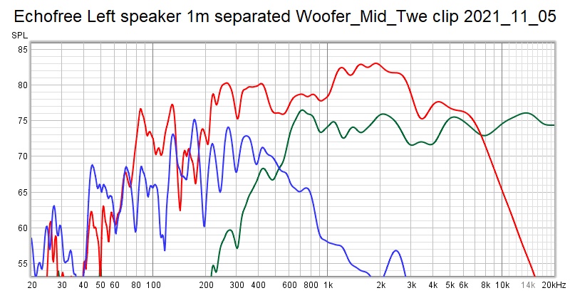

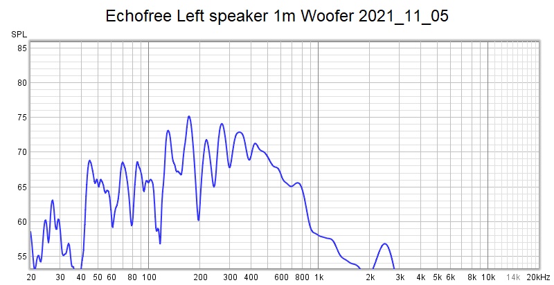

Done measuremant without xover.....Look´s crappy and i need a whiskey.
The Jamo´s are cheep right now if someone suddenly knocked on my door hahaha
Witout xover from 1 m
And inside ending of port with xover
Regards John
Regards John

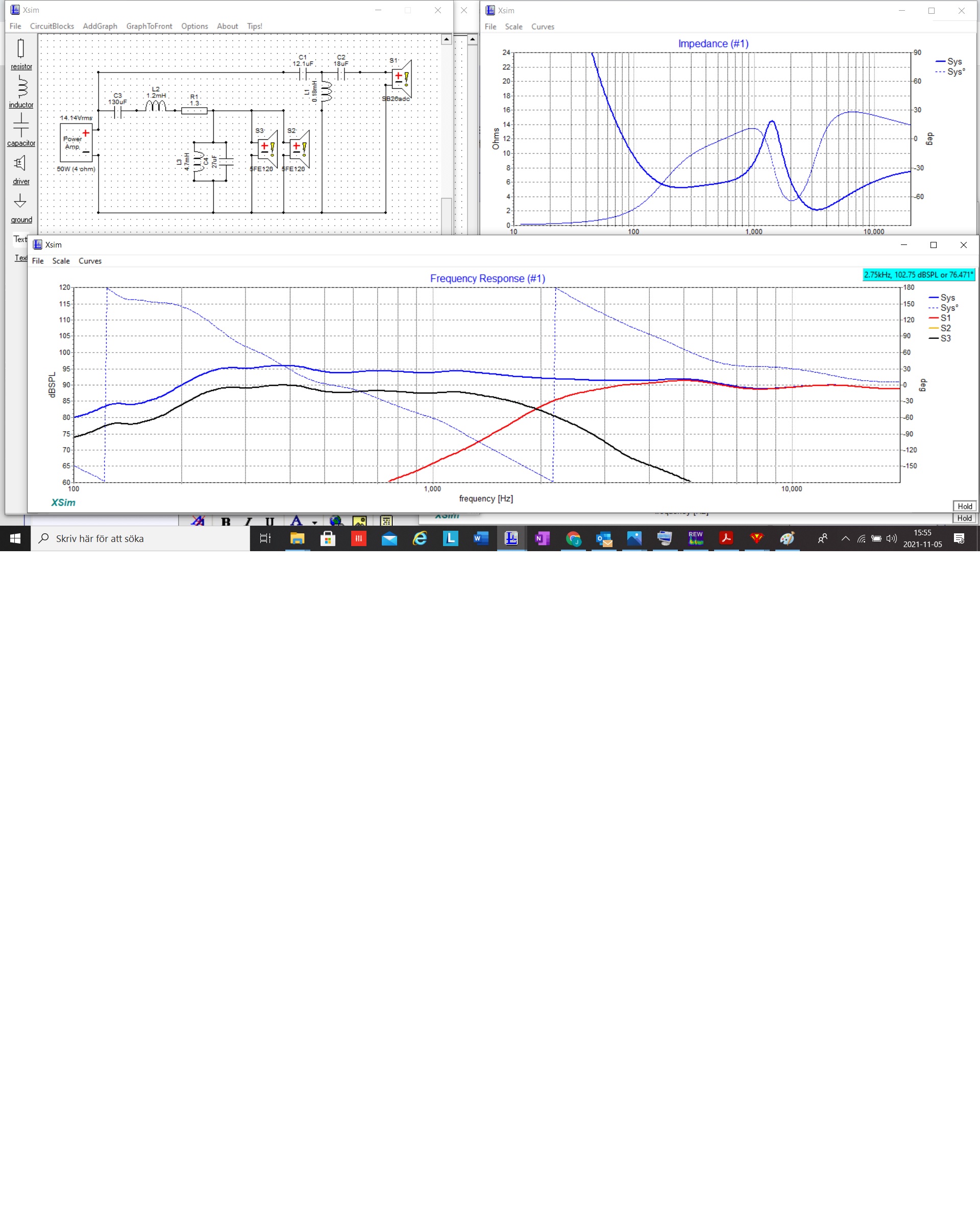

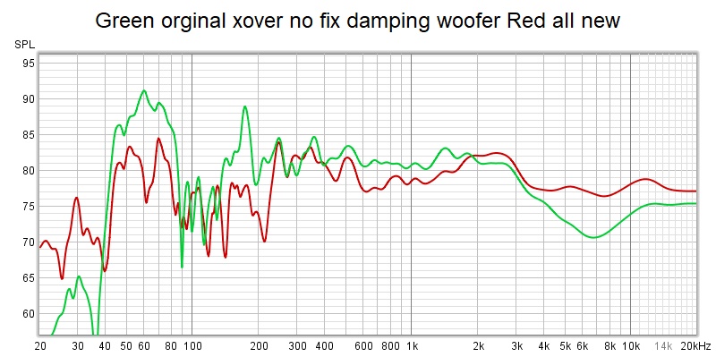

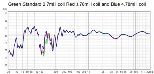

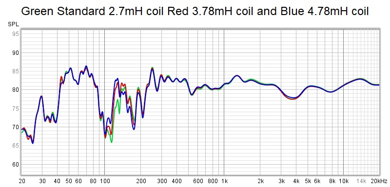

Eariler i have done some testing, i test 3 different values on coil in paralell with cap in the mid´s.
Some differences in 100to 200 hz zone as shown.

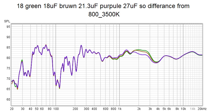

I also test 3 different values on cap`s in paralell with coil in the mid´s.
Some differens in the 1800-3000 hz area.
And pic´s from 1 m on both speaker, one with orginal xover and "new" xover.
Regards John
Regards John

Measurement without crossover will look crappy.
But they will show baffle step effect on midrange and tweeter along with the corresponding phase which is needed to get optimum results.
The low frequency of the mid and woofer will have room modes ( possibly the dips at 200Hz and 100Hz that you are measuring) effecting them which potentially spoils the data. That's why we ideally need the big non reflective empty space or ground plane measurement to give us that clean data.
You have probably read about placing the microphone as near as possible to the cone and taking a measurement in that position and then intelligently splicing onto the quasi anechoic data to give a better representation of the low frequency performance.
Your Bass speaker is at the bottom of the enclosure with a port on the rear of the speaker that makes it tricky to do by scaling measurements so that may end up as a judgement call and adjusting port lengths and enclosure stuffing.

Hi Jawen,
Looking back at the data you mentioned plus the data in post 90 suggest you are getting close. The red graph in post 90 your crossover and the new drivers isn't far from the mark. You just need to refine the interaction of the 2 mids and tweeters. Interestingly what did you think to the sound?
As post 90 looks sensible to me, maybe this crossover and the new measurements of drivers without Xover in box will be a good restarting point. You just need to flatten that 2Khz bump. Lets concentrate on that as a starter.
Looking at the posted data all have issues caused by the room from 300Hz downwards.
Its not your measurements we all have the same issue taking measurements in our homes.
I usually have a huge response dropout somewhere around 200Hz or so. You have 100Hz, 200Hz and 300Hz re occurring in your measurements which makes the low slightly more difficult to judge.
When you are happy to re visit this, and once you have new responses and impedances for the drivers measured. Simply, forget about the bass for now and see if you can get a smoother response between 300Hz-15Khz. with a lovely roll on from 100 - 300Hz which is where your room seems to get involved. But we should try for this and from the Xsim data knowing the crossover roll on we should be able to integrate the bass back into the system using a complimentary roll off on the bass driver.
Variation in the measurements below 2 dBs and general flatness are the things to aim for.. Don't worry too much about dips, you will never easily achieve the flatness of a simulation and it can be counter productive.
Post 75, the brown old Xover dips at 100Hz, 200 and 300. 400hz -2K looks promising.
Post 77, Pink looks sensible, i think it also shows the difference in the woofer sensitivity and hence the need to probably attenuate the mid and tweeter level. 2K bump needs understanding. I.e. is it mid and tweeter crossover phasing and adjustment of components. Ideally balancing mid and tweeter to lessen this, will probably end up with a small dip after tuning. Tune by 1 component change at a time to get a feel for interaction, alternate between the mid an tweeter as you change 1 value and see the interaction. The more you do this and take measurements the the more proficient you become.
Post 79 also shows mid and tweeter higher efficiency. Re adjust Xover for smoother 2000 -3000Hz
Post 80, looks OK.
Post 83, 100Hz dip, generally quite confusing.

In a simulation these two components allow you to play with things relatively easily and yet make large swings.
If you wanted to you could drop these values into Xsim and work from there. This is to give you a dial that you can adjust that should bring on quick changes, have a play.
The arrows in the attachment indicate the two primary components to adjust. Once you can prove it is behaving as per the model, the parallel inductor on the midrange will effect the roll on knee which you may also need.

About post 83, the microfone was on the floor about 25cm from the speaker!.
Black curve all hard woodfloor, Green curve after ivé put a 12cm wide stripe from mic going under the woofer and to the back of the speaker.
And Red curve after i put polyestersheets all around (nearest) speaker.

Today i have try to make a echofree invirement around the speaker and mic around the "ordenary" measaure-space, and i have 10-15mm blankets/filt/carpet all around the speaker and microfone up to 15 cm over the top of the speaker.
And did mesaurements on hole speaker without xover AND, only tweeter, only midrange, and only woofer also without xover.
One pic is from hole speaker connected, the other put together from separate twe/mid/woofer measaurements in 1 curve, and also the twe, mid, and woofer separate measaurements.
The tweeter and midrange mesaurments should be much more non-affected by the room.
Forgot to tell you what i think the speaker sounds like at the time.
Bass strong and quite nice, quite fun to listen to and even delivers emotions
Regards John
Regards John

Wow, Very interesting room, measurements not to shabby either. 😉
A good take on a mini loudspeaker test centre, with nice soft furnishings.
Can you get impedance graphs and drop them into Xsim? with your new measurements, that should make it in terms of data to work from.
Your measurement's show how much more sensitivity you have in the tweeter and midrange.
The midrange does have more diffraction loss/Bafflestep than expected and the 1-3KHz behaviour and the tweeter peak at 800Hz will be interesting to see how they change when they are integrated by the crossover.
For the bass driver take the peaks and mentally join the dots to get the general trend of the arch of its response. If you can apply different smoothing 1octave smoothing should give you a feel for its shape.
I hope your new data makes you feel more positive about this. 🙂

Had take my mesaured curves for tweeter and midrange in my "echo-free" room, and put it in XSim and put all values from my xover in.
NO WOOFER AND NO IMPEDANCE CURVE IMPLEMETED! ( just to see how it look´s like in SPL)
And it look´s like this ?
Can´t understand where the differens come from, because this looks fine 😕!
Regards John
Regards John
