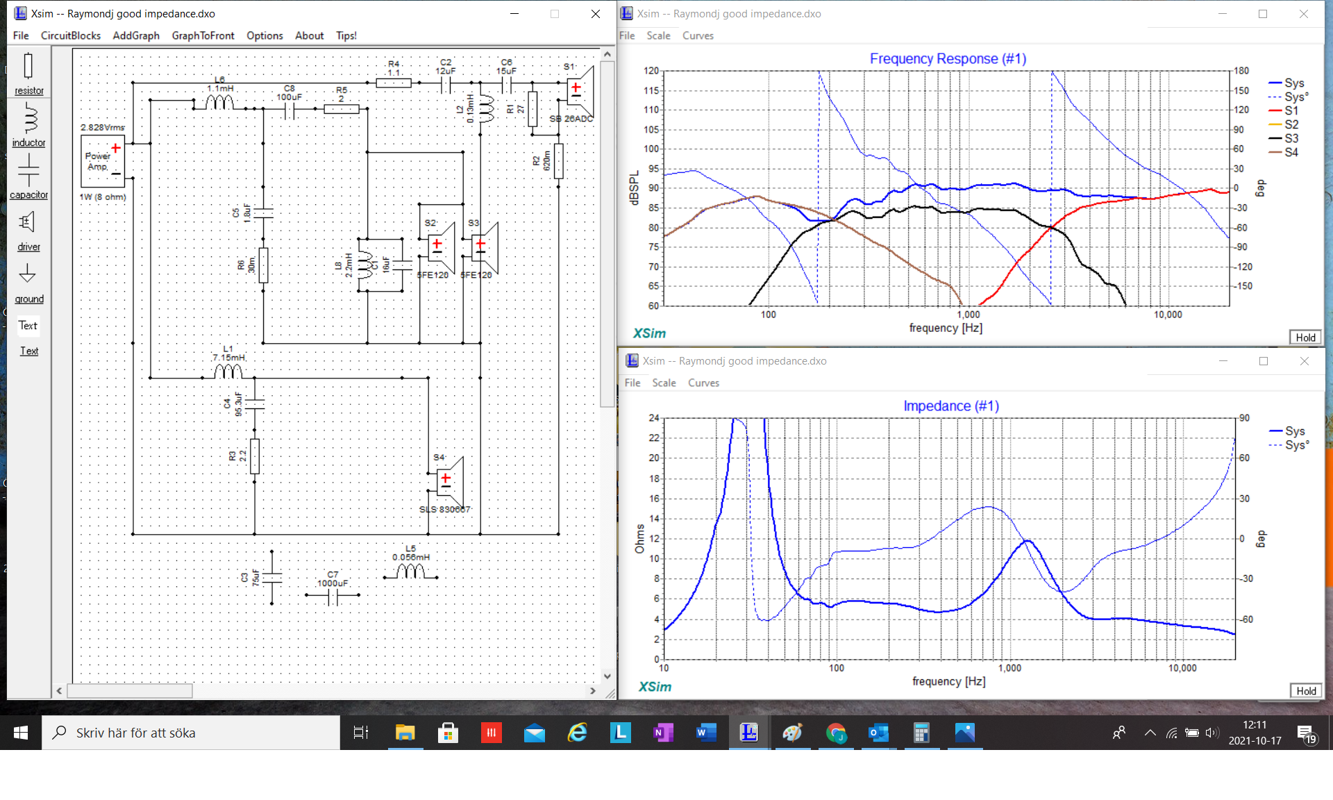

Thank you too, as your challenge has made me think about how good the faital pro 5 is and what decent efficiency you can get with a pair. In other threads people have sung its praises. I will certainly experiment with them in this kind of arrangement.🙂
The attached screenshot show an interesting solution to improve low impedance.
Ray.

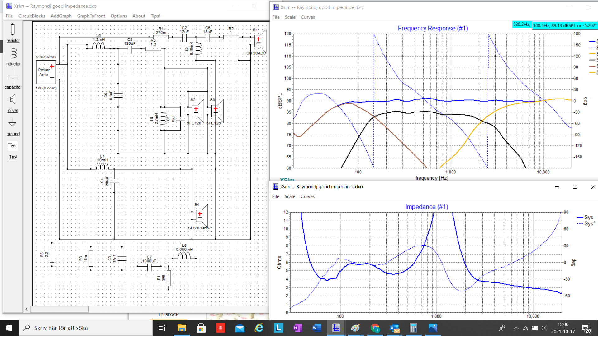

So strange....When i "bild up" you´r latest XSim filter with the good impedancecurve, my curve dosen´t look like your under 400 hz with the same components ???
Don´t get it......Why mine shows completely different from 400hz down!
Look at mine Frequency response curve!

Oh no, what have i done??? 🙂
Its a bit like one of those pictures where you have to spot the difference.
Can I suggest reversing the bass driver phase.
Its kind of good in a way that you asked the question, as it demonstrates the importance of phase.
The number of times I have built speakers and had the phase wrong in one of the boxes. So double check everything when you start solderings and physically connecting loudspeakers.
I hope that helps.

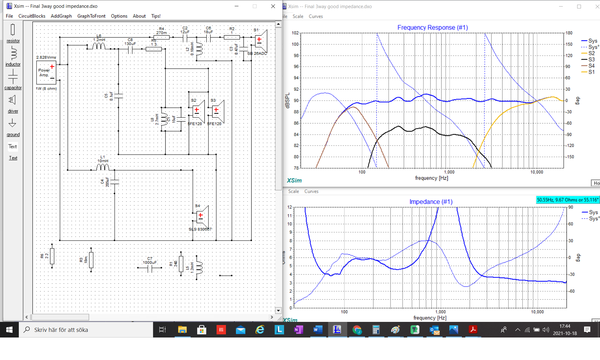

Have spend a few hour´s on trimming your latest filter, WITHOUT reversing the bass driver hahaha......But did some progress.
Still impedance dropps slowly after tweeter xover-point around 2,5K, and reaching 2,2 Ohm at 20K.
Big question is if i schould go for 3-4+ dB filter ( 2,3 ohm dipp at 90 hz and 2,1 ohm at 10K), or accept around 90dB filter that maby suit´s the woofer sensivity better?
regards John

Room Gain from approximately 300Hz downwards is going to effect the graphs, so until you have tried your speakers and moved them around a bit in the room to try to balance the bass you will not know if you have too much bass or too little bass. I think one review that i saw on the internet suggested that the original my be a touch lean. A company like Jamo would have understood their reasons for voicing it that way, so maybe they were concerned about the dreaded bass boom. Also interestingly the original crossover looks very simple. You don't have one to draw up the original circuit diagram?
I would tend to err on the side of caution as too much bass is just bad news. A 5 litre bookshelf can be enjoyable for most of the time, bass is a kind of everything and nothing thing to me. I grew up with sealed designs and i find getting reflexes correct tricky.
I think there are a few more tweaks to be had and maybe going back to a second order and playing with tweeter phase and resistive pad could get you back to a flat or slightly rising impedance at 4ohms or so for the HF which would be nice.
The graph is pretty straight line I wouldn't get hung up on that too much. Your final tuning may have room ripples of 2-3 dbs bellow 1Khz, sometimes these can be left alone on other occasions a notch filter will be needed. Further each crossover can throw up its own little peak or dip that the simulation hasn't caught due to inaccuracies in the original mismeasurements
If you get a nice bass response that balances the drivers you still may want to dial back the top of the mid and keep a gentle decline through the tweeters response. If the room is full or furnishings heavy fabrics and curtains you may not have to do anything with the HF.
Even a few weeks after feeling reasonably happy with the sound you may be playing with the next value of C and the next value of R. Its really trick to get something you can listen too all day and cover the different recording quality of a music collection.

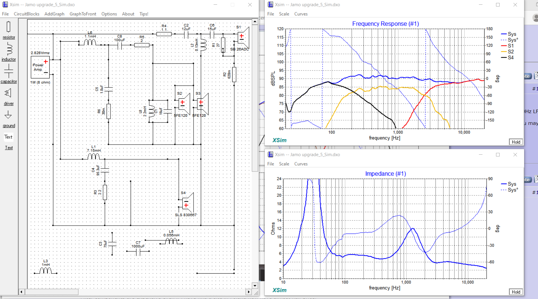

No i have spent a cupple of hour´s adjusting 2 of our XSim xover-models.
Look´s imposseble with inverted woofer to get good responce from 150 hz down, and feels like i´ve tested everything to get netter impedance also.

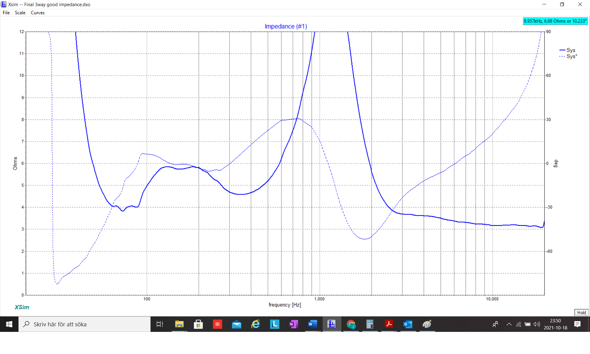

The only thing is putting a cap of 0,47 uF between possetive/+ and negative/- at the tweeter, then i get the impedance up from 2 ohm to 3 Ohm at 20K, slowly sinking from 4 ohm att xover-point 2.600 hz to 3 ohm at 20K
Notice i have the 2 dB scale on "Frequency_response curve" in my picture, think it looks nice +- 1dB 🙂
A newbie on xover-building, can you have a cap between + and - on the tweeter rajmondj ?
Regards John

I would be careful with just a capacitor, a capacitor and series resistor gives you some safety margin.
With a capacitor on its own as you could be asking for a very low resistance (a short) at high frequencies the resistance gives you some safety margin.
To digress some amplifiers, without a suitable network at the output of the amp did not like driving exotic low capacitance type cables. Some died.

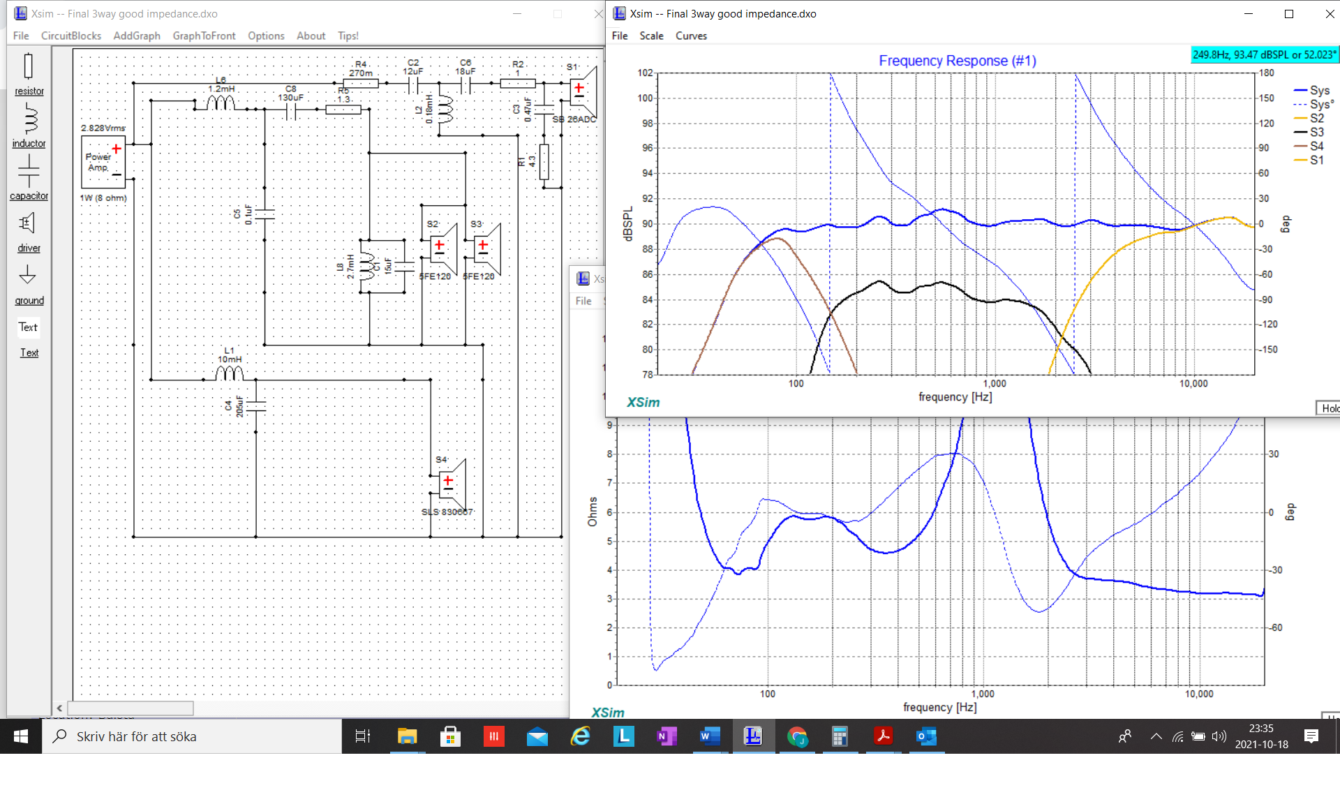

Hallo raymondj :wave:
Yes it´s a pitty that XSim don´t show frequency graphs over 20.000 hz, 40K should be perfect!
In my case now 30-40K are valuable information if the impedance stand still at about 3 ohm´s or if it went down after 20K.
Don´t know if i understand you correct about "a capacitor and series resistor", look at my picture and tell me if i thought right.
Putting a 4,3 ohm resistor in serie after the tweeters 0,47 uF capasitor, raised the impedance with 0,2 ohm to about 3,2 ohm.
And if i look close the impedance seems to increase a little after 19.700hz, but still don´t know at 30-40K or so.
I have order a UMIK-1 for 96 euro (Yippiiii) but i don´t have a anechoic chamber😀, but it will take me a year to learn about measurements.
But the ears are the final judge, and you´r word earlier about be able to play all sorts of music and don´t make our ear´s wrinkle themselves after 2 hour´s playing is a must!
I have Vituixcad and use it to capture the frequency and impedance curve for making FRD and ZMA files, but learning a new program at my age (will be 55) isen´t fast-going 😀 hahaha
I will more accurate measure the mid´s and woofer enclosure when the new drivers arrive, but have them still to play music with until "the end"
And i orderd a 90° reflex-pipe so it will fit as it have to be around 32cm.
Regards John

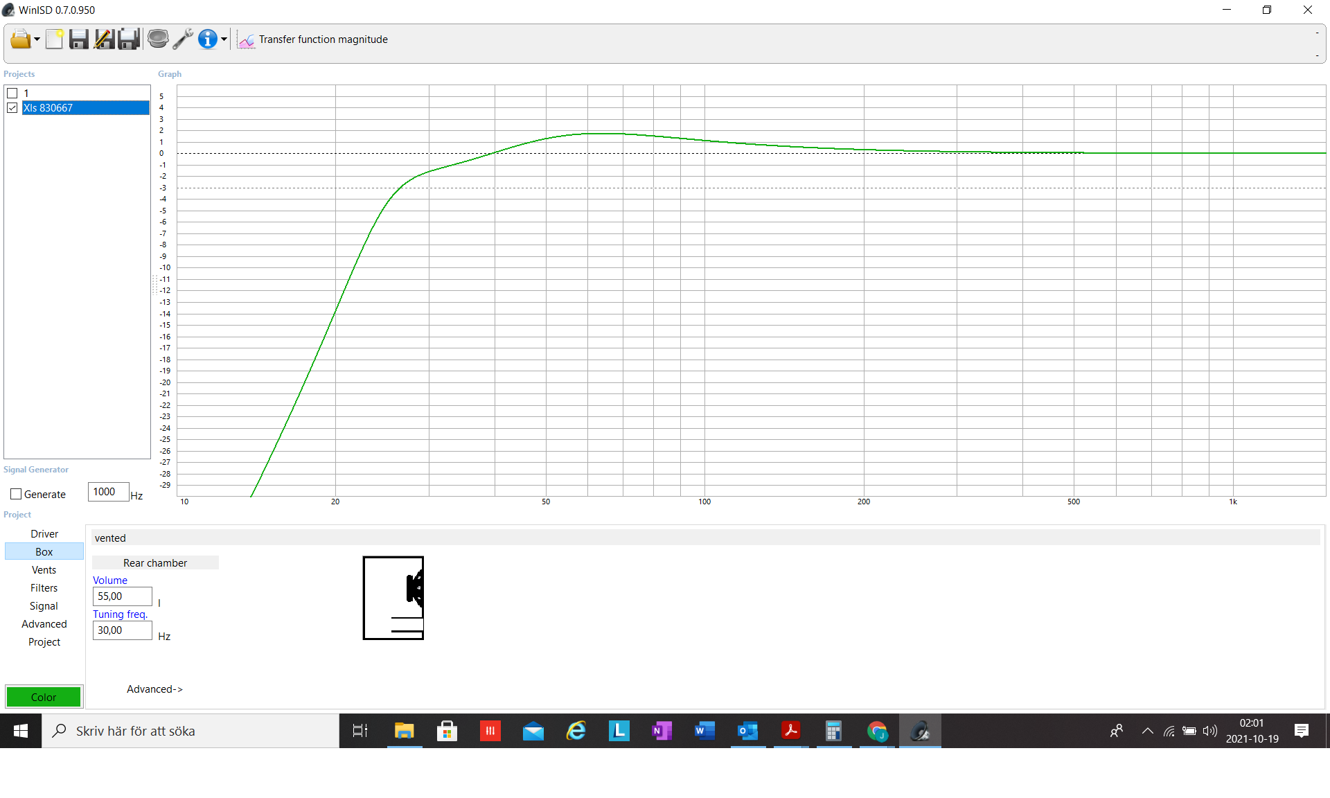

Hmm, I thought SLS datasheet states more like 85db? Best double-check this and consider higher sensitivity 8" e.g. Scan Discovery 22W.
Also, SLS seems more suited for closed box otherwise looks to have a hump when ported. I'd recommend modelling the bass curve and port tuning from the cabinet.
The Peerlees SLS datasheet states 87,2 db, and i have "played" a little in WinISD with 55 liter and 100mm 400 mm long slot.
Do you think i can trust WinISD ?
Regards John

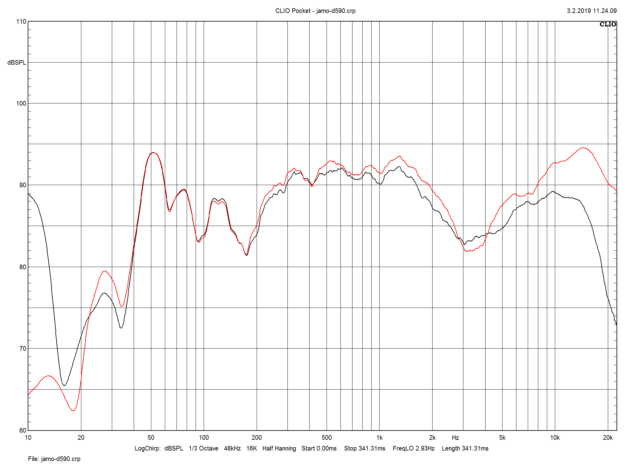

i don´t have a mic or soundcard,
So you don't know how Jamo balanced their crossover to get the sound they had, and you're guessing at the baffle response? At the end of the day you're kind of starting from scratch and it comes down to who can make a better crossover, Jamo or yourself. Fortunately with the right efforts, I think it's possible.
Hi AllanB
Im quite new at building xover´s/speakers (as i have told i my postings), and hasen´t learn all about baffle step, step response, Energy-time-curve and so on.
Just put a lot´s of efforts in getting my Jamo D590 sounding better, nothing else.

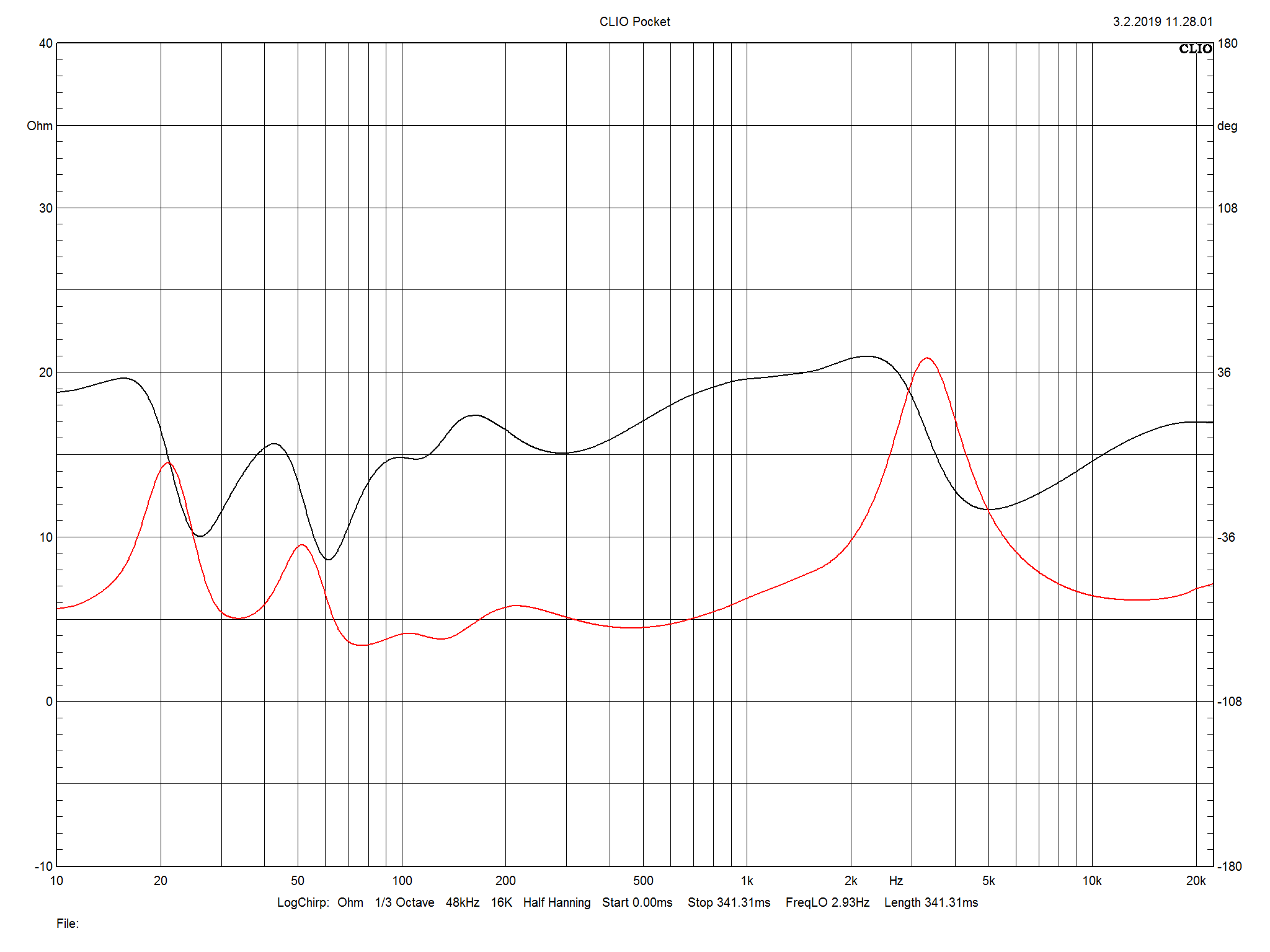

And if you look at the mesaurement from the Jamo D590 50th-Anniversary-Special-Edition in my pic´s, (from a reviews)
It dosen´t look so hard to beat that, and the orginal drivers are quite non quality driver. (But the cabinette is 26 kilo rigid)
What the mesaurments say to you ?
Still thinks only it comes down to who can make a better crossover, Jamo or myself?
And the replacement drivers im going to use are going to be superior compared to original.
Regards John
Not enough information.. Keep up the good work with the simulator, however if I were in your shoes I'd probably test the speakers using the original woofer crossover, because that's where the baffle information might be hidden.. then set the tweeter level, then try to fill the hole.. then back simulate what you've come up with and see if it makes sense on the screen, but also see where your ears were going with it and try to understand why it sounds as it does.
(P.S. the speaker's bass isn't like that, thats the room it was measured in.)

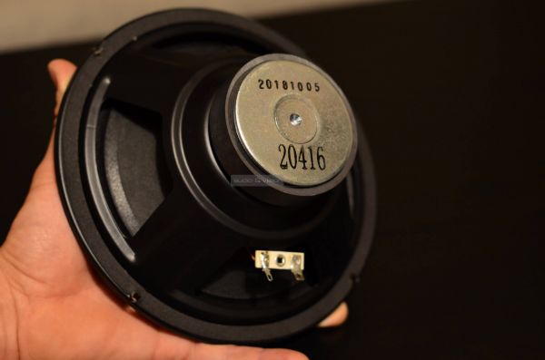

Jamo diden´t spend much on these orginal drivers, thin sheet metal basket, small magnets etc.

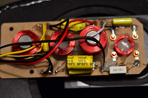

Ofcourse i will tryout the xover outside the speaker before i made final adjustments.
And how do you think the orginal xover and driver look´s?
Regrads John
Great, well, I think you've done your research and I will follow this thread with good hope. I can't offer much expertise but with allenb backing you up, the odds are in your favor!
My two cents is the crossover components look very cheap, with electrolytics in the main filters, and the coils are very close to each other and not oriented perpendicular from themselves in the new layout; so likely interference. You can reasonably improve on these things. Have a look Placement of coils in crossover networks

That Jamo midwoofer build quality looks...uninspiring!

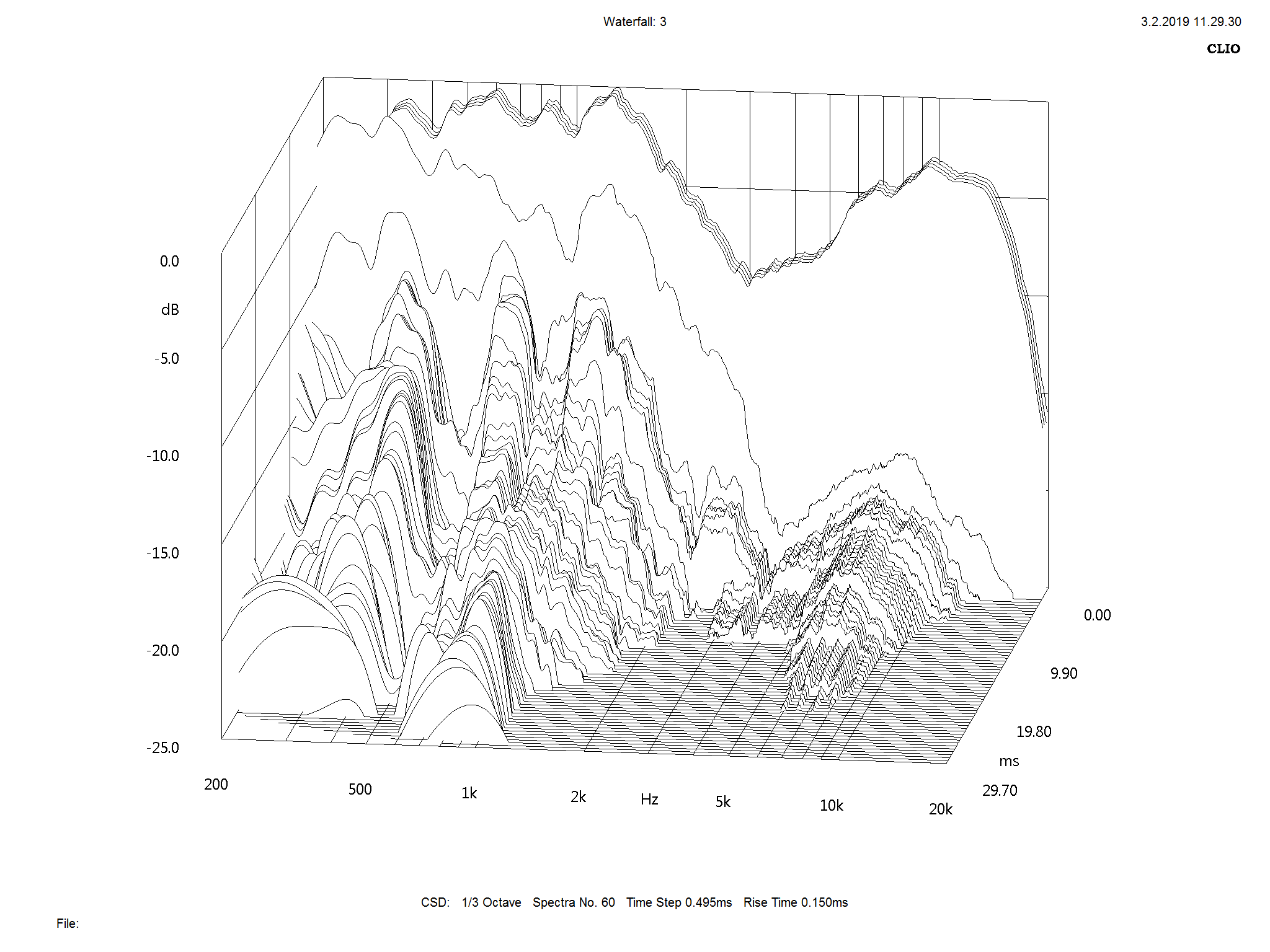

The clio data of the original frequency response is interesting, there is enough information to see what is basically going on. Its a pity nobody has the original schematic to see how the drivers were connected?
I think the low frequency dips will be linked to room modes not bad woofer mid woofer integration. The dip at 2.5Khz or thereabouts is interesting.
It could be due to wrongly connected drivers or a purposely engineered dip as even though it looks terrible it can still sound good, or the ear doesn't seem to mind this.
Or that it it is the result of the simple crossover? Pure conjecture on my part.

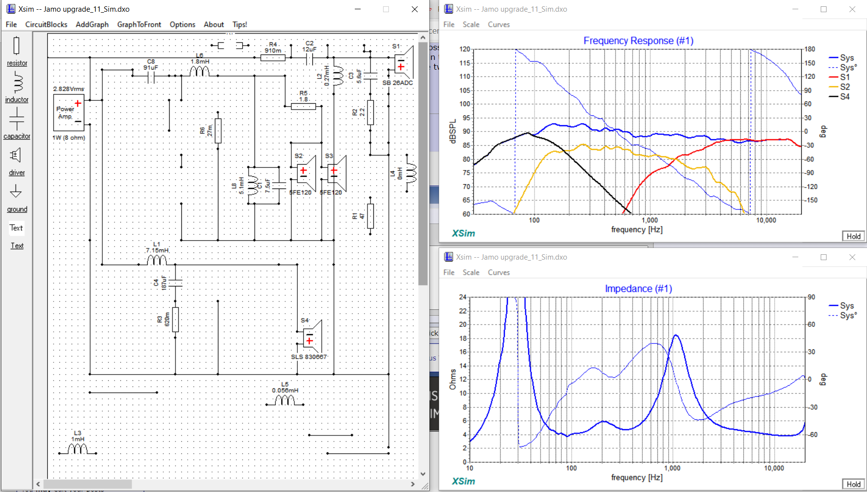

Just for fun while we wait for some measurements. I have guessed some small baffle step profile, played with the the impedance and driver phase. It acted as a diversion from a bad day at work. 🙂
Again i stress a guestimate until we have better data which will probably change everything.
