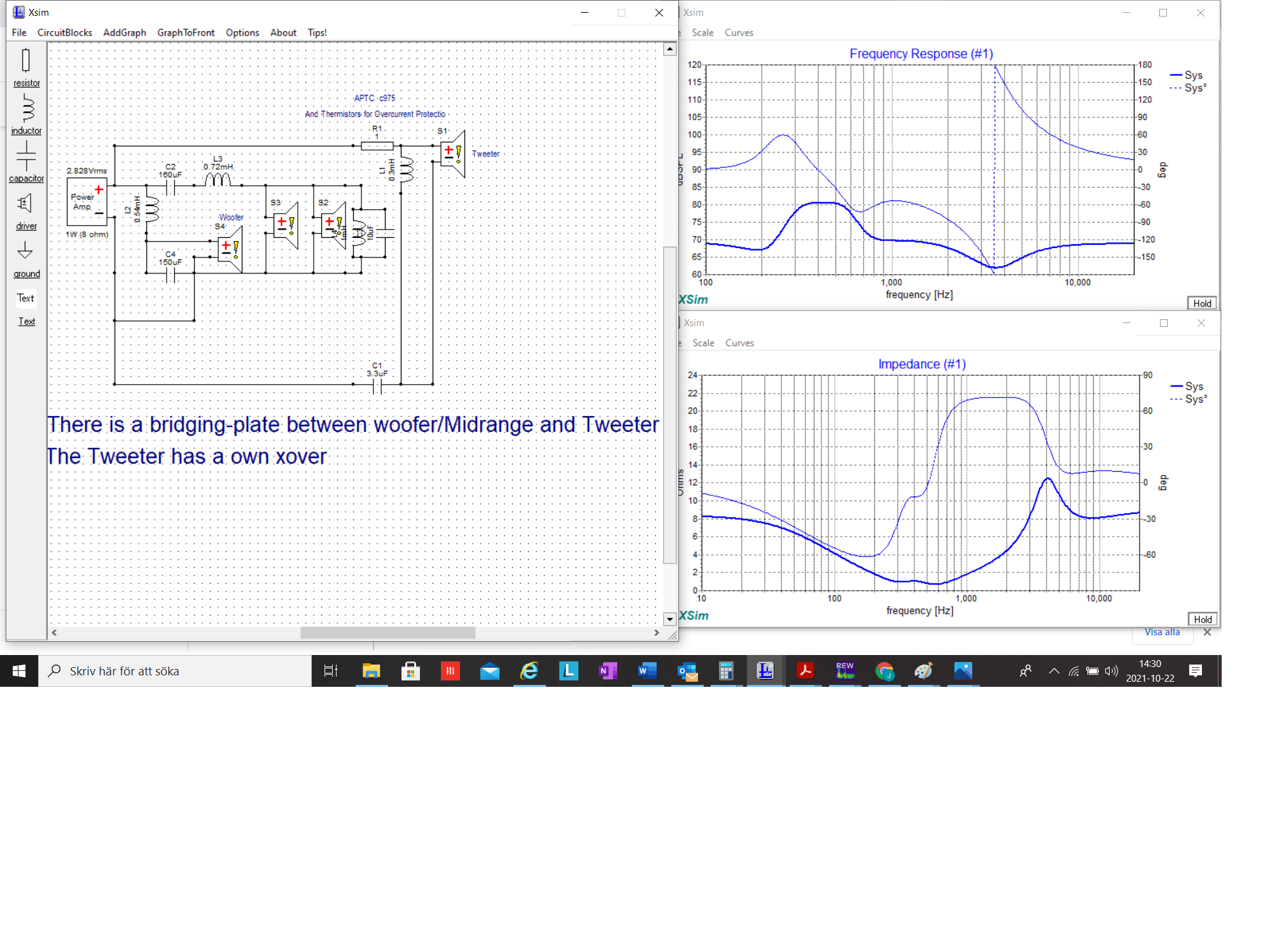

The dip at 2.5Khz or thereabouts is interesting.
It could be due to wrongly connected drivers or a purposely engineered dip
Yes, that looks like the tweeter may need to have polarity inverted. If existing schematic could be drawn from the crossover PCB, that might confirm.

And how do you guestimate 3-6db baffle-step losses in the lower midrange 11600/26 ~ 446hz, and what stands value 11200/26 for?
And i know coils should be mounted 90° (for mahnetfeild) and a little apart from eachother.

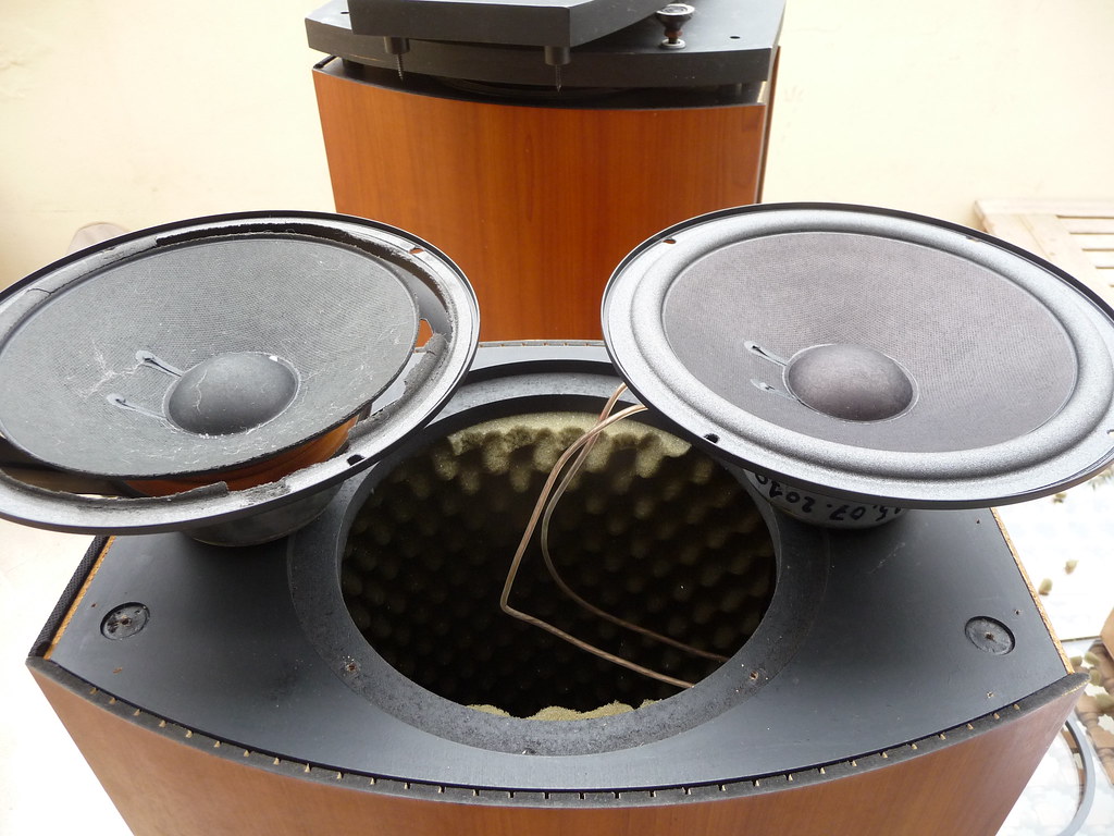

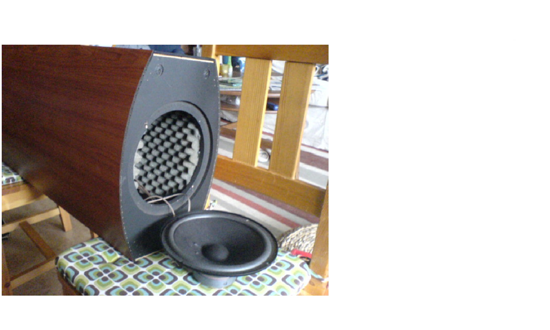

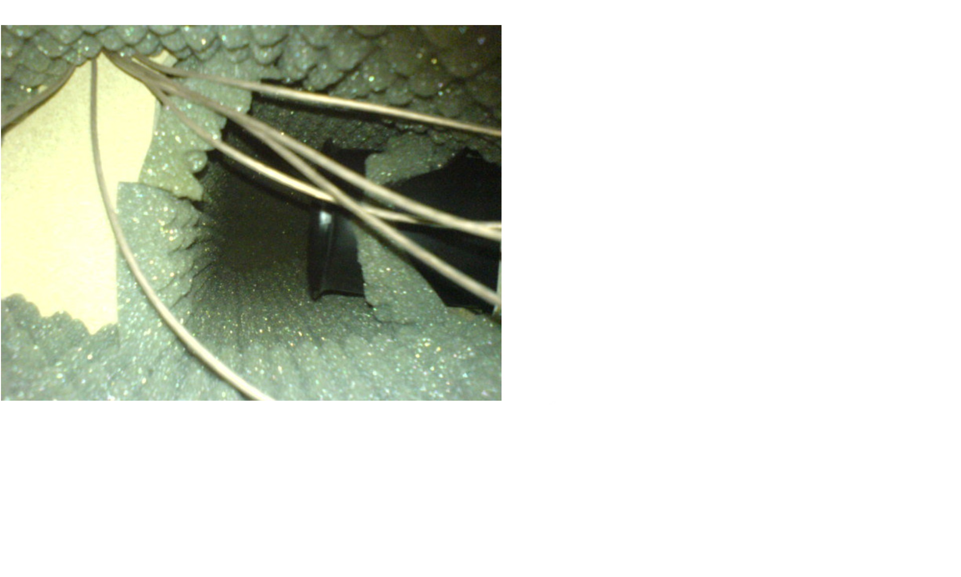

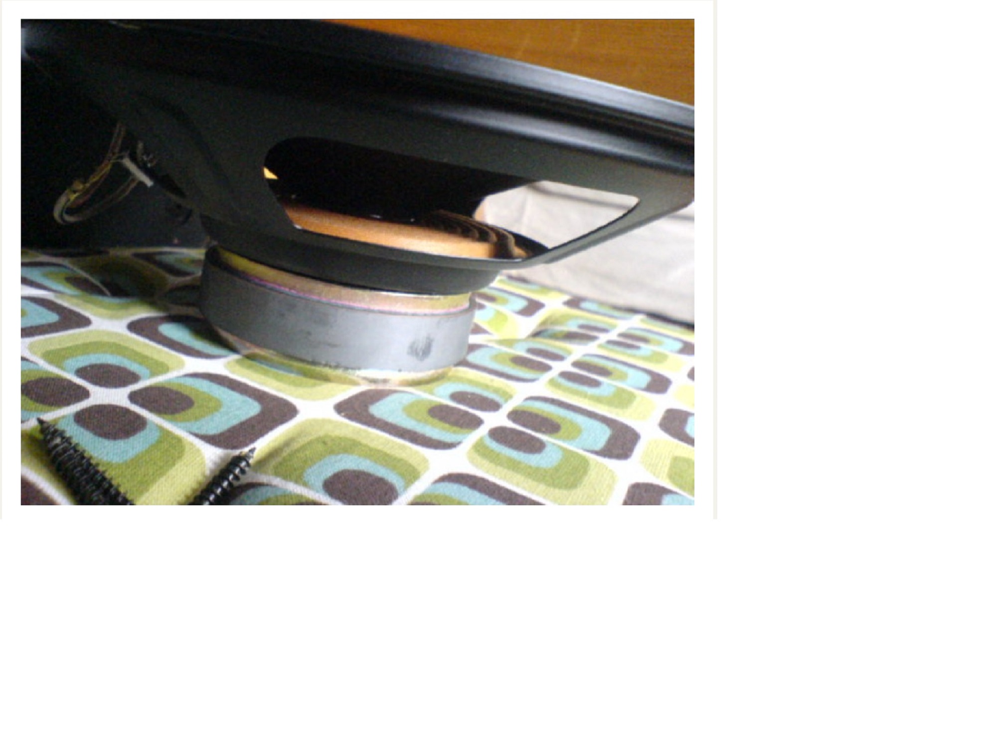

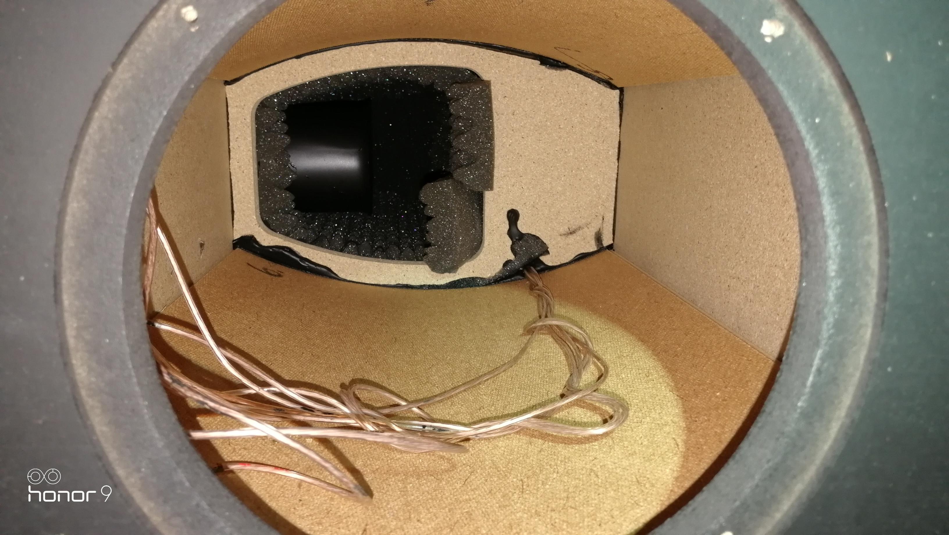

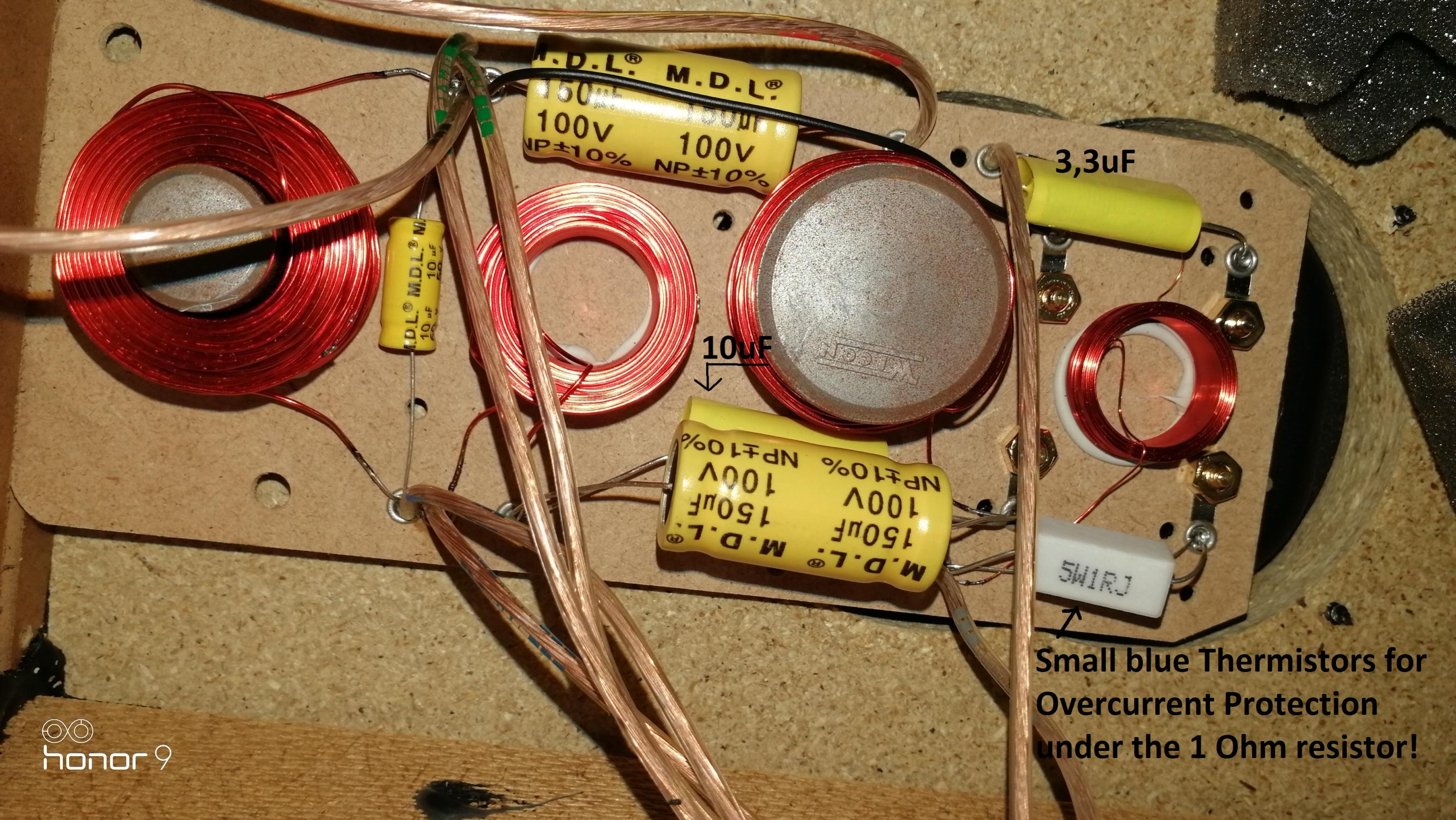

And have find some more pic´s from the Jamo D590 speaker drivers and inside cabinette. ( feel free to comment )

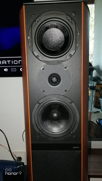

I have a feeling this will turn out well in the end. Those Jamo drivers look unbelievably cheap! It'd be good if you could try to draw out the schematic from examining the XO pcb.
Totaly agree with you motokok!
Jamo drivers look unbelievably cheap in every way, and that was why i begain the "investigation" in the first place a few day´s after i bought them used.
They sounded "muffled" with no microdetails/resolution at all, but i loved the design and the rigid but neat cabinete
Baskets, magnet´s, plastic, the less then average data i find on them....everything.
So i´m thinking im going to go from an budjet "average" sound, to almost hi end...mi end anyway and i look forward to begain with them.

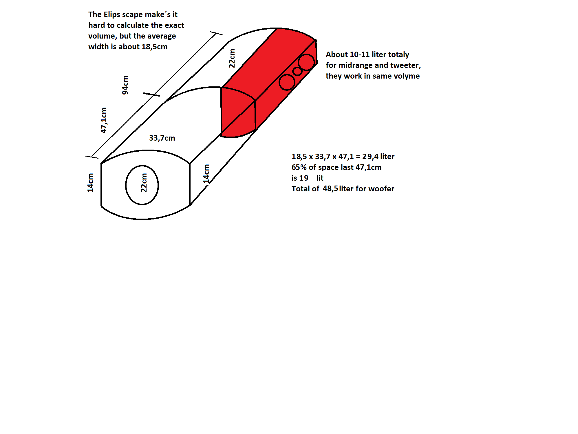

If there is room for it, i maby manufactre a routed milled down plate to mount the new woofer in (over the old wooferhole), but must measure the distance!
Because it will bee good to be able to "go back" and take all parts out if i sell the speaker in the future, because no one is willing to pay for parts in the new xover and the new drivers and i can use them again in the future.

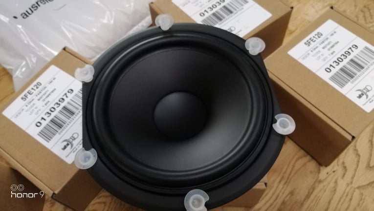

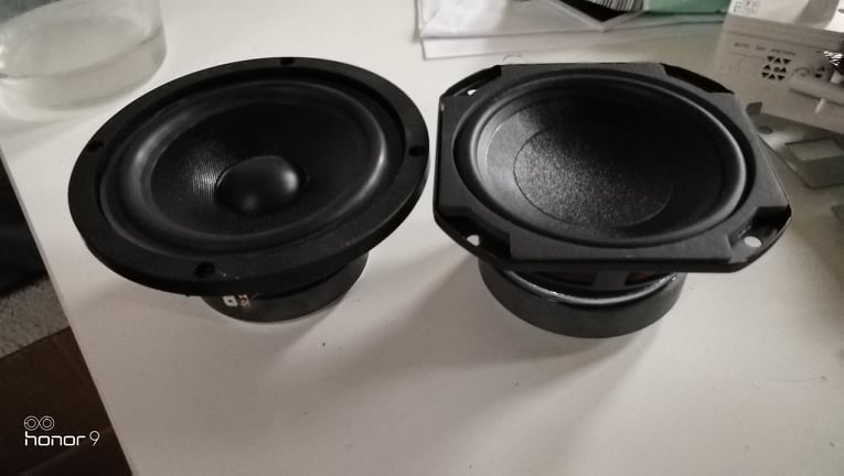

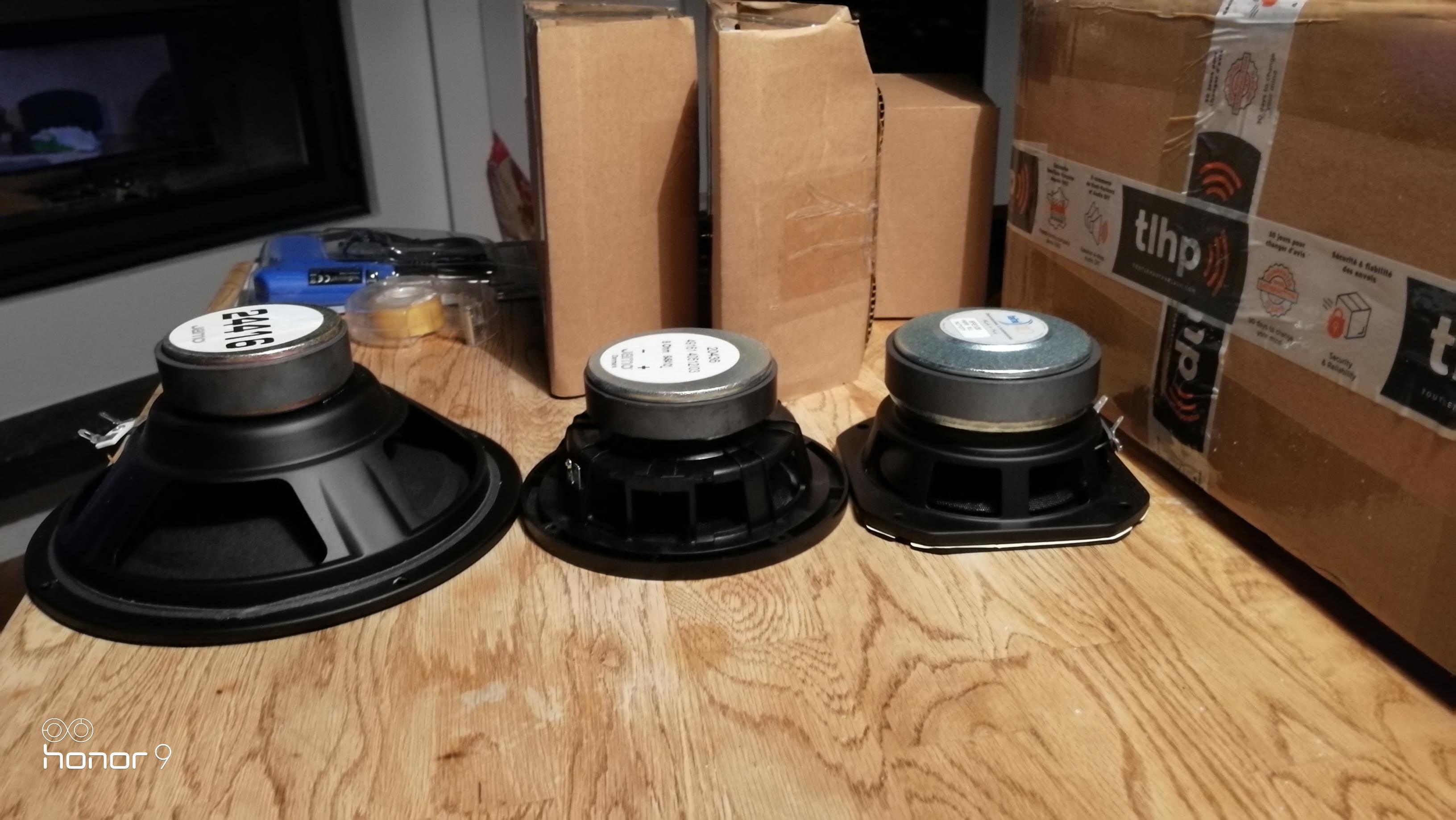

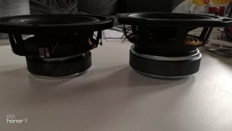

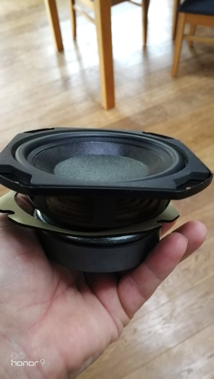

The first of the 2 delivery arrived today, and of course they have send the wrong woofers 🙄.
They have send me 2 x the SDS 830657 6.46 x 7.17 inch 60watt woofer
(Boutique Haut-parleurs & Audio DIY ) instead of the 8,39 inch SLS-830667.
Order some filling and a new iron also, so the rest of the order was right.

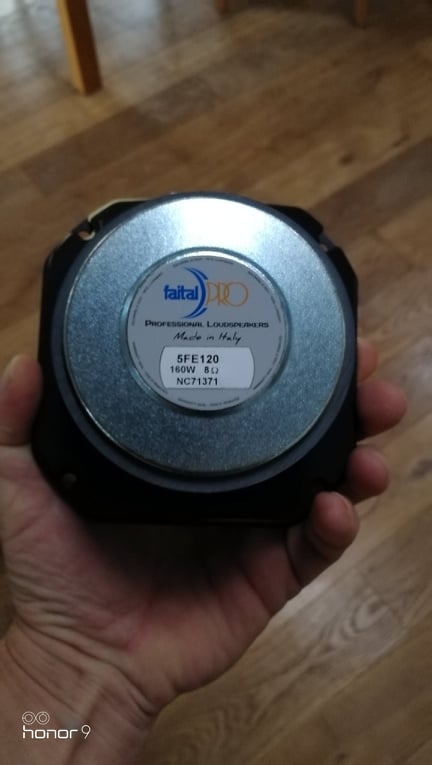

So can´t begain with the woofer modification today as a haved hope, but begain with the 5 inch Faithal Pro mid´s instead.
The 5FE120 look´s well built and they also send a sealing in the driver-box.
The original midrange cabinette has Polyuretan damping material stapled at the sides, but feel that thin stone wool and ordenary polyester wool will do a better jobb or what do you think guy´s ?

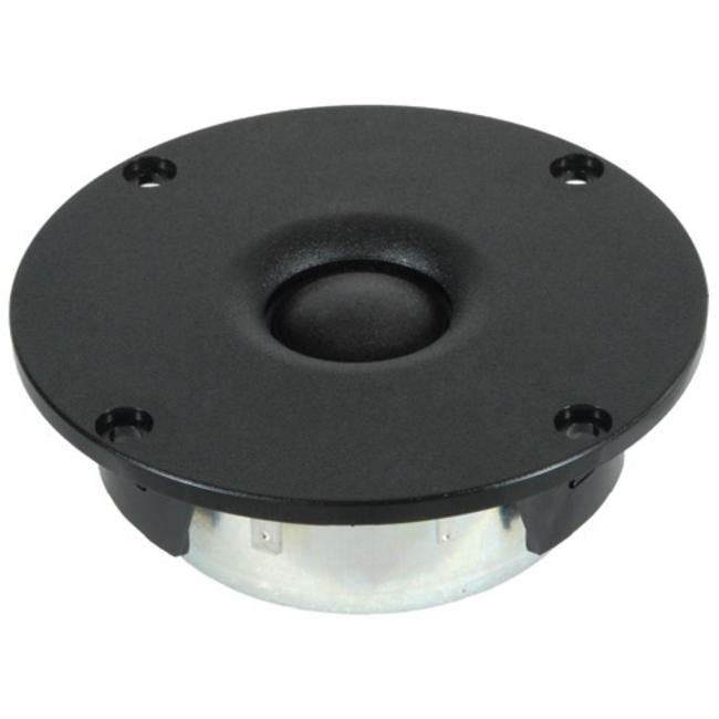

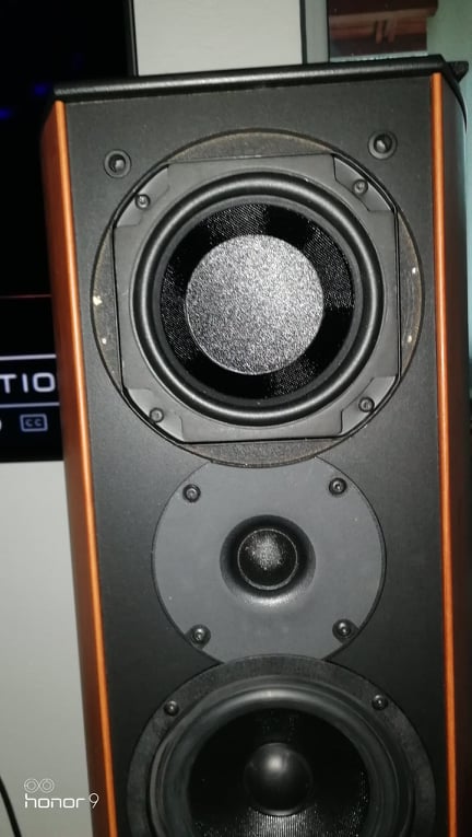

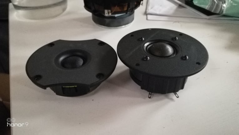

The 5FE120-8 ohm was a 100% perfect fit without doing nothing with the cabinette, exactly the same width and screwholes 🙂
And think the tweeter also going to be 100% witout modifications.

a little eager, and i had an old pair of Scan Speak 93000 lying in my basement, so i had to try how they fit between the Faithal´s.
And Bingo 😀, perfekt!
Look´s like real crap orginaldriver in the Jamo d590, some asian copy of SS and all plastic basket/front in the midrange with quite small magnets.
Listen for 5 minutes now and going from originalspeaker to up-graded one, and suddenly i can hear the singers Ssss and little more details/resolution, also little more midbass punch.
Pic´s at orginal vs Faithal/Scanspeak
Regards John
Regards John

Yea rajmondj i was realy lucky, because I thought I would have to carve a little in the wood...at least a mm or 2.
Have listen to it for a few hours now ( left one original and right one upgraded), and the sound have "open up" a little more in the upgraded one.
This is going to be real a nice result, and if i should give them a rate from 1-100 the original is about 30 points and the upgraded 55 points.
Think i can come up to about 75 points with woofer and new xover.

The way drivers are arranged in 3d space has an impact on their phase relationship. Are you doing anything to incorporate that effect into what you are doing here?
I downloaded the first Xsim package you posted, and didn't see any driver offset settings. And you mentioned that you traced the manufacturer FR for the drivers, so spatial interactions wouldn't be included there.
If you do some acoustic measurements yourself you could capture those relationships that way. Note that taking good measurements is a whole topic all by itself!

Have remowed the woofer and xover now and mesaures the coil´s in the original xover to get their values.
Also have try to putt it all into XSim so you can comment.
Had open the cabinette and take the xover and "filling" away, and try to measures the volyme...About 48,5 liter for the woofer and the tweeter/midrange work together in about 10-11 liter.
Filling in cabinette was only Polyuretan damping material stapled at the sides, so here a maby can do some improvments with thin stone wool and ordenary polyester wool.... will that do a better jobb or what do you think guy´s ?

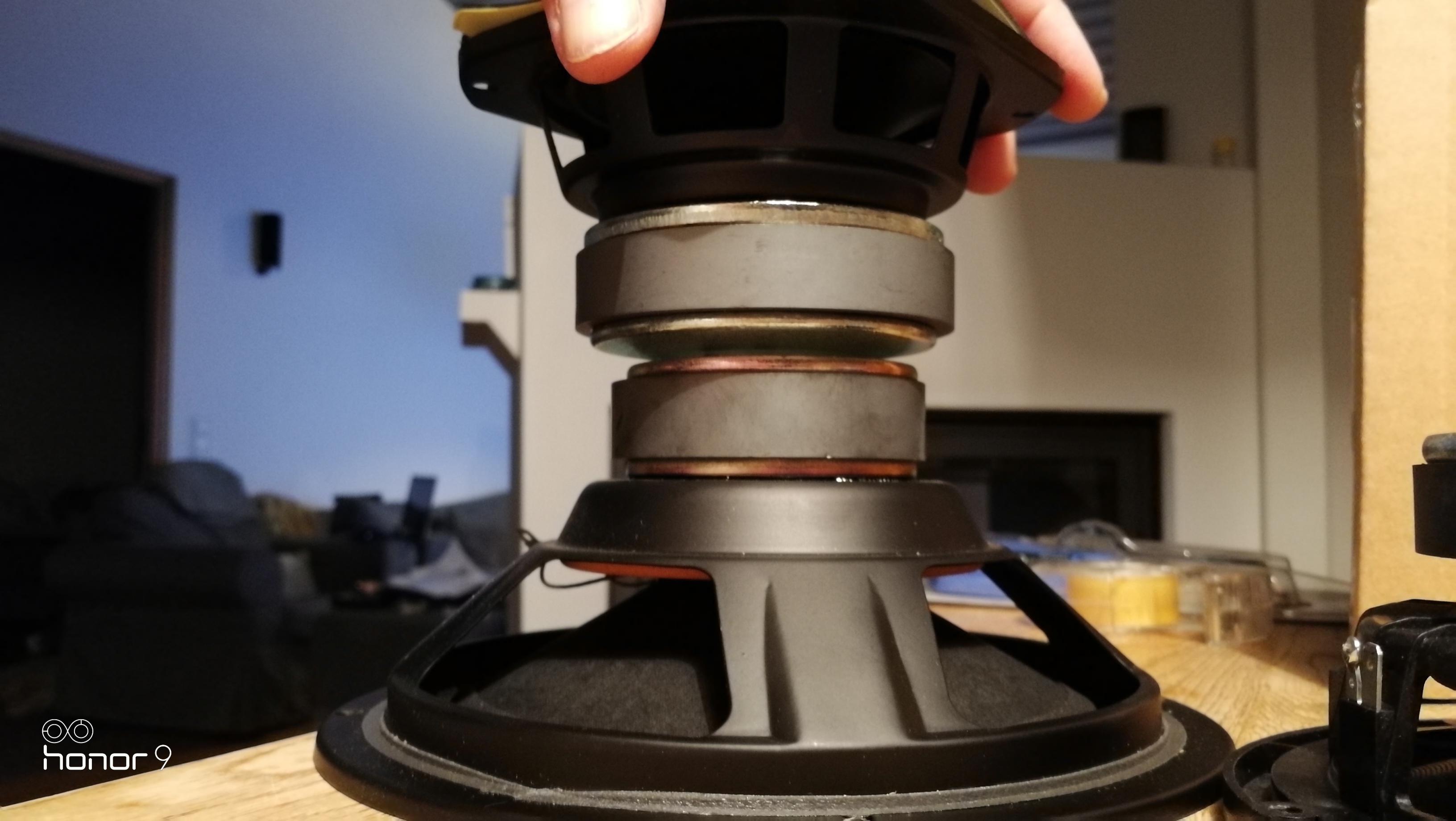

Orginal woofer has a tiny magnet and weight less then orginal midrange 🙄
Regards John
Regards John
