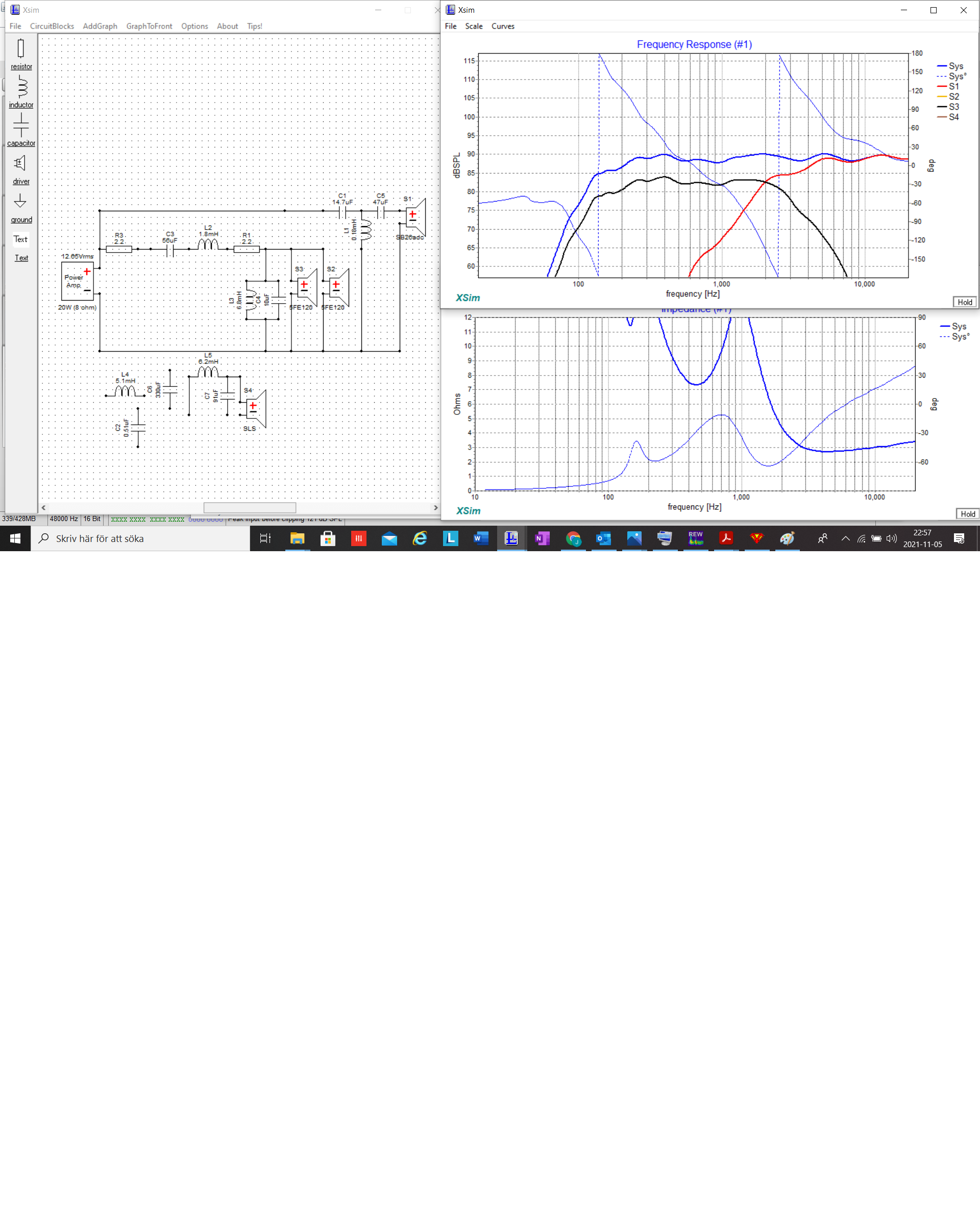

Ahh, just spotted you said no impedance curve.
Although I can see an impedance profile in graph. Do you mean that you don't have the woofer impedance and Crossover implemented / connected ?
You had me there for a minute. You need to get the mid and tweeters zrd files loaded but they seem to be in your screenshot???.
Just out of interest what resolution are you using as your profiles are so smooth without noise, 1/6th octave smoothing should be fine.
Hi again

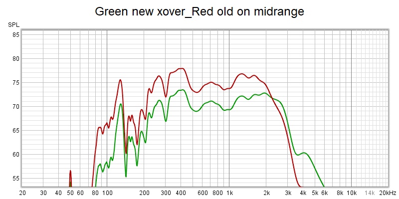

I use 1/6th octave smoothing in XSim, but work me down from 3dB virtual step size down to 1dB to get "maximum".

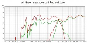

Builded a new MTM xover today just to try it out, but Run in to problem when i connected my amp, and my Onkyo-amp stuck in "Amp diagnos mode"....pjuuu 🙄
3 hours later on internet and trying i manage to reset tha amp, and had to do all settings again.

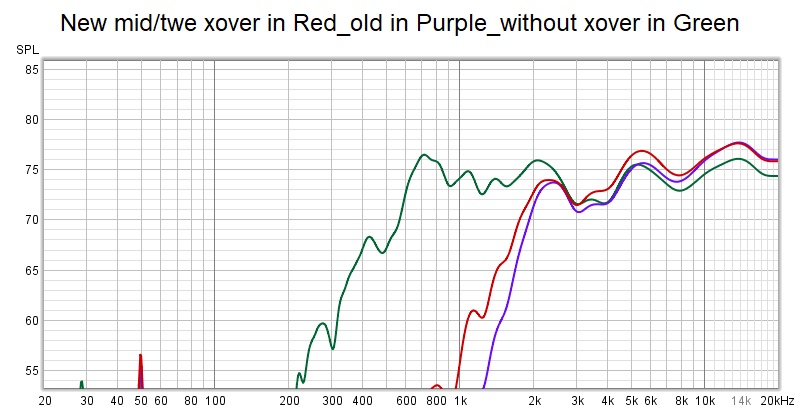

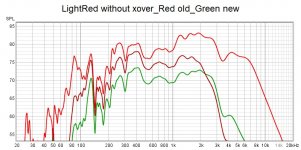

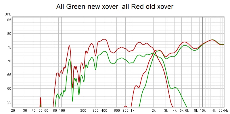

Now i measaure both of my xover and compare with the measaurements from the curve without xover, and both are close to crossing-point.
Also find that my new orderd 47usd 150uF cap has value 1132uF....And find a hole in the side 🙁......From a soldering iron or explode from inside i don´t know, i haven´t even use it yet!
