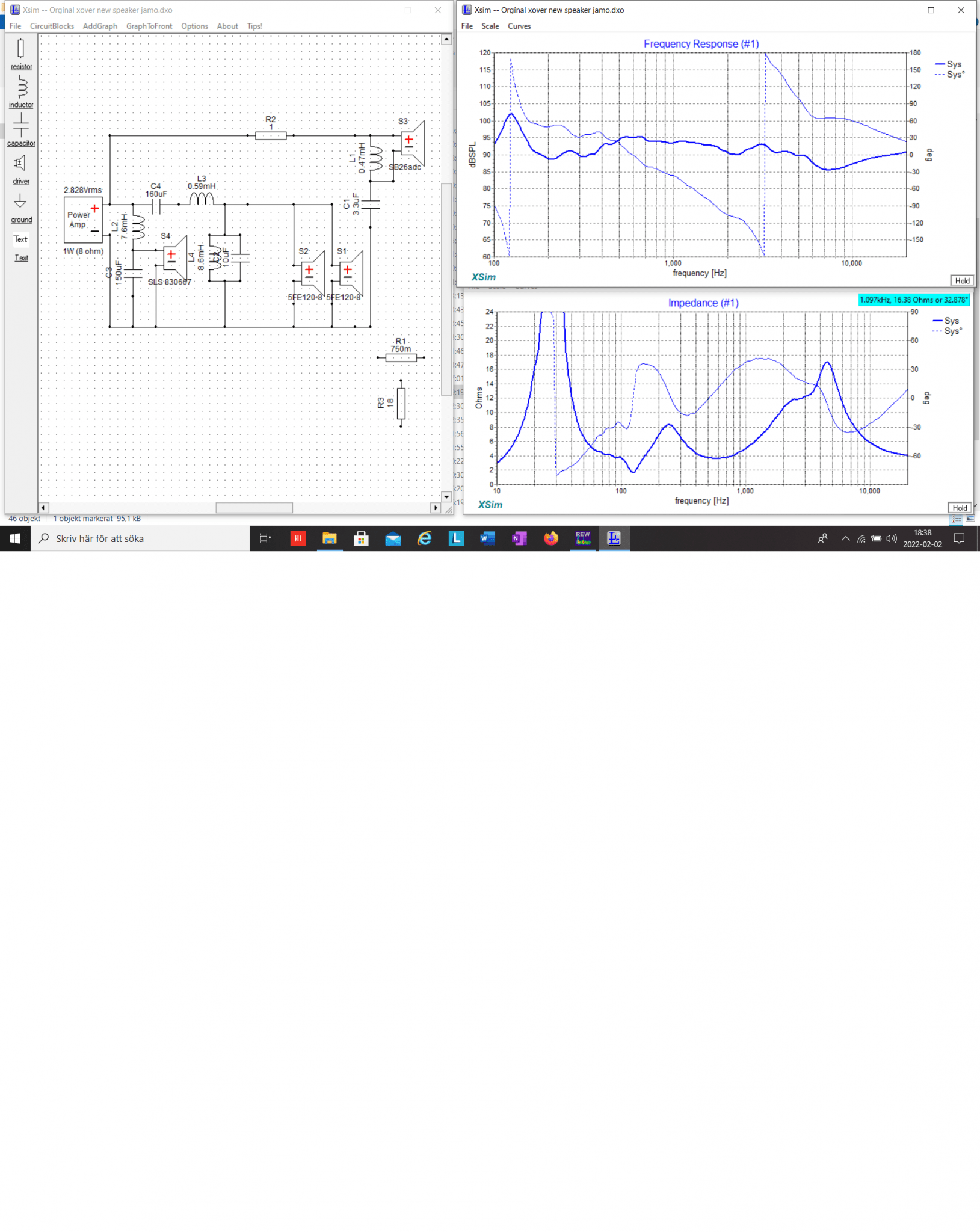

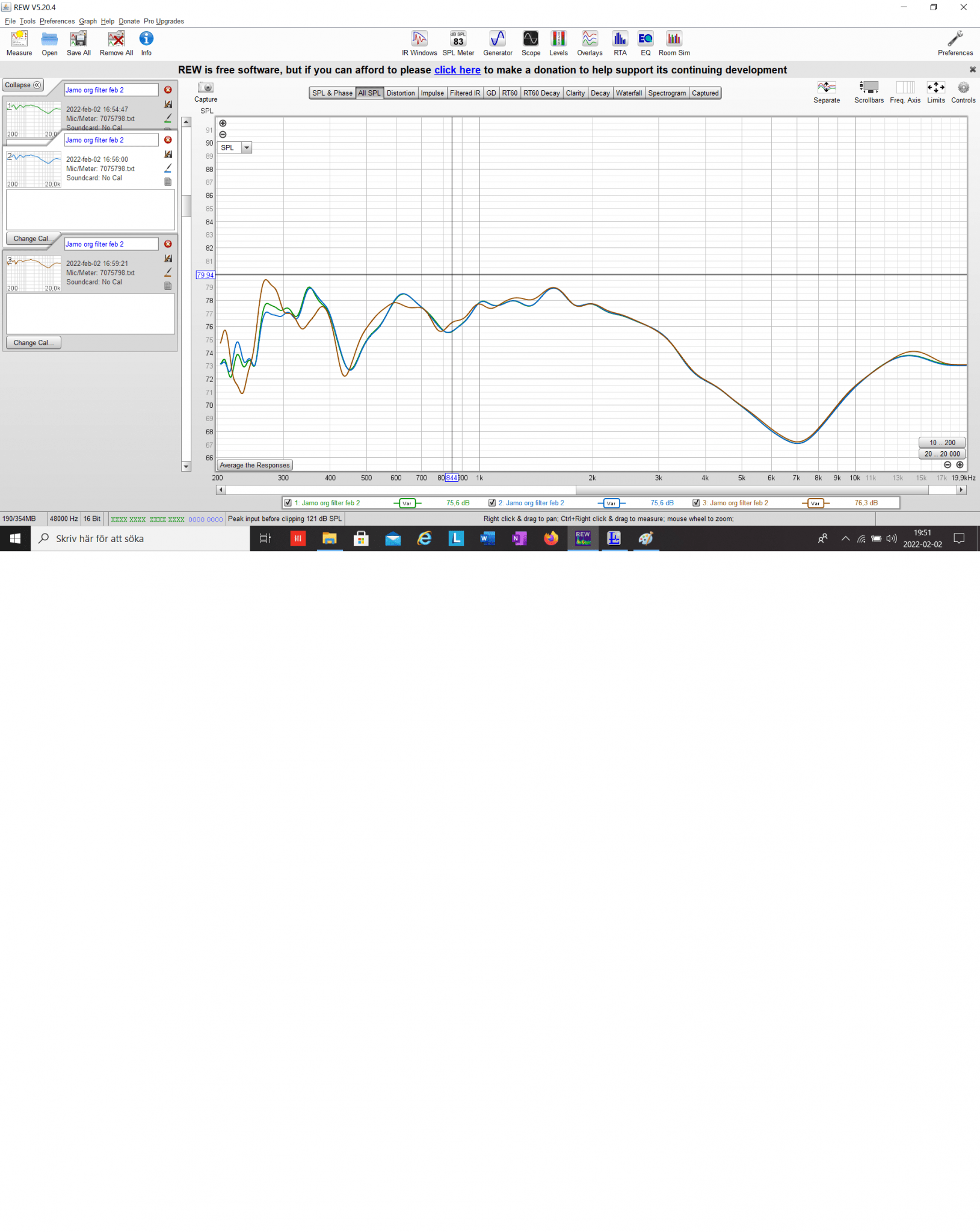

I have done some new mesaurements on the SB26ADC and 5FE120 modified Jamo D590 with orginal xover!
Will begain with mesaurements from 200 hz - 20.000 hz, and try to make some progress on the orginal xover.
As you can see (on the mesaurements pic´s) it´s quite okey from about 260 hz up to xover-point around 2.500 hz, but then falls and are -10 dB at 7.000 hz.
As you also can see is that my previous simulation in XSim was showing almost the same when putting orginal xover values in to it with SB26ADC and 5FE120.......A dipp around 6-7 K
I will begain re-build/modify orginal xover tweeter-circut tomorrow i hope, and come back with the results.
Best regards John

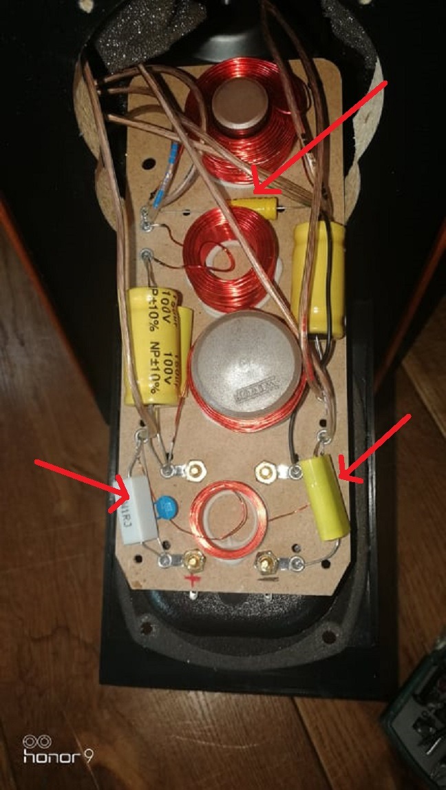

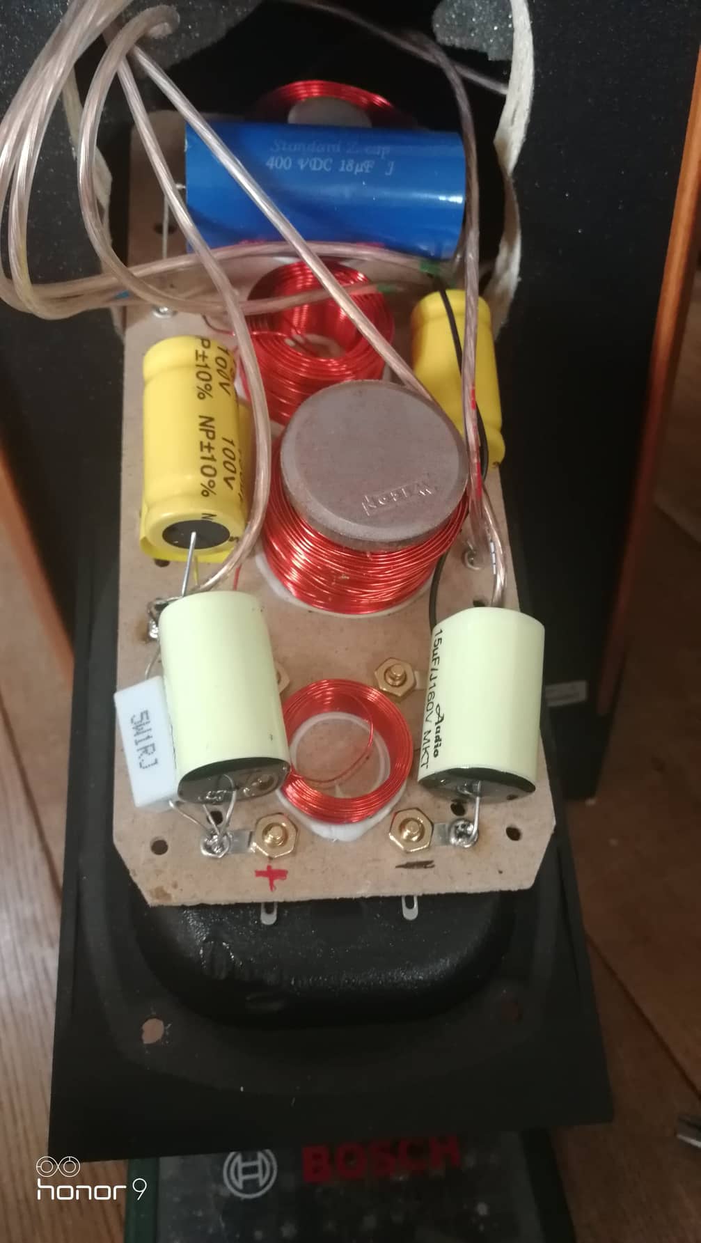

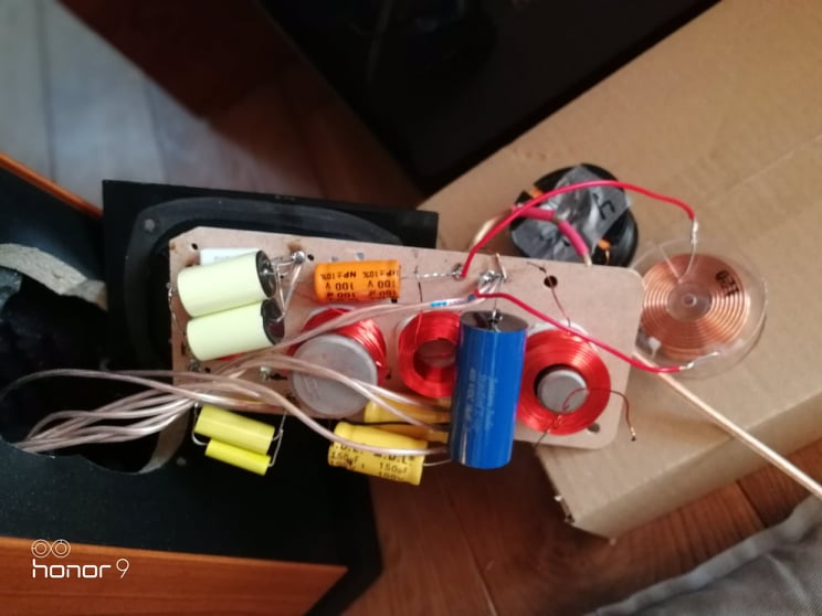

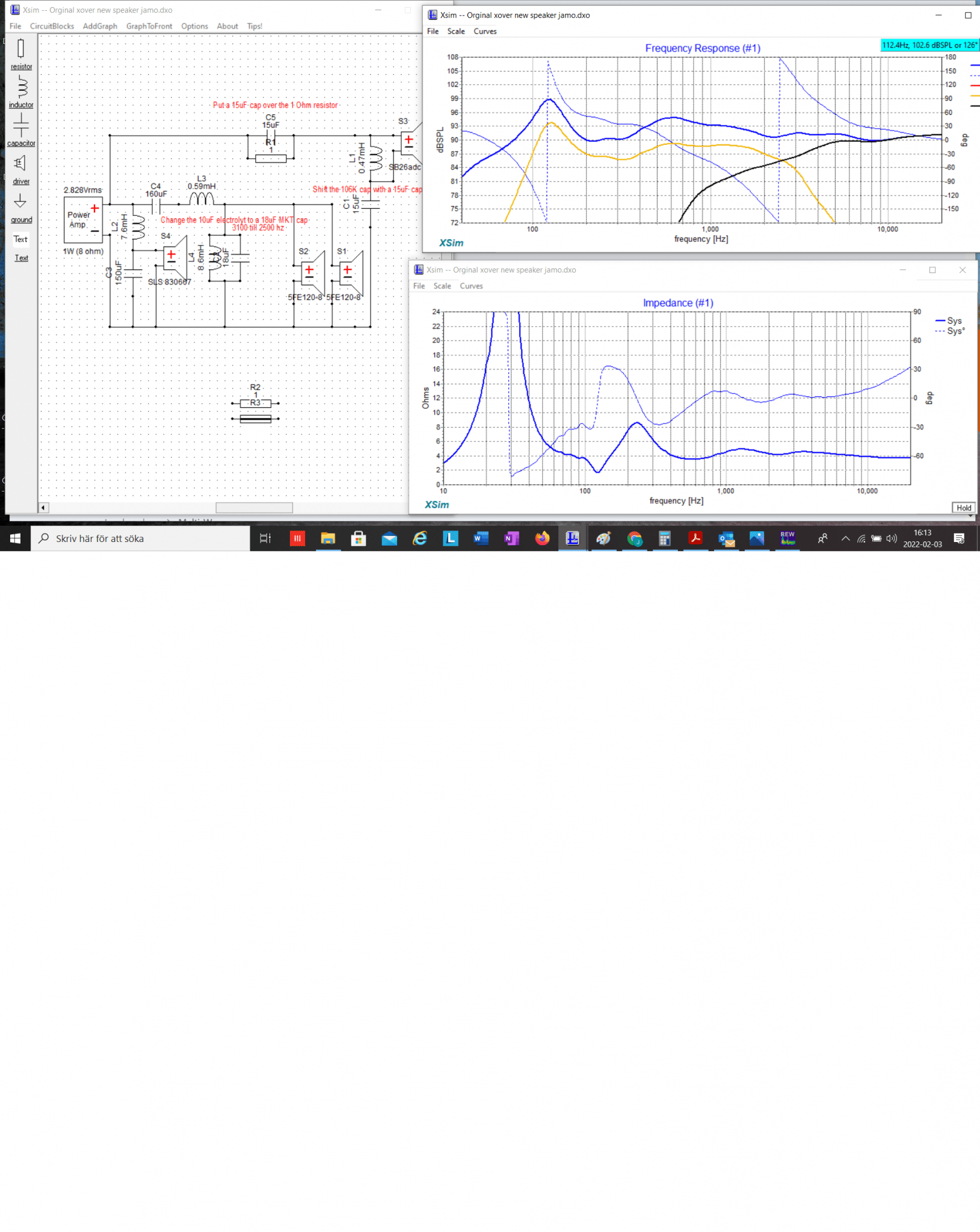

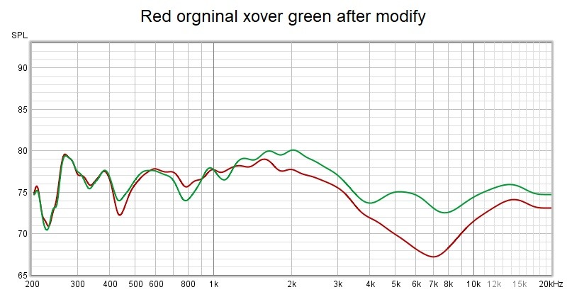

Hallo all i did some time first test in XSim with orginal xover, and have done some quite small changings to the orginal filter.
The easy done modify increases sensitivity on the tweeter by about 6,5dB at 7K, and also make the impedance much better!
If you want you can make this small re-build of the orginal filters xvoer point and tweeter curve/SPL for about 12 USD each speaker.
Il try with as small as possible changes on the orginal xover , so other´s easy can follow.
Maby i will find some other small changes for the orginal filter, but in that case i come back to you about it.
With my Peerlees 8 inch the xoverpoint with orginal Jamo xover is 120 hz (a little low), and have a impedance bump down to about 2 Ohm´s between 110-140 hz
I put only 2 more caps on the board and replace the cheep 10 uF electrolyt for a 18 uF Metallized Polyester Film Capacitors Jantzen Standard cap
So a total of 3 caps per side!
The orginal 10uF electrolyt made the xoverpoint at 3.100 hz, and the "new" 18uF cap takes it down to 2.500 hz (as it should be in my mind)
You can use any MKT / metallized Polyester cap you want)...It`s around 4 USD each
I post you guy`s photos so you easy can feel comfortable with the modify, and also photos on XSIm SPL and impedance after changes and text of what to do on the filter.
And also a pic on latest mesaurement compared to original xover, Green curve after modify.

Now when i did a few mesaurement sweeps from 15 hz and up, my Onkyo 747 goes into "protect-mode".....probably due to the impedance dip at 110-140 Hz.
Have spend some time in XSim, but have a hard time getting the impedance up from about 1,9 ohm to about 3 i as i will need.
Can you please help me out here raymondj, i feel a little "stuck"? :smash:
Best regards John

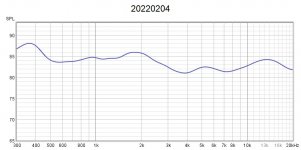

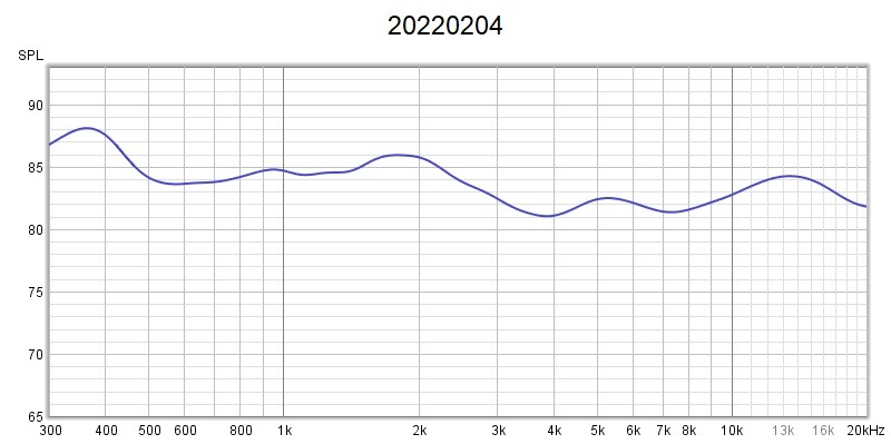

Yea raymandj, this was a tricky one!.....Real hard to make the original xover from the Jamo function "easy" with the Peerlees woffer and impedance without change of more components..
raymondj i have no informations about the original mid drivers in the Jamo speaker, or the woofer or tweeter!
Have spend a lot of hour´s trying lots of diffenrent values on different components, and have come to a point thats quite good but not easily done for people not accustomed to manufacturing own xover´s.
This pic is mesaurement from today from 1 M one speaker with only the 3 caps shifted, with 1/3 smoothing...Going to be good with both speakers involved from listentingpoint 👍
Best regards John

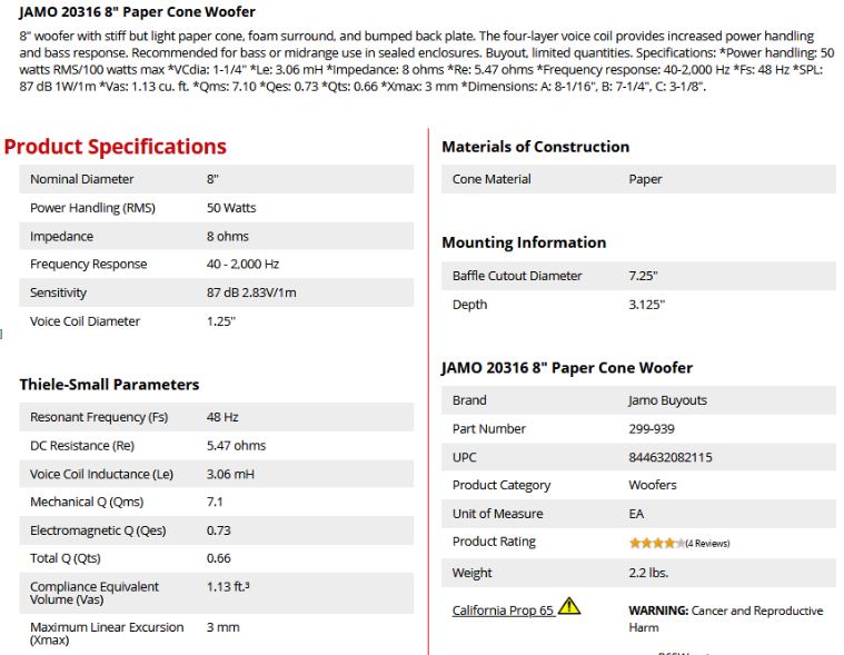

Thiele Small paramaters for some JAMO
?? Jamo 20435
*Power handling: 40 watts RMS/80 watts max *VCdia: 1" *Le: 0.87 mH *Impedance: 4 ohms *Re: 3.37 ohms *Frequency response: 40-5,000 Hz *Fs: 70 Hz *SPL: 87 dB 1W/1m *Vas: 0.20 cu. ft. *Qms: 3.03 *Qes: 0.57 *Qts: 0.48 *Xmax: 3 mm *Dimensions: A: 5-3/4", B: 4-5//8", C: 2-5/8".
Medium D590 Jamo 20436 8ohms
Medium Jamo 20255 (707A et 707I)
Specifications: *Power handling: 30 watts RMS/60 watts max *VCdia: 1" *Le: 0.36 mH *Impedance: 8 ohms *Re: 6.03 ohms *Frequency response: 40-5,000 Hz *Fs: 70 Hz *SPL: 86 dB 1W/1m *Vas: 0.21 cu. ft. *Qms: 3.83 *Qes: 0.71 *Qts: 0.60 *Xmax: 2 mm *Dimensions: A: 5-11/16", B: 4-5//8", C: 2-3/8".
_______________________________________________________________
Tweeter (707i et A) 38822 4ohms
Woofer for 7.7 (20316) T&S 20316
Moorclos,
Thanks for posting the info you have dug out.
It does seem that they should have been 8 ohms on the mids.
The bass driver is listed as having a 5.8 ohm Re with a 4 layer voice coil and 3.7mH inductance, quite possibly that could have been a useful factor for the original designers.
It highlights it is not always easy to substitute drivers, the devil is in the details.
With that said Jawen is going forward and with a few more iterations it should sing very nicely. The mid tweeter combo always looks very promising. The bass driver is almost acting like a weak sub woofer in my mind, with room gain doing the rest dependent on good positioning.

So strange with XSim and real mesaurements on this project now while tweaking orginal xover!
When i in XSim change a value that XSim say´s change -2 dB in region 2000 hz, but mesaurements shows a increase about 3-4 dB only in 3-400 hz region 🤔
Done 4-5 changes now but what XSim shows in simulations is NEVER the same as the real mesaurements.
I want to boost from 2500- 10.000 hz about 2-2,5 dB, but feel lost on this XSIm simulation.
Feel that the SPL curve from SB26ADC and 5FE120 on this orginalxover-type dosen´t suit XSim simulations?
Cheeeeeeeeeers 🥳/ John
