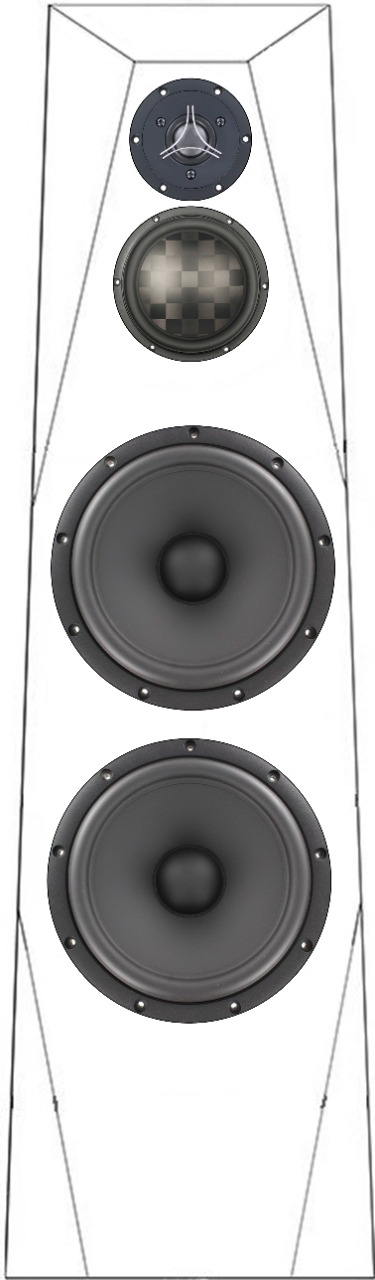

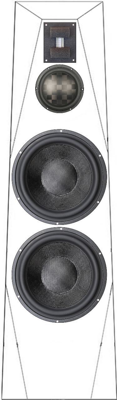

planning my Ultimate 3way, hopefully last build ever
tweeter : Raal 70-10D or Satori TW29TXN-B-8
mid : Satori MW13TX-8
bass : Morel Ultimo 104 or Satori WO24P-8
XO : estimated around 350Hz dan 3-4kHz
target : perfect timing & linear phase
box : Avalon Time clone
amplification : dsp + multi-amplifier is my 1st choice, as i already have dsp and several amplifier laying around. maybe i can hire someone expert in passive xo design later
I also already have dual-opposed 2x12" sealed subwoofer for below 40Hz and there 2 of them so main focus for woofer is to handle higher cut off to blend with midrange. for sure with either woofer choice above will have low bass extension too
Tweeter : Ribbon vs Dome?
I use cheap plannar ribbon beston rt002 on my OB and Fostex T90A for FAST and reguler dome on my 1st 3way floorstand, but never have any experience with high end ribbon or dome
Woofer : Kevlar vs Paper?
I prefer Morel for it looks (looks like woofer on B&W Signature 800 which cut off 350Hz) and higher power rating, but Satori has lighter cone which might give faster transient (but boring looks just like any other woofer)
any input?

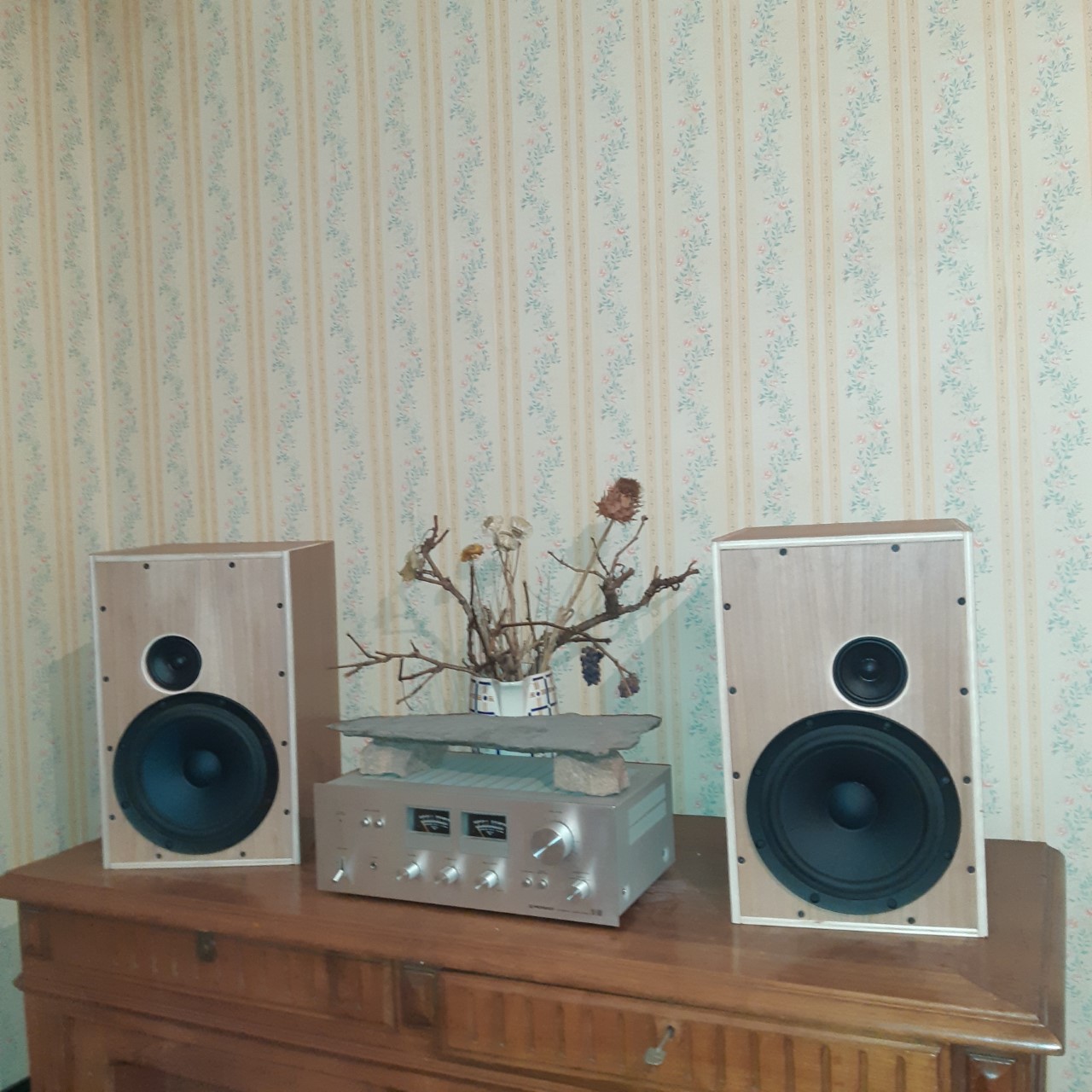

I was eatings eggs then I landed on this thread
Maybe the best designers could do something with something a little wide band in the mid ?
Something with 500 hz to 5000 hz, with 1.2 center to center spacing with the small neodyn tweeter unit, some are 2.5 cm diameter and there are cool 3" to 4" mids that are very flat and low distorsion for the mid unit :
The SS 10F is flat, especially the 4 ohms unit, the Peereless 4" or 5" Satori style have very low distorsion in that >200 hz range and smooth roll off (mainly the 5")... non limited list. Cone choice to be hard enough for small details but with compromises choice for less break-ups (some polypro ?)
Of course some pure mids ref come in mind as well as the cool already advised everywhere Audax PR17 M (paper version) able of 500 hz to 3000/4000, maybe suitable for a bigger LR12 overlapp with a tweeter ?
If cone surface is a concern, some revelator that climb high ?
The cabinet and wood working being ALWAYS the limiting factor -or a good second-hand is less expensive.- maybe something pyramidal, simplier than Avalon thick angled front bafle... Avalon style is only for the wood workers day job or the kings of saw table like Troels and the 5 speakers-a-year stakanovists with rare skill 😱
I try to do something like that as simple as possible and Harbeth cabinet style cause I'm a perpetual absolute beginner : SB23NBAC, LR12 xo around 500 Hz -> SS 10F8424G00 LR12 4000/5000 hz-> tweeter (non chosed yet as I'm slow on measurement and croosovers passive setuping) like a Fountek Neo CD 3.5 cause the horn for LR12 timing offset; the cool 0.8" peereless neodynium, or a cool Wavecore TW022WA10... Not so fare from a 1.2 wave length CtoC at cut off and a little compromise can be made there in favor to have a wide band mid going up to 5000 hz ? All sealed enclosure circa 28L for the SB23NBAC
Non limited choice... just lurking here. Good enough for a small budget ref speaker or at least the idea of a wide band mid driver ?
Thoughts ?
if too much expensive diy, better to buy yourself a Neumann Active speaker 3 way for 1800 euros per unit : KH320 Neumann Enceintes de Monitoring – Thomann France
can be DSP with mic for room placement !
If non entering in the 8 items list of non commercial loudspeakers then a Ref DIY Loudspeaker classic design SHOULD cost less than a brandnew on shelves to keep its "Ref" name atribute (we may call that The Atribute loudspeaker 😉 )
ahaha, with Ikebana style behind ! Although I find a certain South African loudspeakers brand to make cool menhirs shapeds enclosures but not my budget, idem for the BW coquillage loudspeakers... Damned, we are children of Breton's Cabasse, lol ! (french private joke)
Btw, the Dolmen you see on photograph is de l'ardoise hand made de Travassac for roofs, Correze... not my house alas as I'm living in a flat but I populated it with the amp found in public town trash, recaped, works fine, what asking else for Covit plan B druidique shelter 🙂... a diy Harbeth (hard Bet?) little speaker !
This is a very rare example of stone age (Stonehenge?) Amplifier.
Panoramix's potion fueled! You can expect miracle from it! I approve, very impressive. 😀
Cabasse, de l'ardoise...Decidement ils sont partout ces bretons! 😉
