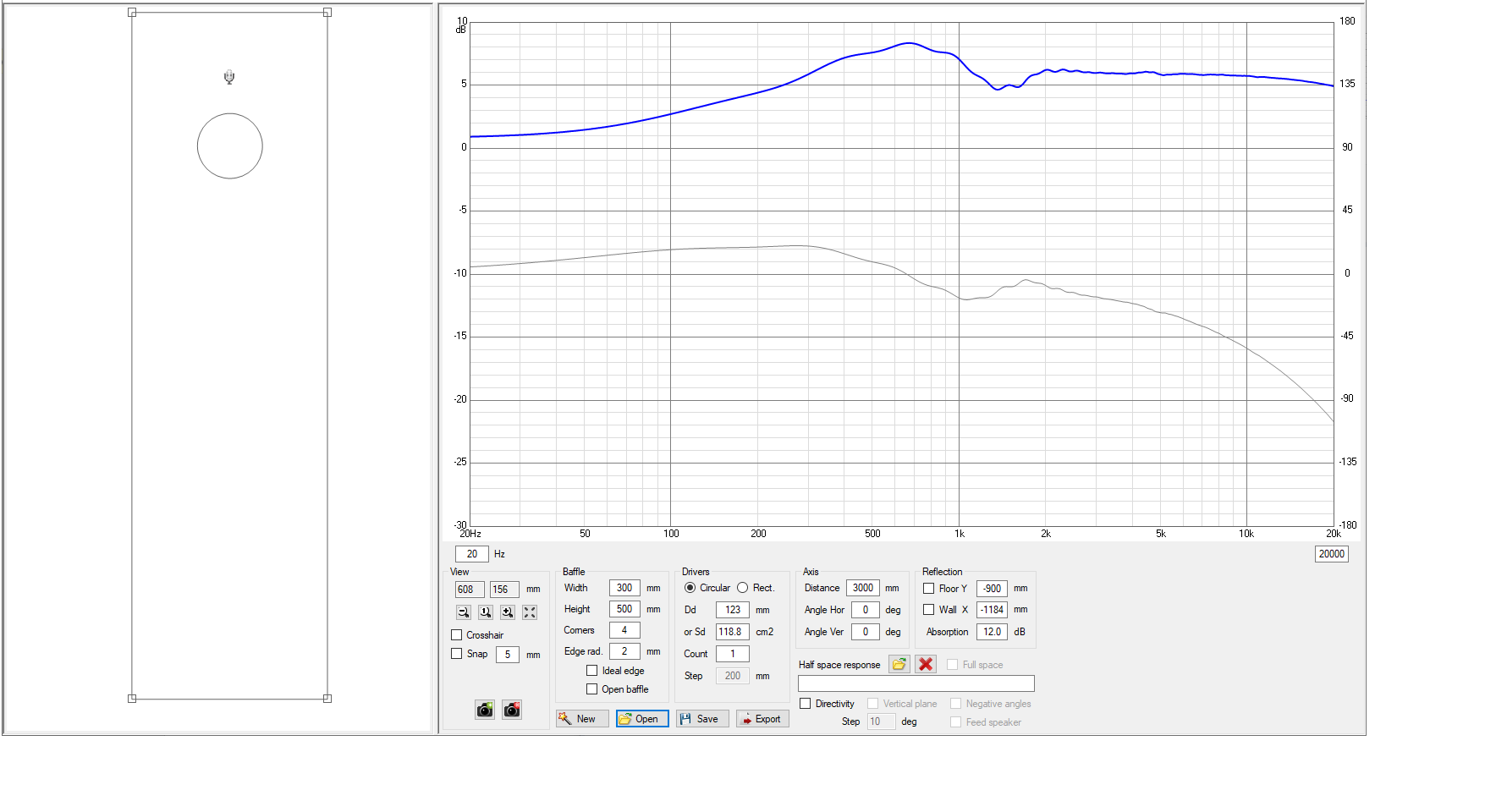

In retrospective, diffraction is still an issue despite the roundover, I should have off-centered the mid and tweeter.
These look great and seem pretty sensible as far as cost vs performance. Do you care to share more details on the crossover? Also at what frequency do you see the diffraction issues? I thought the wave guide was supposed to mitigate much of the diffraction issues?

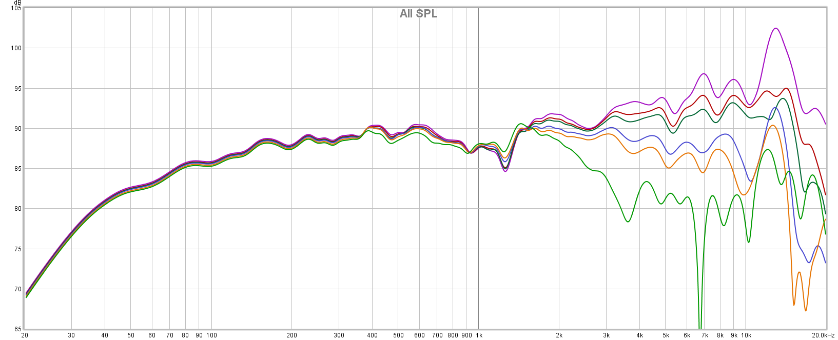

I can see a dip around 1.5kHz on axis due to diffraction: here presented without any round over:These look great and seem pretty sensible as far as cost vs performance. Do you care to share more details on the crossover? Also at what frequency do you see the diffraction issues? I thought the wave guide was supposed to mitigate much of the diffraction issues?
thanks, just trying to learn.
Diffraction largely changes directivity too, so it's complex.
Now, because it occurs below 2kHz, it impacts mostly the mid ; and not the tweeter/waveguide.
See my mid response alone; and how response actually goes up around 1,5kHz off axis:
If I had a much more narrow baffle, the diffraction would have been less of an issue given that its range of effect would be ~3kHz, ie where waveguide helps by increasing directivity, ie prevents radiating towards the side of the baffle.
[/URL]
