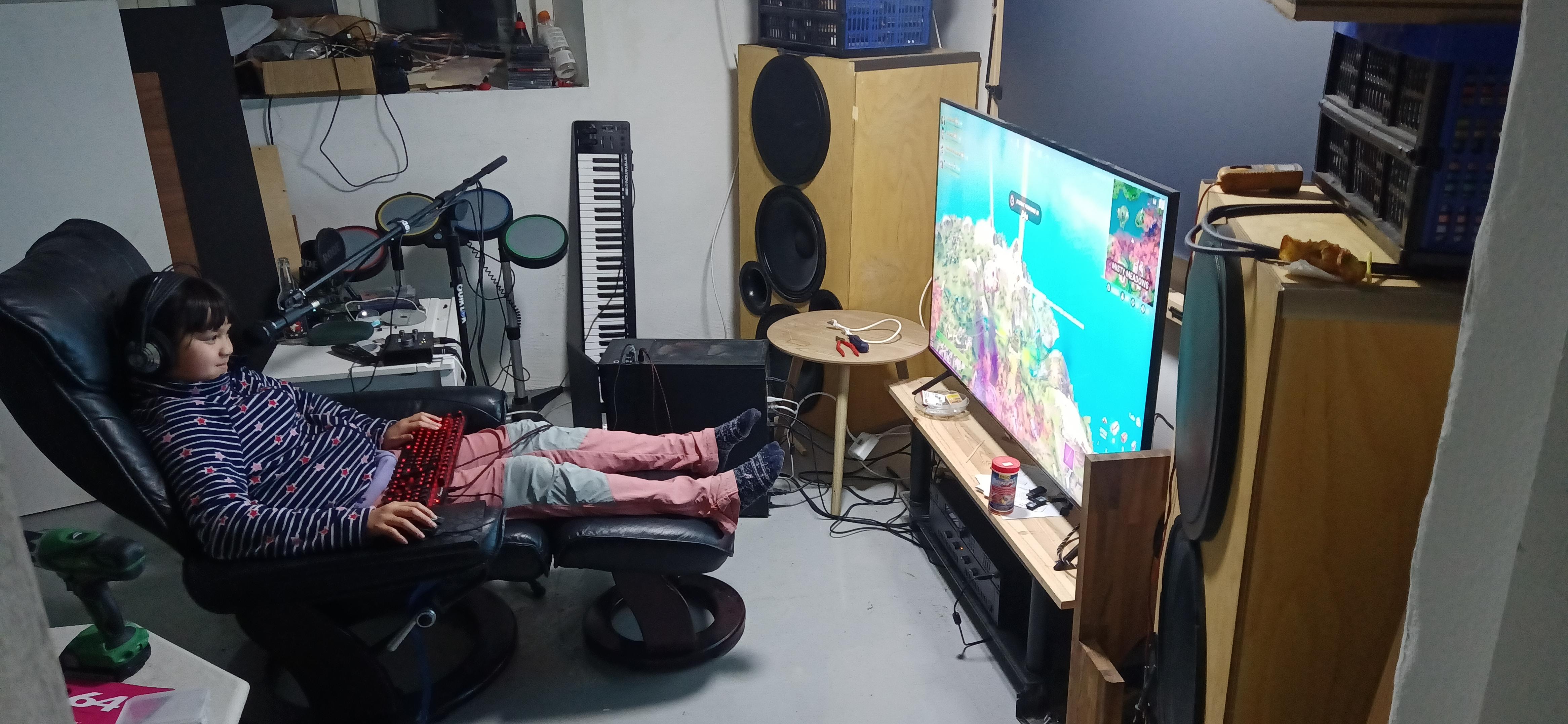

Love my big setup in the cellar.
Edit:
My youngest daughter loves the big speakers, having fun trying my gaming rig. She once said to a proud stereo enthusiast that he had small speakers, think it was a Klipsch RF7.

My first DIY build was CARRERA. 45 degrees panels. detachable front and back. Front don't have screws. it's detachable from the inside.
some pictures can be seen here : 2-way to bring me to HiFi-heaven....and having fun on the way - forum.zelfbouwaudio.nl
Even had to make the hole for the tweeter smaller, some were surprised it's possible and learned from me how to do it.
2nd build a soundbar with 2 FR drivers and 2 woofers.
Made everything myself. FR drivers are 15 degrees angled, woofers on the side. Each in their own compartment. Calculated the BR port made the XO. Add the 2.1 amp and compartment for the remote so it easy to find it back 😀
Made it all in the bathroom, with limited tools. just bought a router because the person who would make the holes charged me double price of a cheap router.
